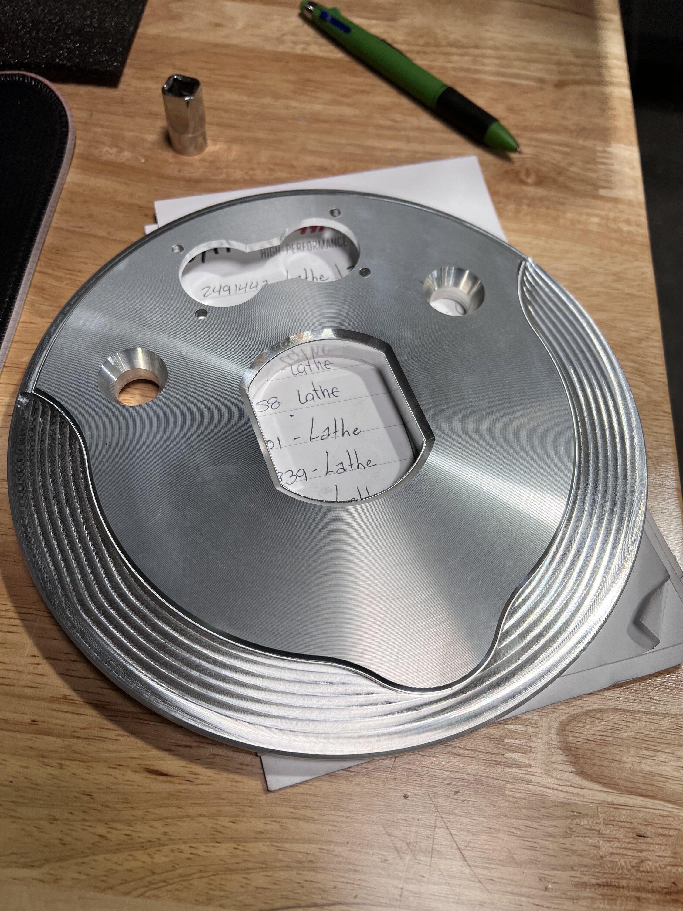

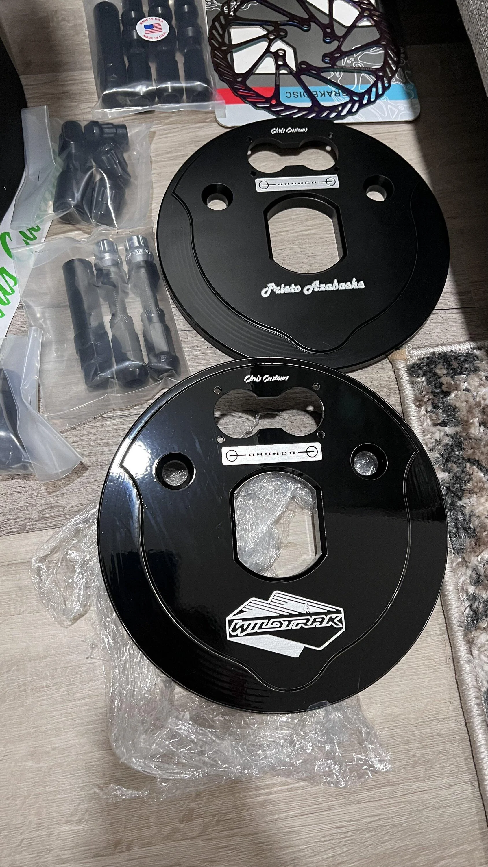

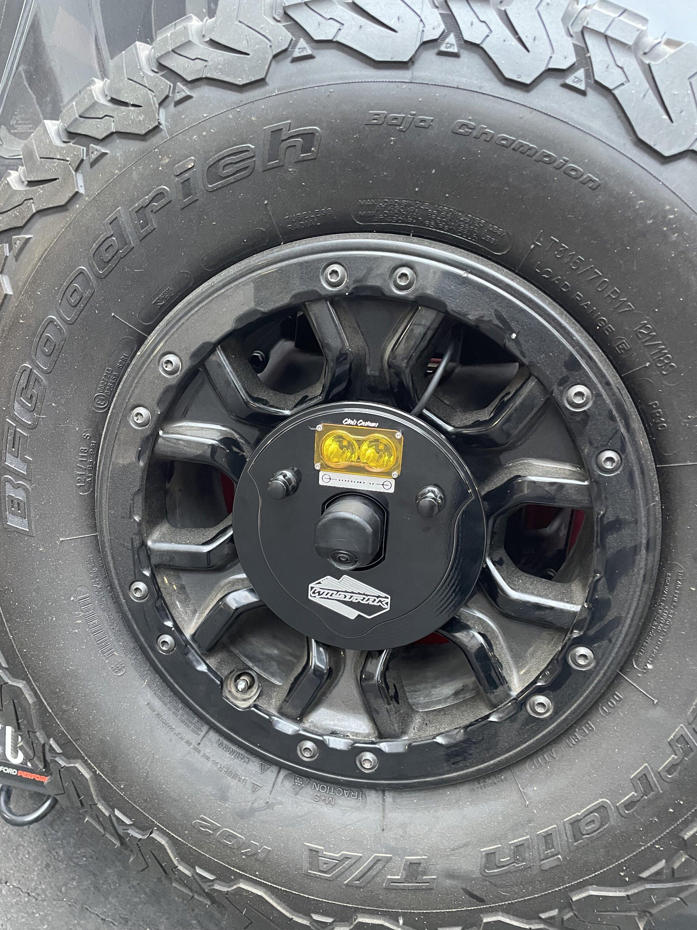

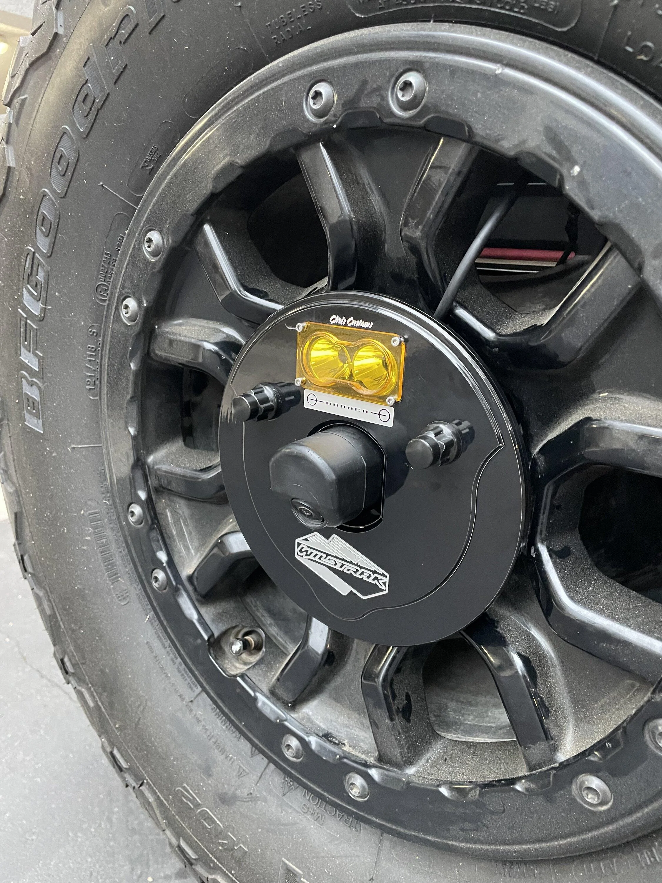

Hello Bronco fam, created another different chase light bracket. Added the Wildtrak emblem and added locks to protect our 5th wheel! Just a few more tweaks and its a finished product. Fits better now and light is more exposed, wayy brighter now.

how do you adjust for proper aiming?
kodiakisland
Jul 10, 2020
5,770
16,385
Arkansas
12 Tacoma, 18 Indian, 23 GV70
Aiming of the light? It fits straight on. Flashes forward
If it's a spot, it will need proper adjustment. If it's a flood, it probably won't penetrate heavy dust well. If it's more for looks, it should be fine without adjustment.

Ohh got you. Its a spot light and tomorrow we will test it out in the dirt and see what it does. Thank you for the feedback

Yeah. mostly just curious as I know my spare doesn't sit square with the ground and would probably point up. I find my spots have to be adjusted within a few degrees to really be in the eyesight of someone behind me in heavy dust during the day time.
It looks great. Hope it works well.

How do you wire/power the light?

I wired the light thru the tailgate and all the way to the Aux wires we have under the glove compartment. Hooked it up to Aux 5, also, I added a strobe light switch from Amazon that comes with a lil remote that allows me to control the flashing.

Wow...well done. I used the glove box aux wires for my roof lightbar.
I wonder if there is a way to connect the chase light to the wires in the tow hitch?
