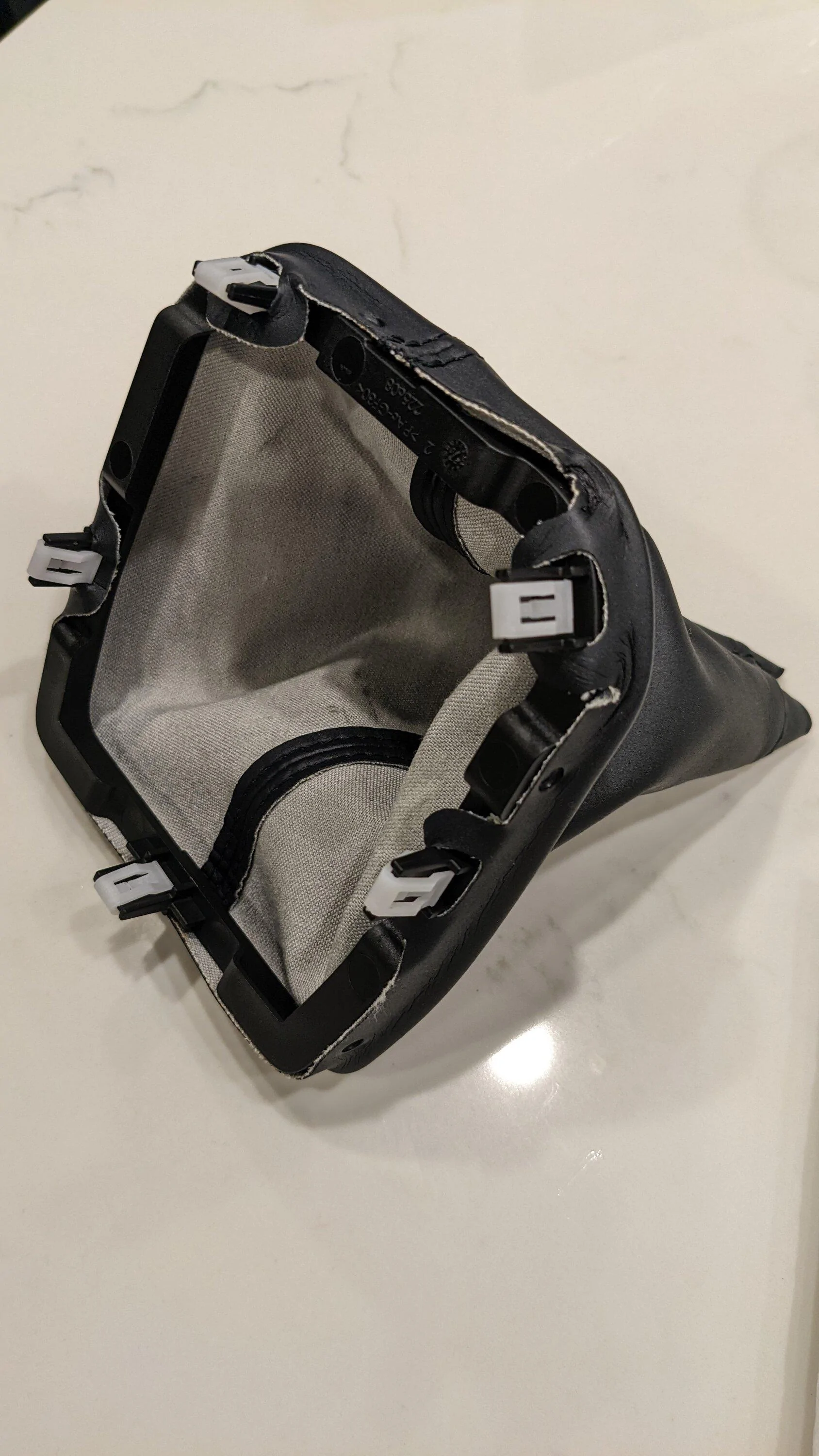

I am working on making my own custom leather shift boot. I've got the thing disassembled, next step is to cut it all apart and from there I can make a pattern from which to cut new leather. When I have the pattern I will send it to redline so that others can benefit from it.
You’re my hero!

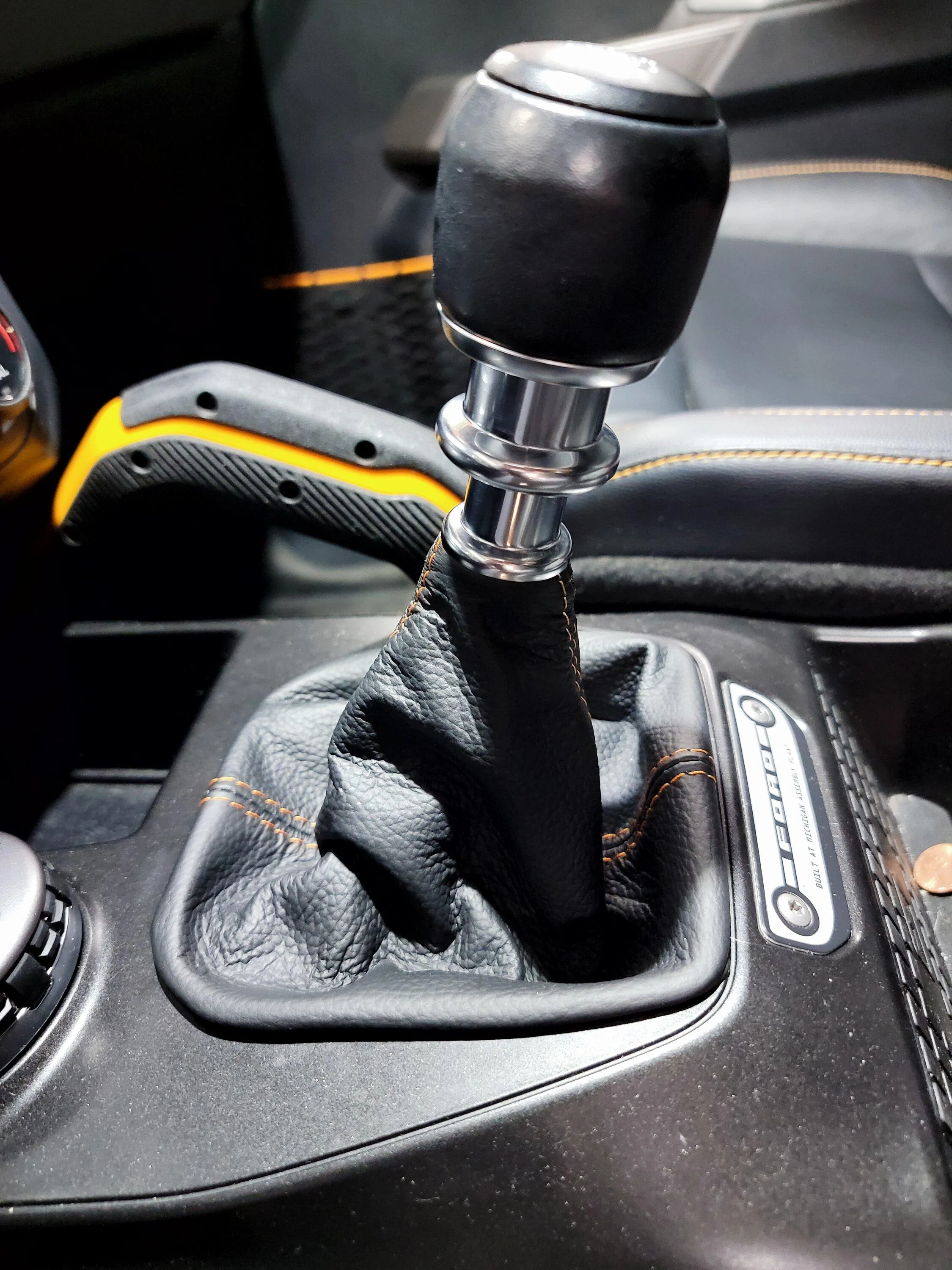

I just placed pre-order through Redline. They were extremely communicative. I ordered regular black leather with orange stitching to match the seats. Will upload pictures once received and installed $49. You need to contact customer service and they will send a custom order form for pre-order which is discounted.
