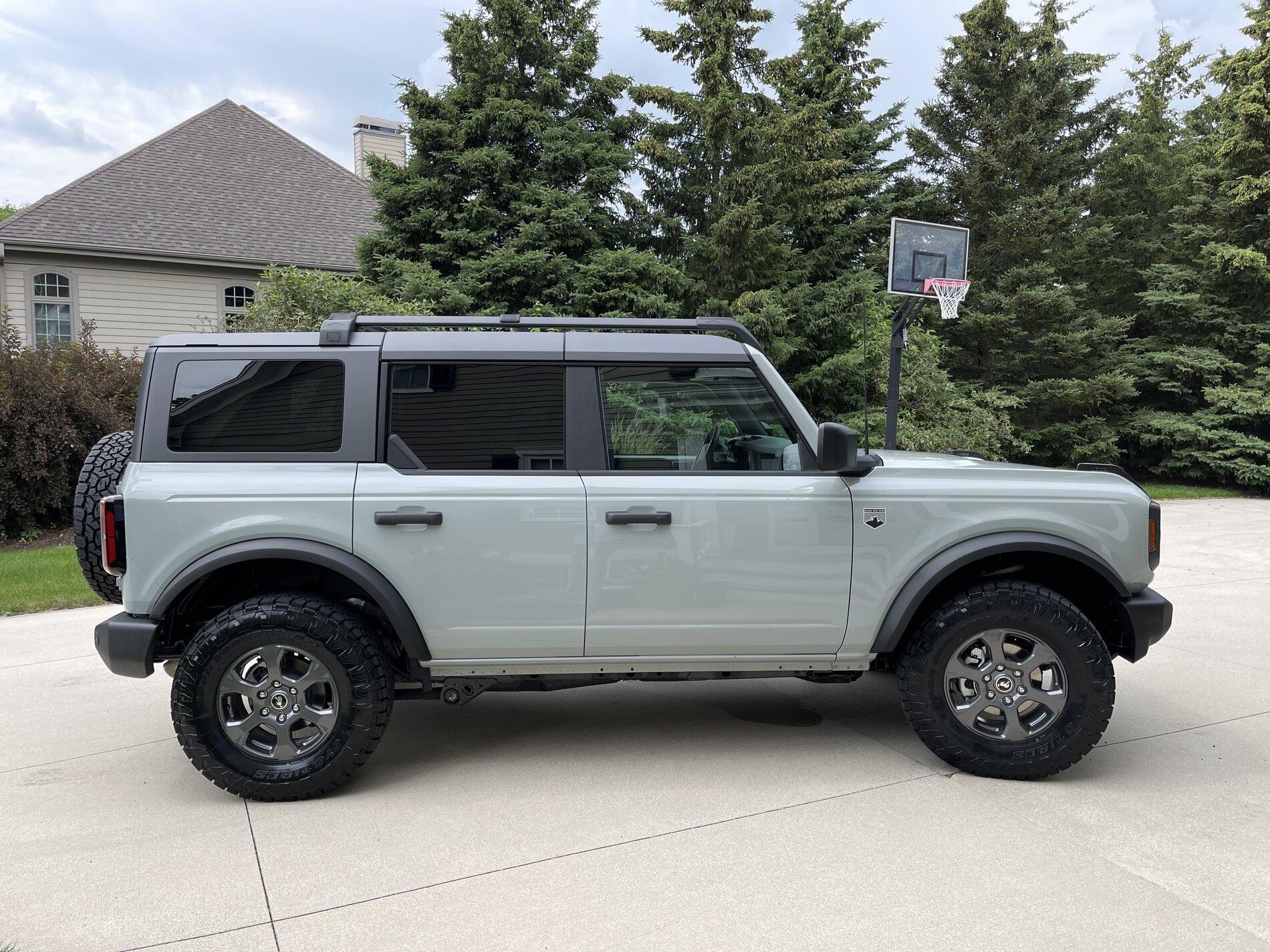

I had Cooper AT3’s 33” on my CJ and thought they were great. I would love to put them on my OBX - would really like to know the exact size of the tires that person put on. I have seen other threads on B6G projecting that 275’s is max on the OBX without any additional work having to be done. Curious as to whether that is accurate.
I just found the facebook post for this OBX and the owner confirmed it is 275/70/18. Which is:
OVERALL DIAMETER 33.23
According to the manufacturer.
Thanks for the nice detective work. That is what i was targeting but nice to have a confirm on the size that works. Those tires do look nice on the OBX.

Sorry - typo - meant to say 275/70r18s was what i recommended a few months back in cooper at3. coming in at 33.2"

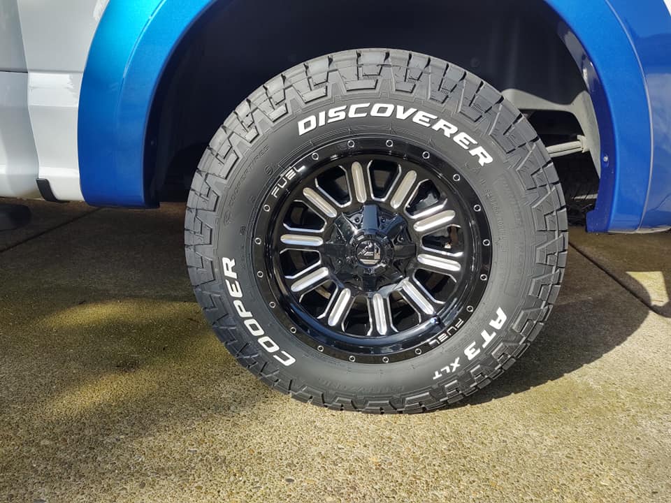

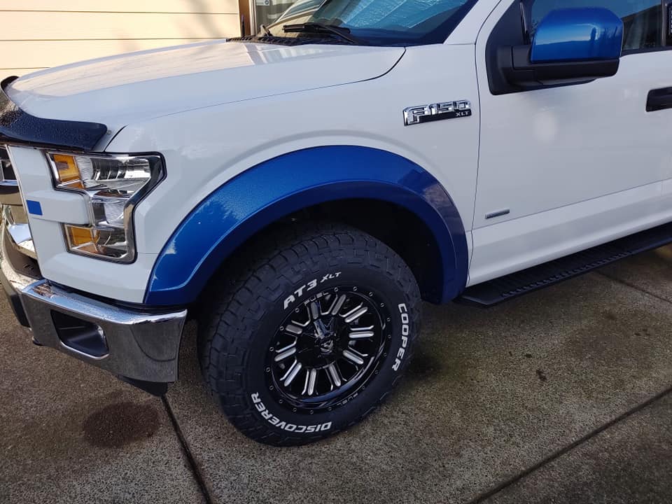

The wheel is an 18" wheel up from the Black Diamond's 17. The tire will be a 265/70/18 (OEM is 265/70/17). Wheel will be 18/9 +20mm offset. I already have hubcentric rings for the wheels 106mm wheel bore to OD 93.1 Hub ID. I have these tires (same size) on my F150 and love them. IMO, the raised white letter and this wheel will look great on my 2 door BD in cyber orange. Here is a photo of my F150 with a different style of Fuel wheel:
