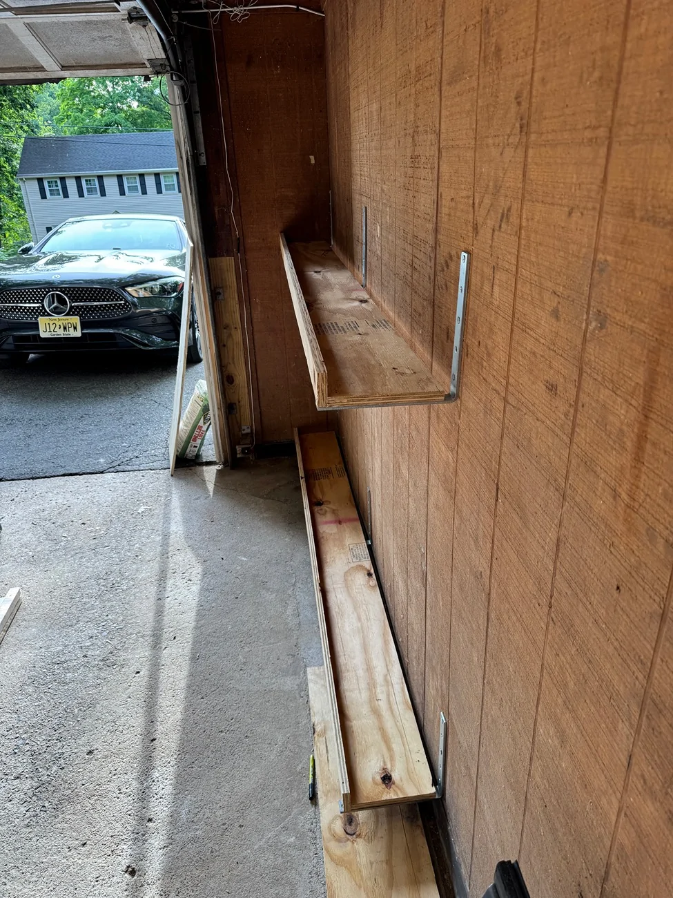

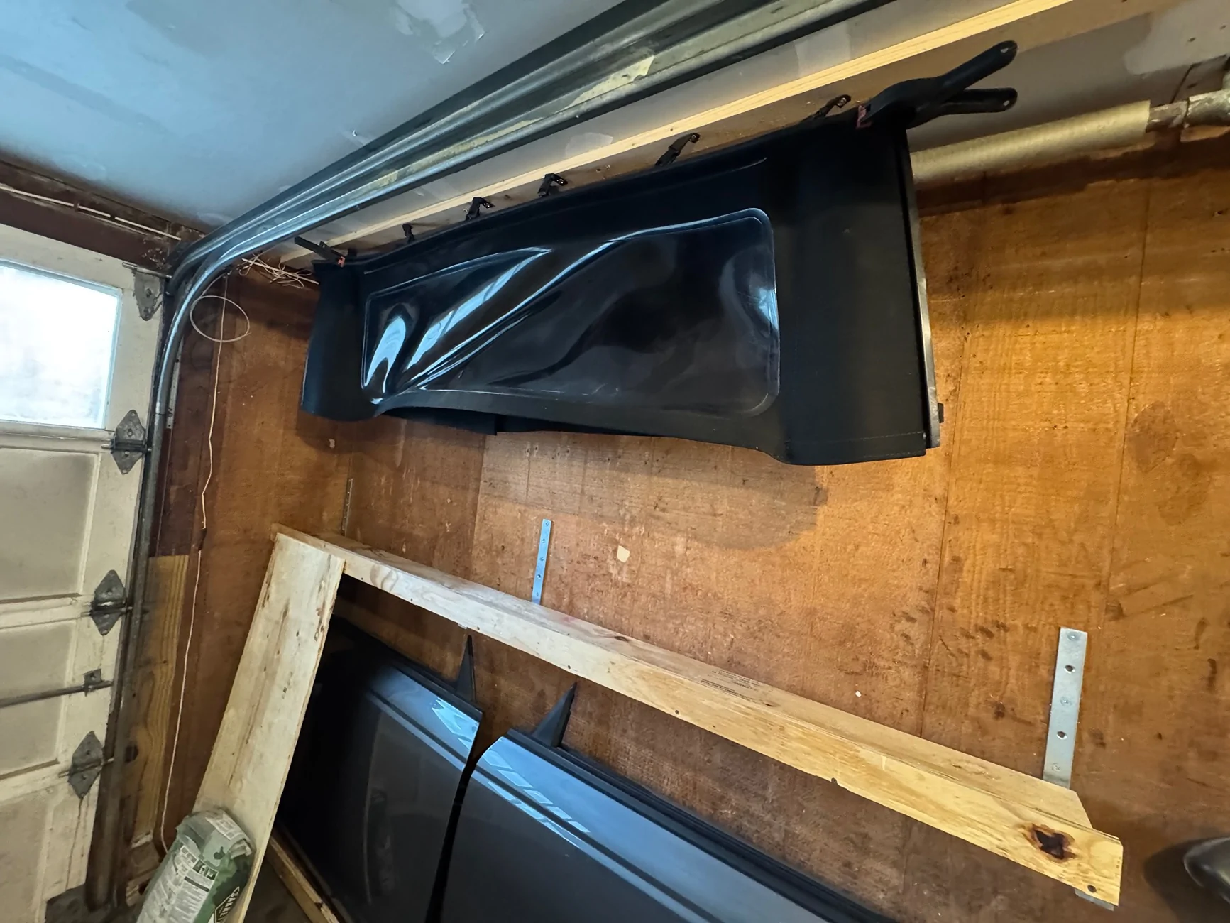

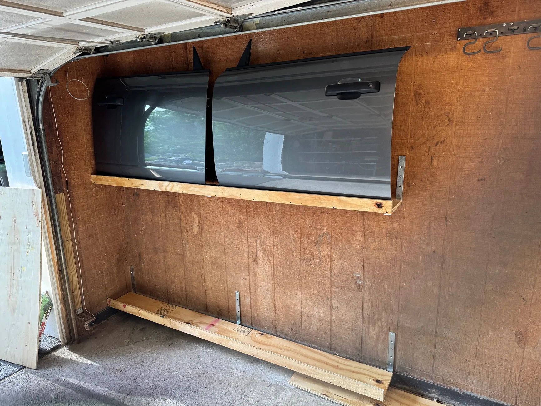

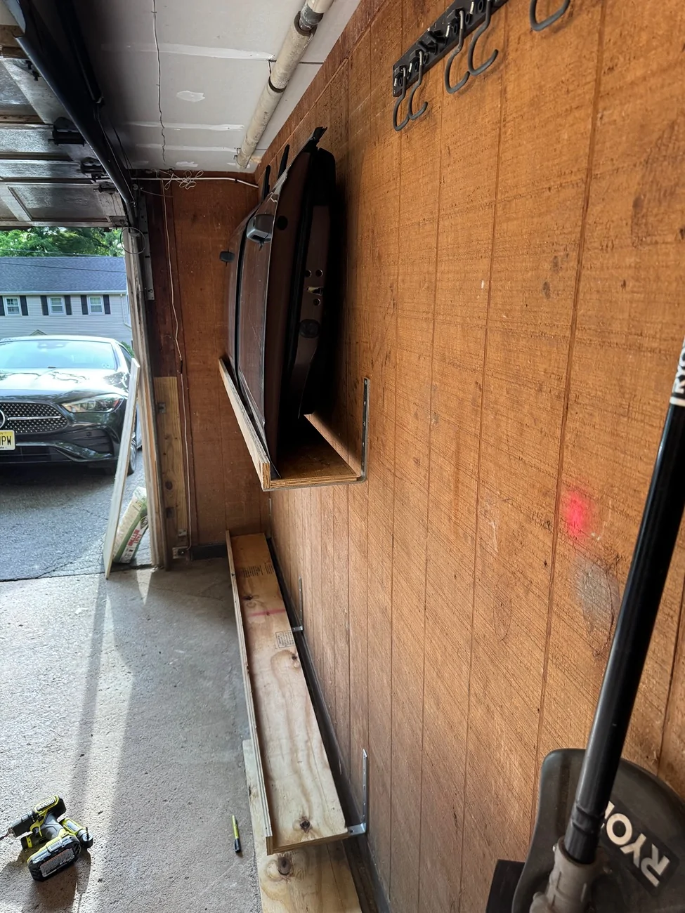

about 3/4 done.
3/4 plywood shelf is 8-1/2” x 88” with 3” lip. Probably will do some kind of carpeting to cover all wood.
#14 shelf anchors are through plywood into cinder block
probably will put rear doors on top shelf instead.
Ford Bronco Simple and inexpensive door storage IMG_4232
Ford Bronco Simple and inexpensive door storage IMG_4234
Ford Bronco Simple and inexpensive door storage IMG_4233

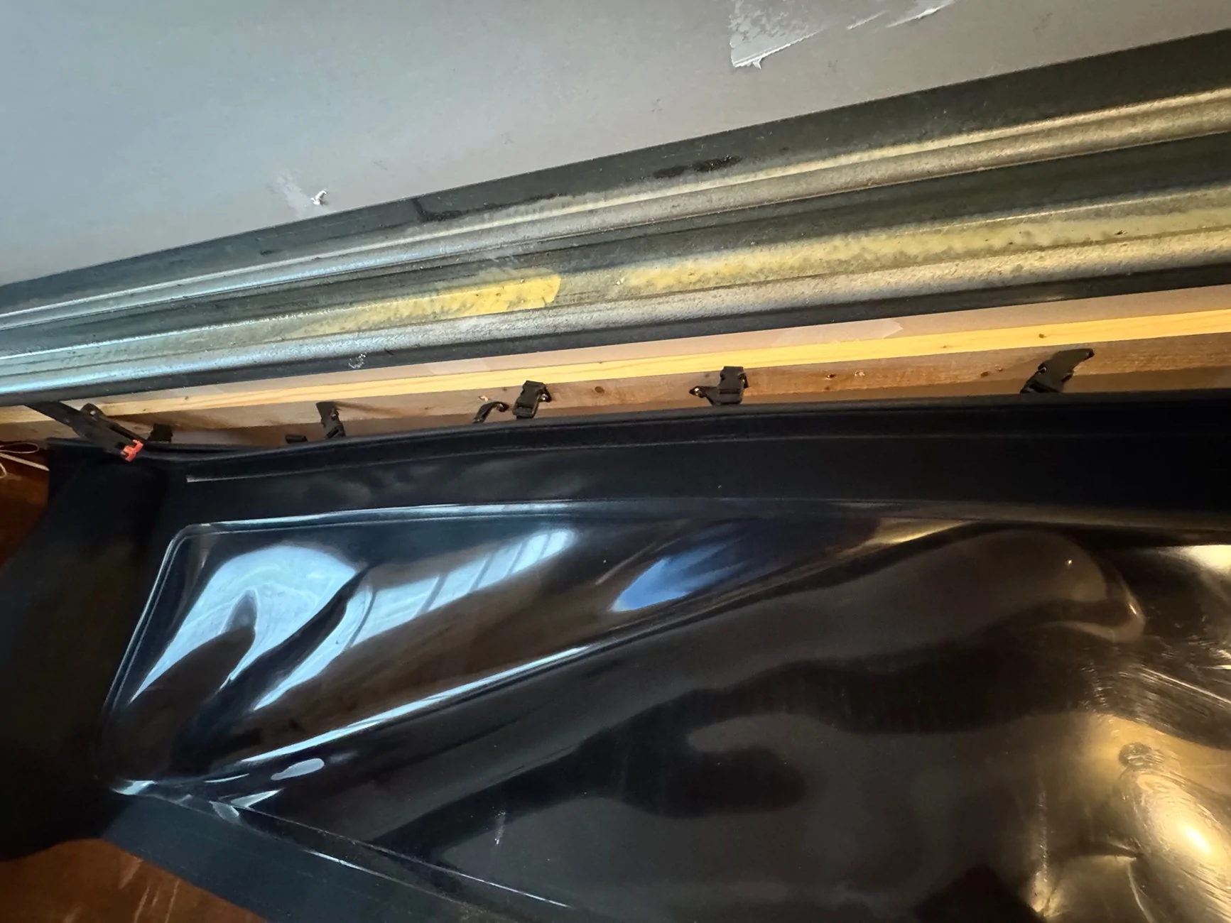

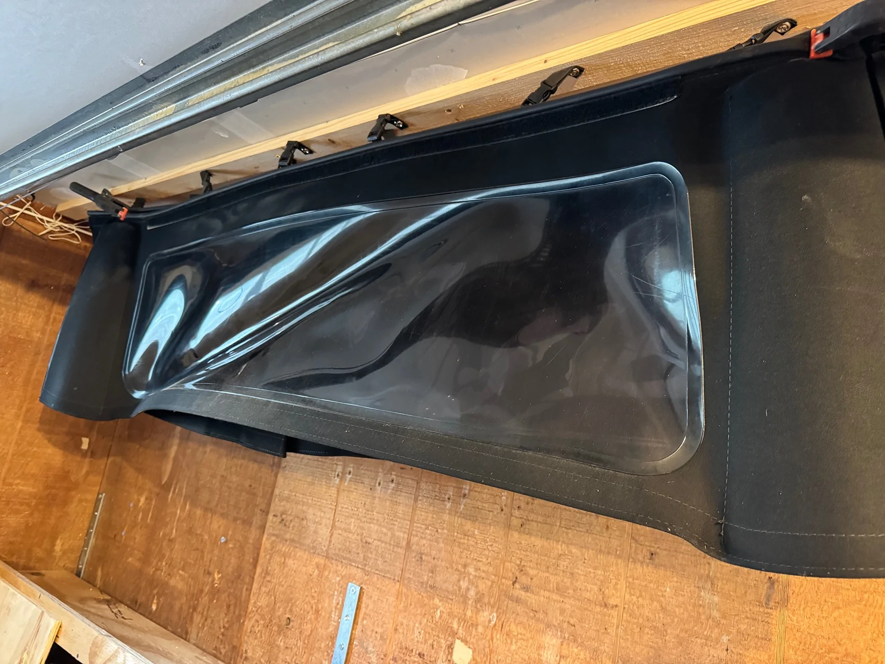

Also. I took a 1x5 and spaced out buckles with some webbing to hold windows. Works pretty well.
Ford Bronco Simple and inexpensive door storage IMG_4243
Ford Bronco Simple and inexpensive door storage IMG_4244
