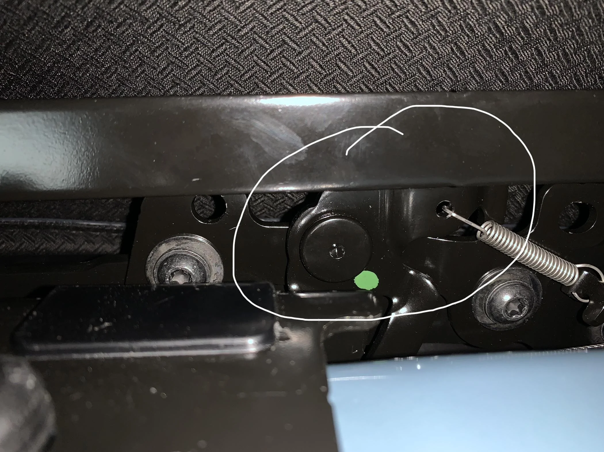

Hi all, my soft top has been clicking while driving and I’ve heard it over my right shoulder. I eventually narrowed it down to the area right over the rear passenger side window and found a pice that feels loose (it’s the piece that’s circled in the photo with the spring attached to it). It doesn’t look like there’s a way to tighten it back. Anyone else have this issue and/or would anyone be able to check their soft top to see if this feels loose?

Yes. I have a clicking sound coming from the rear too, but I think it's coming from all the way in the back where the top meets the rear window. I haven't been able to figure out the cause of the "clicking" noise yet. As an aside, the same piece that you mentioned and showed is loose on mine too and only on the right side. I don't see a way to tighten it up, but I haven't really looked into it yet. In my case, I don't think this is the clicking noise coming from the rear of mine.

You can adjust that peice upward to make it tighter

Won’t it just fall back down? There’s a lot of slack left to right.

It's 2 T-30 bolts on the side of that peice just loosen pull up a little and tighten back. There shouldn't be any movement right or left, just up and down.
