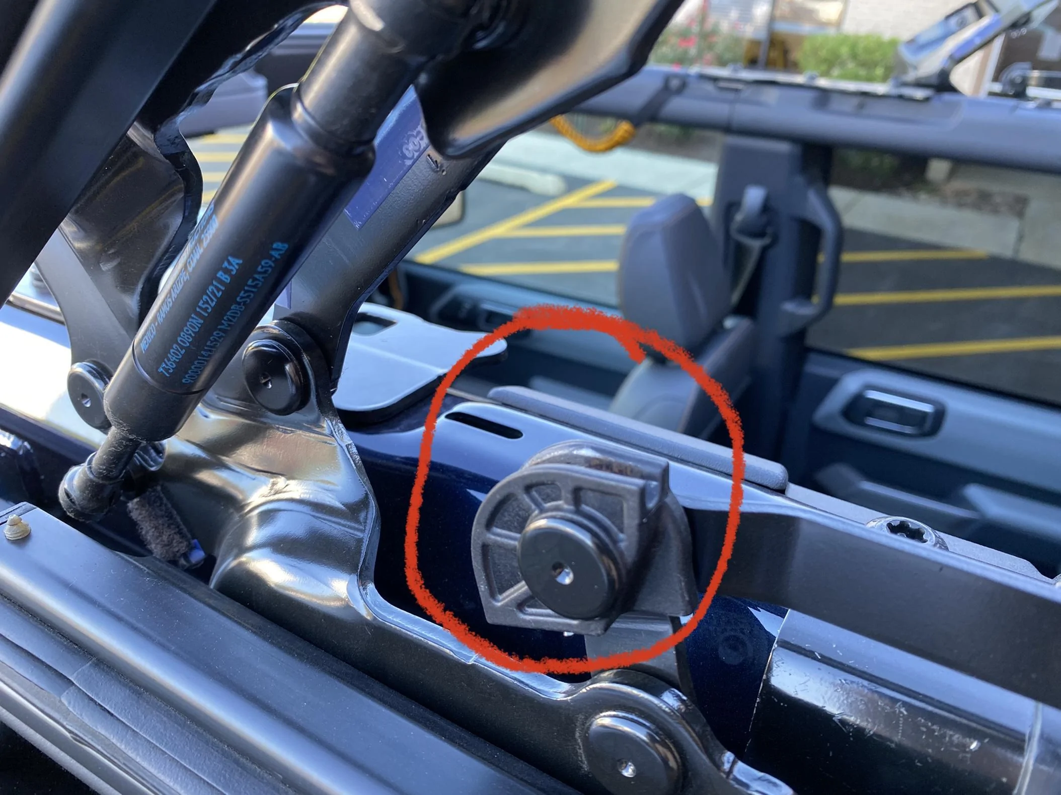

I use my soft top in position 1 daily or whenever it isn’t raining. I finally located the non stop squeeking to this fan-shaped “catch” above the rear window.
Ford Bronco Soft Top Sqeaks while downs F34556C3-4E9C-443E-B77E-B24A06574AB5
Added some petrogel lube inside the catch and that solved it for me. The catch looks like it’s made from some type of glass reinforced plastic. There were some wear spots on the inside causing the noise.
Hope this helps.

Anybody land a solution here? Getting nowhere with my local Ford dealer about the incessant squeaking that occurs when soft top is folded down in first position. And yes, I've tried the straps, which don't make it stop.
