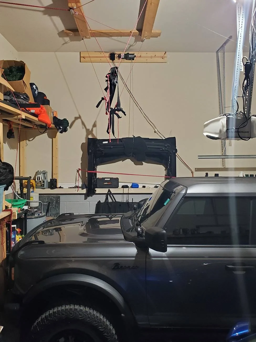

I store mine the same place as where I store the hardtop in the summer! just have a platform the soft top and windows are strapped to and then it’s pulled up to the ceiling. Then when you swap tops you switch them out.

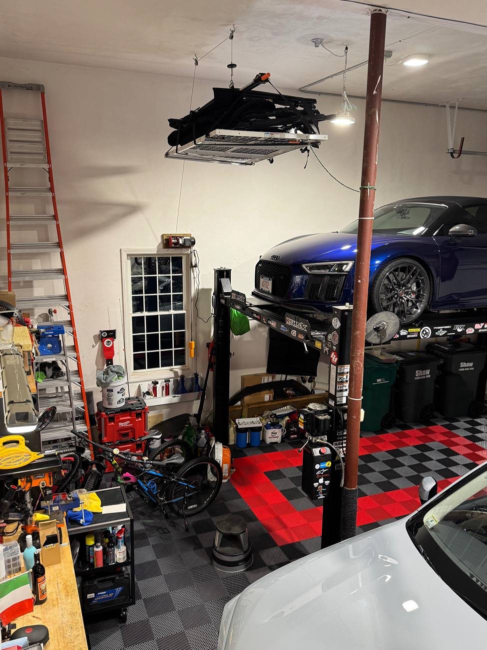

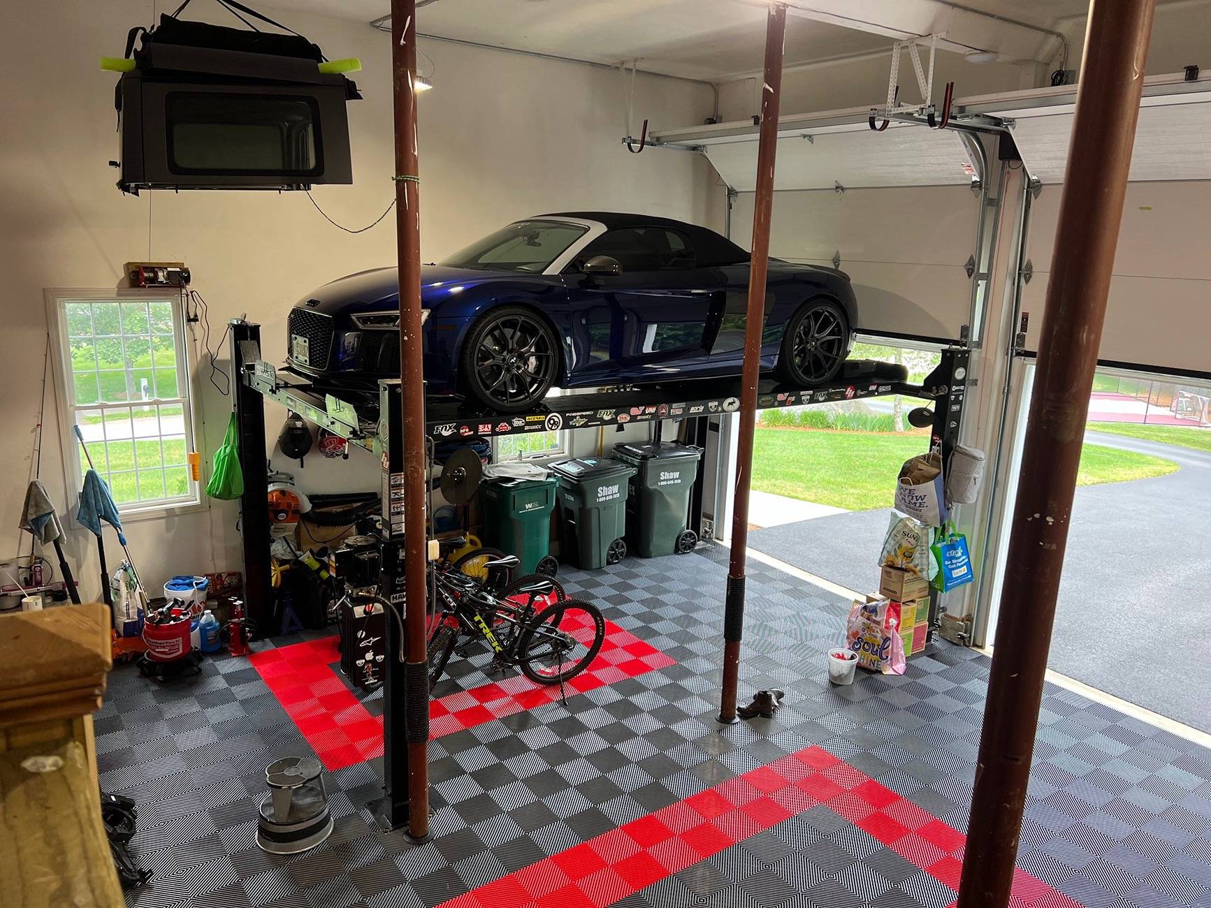

it’s not light! I think maybe 100 pds or so? It’s more awkward in shape to carry around more than anything! I use a jbarr pole and strap and it says on that to have no more than 270 pds attached to it and both the hardtop and soft top has been stored this way for 2-3 years. Here the hardtop on there as well.

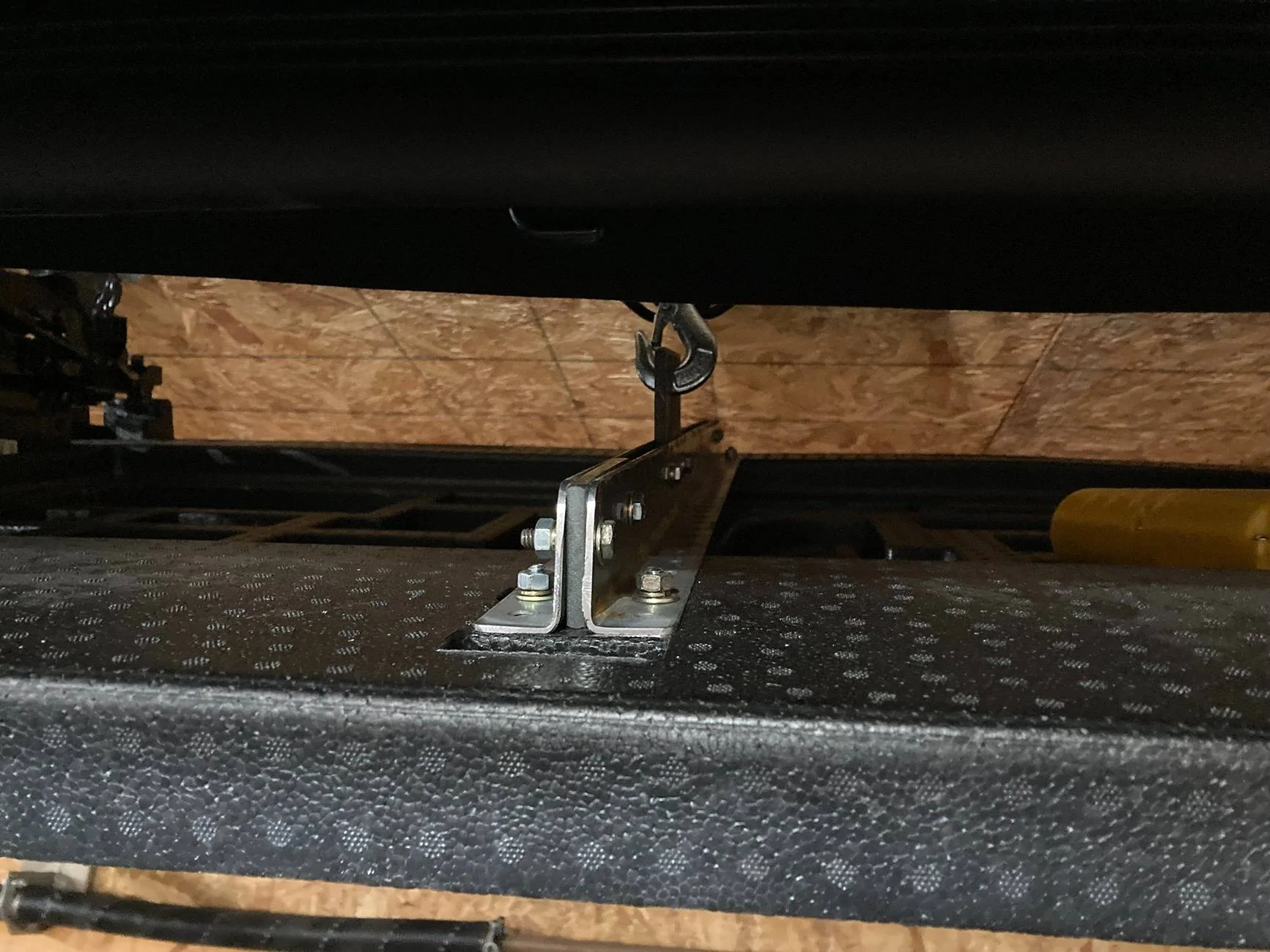

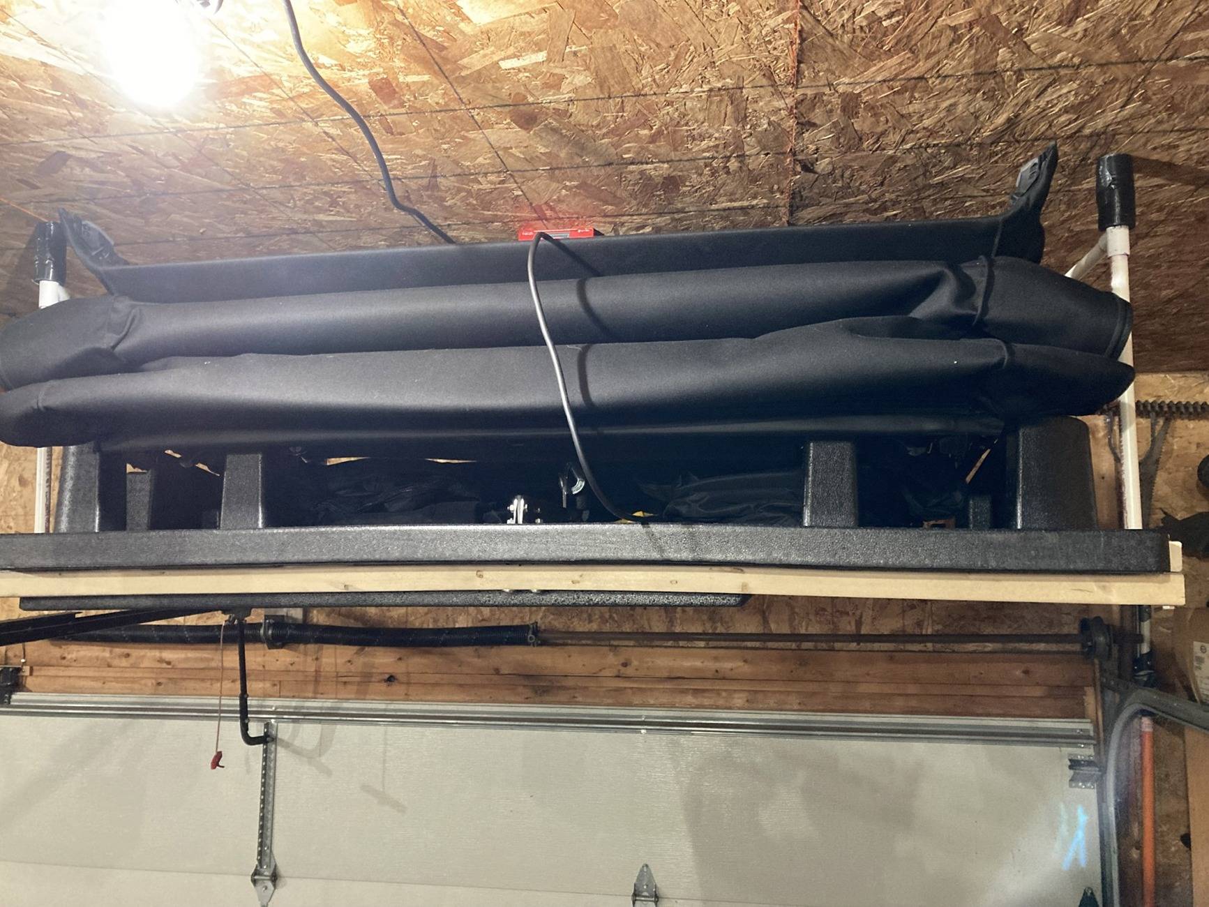

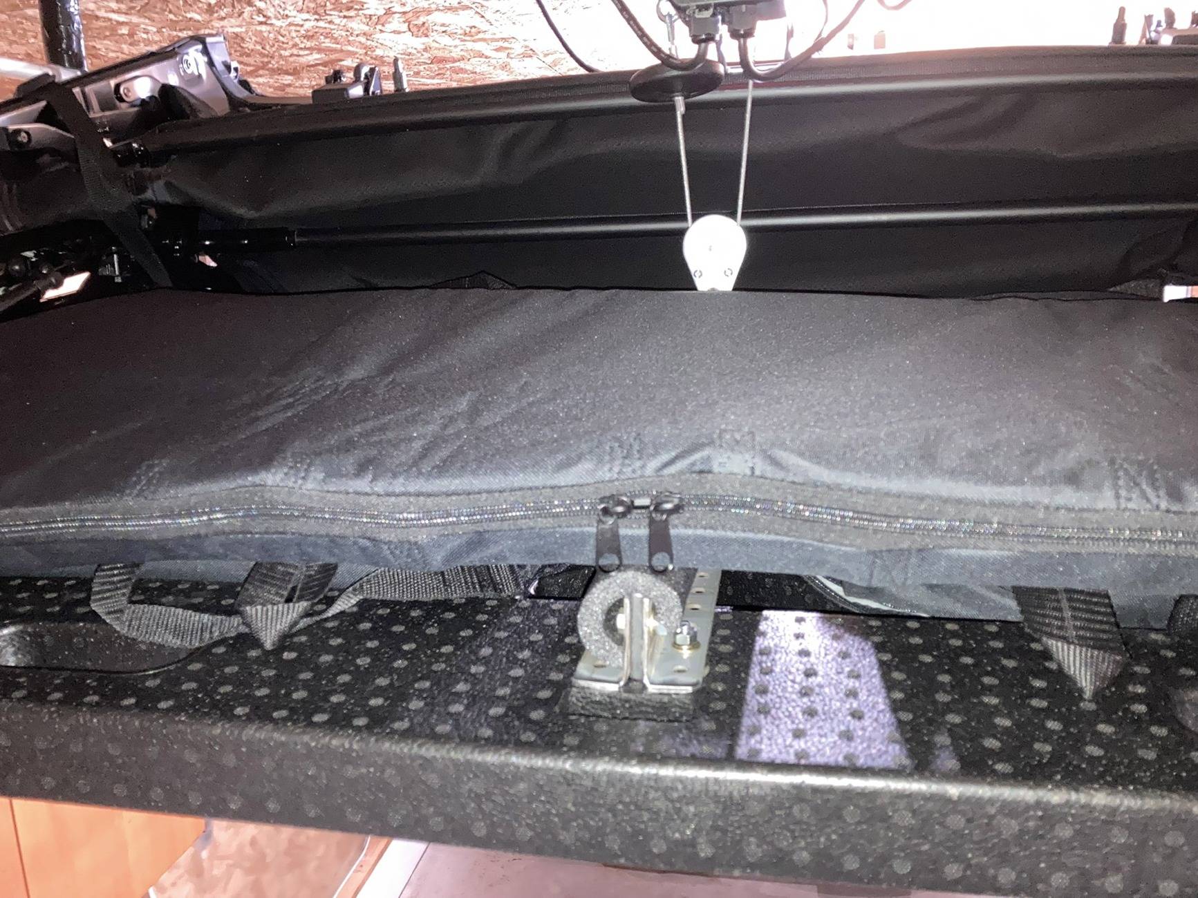

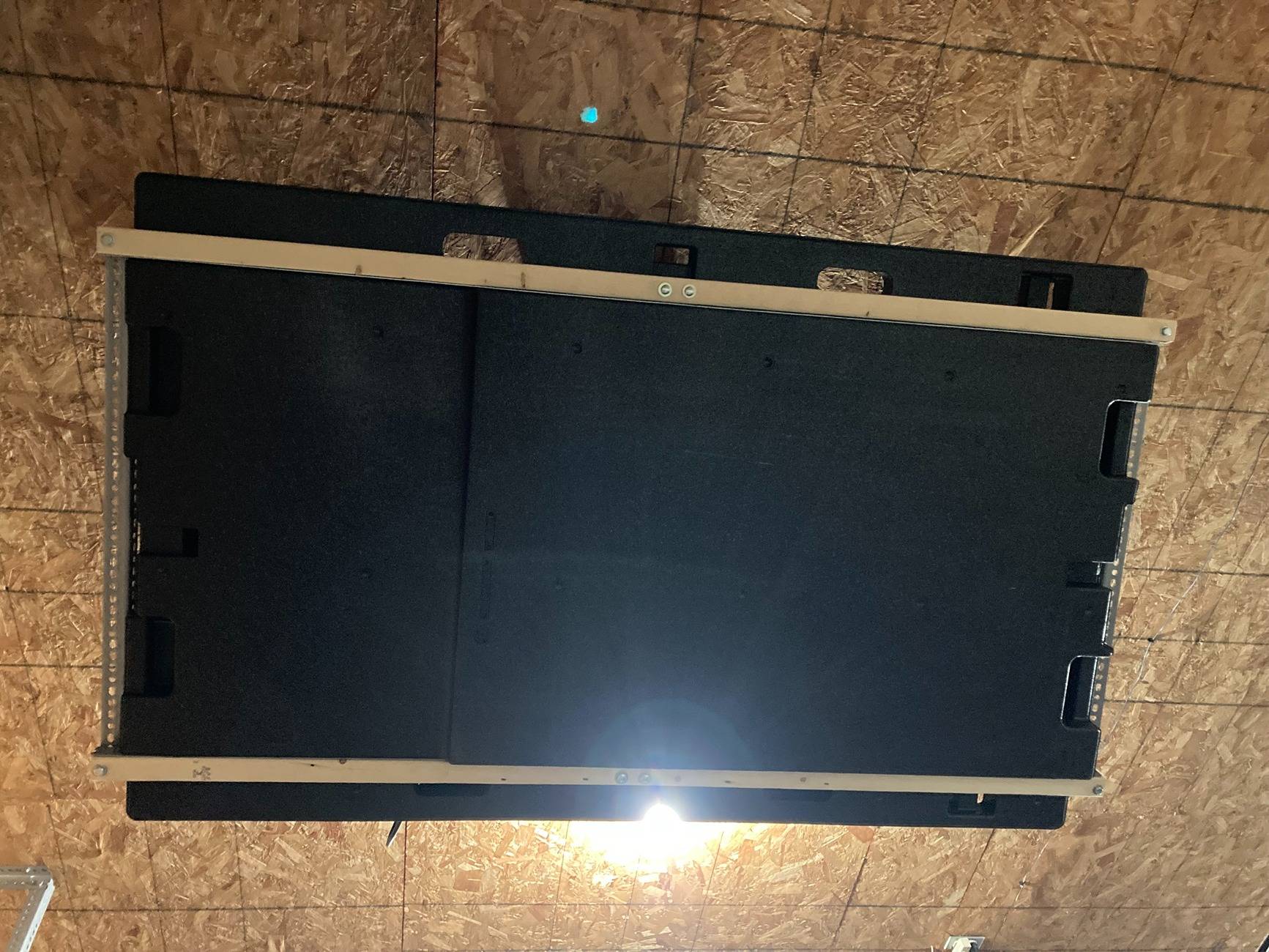

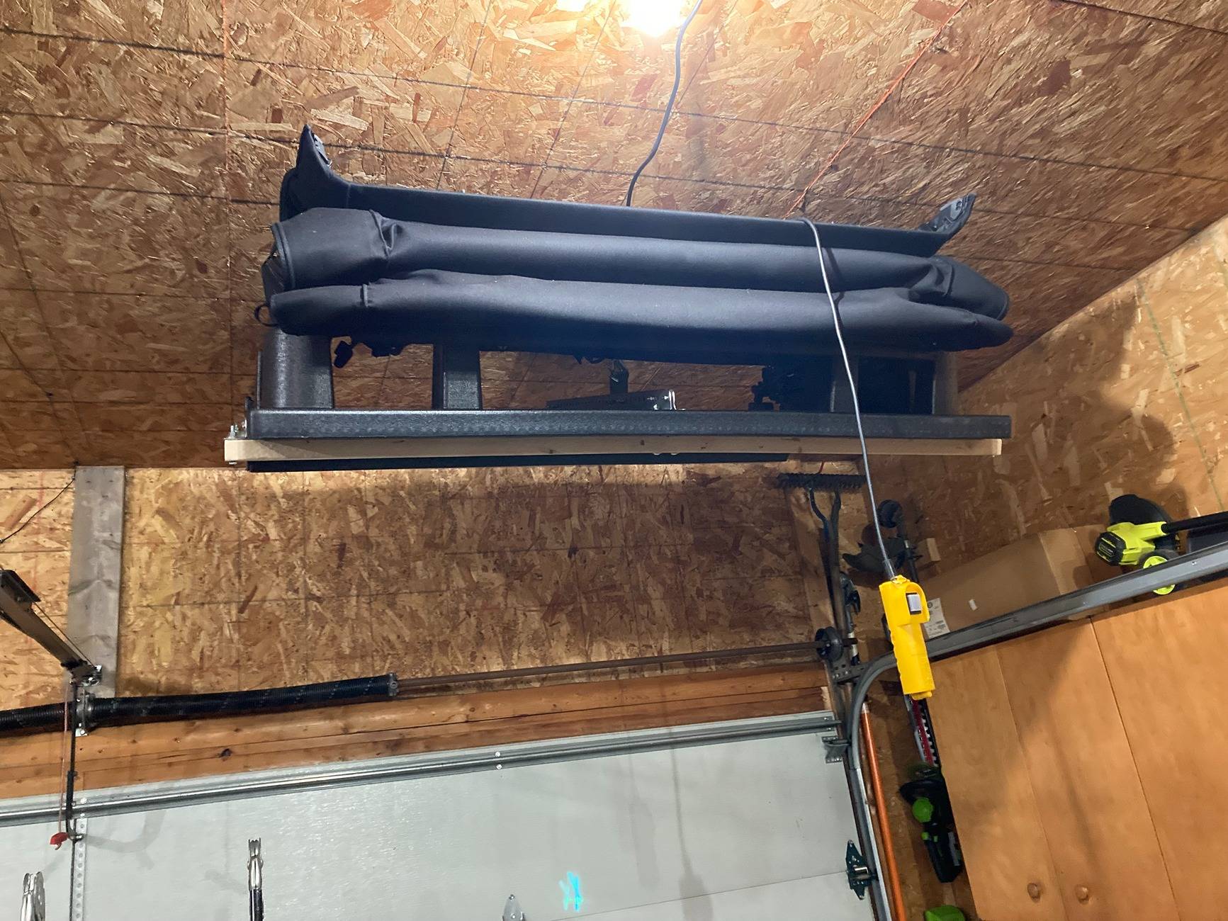

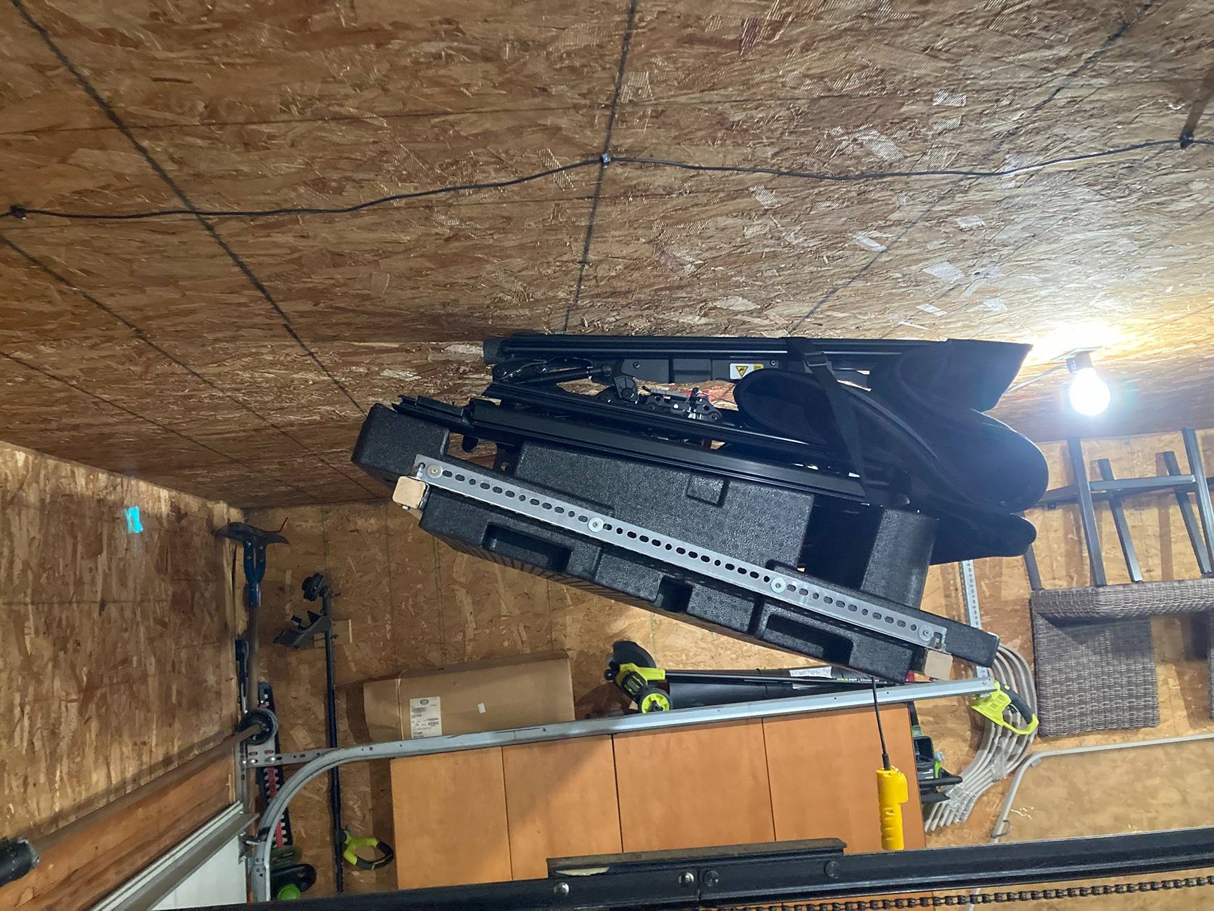

For my Dual-Top Bronco's Soft-Top, I bought the $100 Pittsburgh 440 lb. Electric Hoist from Harbor Freight and made a cradle out of 1.5x1.5x14GA slotted angle, 1/4x4" Flat Steel, & 2x2 lumber from Menards for the foam platform it came on ... cost under $190 for all the parts.
I'll post details in a separate thread I plan on doing soon. It is not quite done as I plan on adding more 2x2 lumber to the end angles so I can add 1/2" PVC pipe stop-frames so it hangs level.
Just felt this foam shipping skid was a nice storage platform and did not want it going to the landfill.

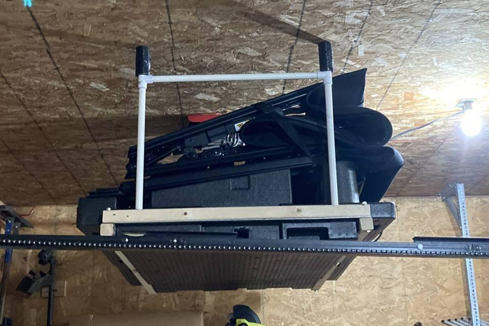

Revised my framework (added 2 more 2x2 boards & 1/2" PVC piping stop frame so it stops level with ceiling) and now have my 4 Mabett Door Storage Bags and the Mabett Soft-Top Window storage Bag stored on it as well.
It takes 2 people to guide it up & down due to the single point lift, but I can live with that.
