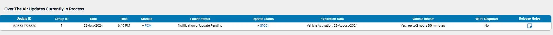

Oh, I can relate. I'm also tuned so I have auto-updates off for the same reason. They're trying to ram one down my throat right now. lol
Ford Bronco Software update next week?? 1723311383283-s7
If the GWM is showing for you, then you're fine and not affected by the issue.
