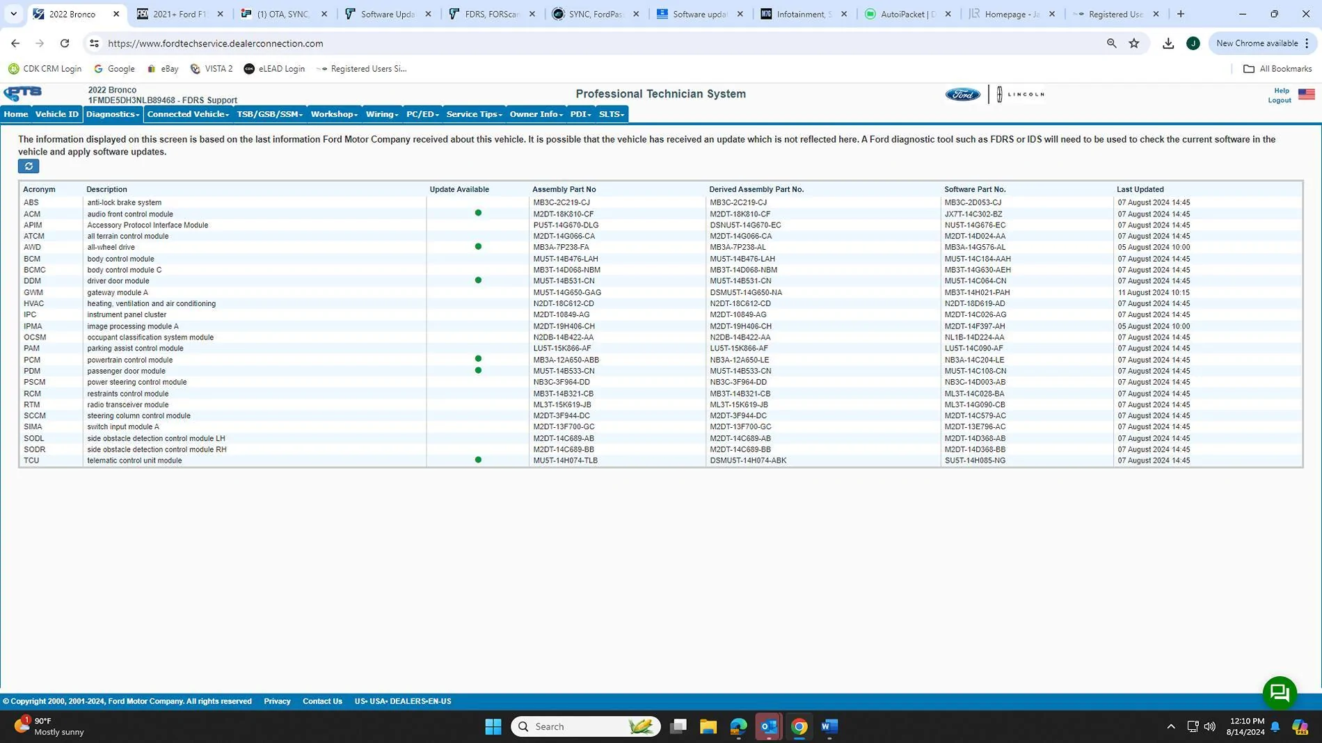

To check what modules have pending updates, someone would need to run the VIN through PTS or FDRS to check. Message me the VIN and I can do it for you.
My VIN - 1FMDE5DH3NLB89468

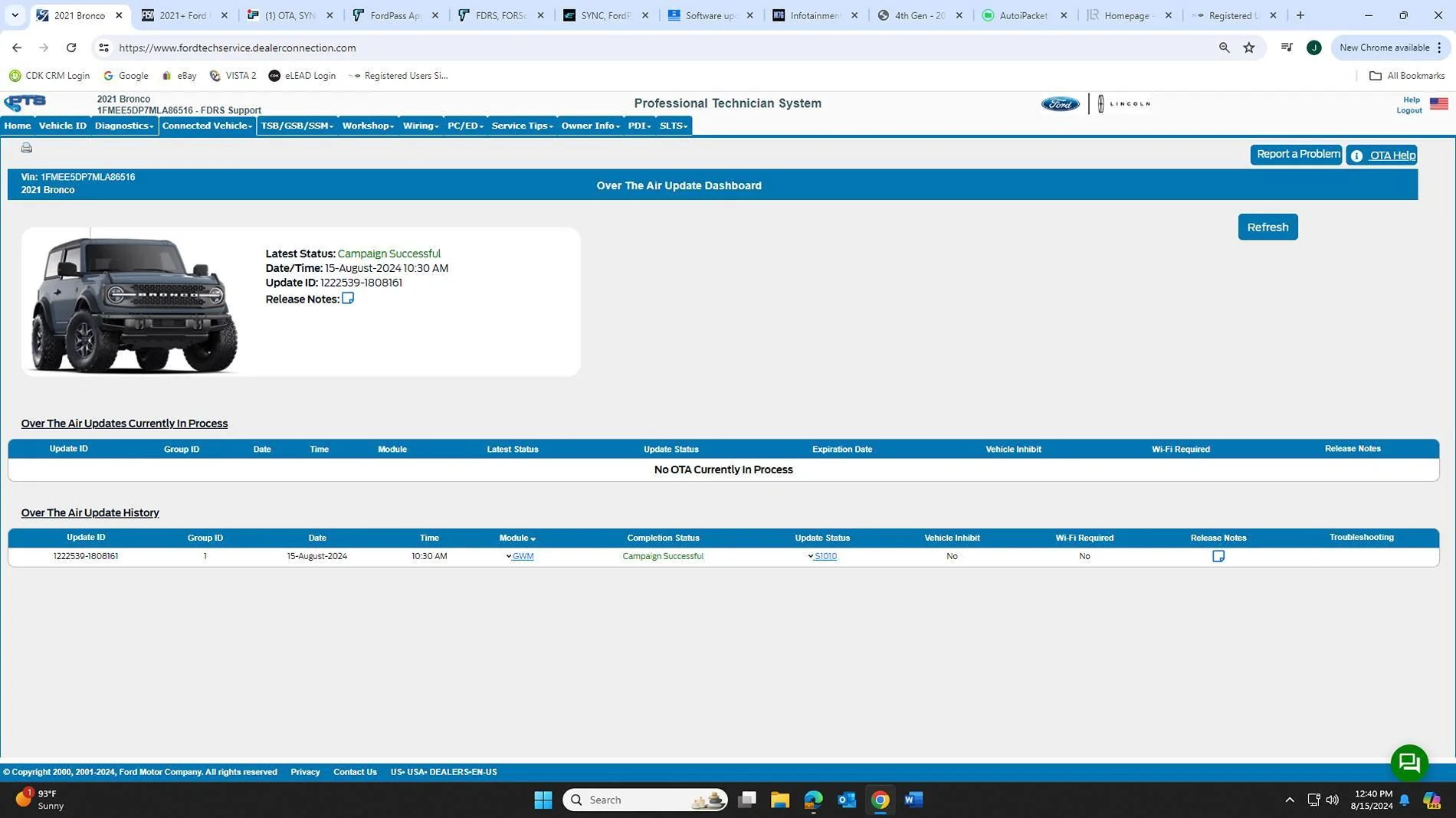

Your truck is on Sync 23159 which is one version behind the latest one. You've gotten 4 updates between June and now; last one being 6.1.0 a week ago. The truck is not reporting any codes and seems very happy in that regard. Modules with pending updates are marked with the green dot in the screenshot below. The TCU update at the bottom of the list is the next one you need come in before the next APIM/GWM will be released on the server for you to get the final Sync update you need to be up to date as far as those modules go. IMO, nothing to be concerned about here in terms of updates.

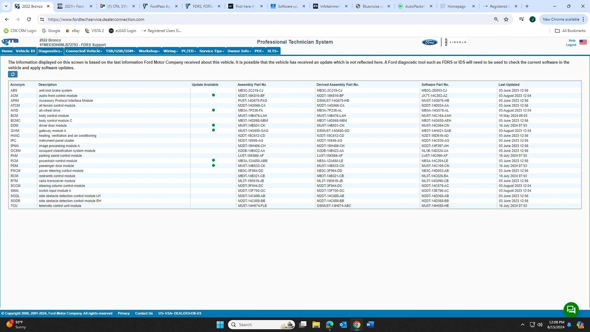

Could you take a look at VIN 1FMEE5DH0NLB72793 for me please?
I recently found out last week my sync haven't updated since 2022 (I'm on 22082 Revision 411). I have Scheduled updates turned On and It's connected to my Home's WIFI.
I purchased my truck brand new on 2023 but it is a 2022 model that sat on the dealership for too long. Maybe being turned off for so long has something to do with the fact it is not getting updates?
Thanks in advance!

Yes, the truck sitting will 100% have an adverse affect on getting updates. Due to the way the OTA's work, once an update is sent, the vehicle MUST be started within a 7 day window in order for the vehicle to ping the server back and initiate the update process. In your case, your OTA dashboard is blank which means nothing has been sent to you in the past 60-90 days; I cannot see OTA history passed that as it is not recorded in PTS. Modules pending updates are below. The GWM you see there is the one you need to come in for more updates to be released for you.

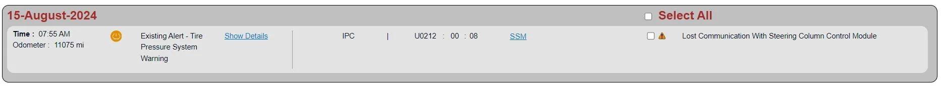

Btw, your truck is consistently reporting this code. The SSM it references is attached. If your truck gives you random messages about certain things not working, it could be due to a loose connection. If your truck is not giving you any issues, then you can ignore this.

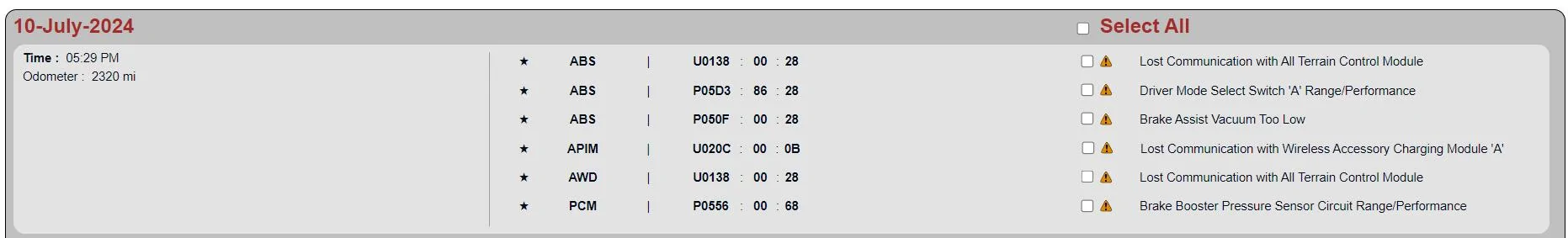

Just curious how these updates work. I have not received one OTA update yet. I have a 2024MY (1FMDE8BH0RLA31888) and brought it in for service at 2,000 miles because i got a "Service brake system" notification while on the highway. The dealer said it wasnt actively throwing and couldnt reproduce, so they did nothing. I had a list of things for them to check as well, like how often the sync system needs to be reset. They said that they did some updates on the sync, but on the invoice provided, what was told to me on the phone didnt match with what they had listed. And my first start of the bronco, i needed to manually reset the sync system because of black screen, so im not sure they actually did anything. Do these updates always get checked when you bring the truck in for service? Or only when the update is related to the service issue you are reporting?

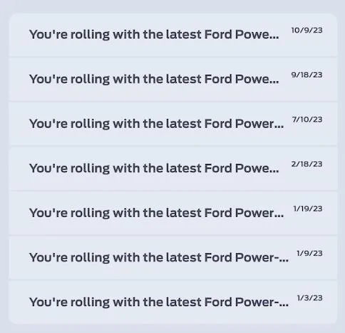

Curious, I'm a 2021, 40K miles. 1FMEE5DP7MLA86516
I have not had any updates in 2024 pushed to me, that or the messages for them didn't save in FordPass.

As far as updates go, you have a 2024 so your experience will be very different from what you ready about here. Your truck was built with the latest software already. You are only showing three pending updates. You haven't been sent anything because there is very little to update on your truck for now.
As far as the brake warning you got, I assume it was these random codes reported by your truck. It happened on 7/6 and again on 7/10. The dealer is right, though. The codes went away and have not come back. You have not pending updates for any of the modules mentioned below, so there is nothing for them to do. However, they didn't update any modules while the truck was there. It is possible there weren't any updates showing for you a month ago when it was there.
Ford Bronco Software update next week?? 1723739827839-o9
Ford does not pay dealers to update modules just because they are out of date. The dealer will only do them as part of a recall or if the module updates fixes a particular customer concern.

You just got 6.1.0 a few hours ago. :ROFLMAO:
