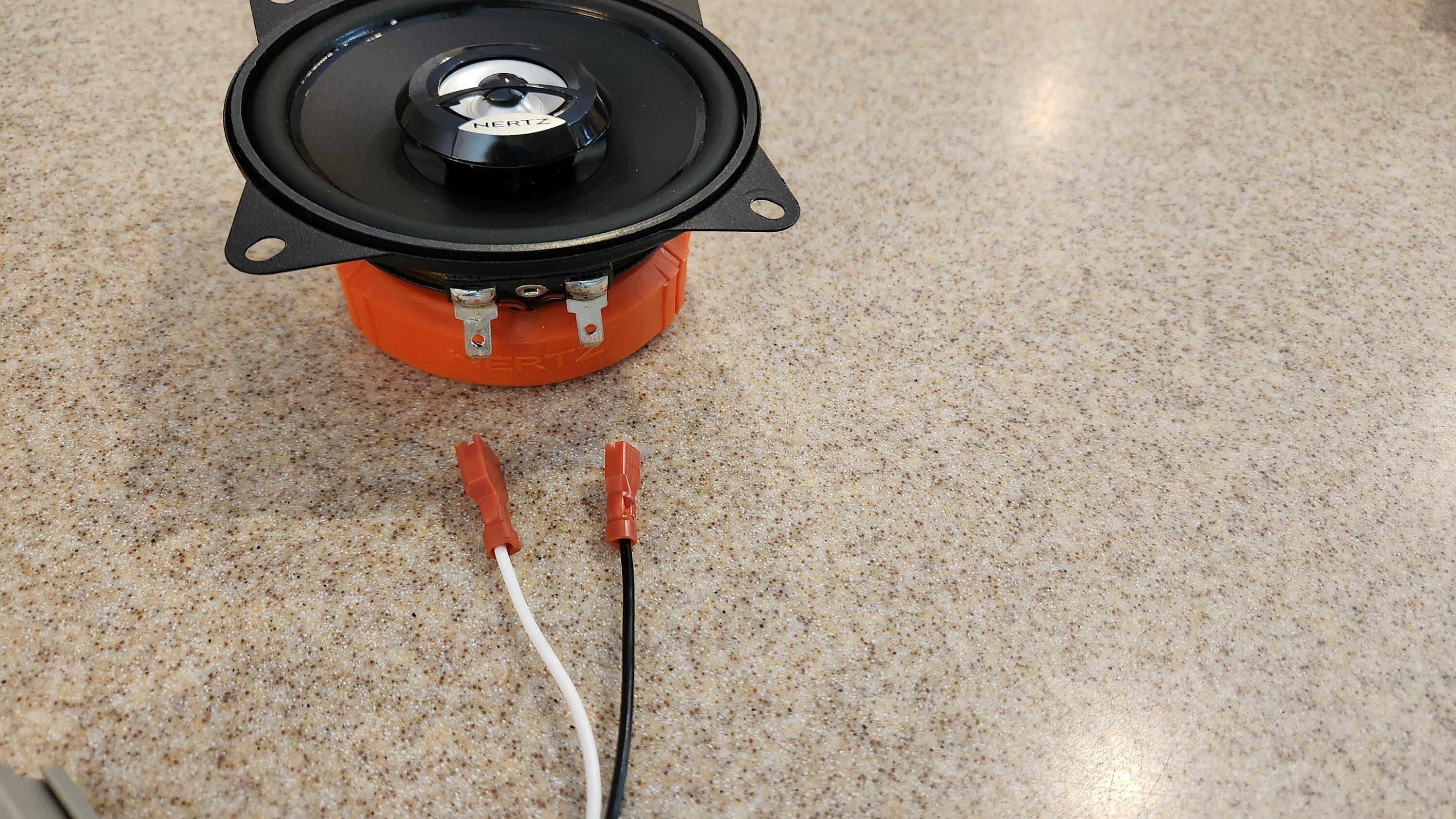

I installed the PRV to my center BO speaker just fine, I was hoping to use the same harness for my Hertz 1003 but the connections are sized differently.
Can anyone link to amazon the appropriate wiring harness?

I would probably just use side cutters and trim the negative post a hair

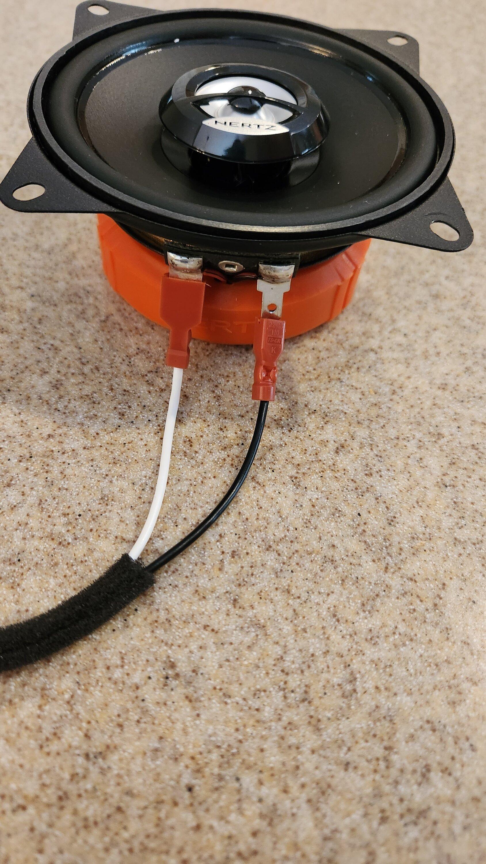

I ended up cutting the wire and finding some 22-18 female connectors. Had to get a crimp tool but it was easy.

I cut the connectors and just soldered the wire on all 4 of my Hertz
