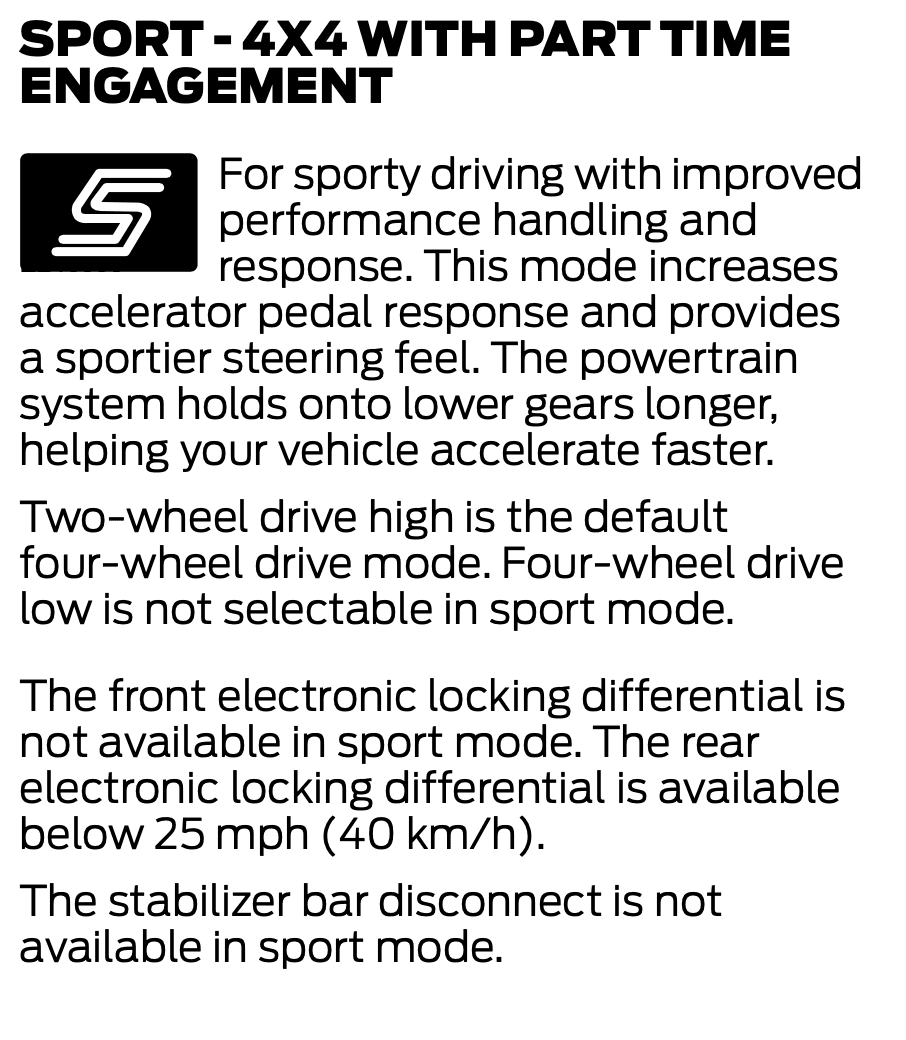

4A is the default in Sport mode
2H is the Default 4x4 Mode for SPORT. See Manual:
"For sporty driving with improved performance handling and response. This mode increases
accelerator pedal response and provides a sportier steering feel. The powertrain system holds onto lower gears longer, helping your vehicle accelerate faster.
Two-wheel drive high is the default four-wheel drive mode. Four-wheel drive low is not selectable in sport mode."

Yeah you can't use sport mode in 2H although you can, if I recall, switch to sport, which is 4A and then get it into 4H.
I use Sport Mode in 2H all the time. In fact, I have only every used Sport Mode in 2H. I do not have Advanced 4x4, thought it was an unneeded cost option.
