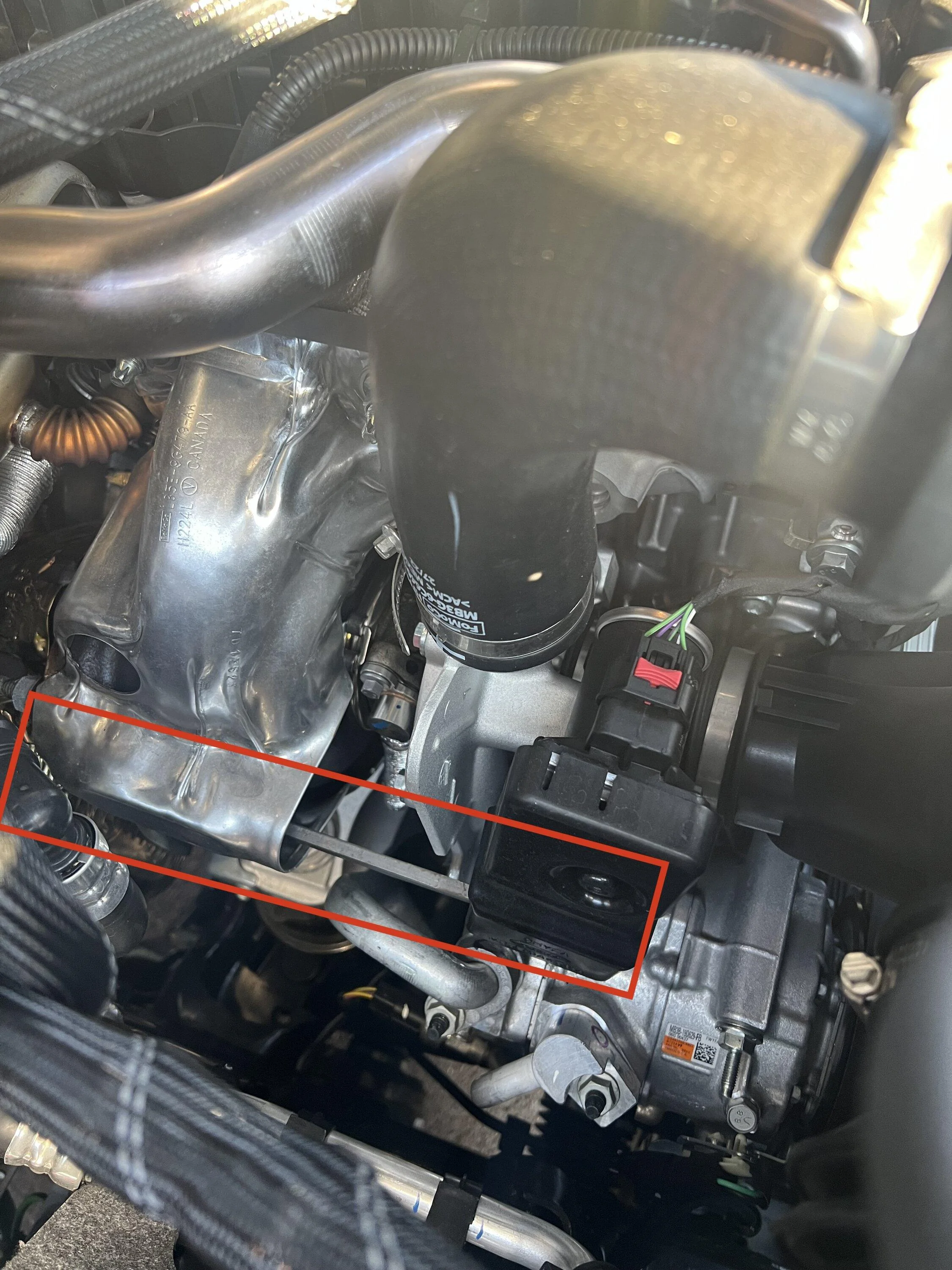

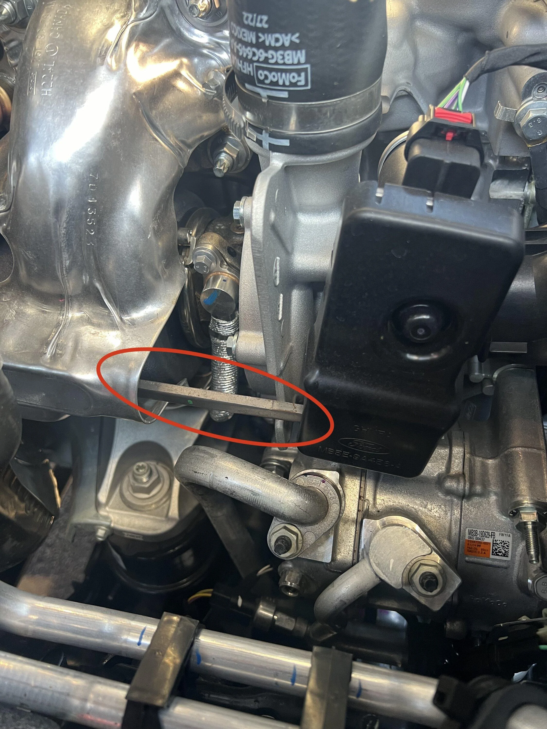

Hello -- I noticed a squeaking/creaking sound when I first turn on my bronco (it's been there since I bought it).
It appears to be coming from this thing... it moves back and forth and squeaks. I assume it's priming something or just warming something up but I don't know what it is. The bar in the picture moves back and forth intermittently while the vehicle is warming up for the first minute or two.
What is this thing? I'm wondering if I can get to it any maybe put a little grease on it or something but I don't know what it is.

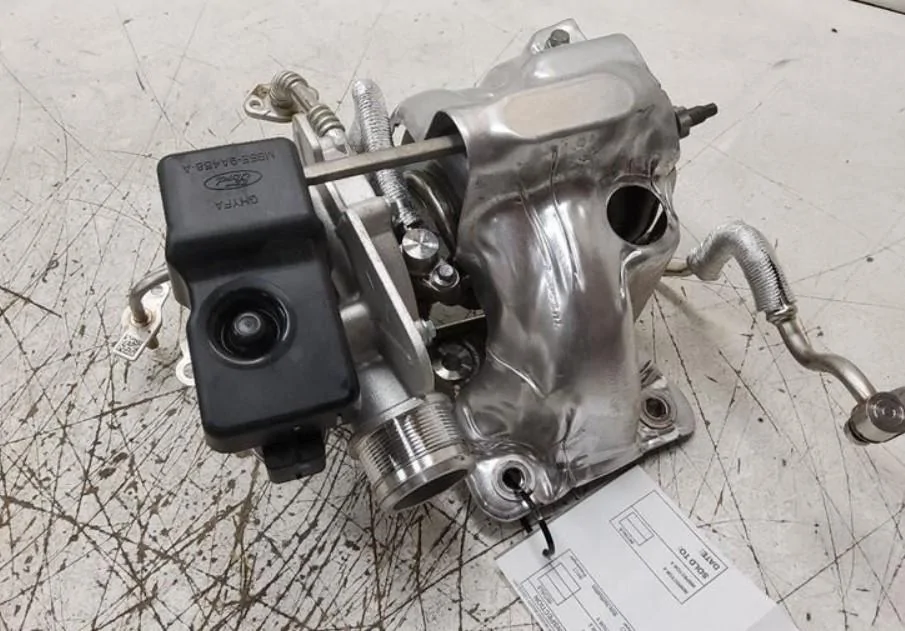

I'm pretty certain that's the wastegate actuator linkage moving. Too bad both sides of the arm are obscured with shrouds. The turbo side of that moving linkage typically has an exposed connection point that you could try greasing, maybe the noise would go away. Having a hard time deciding if the movement sound in your video is the vacuum, metal on metal, or both. Do you happen to have any mods or blow off valve? Check engine light? I vote the ECU is detecting an issue and trying to save itself.
