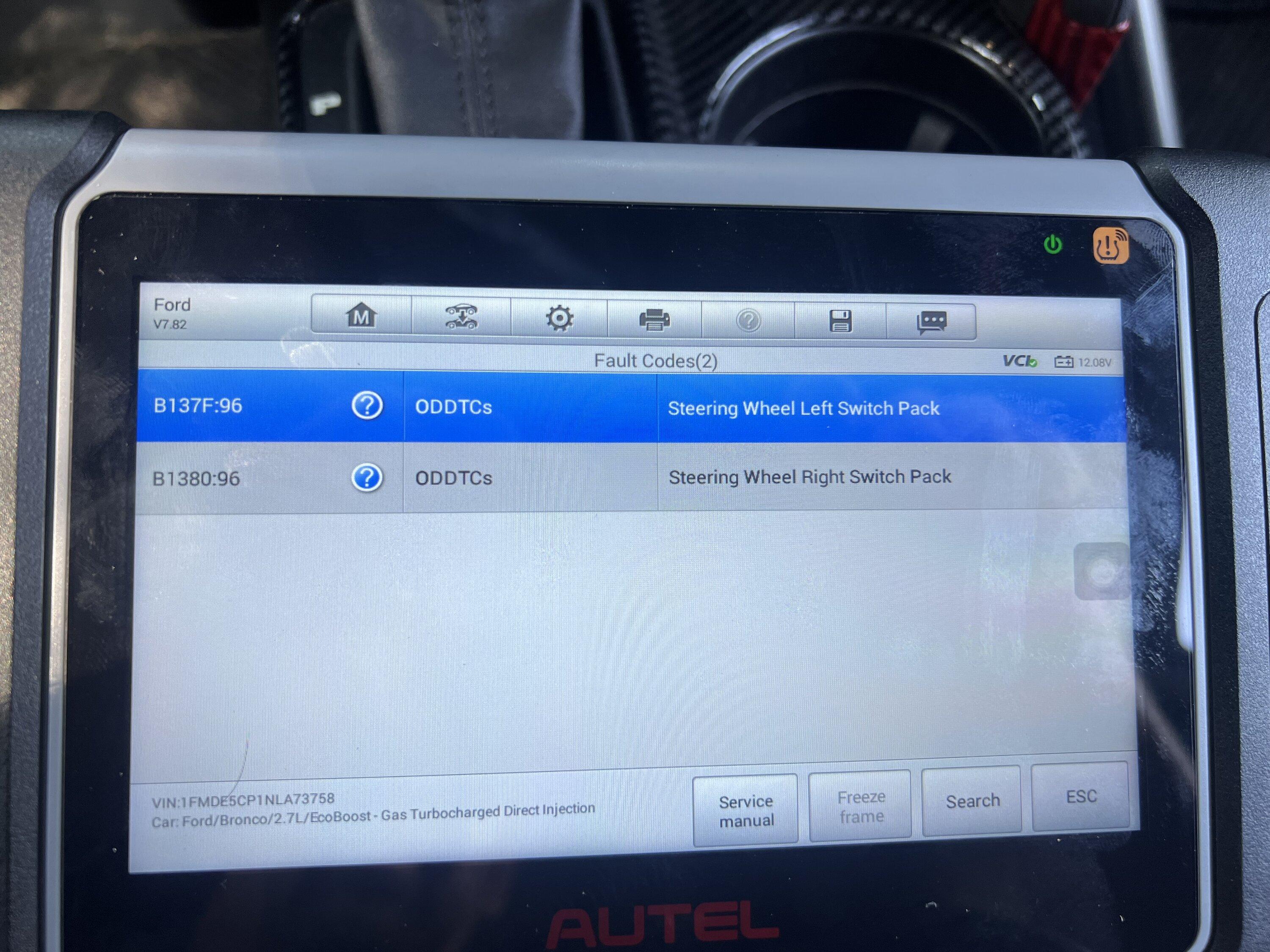

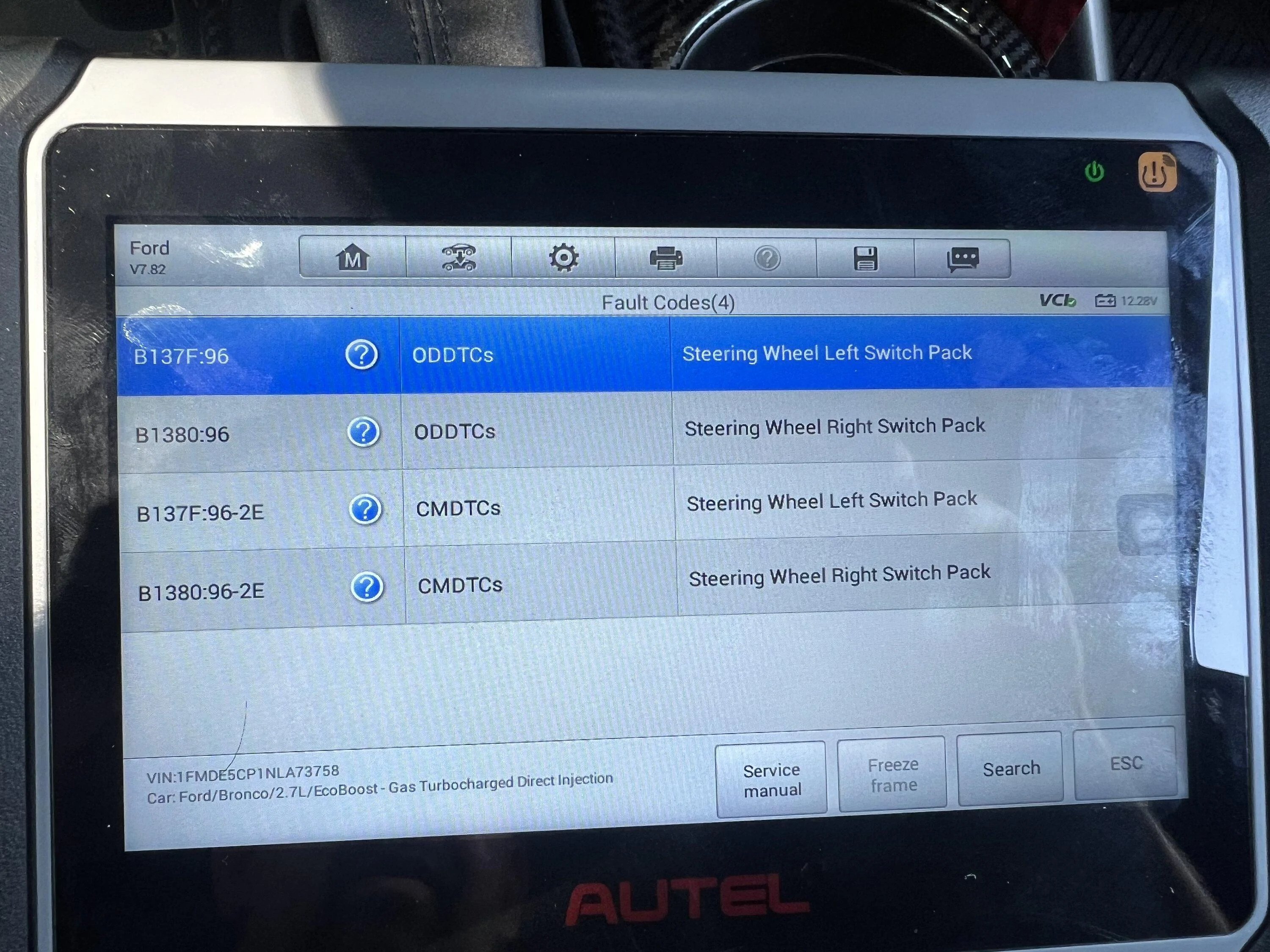

Okay. Went and pulled the codes. If I start the truck I get the first 4 in the picture.
If I clear them I get the 2 in the second picture.
after tuck is started all 4 come back

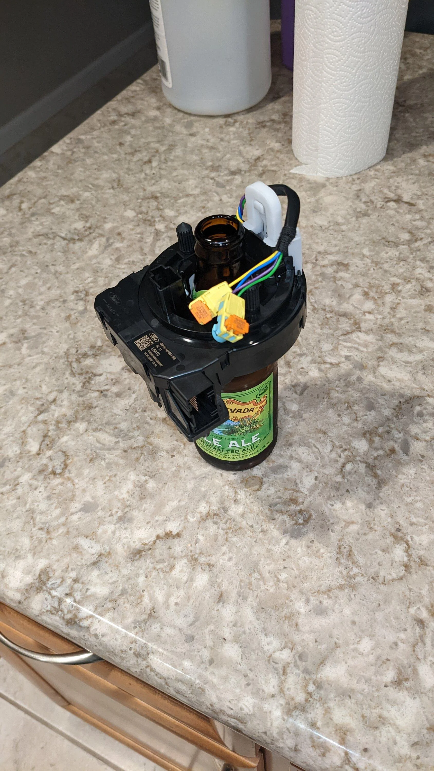

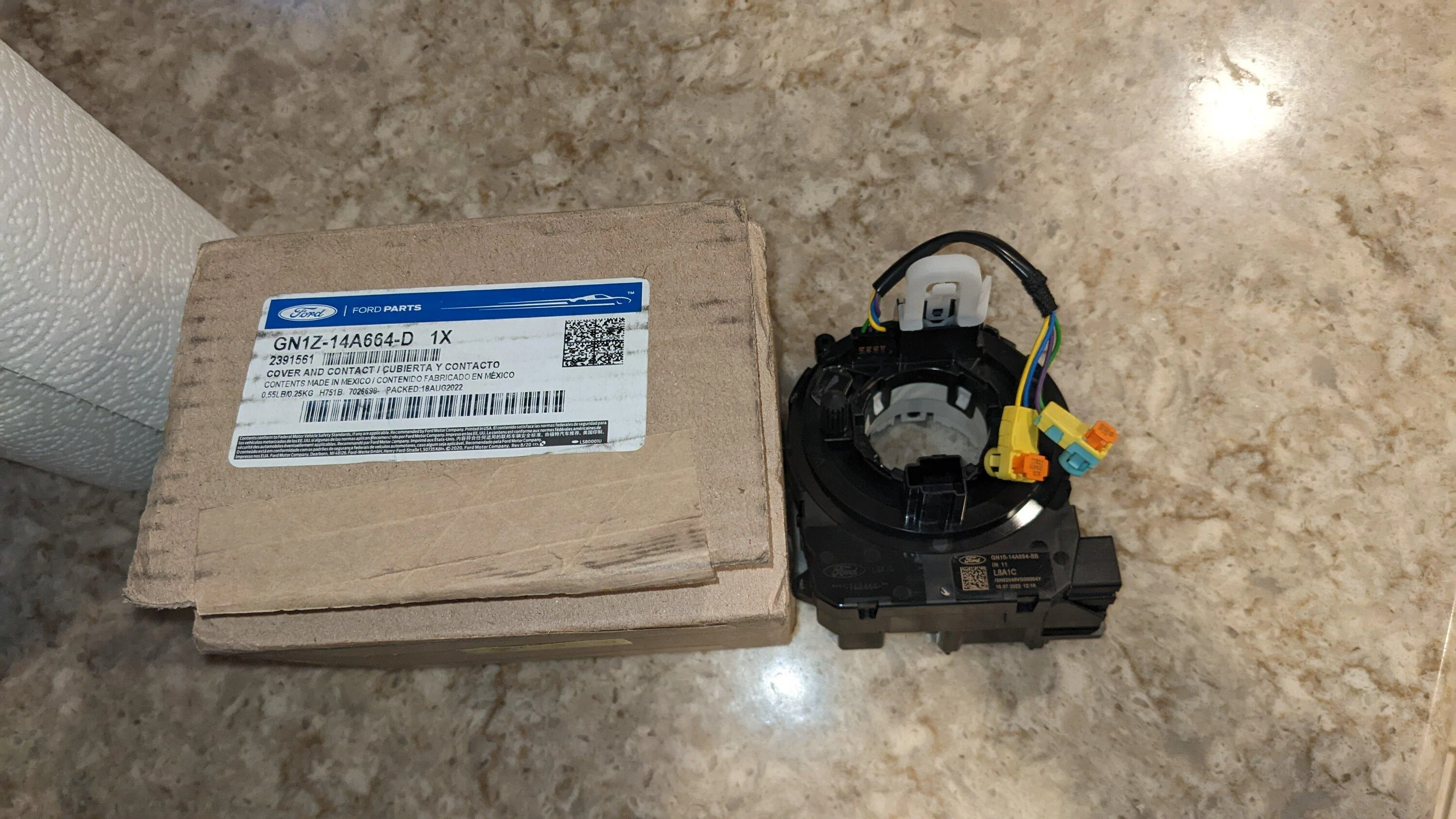

You need a new clock spring, you broke the ribbon strip that the buttons work off. $120 and you get to pull the airbag!

Hit flip up as there are 2-4 different option based on what the steering wheel switches. It's a generic part that fits 2-3 ford vehicles.
How’s the install in that one? Pretty straight forward?

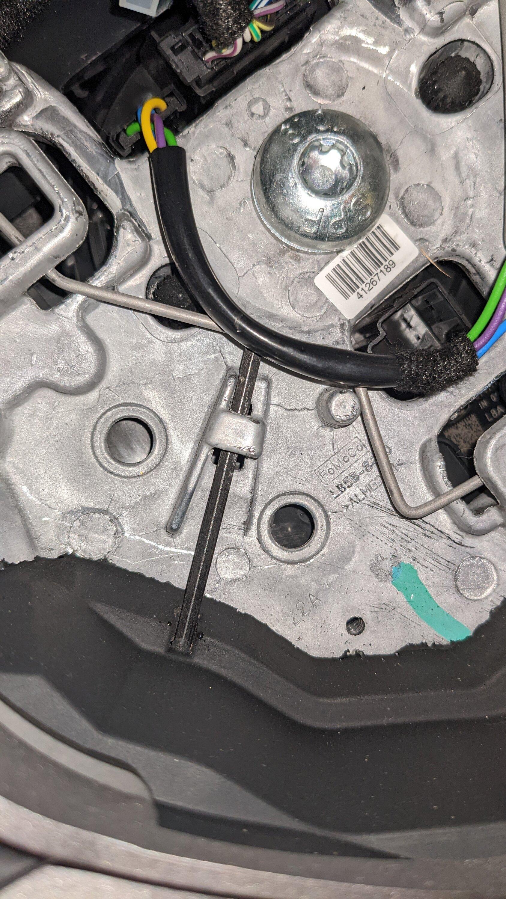

@Ground_zero298 its maybe an hour job.
Pull the battery
Drink 2 beers

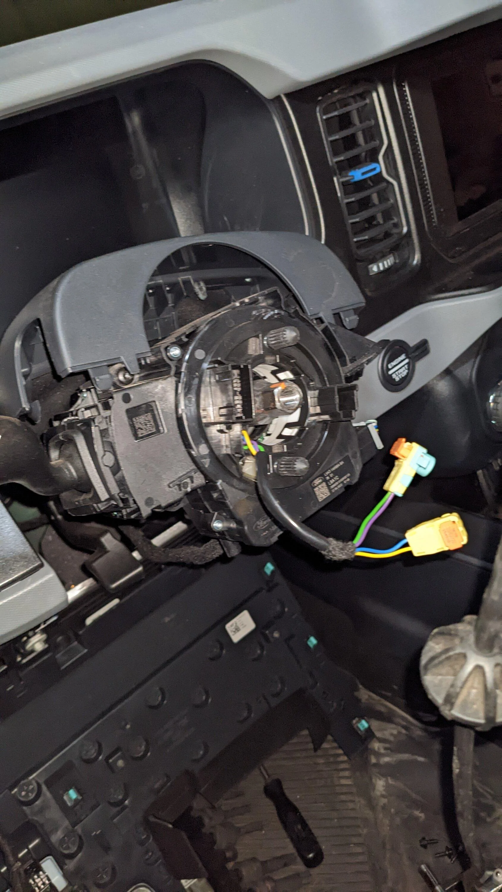

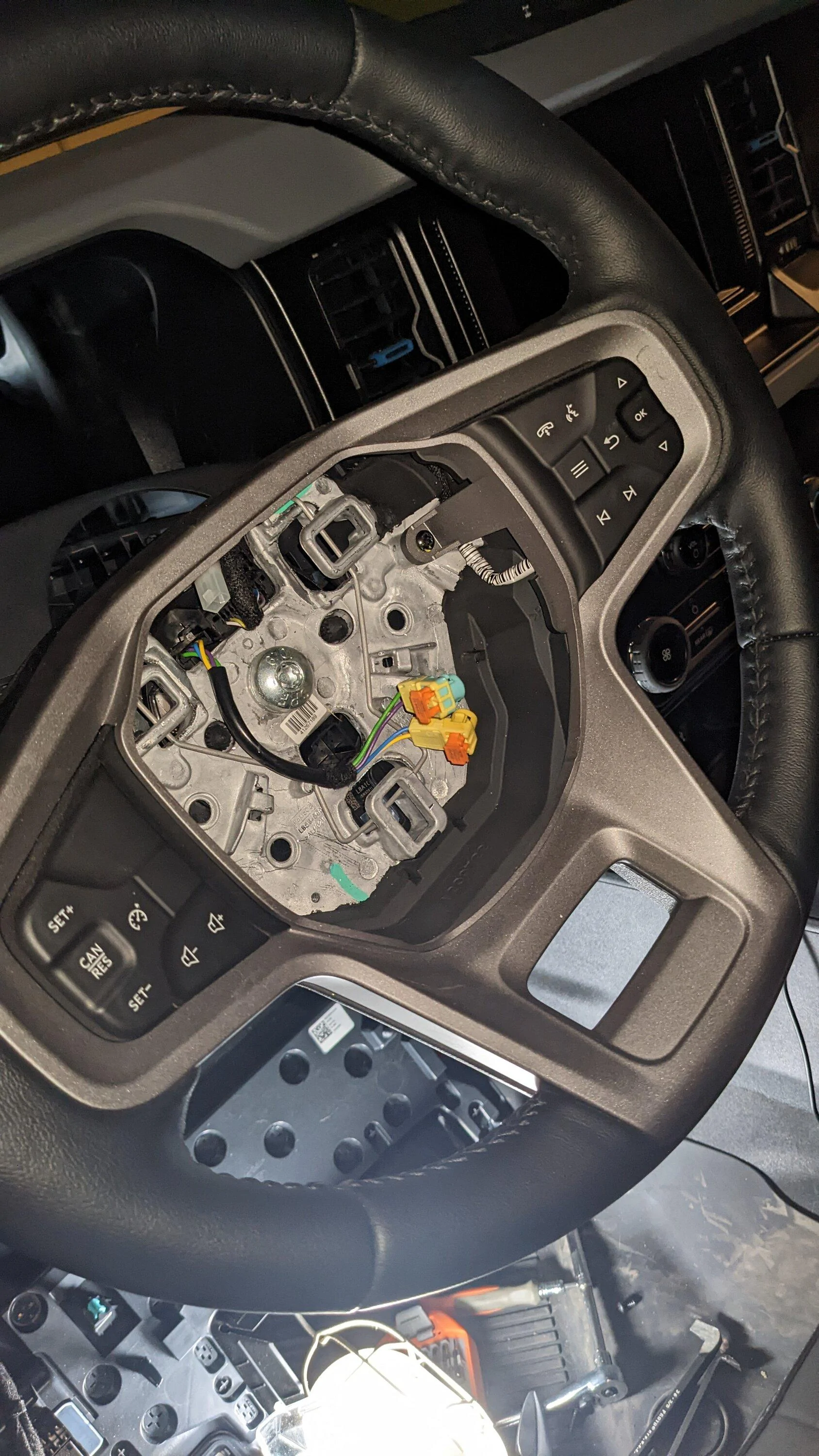

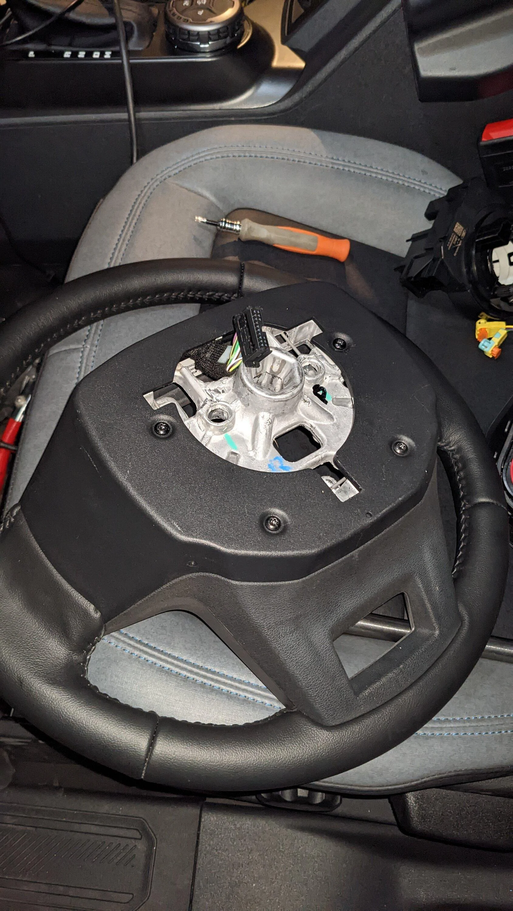

Ford Bronco Steering control module failure PXL_20221118_030447616
Stick the largest Allen wrench that fits in to release the air bag
Unbolt the steering wheel
Pull a few plastics
No beer. Popping a Valium and having at it. See how it goes.

33 minutes. Fixed it.
