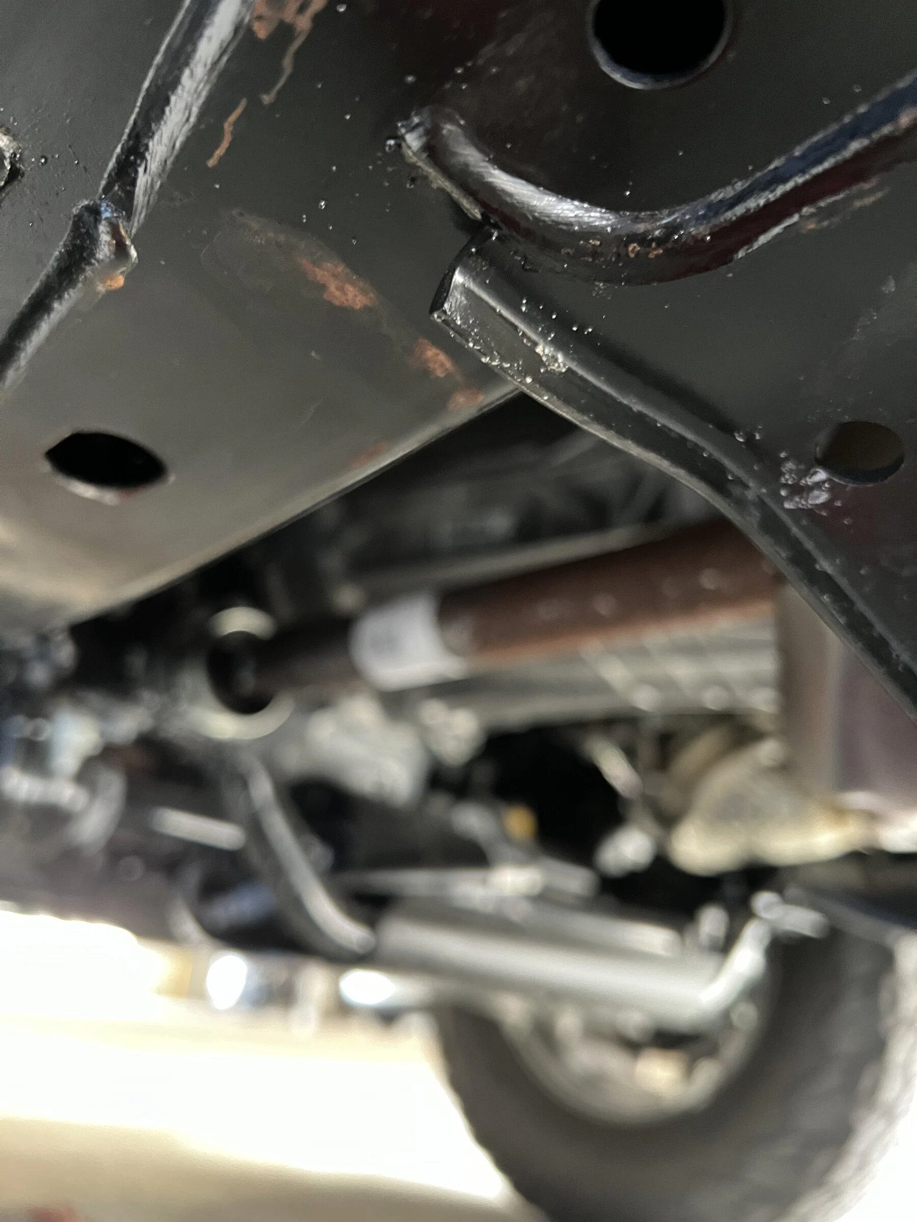

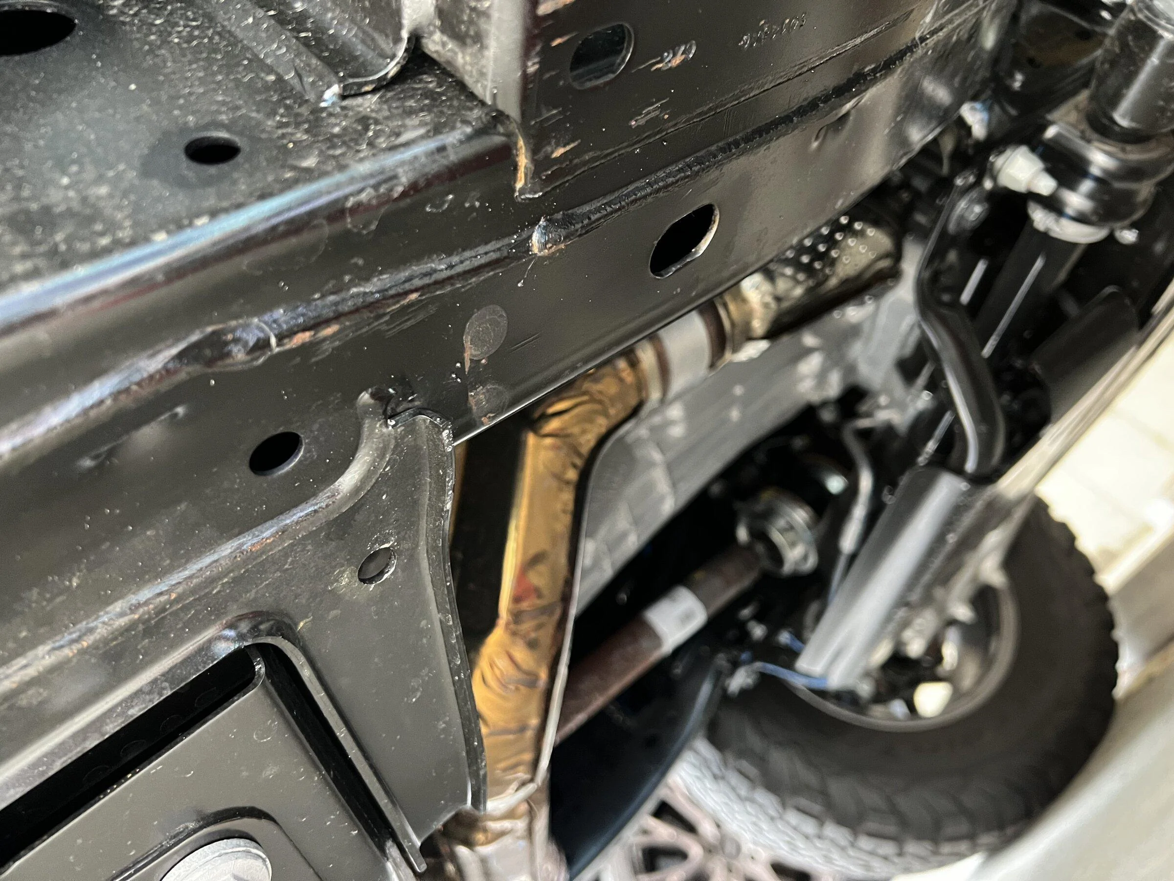

Was laying under my Badlands just now, trying to make sure I had enough room to drop the skid plate and do an oil change without jacking the truck up ā€” but I found something concerning.
Behind both front wheels on either side, and just in front of the jacking point indicated on the frame itself, I spotted surface rust already popping up on the frame. I wiped it off with a dry rag to make sure it wasnā€™t just dripping from something else and accumulating there, but it does appear to be surface rust and not a stain of any kind.
Even more concerning, it looks like the spots of rust are on an area of the frame that seems scuffed up a bit ā€” almost like either Ford or my dealer during PDI didnā€™t safely lift the vehicle and somehow scuffed the rust proofing off the frame in this spot on both sides. The issue appears symmetrical (same amount of rust and scuffing on either side).
Pictures attached; my Badlands was built the first week of December 2021 and has under 600mi on it. If this amount of rust was popping up some years down the road Iā€™d be much less concerned, but now Iā€™m wondering if I should be sanding those areas down to bare metal and reapplying some rust proofingā€¦
Driver side:
Passenger side:

Alright, that at least makes me less worried about the frame itself being prepped wrong! Just annoying that something in transport clearly took the rust protection clean off before I got it. Hope yours looks as good as (before) new now!

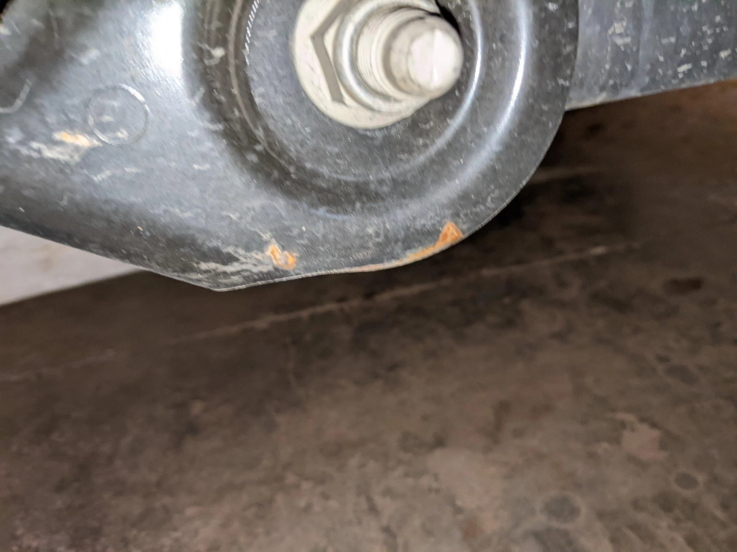

I just noticed this today. So what's the best course of action? Sand it and Steel-It?

Most likely getting a POR-15 style kit with steel wire brushes and a rust prevention paint to go on ā€” clean the rust off, clean the area thoroughly with the included alcohol wipes, dry then paint on the rust preventative paint and you should be good until you scrape it up again

It's gotta be from stones. Haven't scraped it on anything, as i only have 270+ miles on it. Same thing happening on the other side. Seems kind of odd to have happening so soon. Be nice to have some sort of guard for that area.
