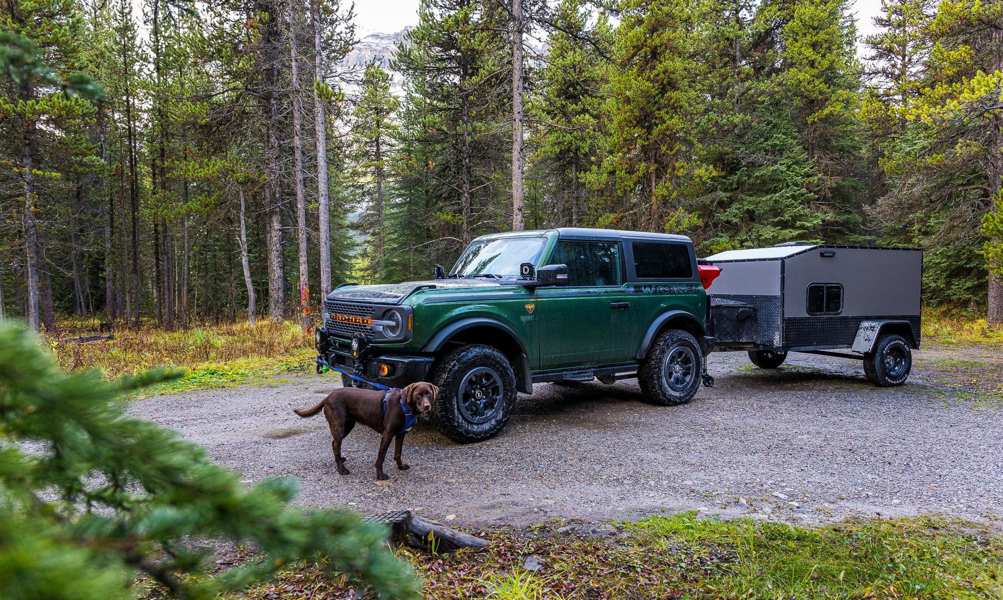

Breaking in the new transfer case on 200kms of greasy forest roads to the cottage. Just making sure its all G. Did an OCI and wipers today; she'll get a tire rotation at some point this upcoming week too

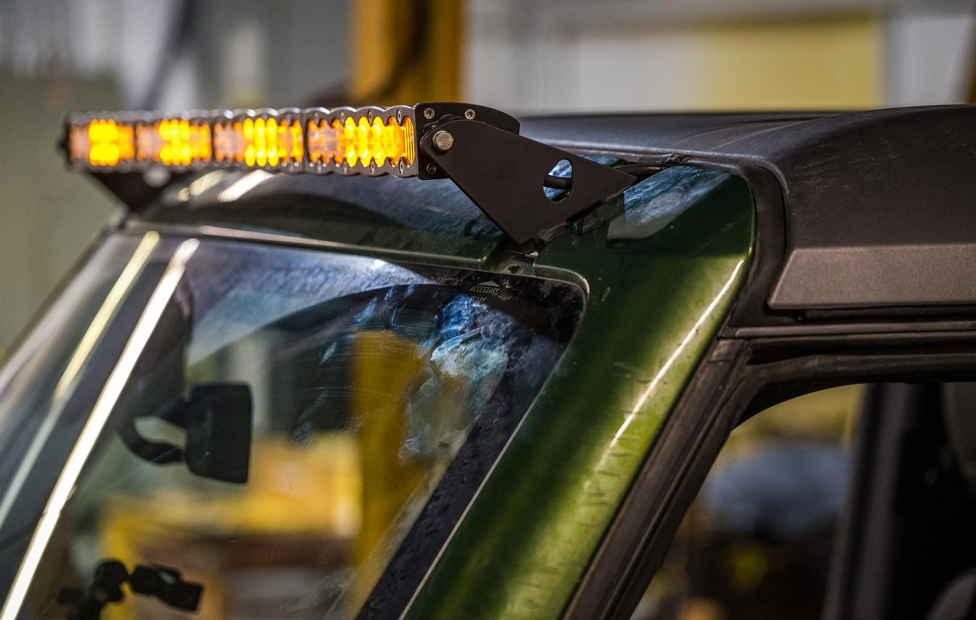

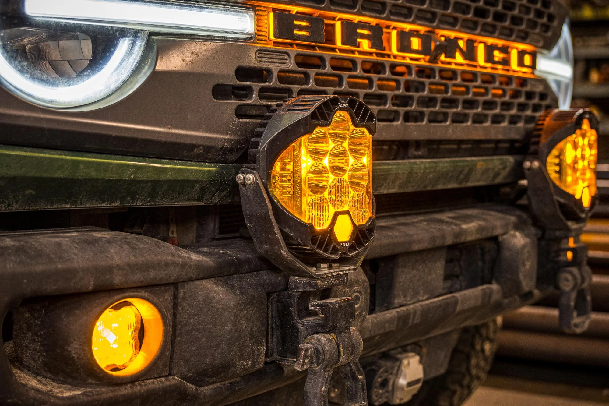

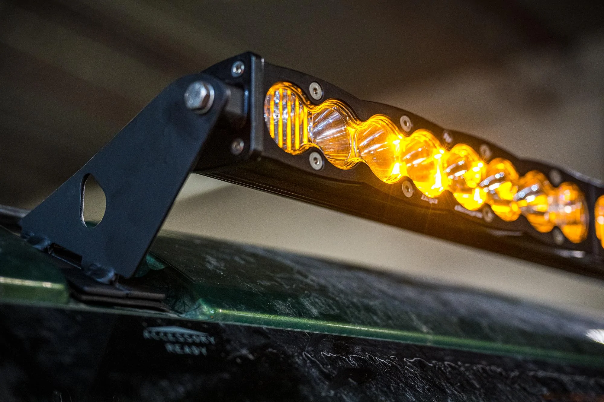

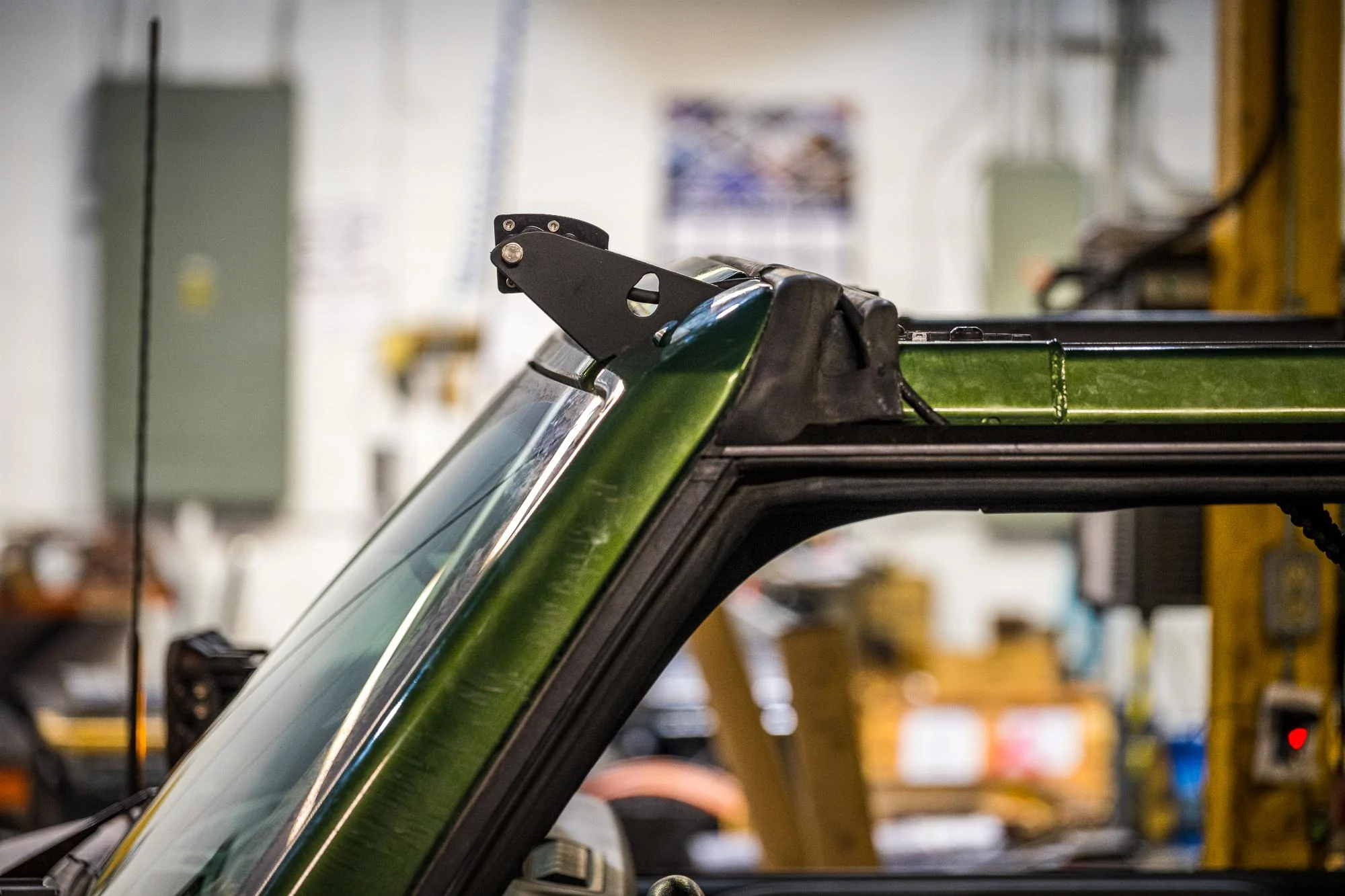

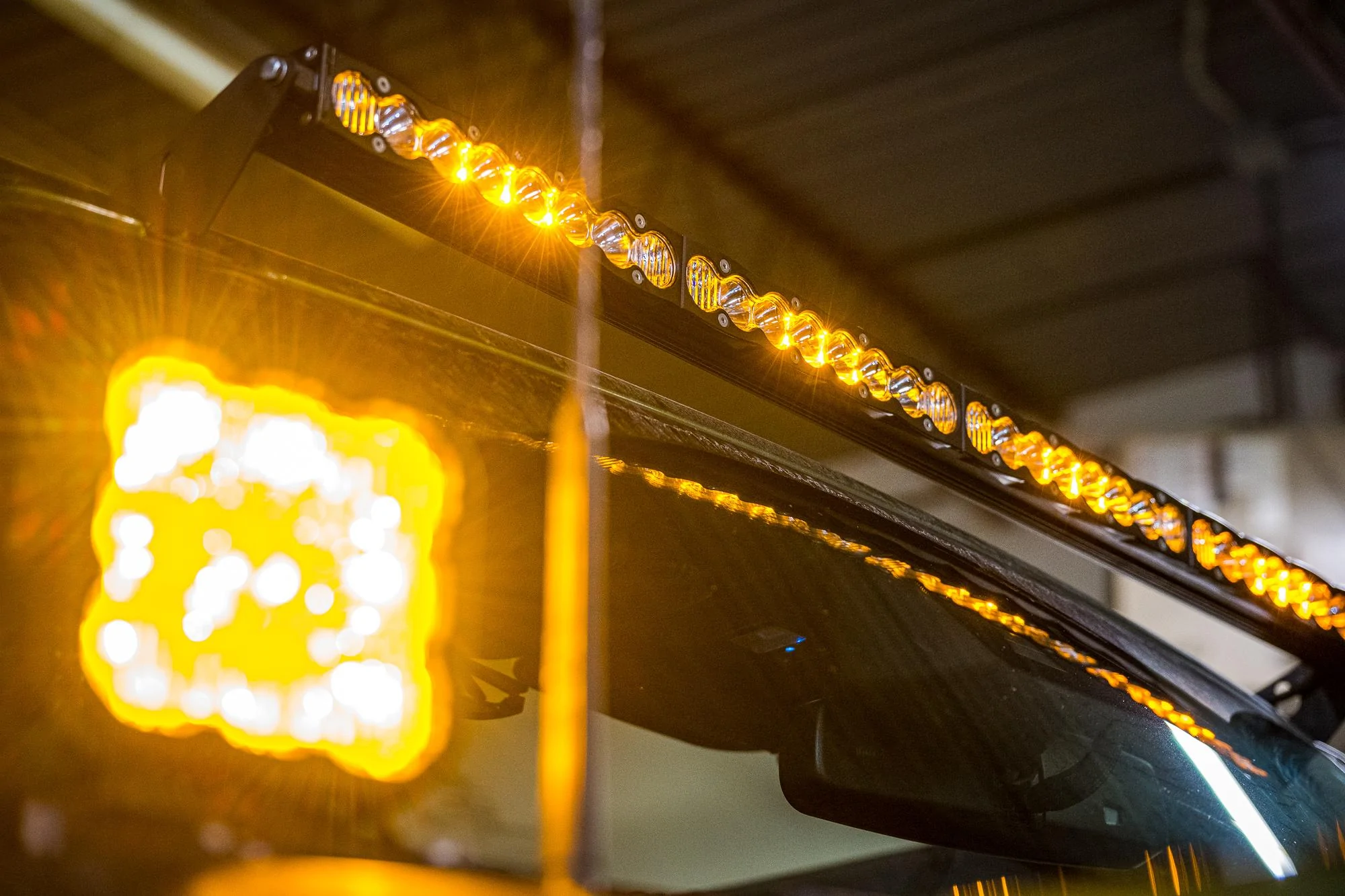

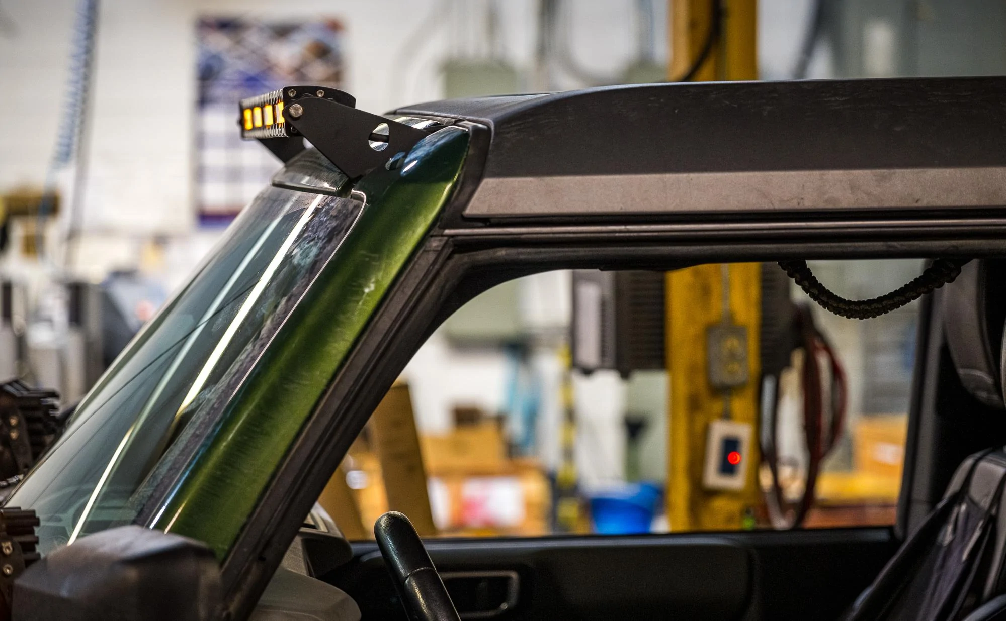

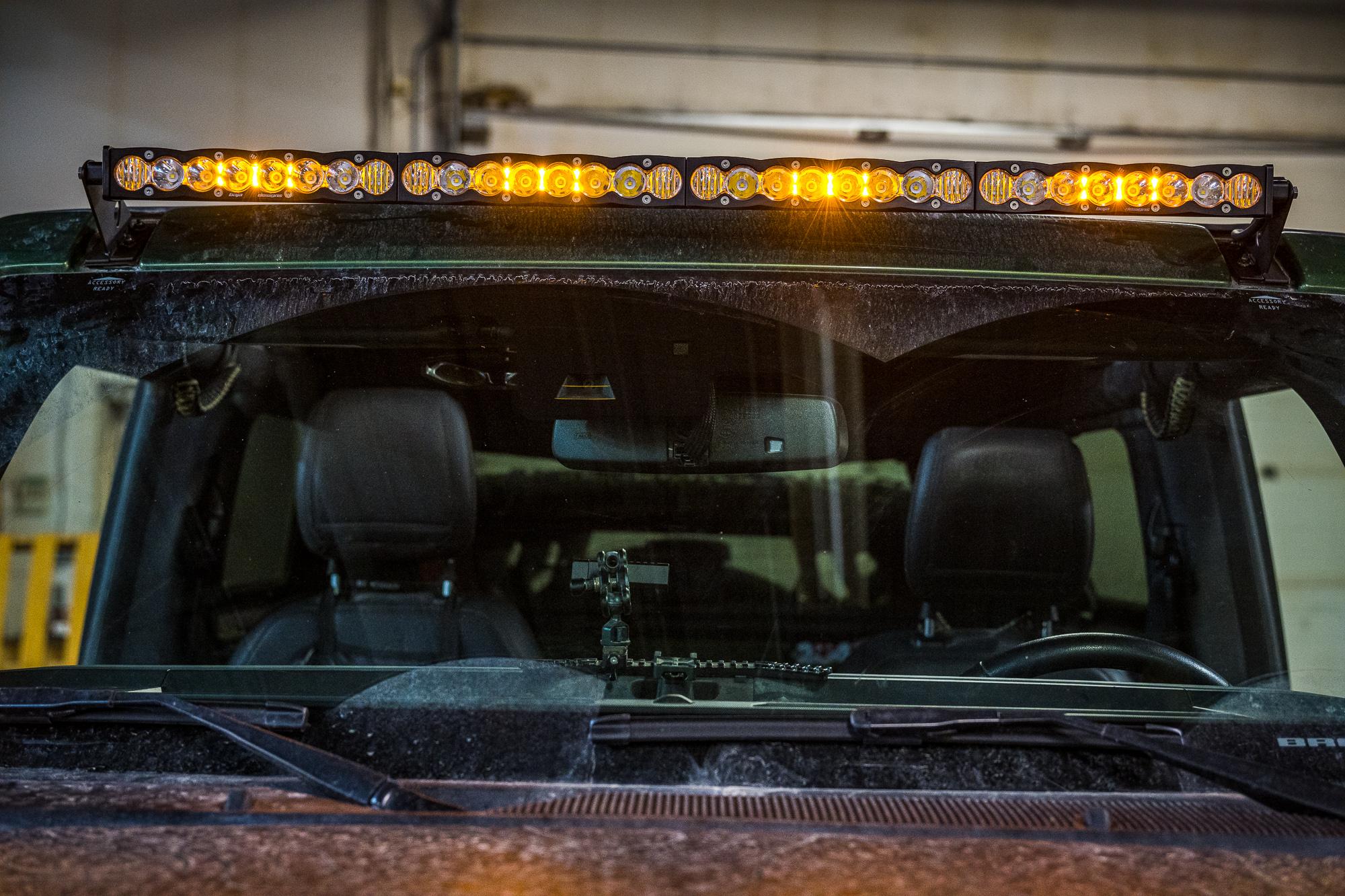

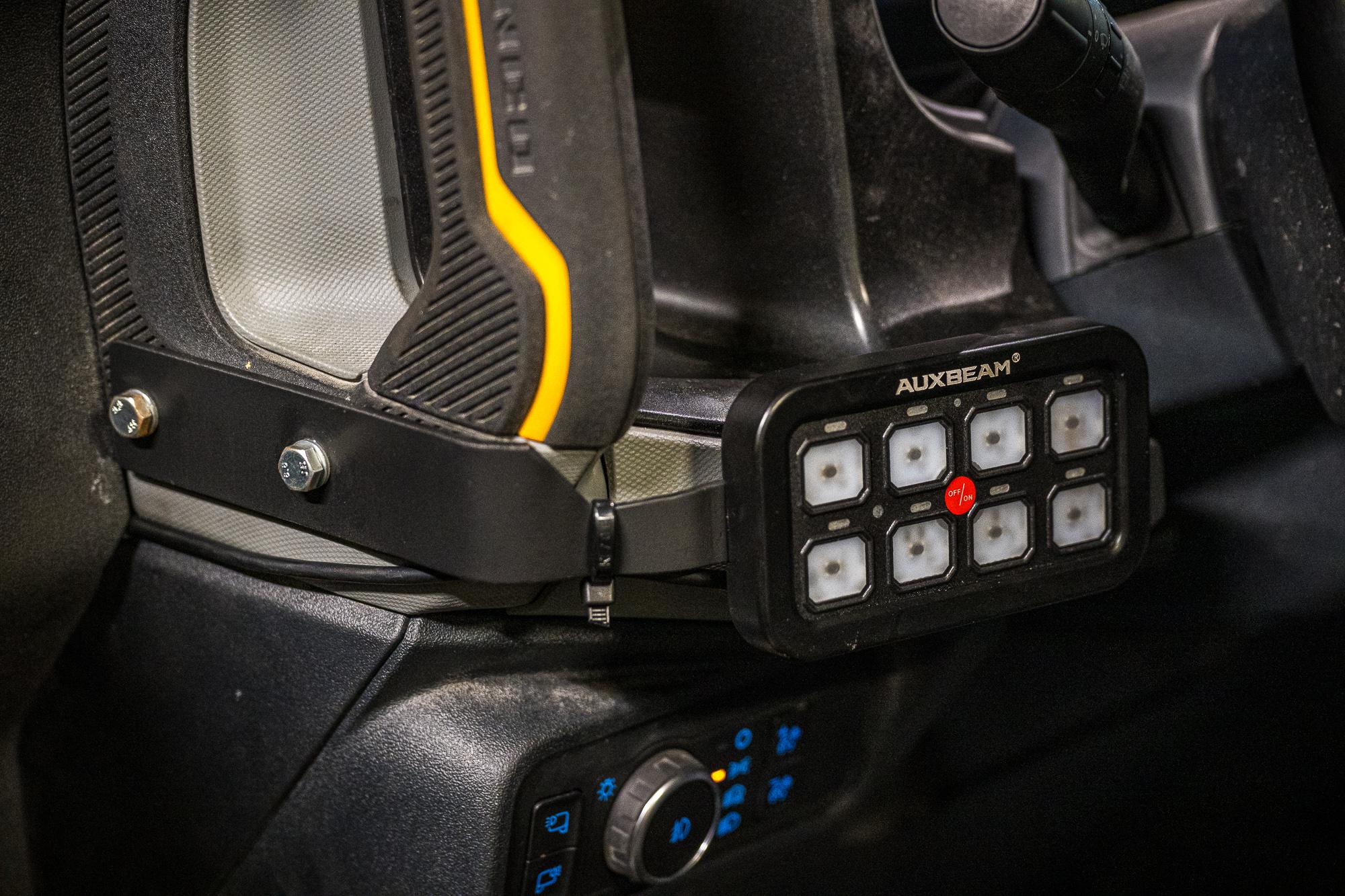

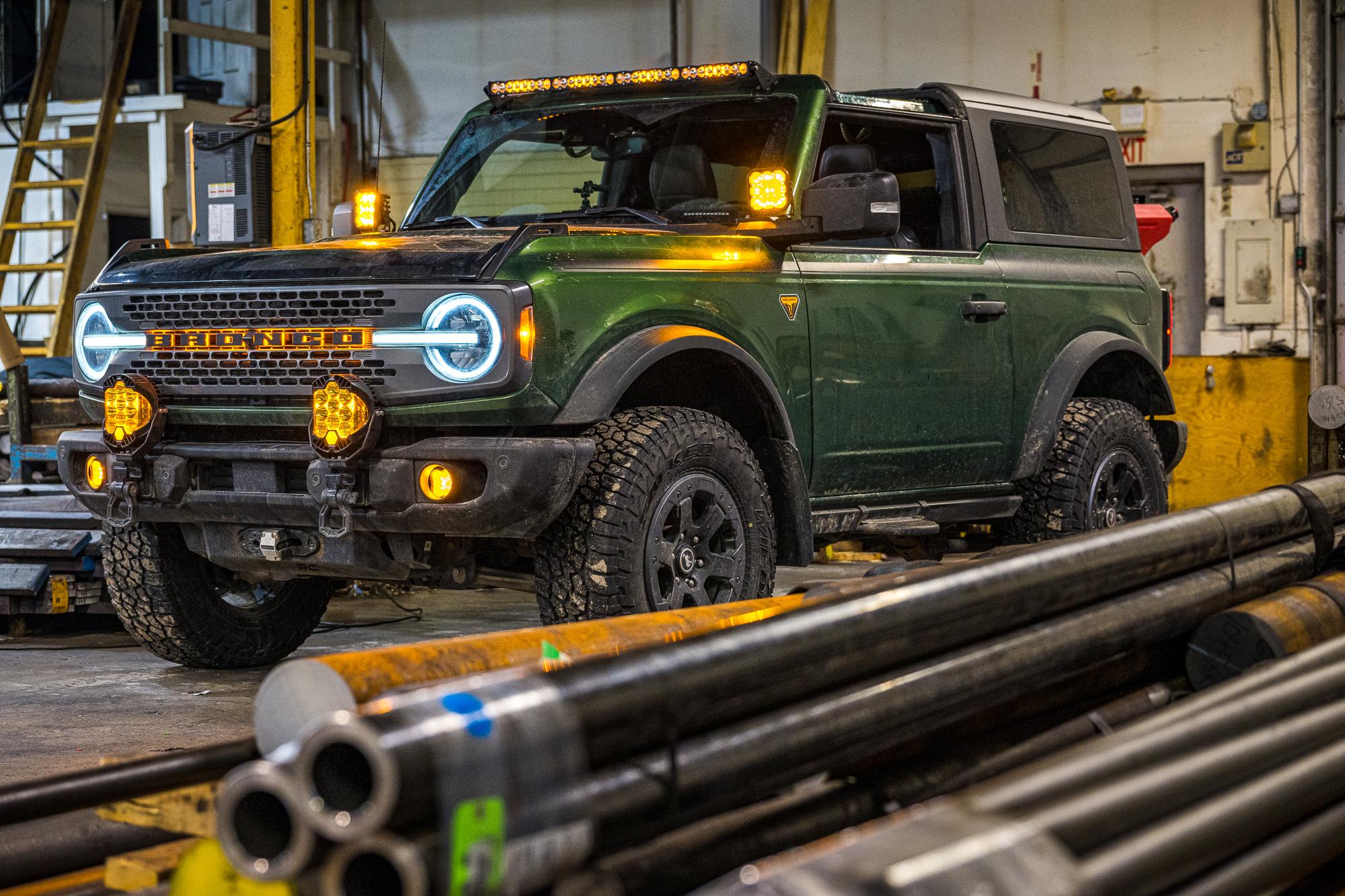

About 7-8 Months ago, I drew a bracket design for the @Baja Designs S8 40". This weekend I finally had enough time to tackle the install.
The S8 40" draws 16A and I wanted to run the DRL's, this meant a relayed harness... the preran wire above the passenger visor simply seems too undersized IMO. While I was plumbing these lines, I also pushed a line for the Auxbeam Switch panel and line to manually trigger the IAG Interior lights (with said Auxbeam controller). I popped the line through the main harness grommet, up along the Drivers A pillar and then dropped each line off at its respective location along its journey.
The weather stripping pulls out of its home to allow easy routing. I removed the airbag break away panels on the A pillar and the front half of the roll cage, loosened the airbags and tucked the IAG harness behind as it ran rearwards.
Up next were some plasma cut SS brackets, hand bent on a brake, painted and installed. The weatherpack was cut off the S8s wire fed through a pinhole in the roof seal. The junction was covered with a Silicone Sealant - front and back.
I hope that there isn't any issues with the bar, knock on wood. Luckily for me, I got her wired up properly and she fired up strong!
The Auxbeam also had a bracket made up and painted. Tucked low and out of the way since its only intended to run peripherals - nothing forward facing.
The "Cams/Lobes" that are cut into the bracket are purposeful. I wanted to have a could lashing points to further secure the canoe on extended/rough drives! Hooking a cinch strap through the eyelet's should help a ton.
The Auxbeam power distribution box has not been installed yet, I ran out of time.. but it'll be up next whenever time allows again

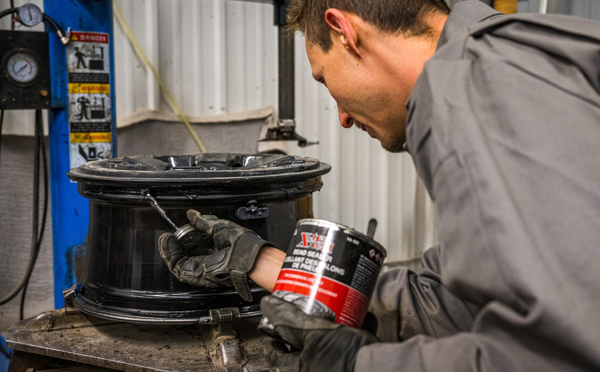

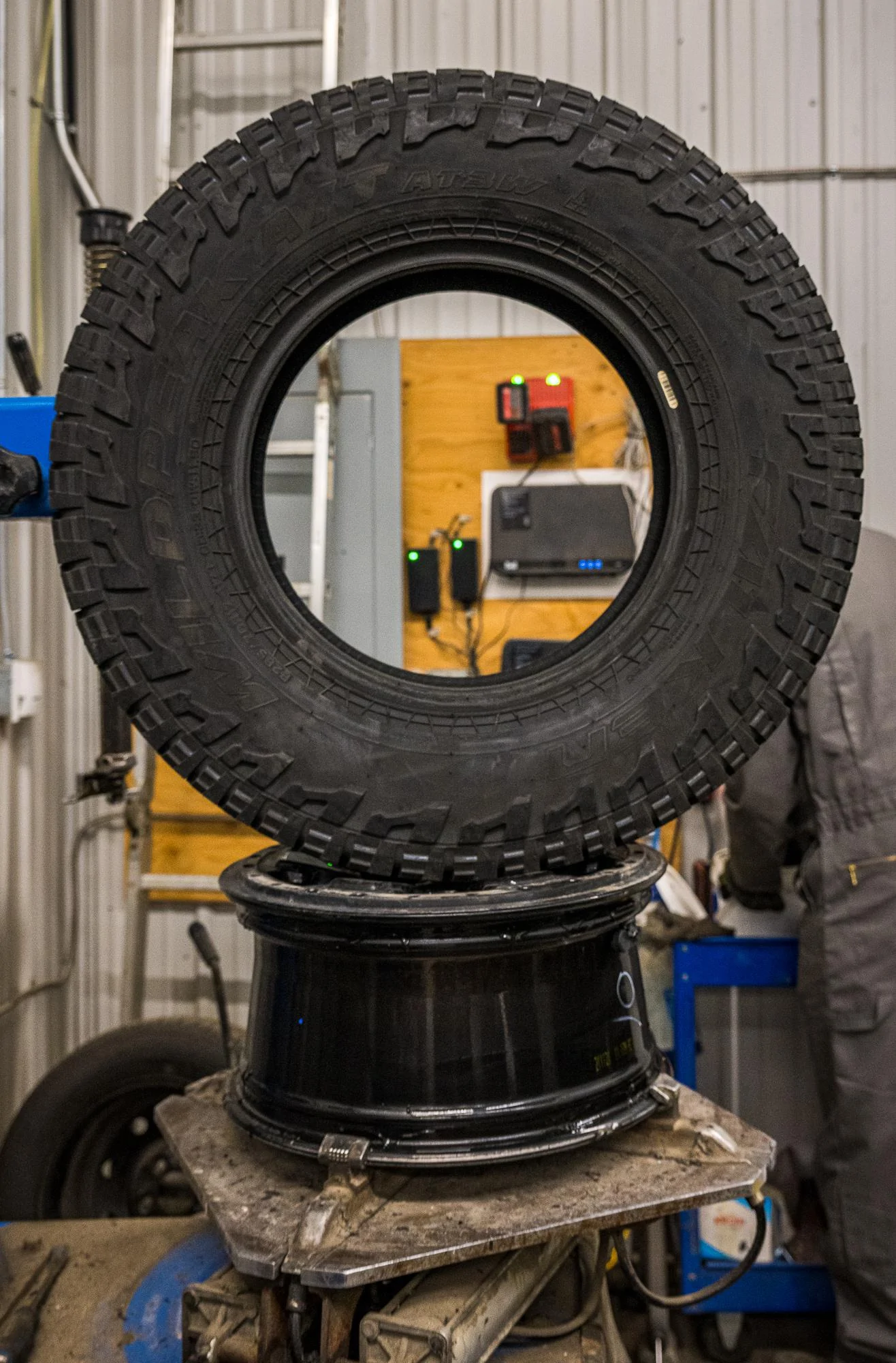

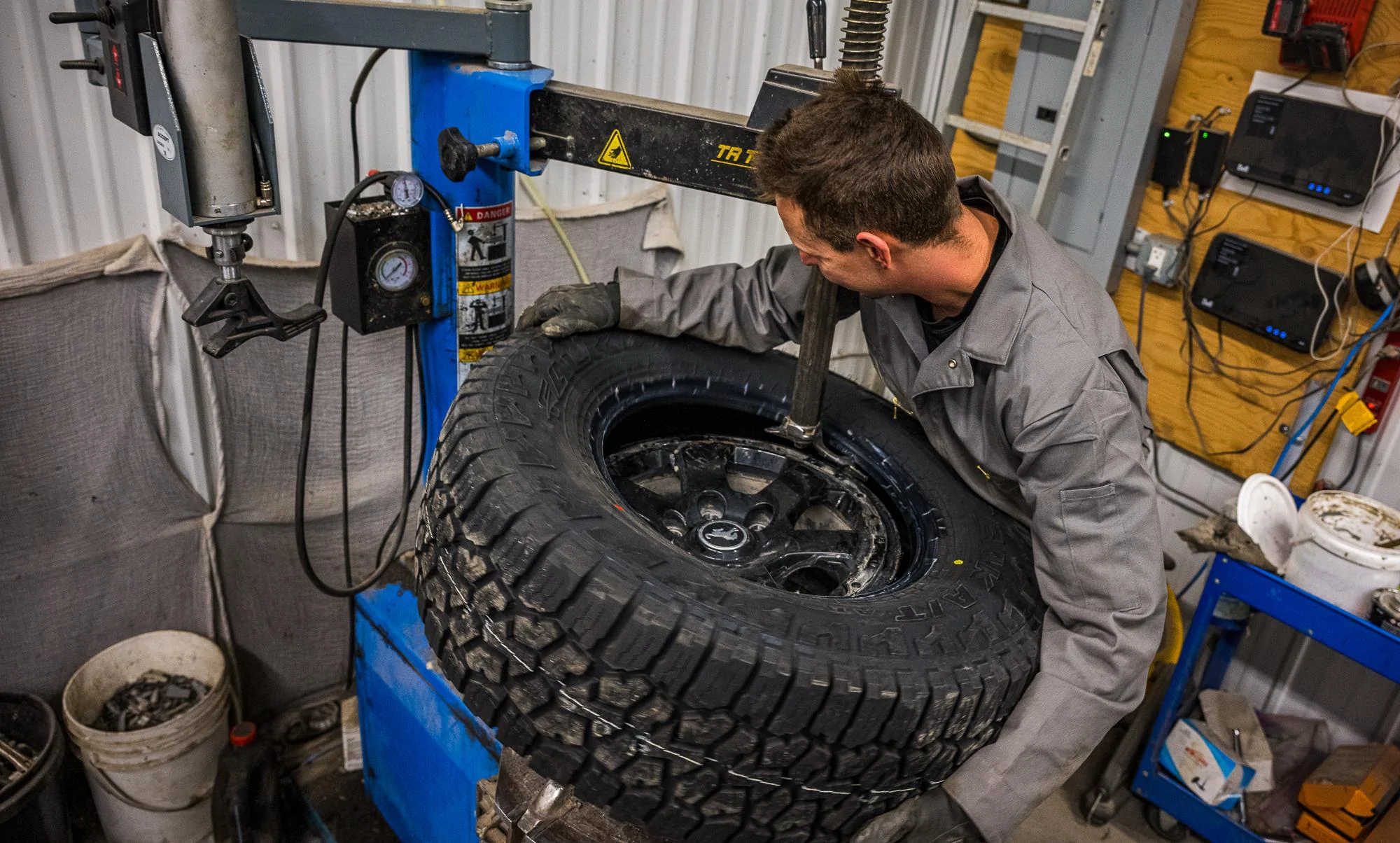

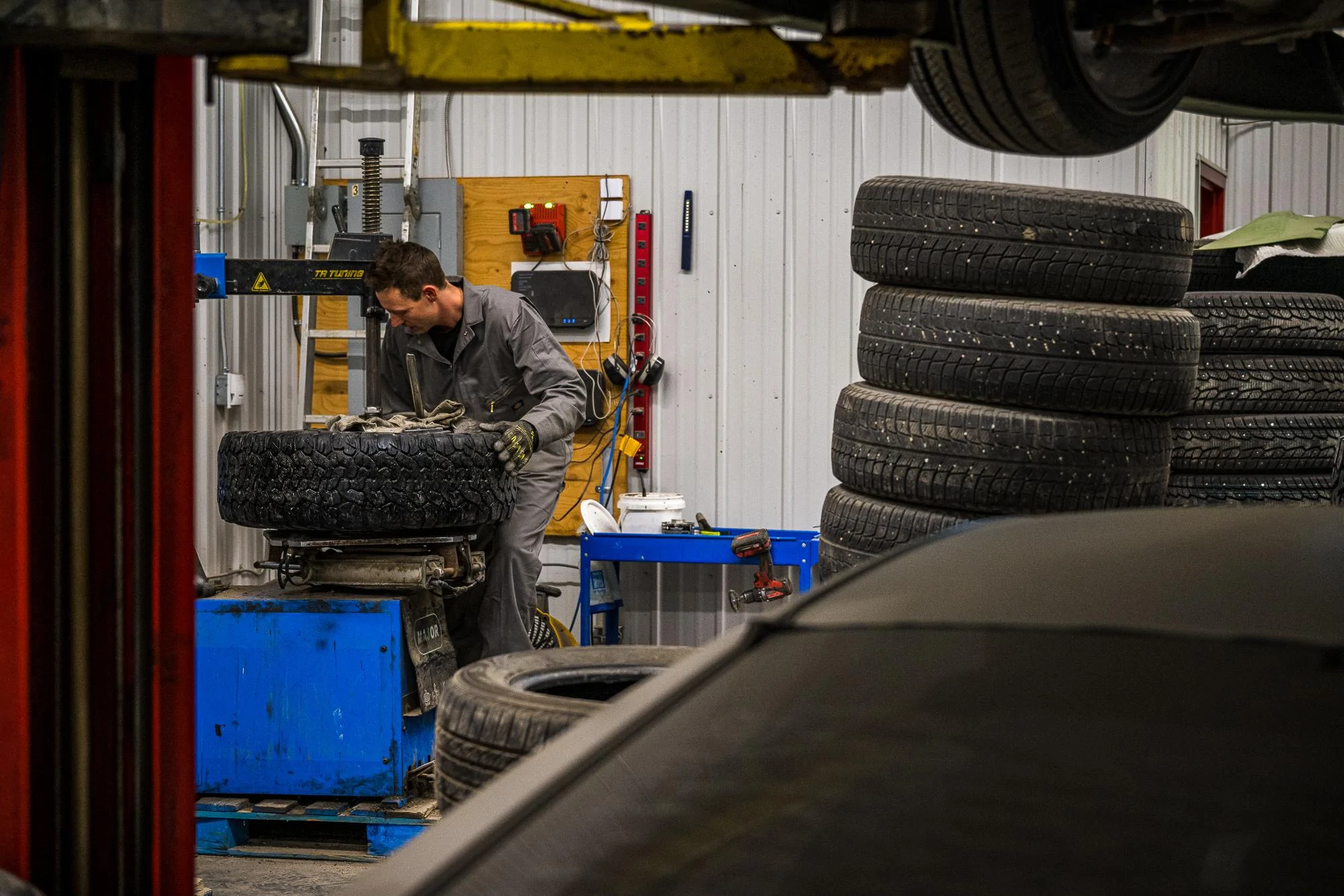

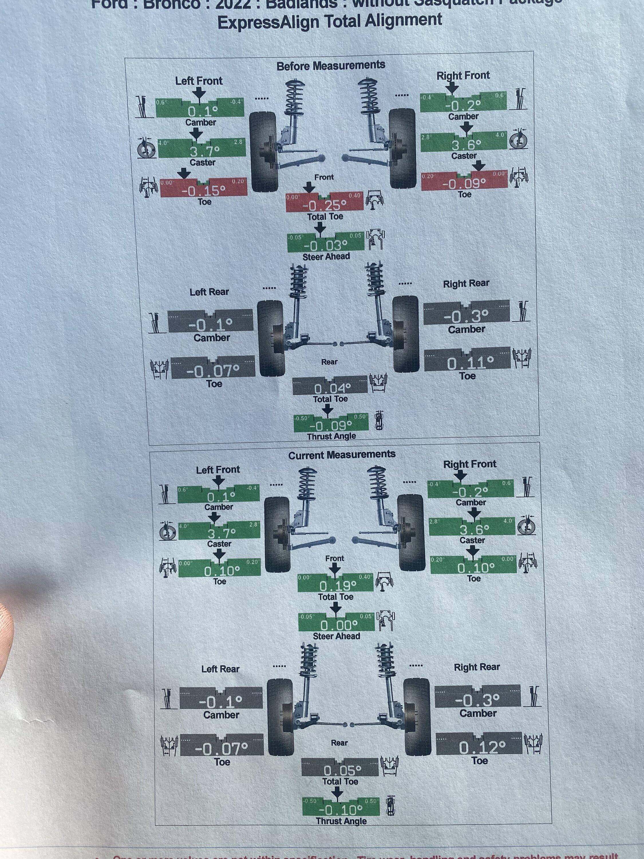

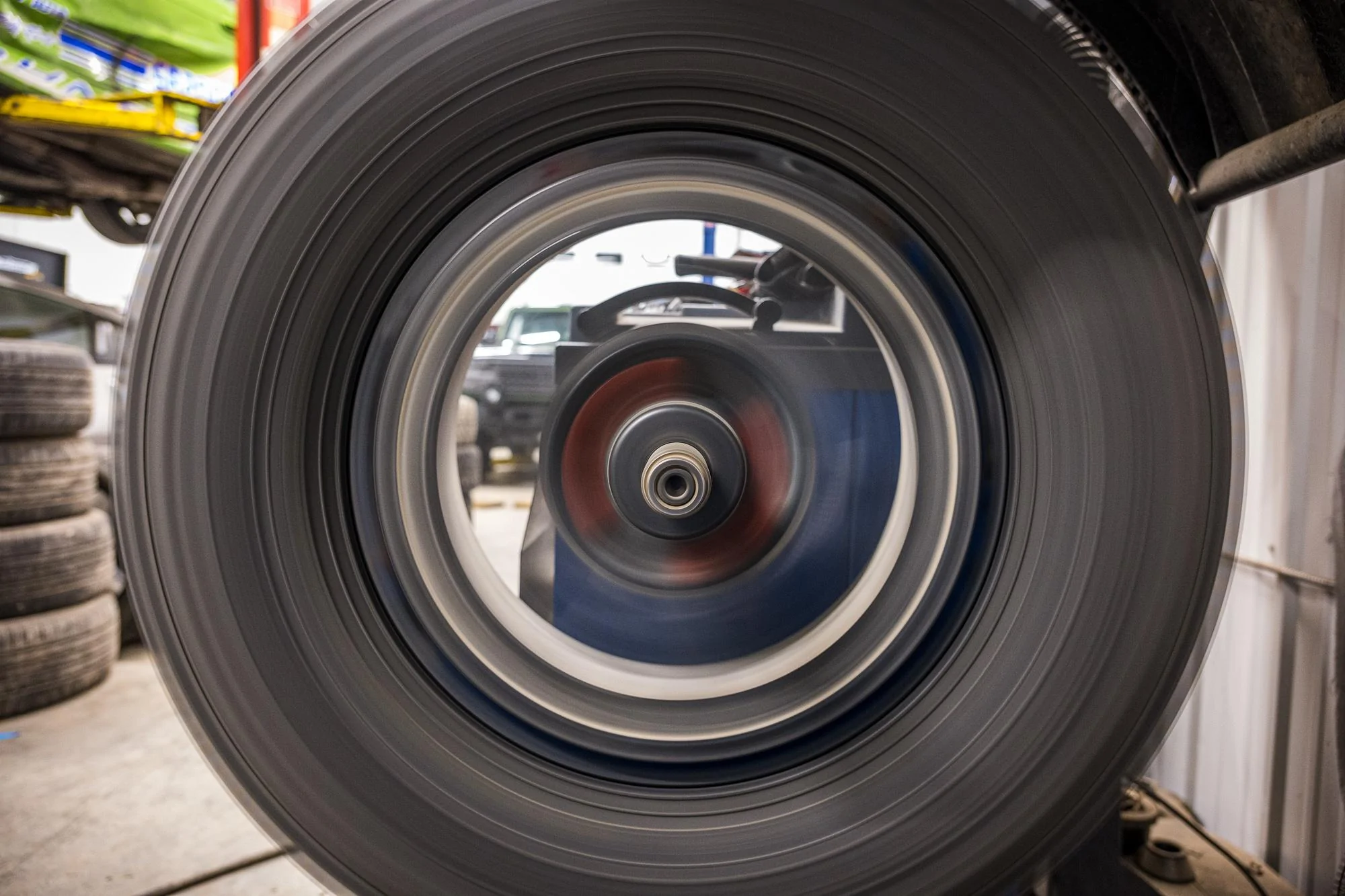

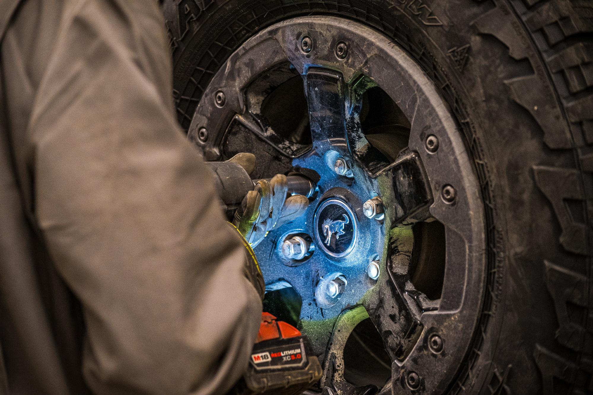

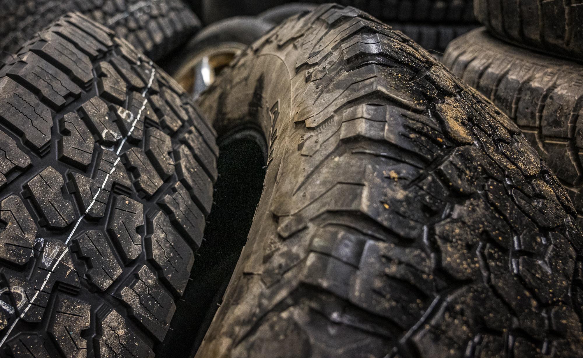

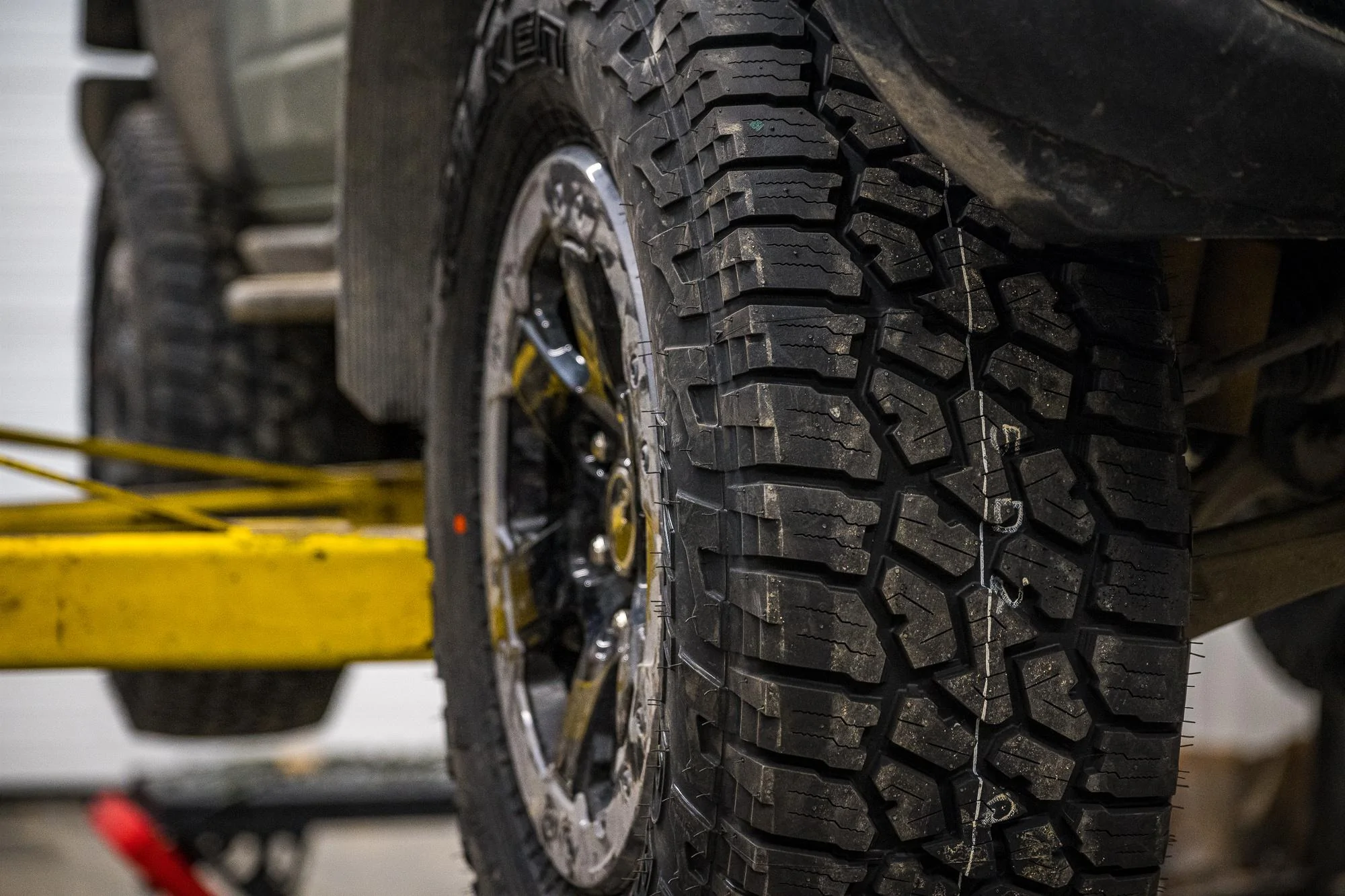

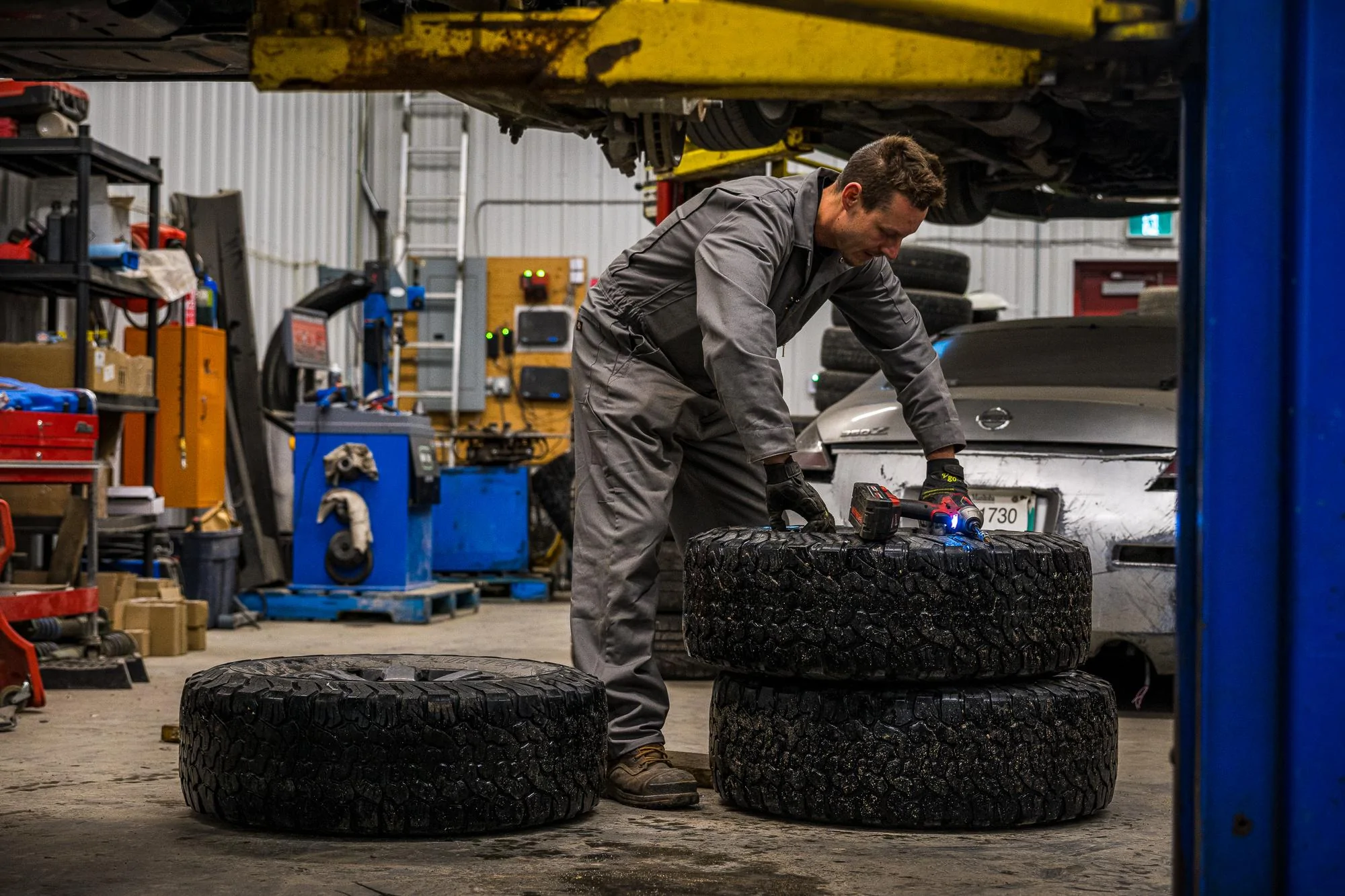

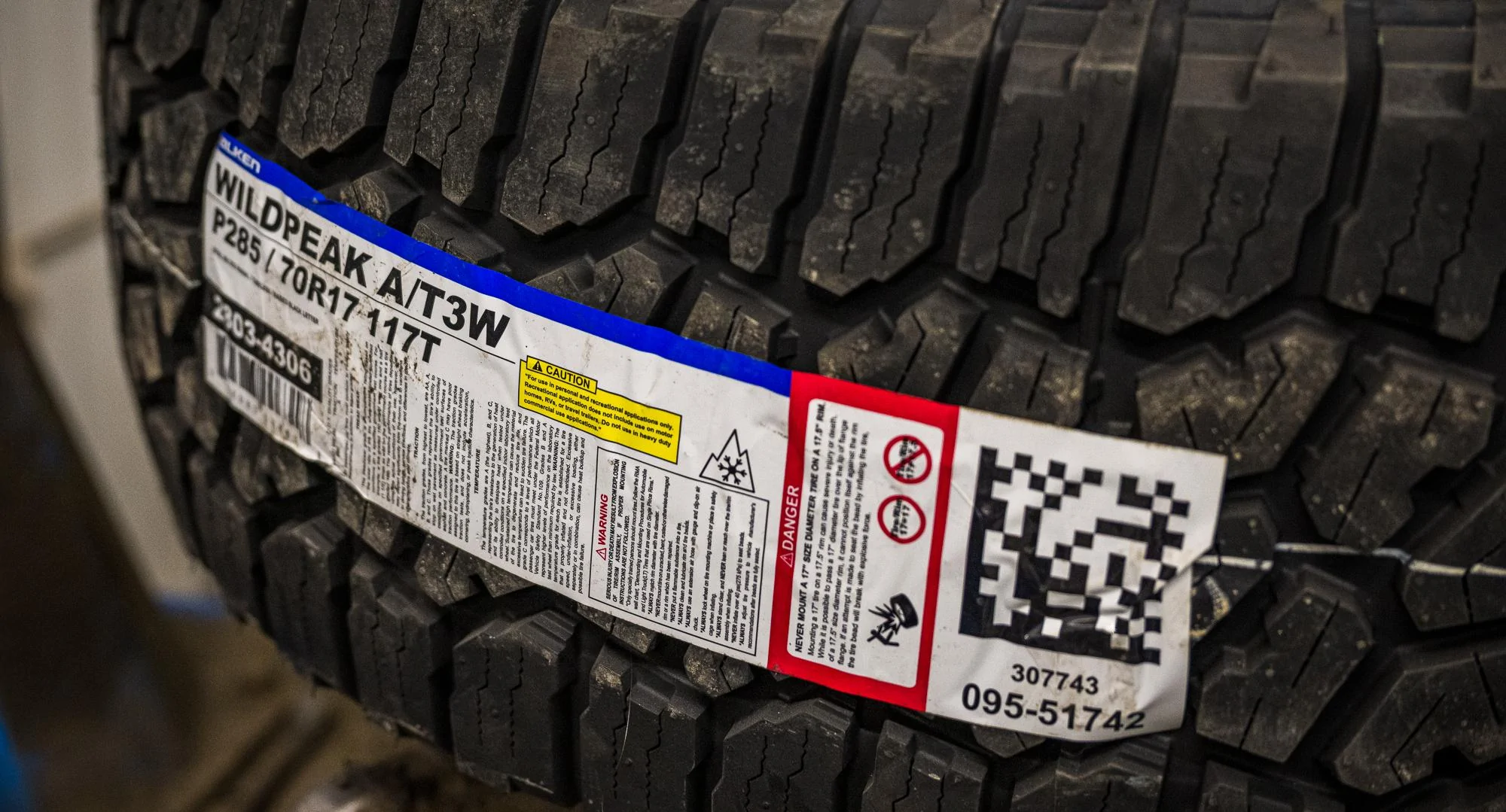

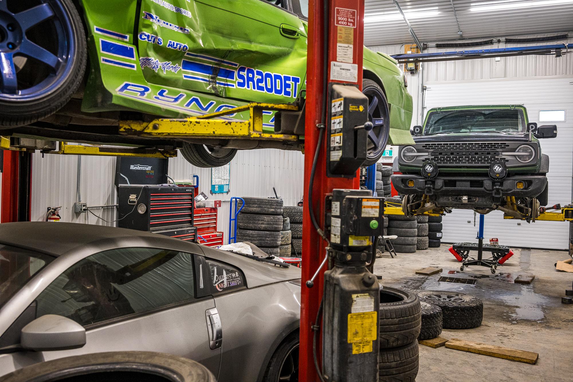

The KO2s had some alternate lug wear/cupping upon removal. The steering wheel had started to meander counter clockwise a few degree and the truck tended to hunt on the highway… sounded like the front toe is out.
So In an attempt to not fuck up the WP AT3Ws she got to go into the shop for a half day appt. Quickly on and off the rack, and she’s good to go again!

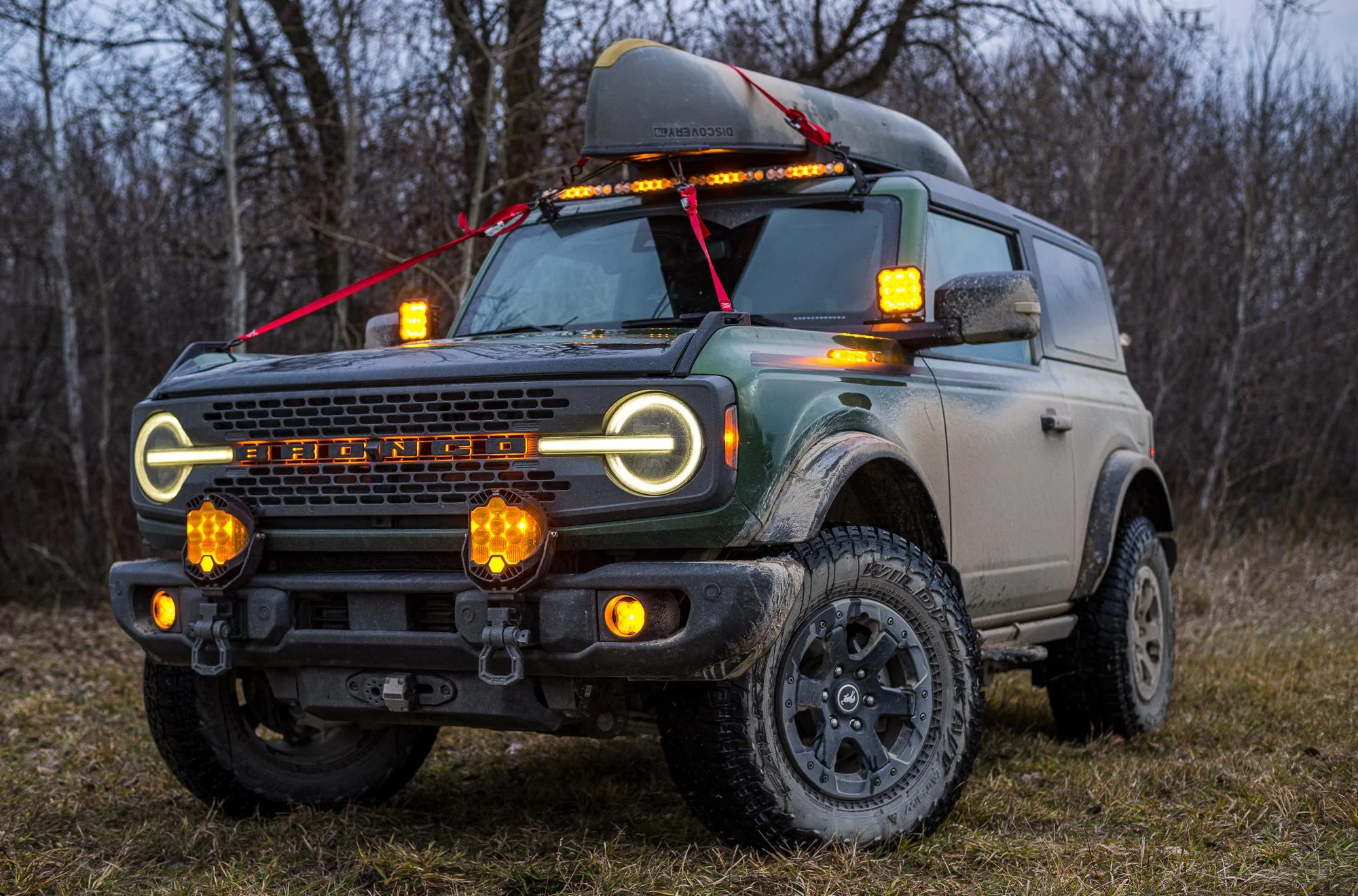

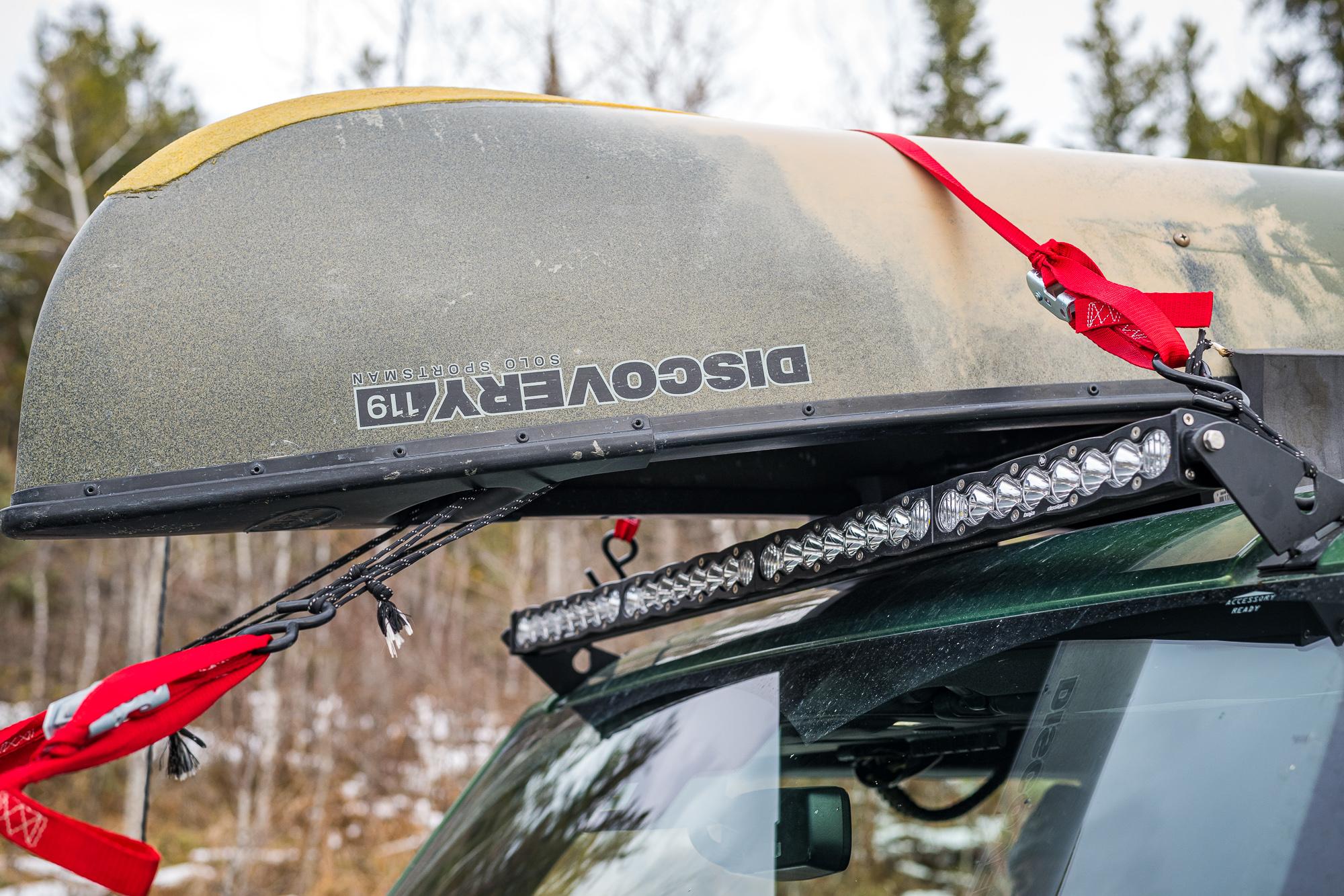

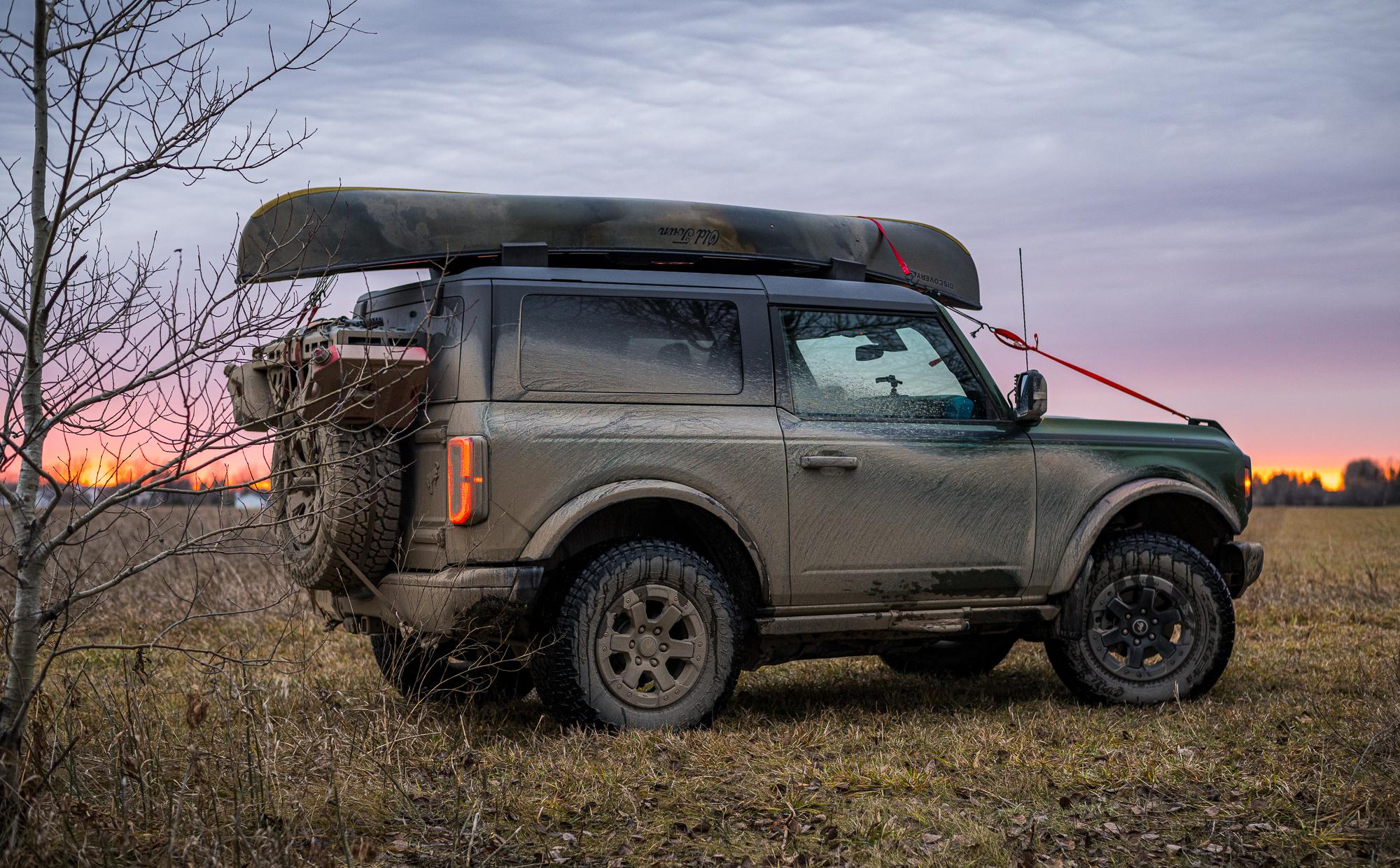

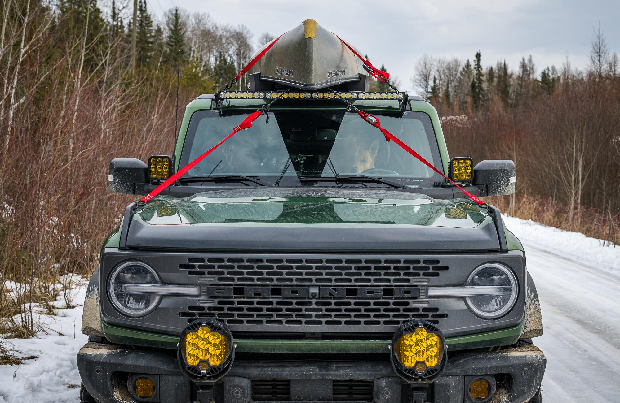

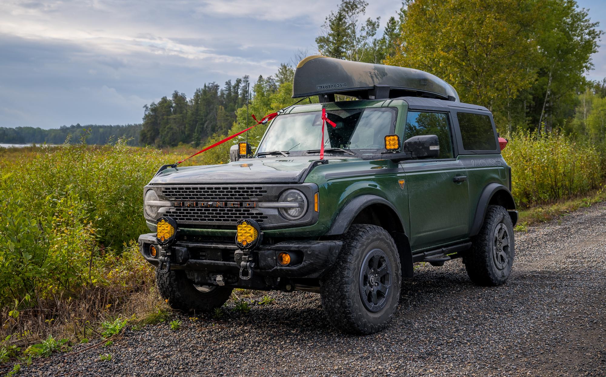

Rumor had it that the lake had thawed (they were wrong)... so I loaded up the canoe and went for a night drive. Ive got NOTES (and a bit of hype for those quality manufacturers out there)..
First note, the canoe reflects way too much light from the S8 to effectively be used. Luckily the rest of the lighting does the job without issue.

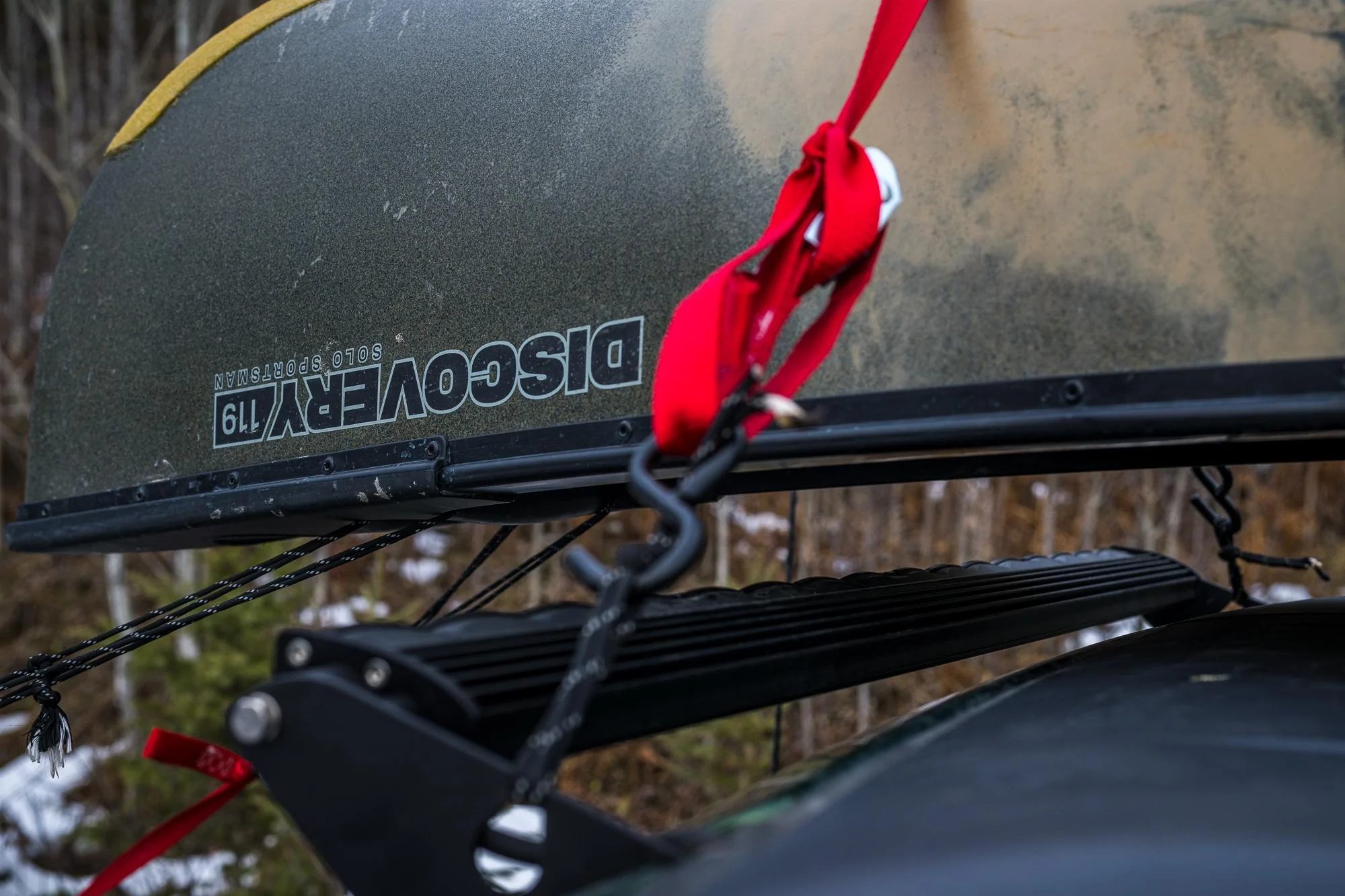

Second Note, the double duty light brackets work perfectly to keep some nose pressure on the canoe to avoid it from swaying left/right on the foam blocks.
Third Note, the S8 is slim as shit! No interference while loading up or off.
Fourth and final Note, I rushed out to buy another pack of cinch straps and decided to use the paracord loops that I knotted up. Next time ill be trying the over hull strap without them.

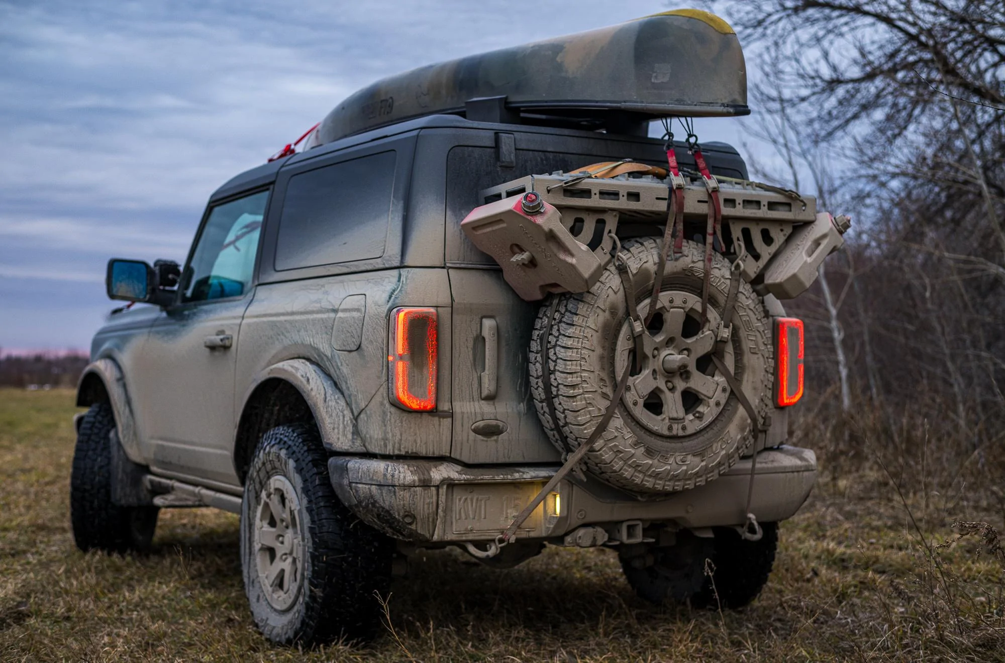

Since the Tcase got swapped, the rigs been absolutely mint. At the moment she's dirty and flirty. The Falkens have so much more grip than the KO2s in the snow/ice/mucky gravel roads. The 4A is an absolute must for the conditions of Middle Manitoba! The fatness of the stock sized 285/70 Falkens don't really fit too well with the @JcrOffroad Spare Tire Rack. I might have to make some offset spacers for the grippy feet that bit the tire shoulder blocks. The grippy feet aren't wide enough and the rack either sits too much towards the glass or leans away awkwardly.
Ford Bronco The Boreal Badlands November 20, 2023_5097-LR
Id like to give a shoutout to 3W Auto Life (@Daniela at 3W Auto Life) and BDUSA (@Rickperry) for a few goodies that will be appearing in threads upcoming!

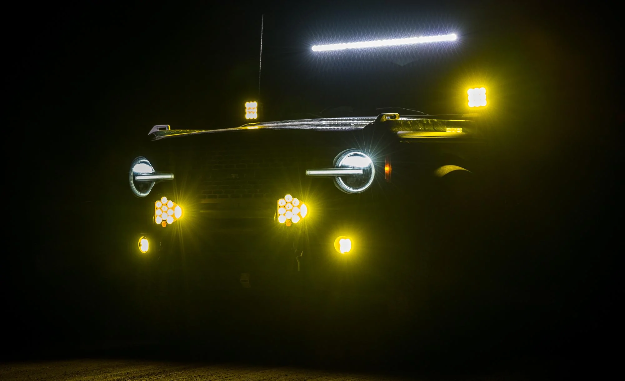

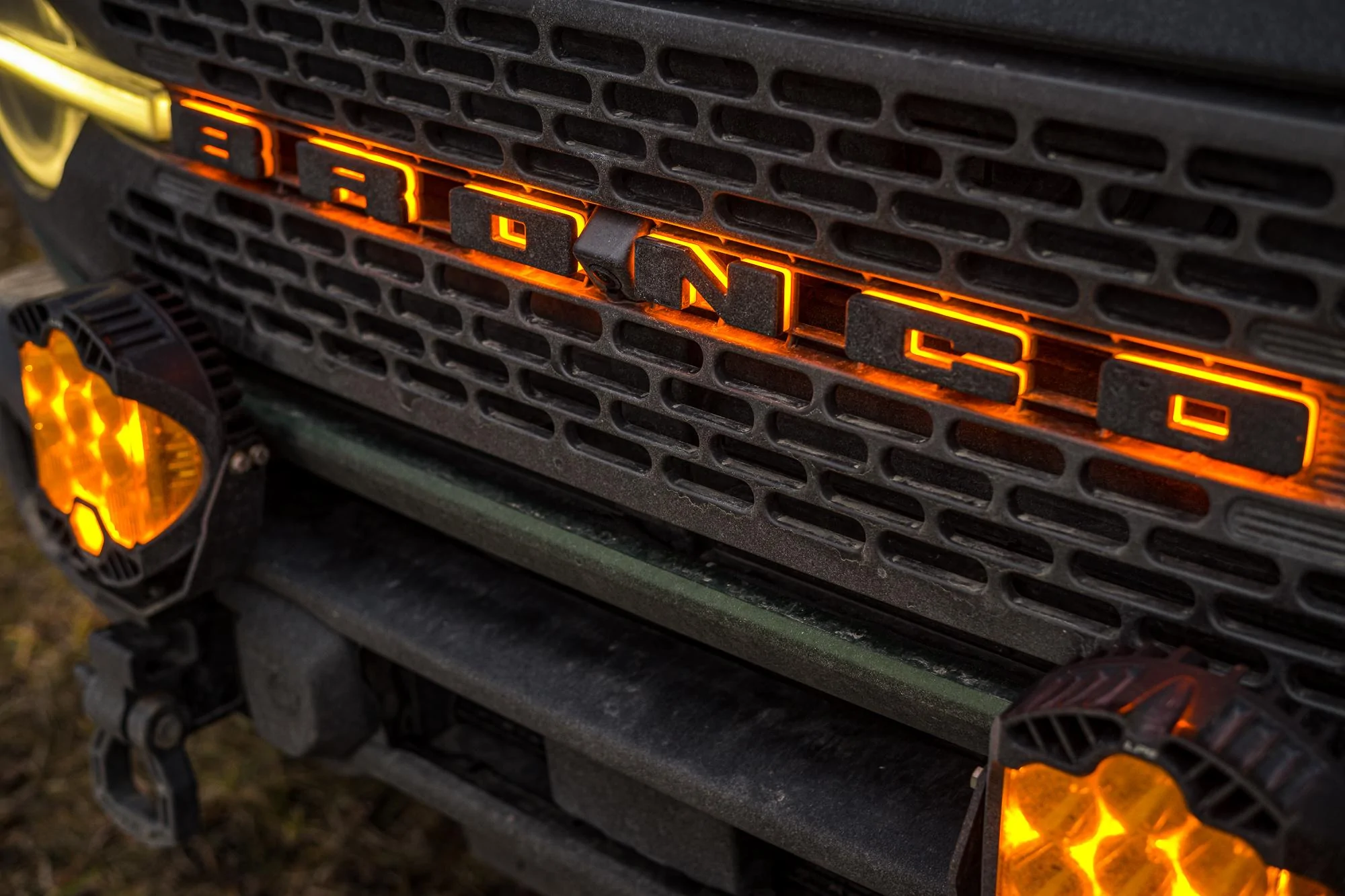

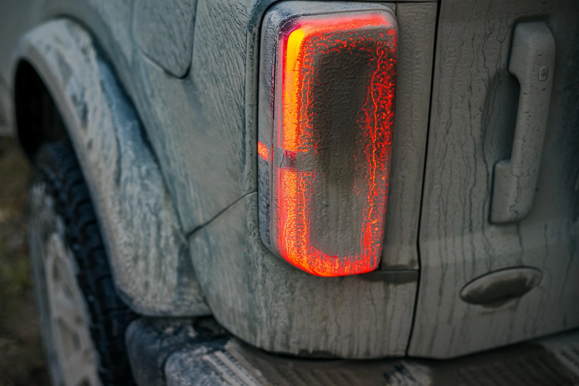

Second to last, the lights. Y'all already know, but any and all @Baja Designs, @Diode Dynamics, and @ORACLE Lighting products are absolutely top tier!
