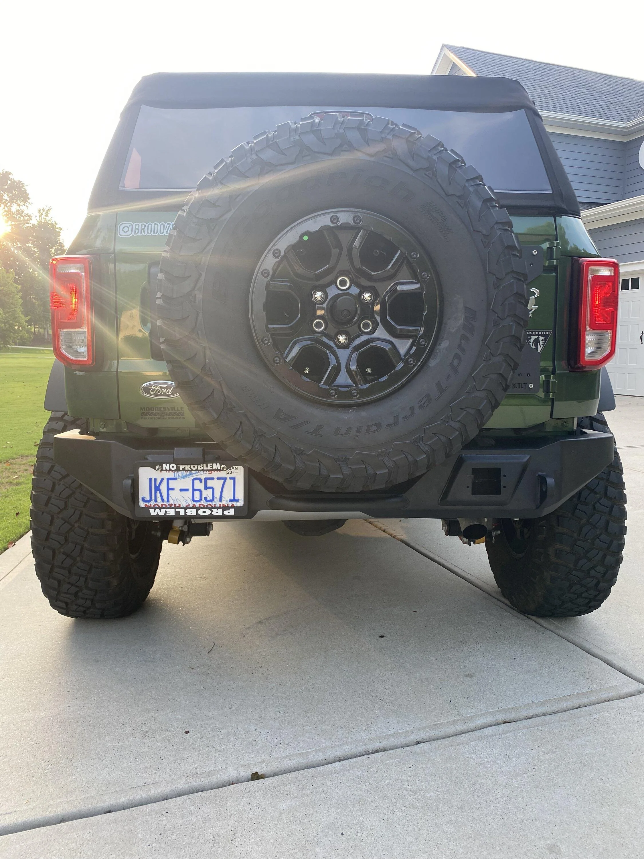

@LifestyleOffroad rear bumper installed. Thoughts on it:
1. They have plenty of options when ordering to configure it just like you want
2. I chose this specific bumper due to one of the options being keeping the license plate where it was, and they send you a spare tire relocation kit in case you change your mind.. kudos
3. Everything lined up 100% perfectly during install, not something that always happens for sure
4. It’s damn sexy

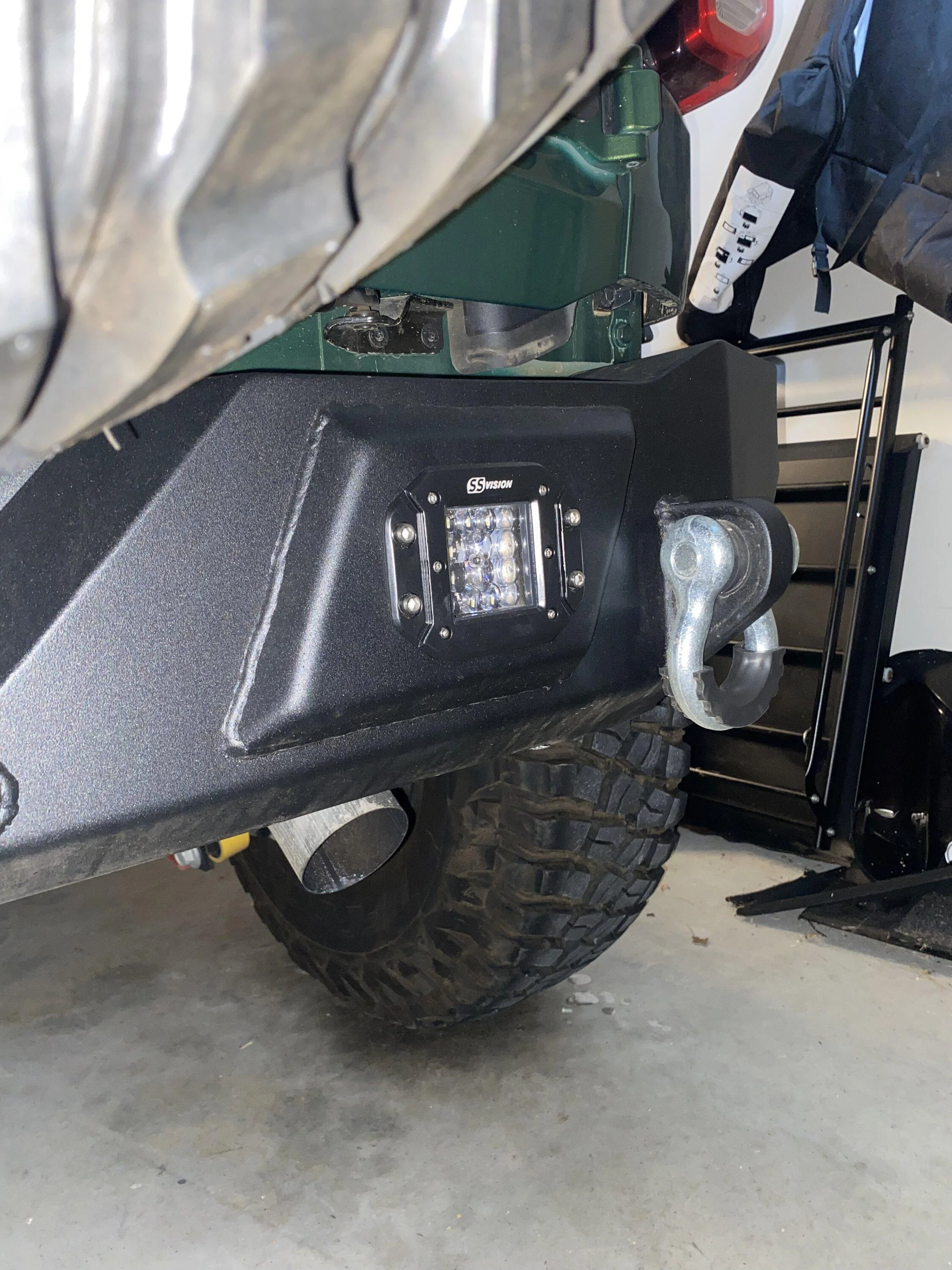

Small update. Added a light to the rear bumper. Since it will rarely be used, I violated my own rules and went with cheap Amazon brand. Also finished addressing the last of my rubbing issues since going to 37s. Trail run 2 weeks ago caught the front inner fender liner. i removed the 2 giant hunks of plastic and replaced them with JKS big tire kit brackets, and they really do pull that liner in significantly

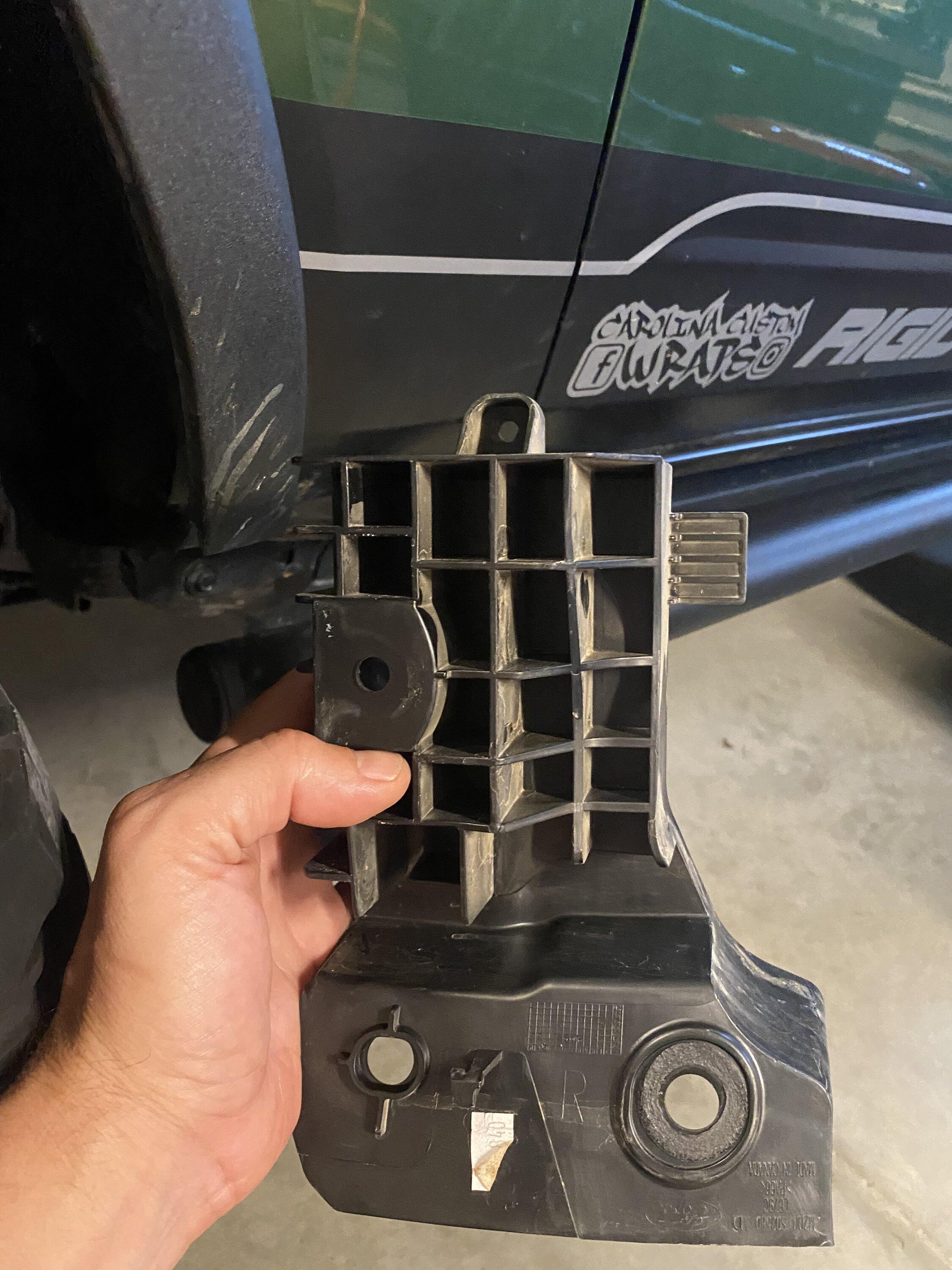

Can you tell me what these things actually do or protect? I’d like to delete mine so my 37 is clear as they are rubbing on these things
Sort of protect a wiring harness on each side, but near as I can tell they are mostly for shape. I’ve not had any issues
