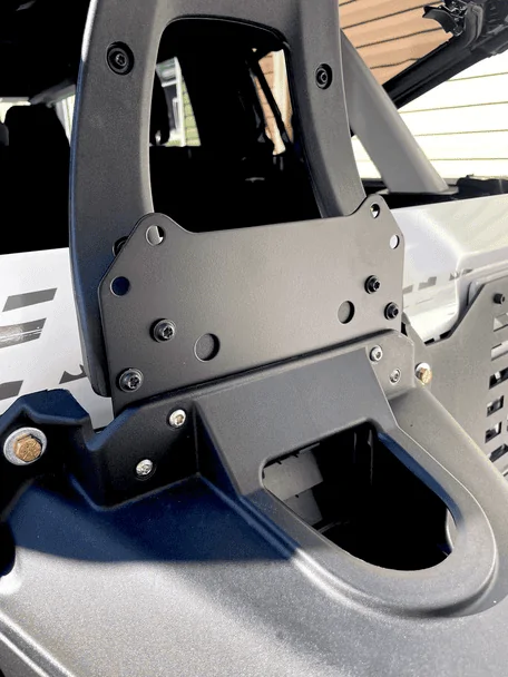

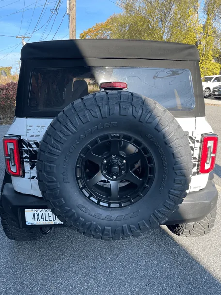

We actually manufacture a 3rd brake light extension under our KR Off-Road brand. It'll extend your factory 3rd brake light up a bit so that you can fit 35" - 41" tires
https://www.4x4truckleds.com/kr-off-road-3rd-brake-light-relocation-bracket-for-2021-ford-bronco/
Made right here in America out of stainless steel + powder coated black with a lifetime warranty. Certainly not the cheapest option BUT at the same time it's 100% American Made (and we also use Stainless Steel instead of regular steel, which can rust over time if you scratch it, the stainless won't rust if you scratch the powder coating off our bracket)

I tried the RC extension on mine, and it seemed to stick it up too high for 35's, so I want to track down the part from the SAS trucks.
RC bracket with SAS 35's

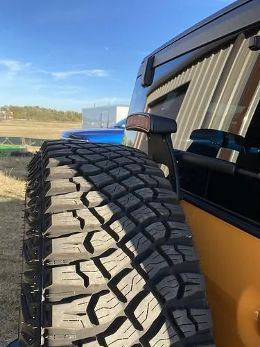

Can you post a picture of what your OB looks like with the 35's and stock wheels? trying to decide if I want to keep them or not
Noissuefound
Sep 3, 2021
US
Ford F-150
Ford Bronco Third brake light solution when running 35's? 05BE11FB-3DDE-41FC-873E-D06E7C1452BD
The tires are Yokohama Geolander 285/75/r18. They are flush with the fender flares.
