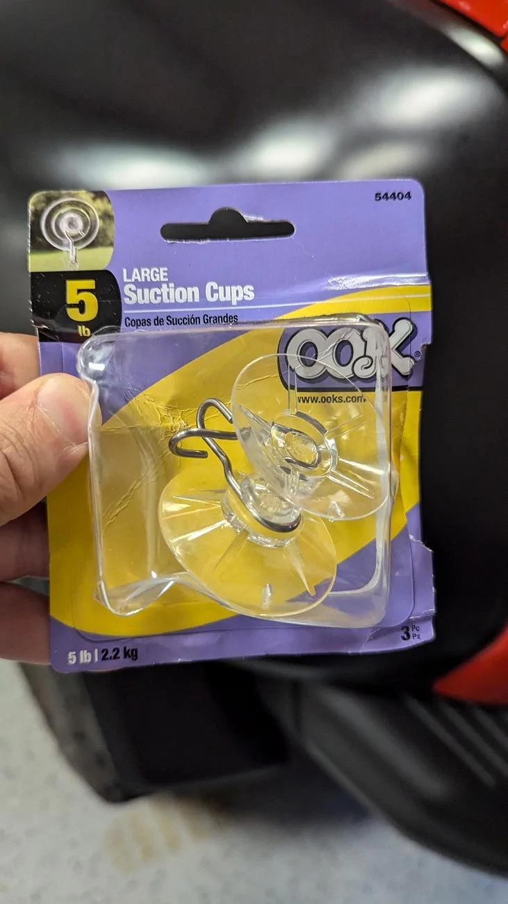

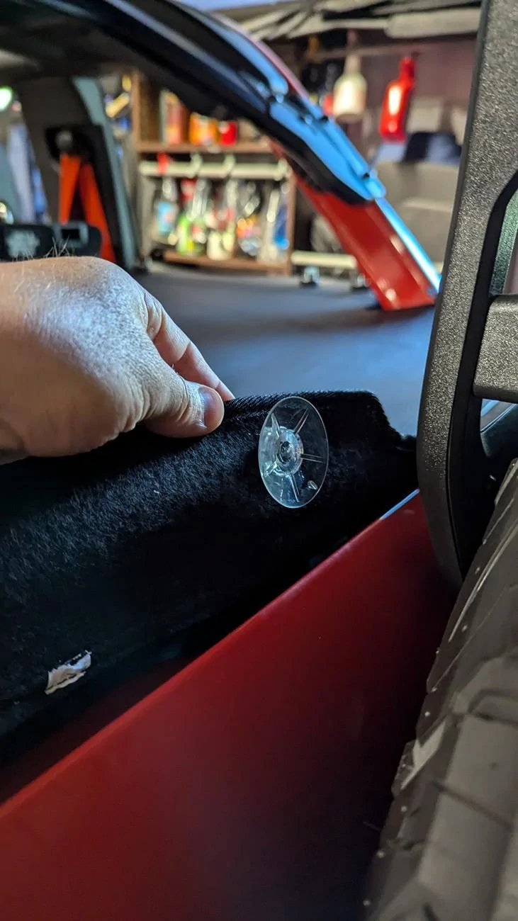

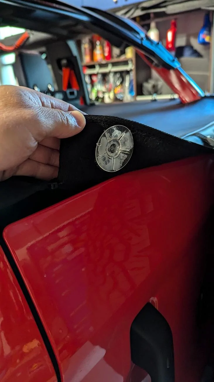

Home Depot suction cups and hot glue. Pop the metal hanger off the suction cup, unthread the straps from the tonneau cover, make sure to get the hot glue into the groove where the metal hook used to be, attach cups to the cover in 4 spots (2 each side) WAIT for glue to cool off before actually using them to secure cover .
This was not my original idea - someone on B6G posted it initially and it works great!

Thanks for info & pics. How do they hold up in the heat & sun? What about at highway speed? Looks like a simple solution. 👍🏼
Only had it on a few weeks - one of the first suction cups I did had come loose (heatwave in NY) and I was not very diligent in ensuring the glue got in and around the groove of the suction cup. also came to find out that ANY sort of alcohol based cleaner accidentally sprayed on the glue will essentially negate all holding properties of said glue (learned that with my paintless dent removal kit) Even if it doesn't last - it's still safer than those straps across the paint and attached to the edge of the door.
