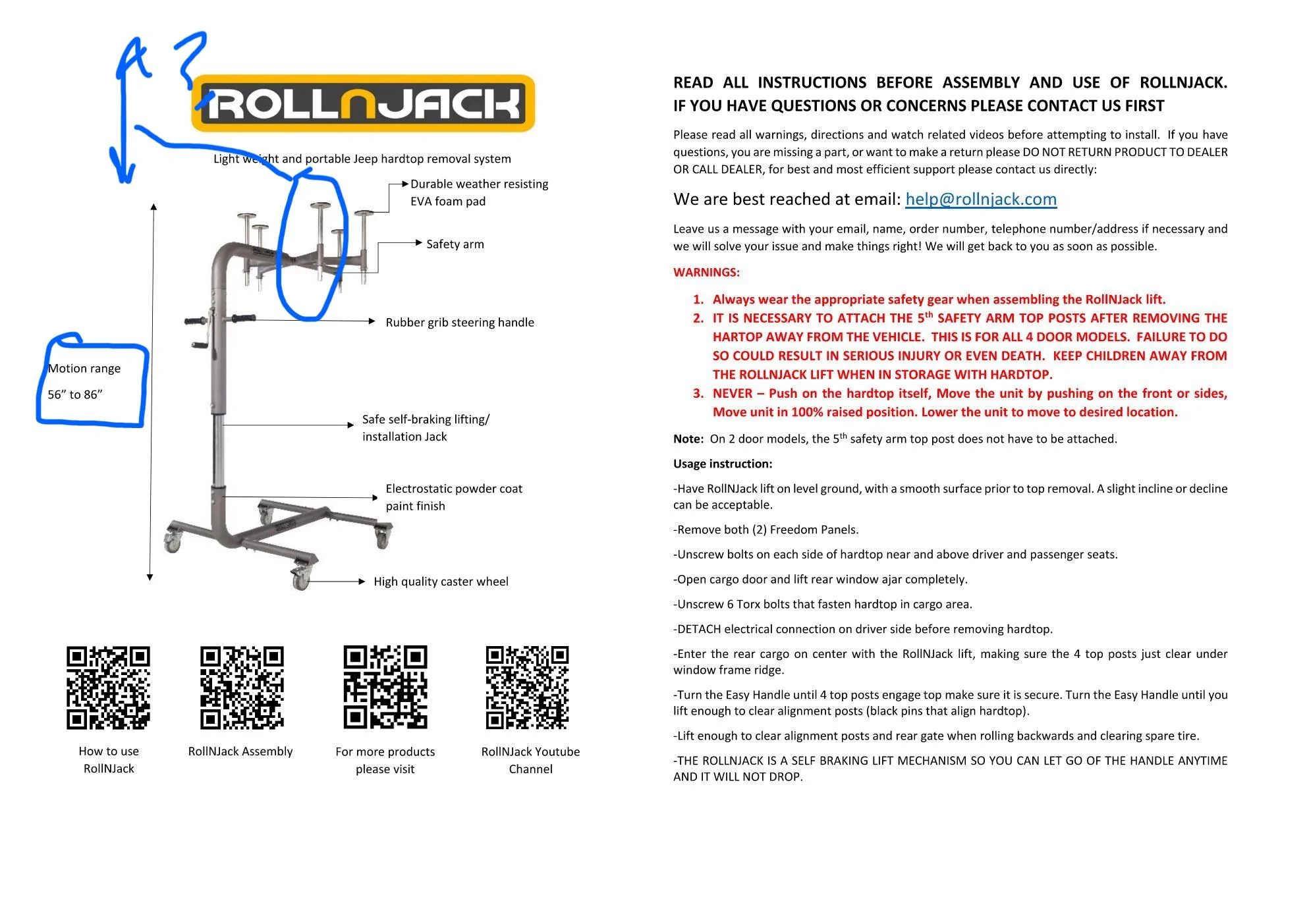

I am considering a RollnJack or TLP. One issue I face is I have a workbench and cabinets at front of my garage. Also I normally back the Bronco in and wife parks normally with her front nose of her vehicle pointing to the cabinets. Entry to the house is closest to her side so storing the top in front of her would block access.
I would like to continue backing the Bronco in. Is it possible to keep the top lifted/stored in a higher position so it clears the Bronco when backing in?
Borrowing a picture of the RollnJack someone posted earlier, it seems there is 56-86” of vertical adjustment in the main support. I would guess there is also a minimal amount in the lifting legs that are on the cantilevered portion of the arm.
My ceiling is a little over 8’ tall. Ideally I could get the top of the hard top near the ceiling. My other concern with putting in max (or near max) vertical adjustment would be if it gets wobbly the higher you go.
Hoping someone can confirm.
Relooking at this detail, 86” (7’ basically) may be the max height from floor to top of supports. With a few inches for hardtop thickness I think max dimension to top of hardtop is around 88”. Roughly a foot from my ceiling. Is that right?

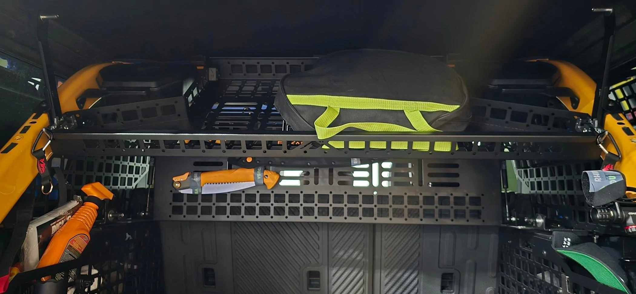

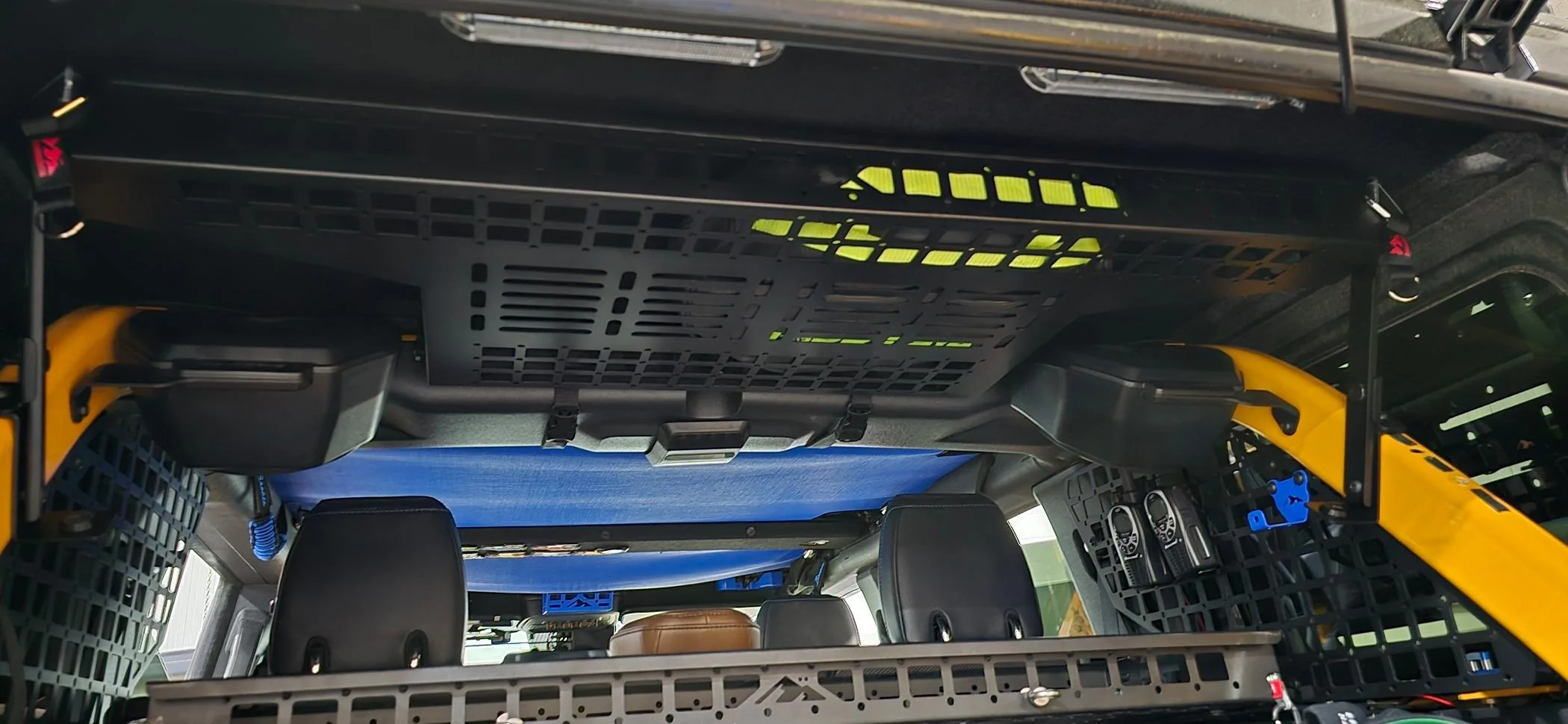

Do we know if the Rollnjack and TL will work with the new mountains2metal fold down attic tray?
Ford Bronco TopLift Pro vs. RollnJack 20240411_120824
Ford Bronco TopLift Pro vs. RollnJack 20240411_120617
When I purchased my attic tray at Super Cel they said it would. I test fitted the top lift pro on mine and it will work. I’ll snap a picture this evening when I’m home for work and installing the lower cargo tray. But with the tray folded down it fits right in.
Sorry I couldn’t get the photos of it this evening. I installed the lower cargo tray and ran out of light and time. I’ll get the photo with the TLP with the Attic tray over the weekend.
