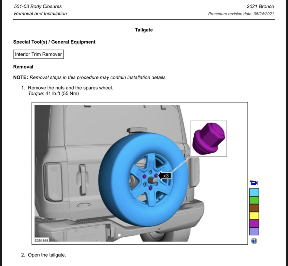

Does anyone know what is the torque spec for spare tire?

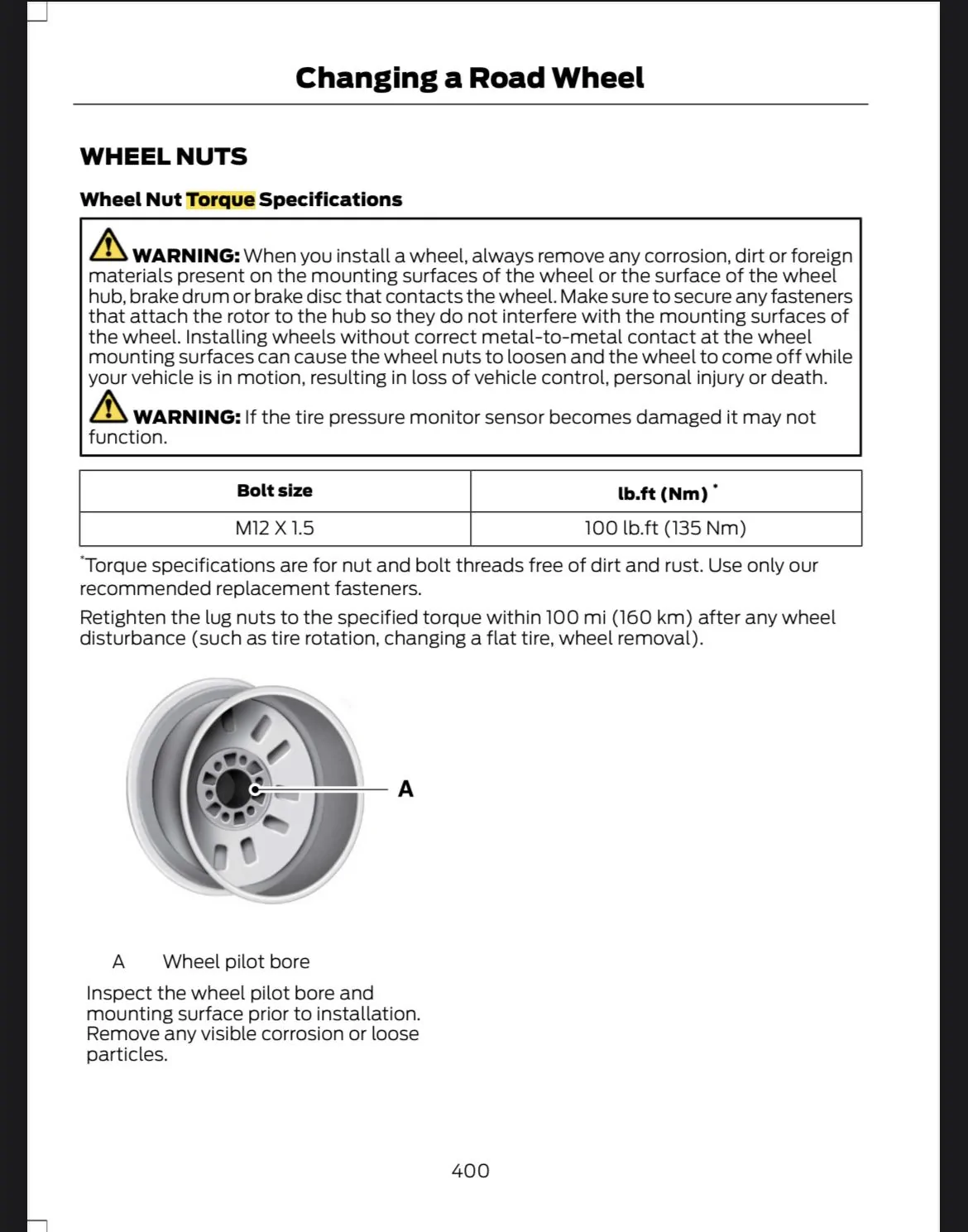

If I understand correctly the torque spec for the wheels to body is 90 ft/lb.
Does it the same for the spare tire as well?

Perfect, thank you.
Is the wheel torque to body 90lbft or 99lbft?
