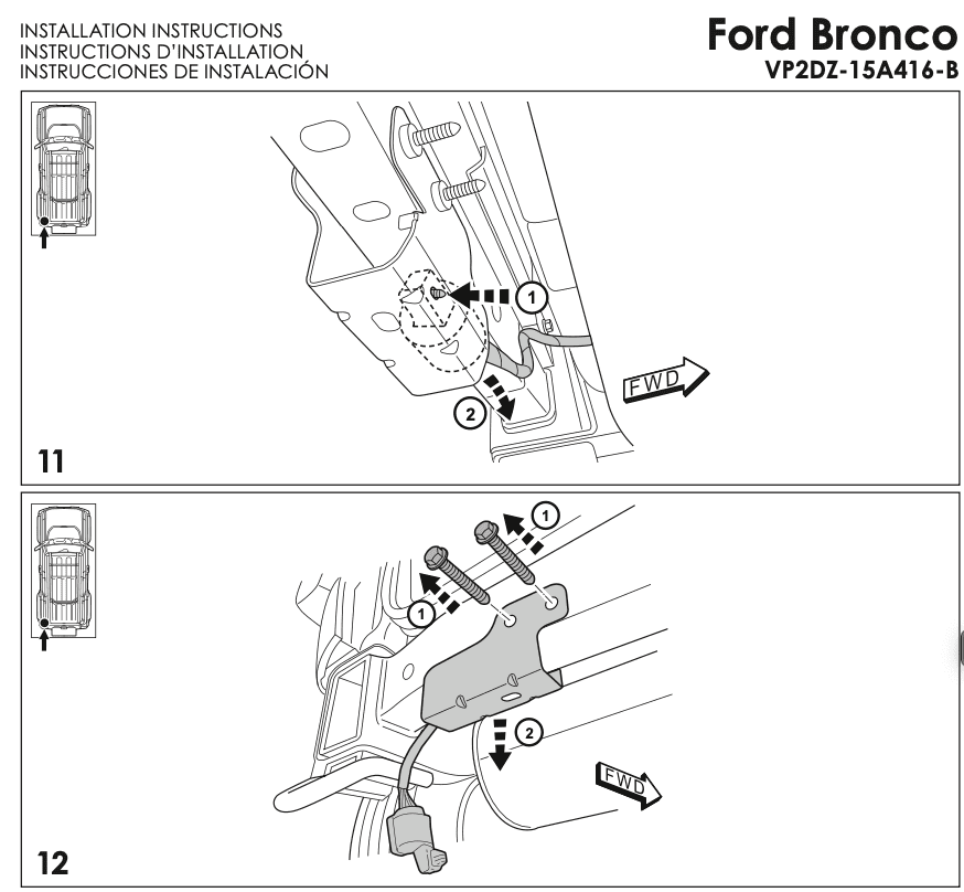

@flip & @Ducati1098 - any idea when the pre-wire was added on the assembly line? Mine is an 08/16/23 build and I have the harness, module, and hitch in the box and was wondering if I had to splice or not. I have the Lumen kit.

As far as I know this just started for MY24. So I don’t believe yours would be prewired.

My understanding as well.
BUT, should be easy to verify. Connector for the wiring harness is behind the bumper and a shield on the driver side. If it's there, you're in luck. Screenshot from the instructions @flip posted:
I'll check on that one, but was more concerned about having to insert pins at the front drivers fender wiring.
Thanks guys.
