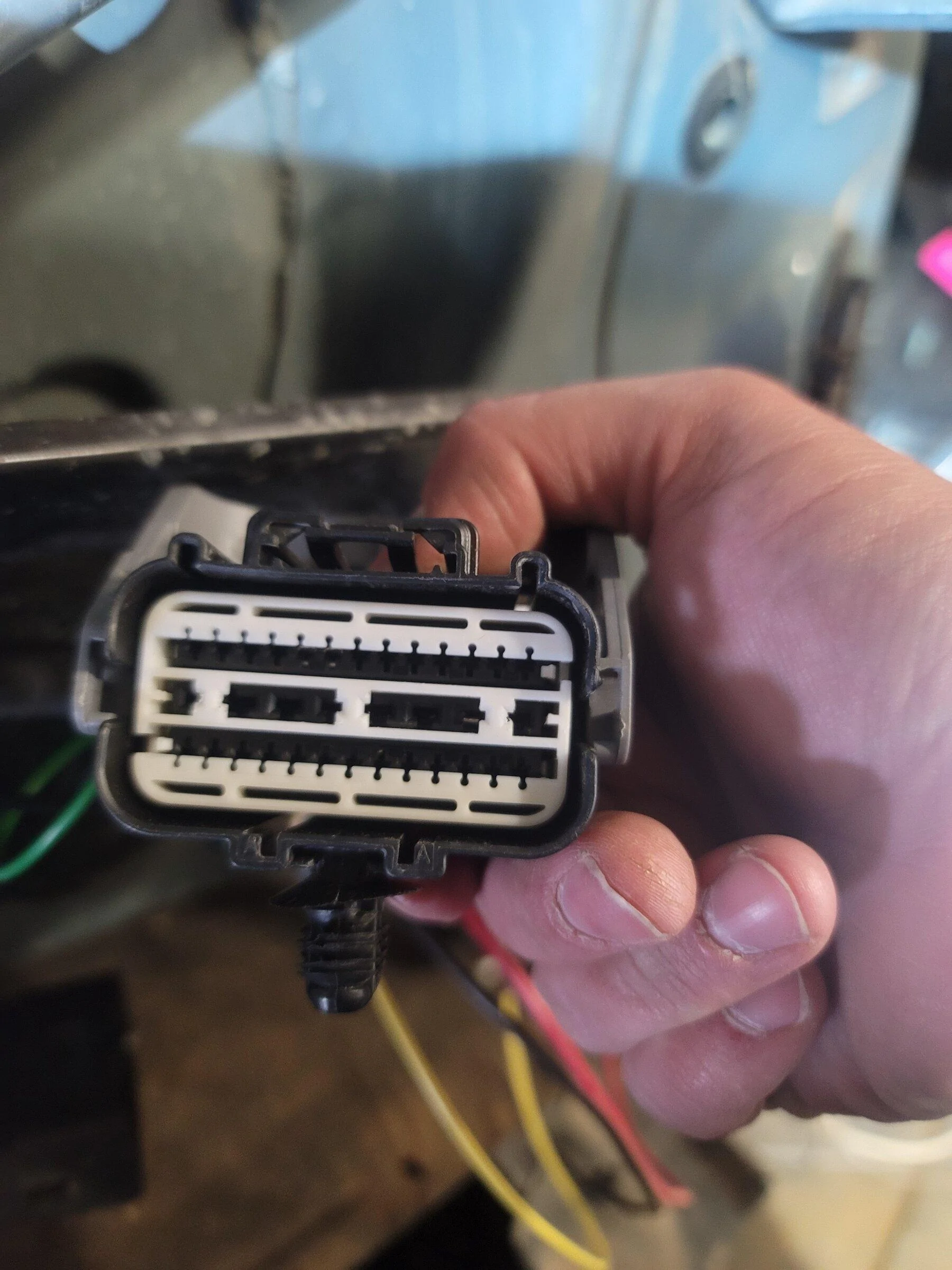

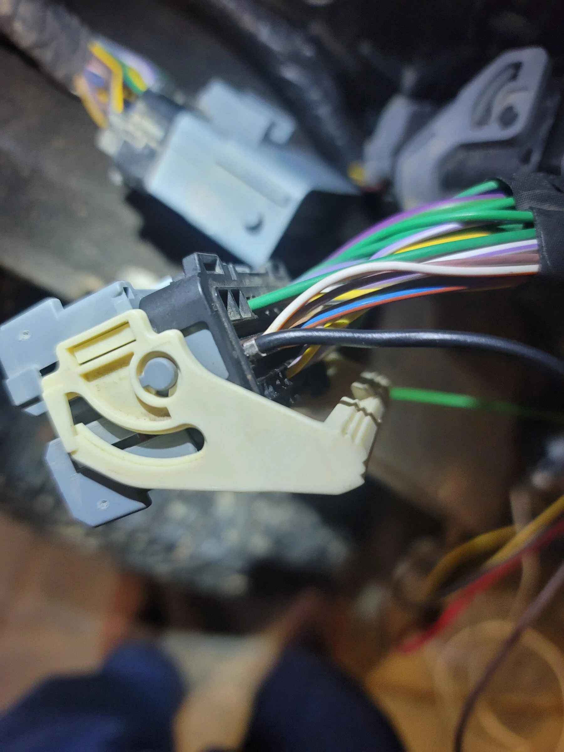

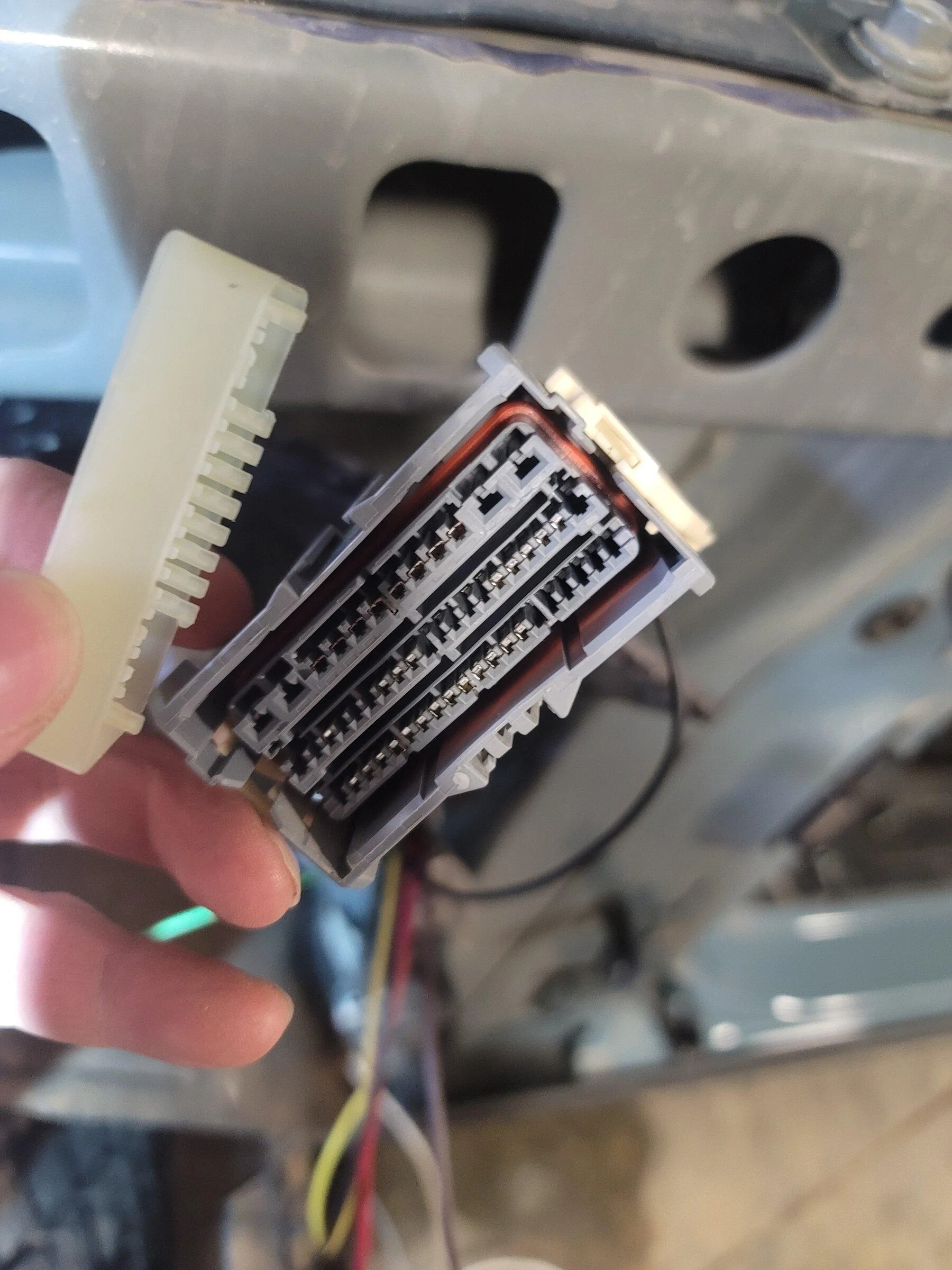

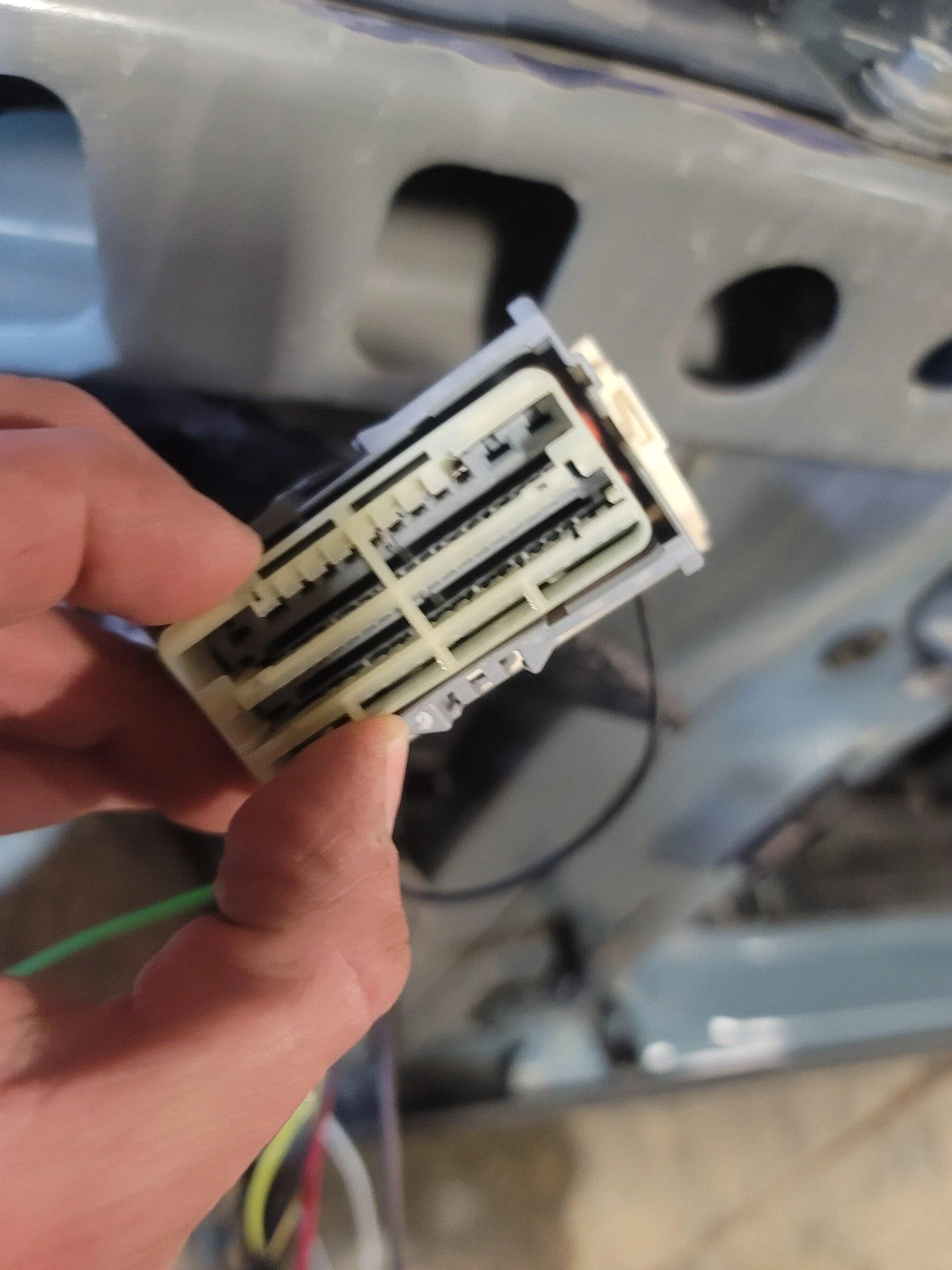

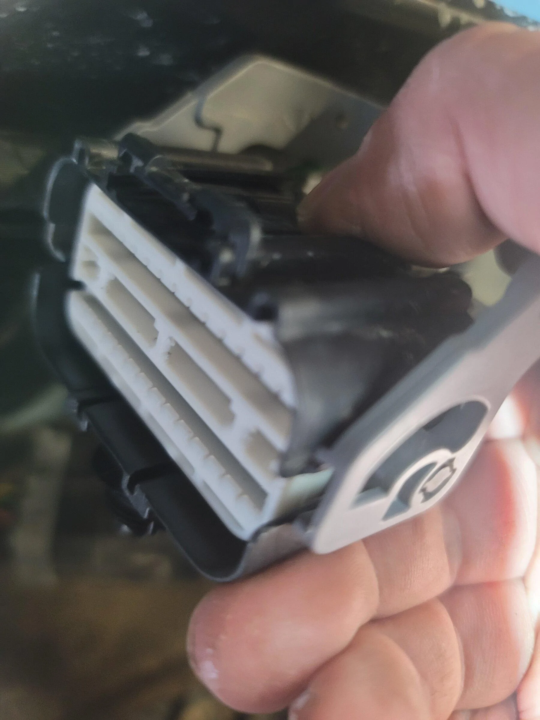

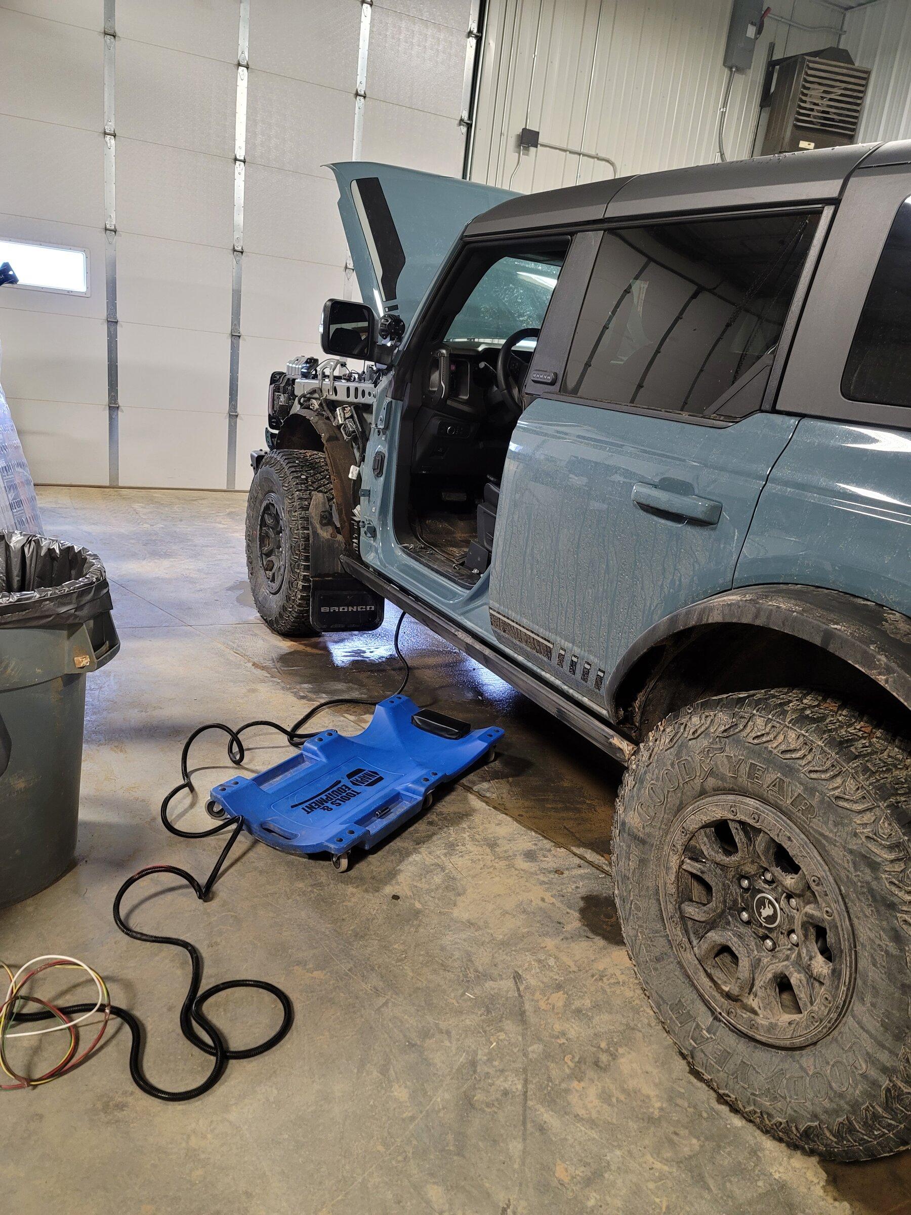

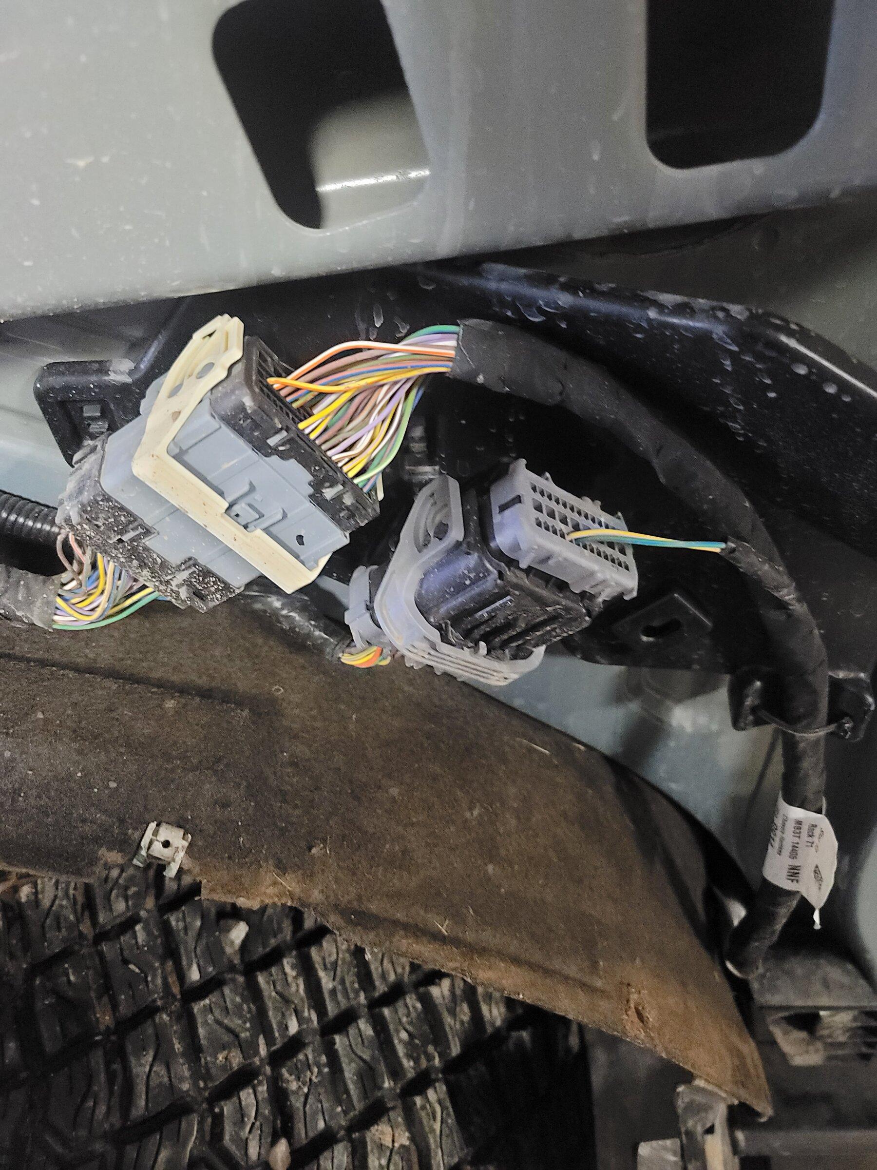

I built a harness but waiting for the rest of the pins to show up. The plugs are behind the driverside fender that you will need to run 6 wires from the front to back 5 wires go into the connector that has only 2 wires coming out of it and one goes to the big cluster if you want reverse lights. The ground I just grounded in back. I messed up my order for pins and ordered a few wrong so I currently only have reverse lights and tail lights at the plug haha oops. You will also need the trailer control module from ford to plug in that plugs in behind the panels on the driver side cargo area will either need forscan or a dealer will maybe turn those features un for you. You will need to pop the plugs out of the connectors like in the photos the the back side will need to be uncliped and slid up the wires so you can break the plugs out to beable to slide your new wires and sockets into the connector.

Remove the front drivers tire and fender liner. Connector 201 and connector 105 are right there. The top connector is 201, bottom 105.
You will need to disconnect the battery in your bronco for this!
Disconnect c201 and c105. Disassemble c201 and remove the plastic weather proofing pins from the gray backing piece for pins 15, 16, 17, 18, and 19. Remove the corresponding pins from the new pigtail WPT-1607. I broke the white piece in the front of the existing connector, so be careful! Luckily the new pigtail one came out without breaking and I was able to replace it. The starting and ending pins are labeled on the back of the connectors to help you install in the proper locations.
You will need to also disassemble c105 and complete the same process as above to install a new pin pigtail into pin 40 for reverse lights(if you want them, and I did).
Once the new wires were in place and the connectors reassembled I used the factory crimps and heat shrink that comes with the connector to attach the new black group of 6 wires to these wires. Keep in mind that not all of the wires will match the factory colors. I matched the color of the factory as much as I could, then I documented which colors I had to switch the other wires to for installation of the 7 pin trailer connector in the rear.
