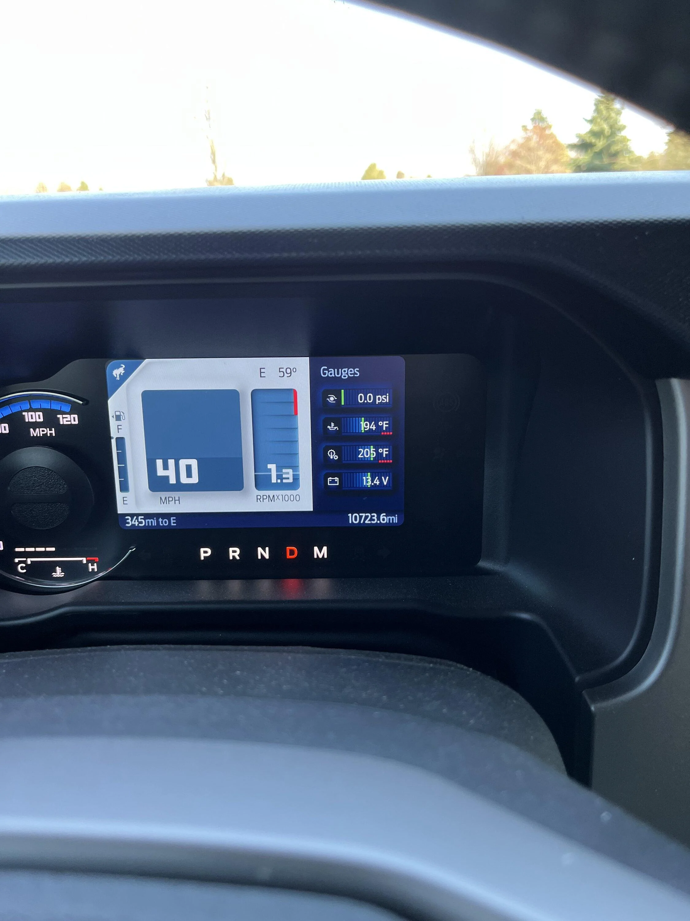

Alright, so I am just a little concerned about this, my average transmission temps are at 205 degrees.
Ford Bronco Transmission Temps E4B29DFF-8FAA-4C1C-9832-8655DA4AEC68
Soon I will be towing my 2500 pound camper through KY. My first concern is how much higher will this temp climb when towing? Second concern is would adding 35” tires to my OuterBanks causing more temp problems? Is the transmission between the Sasquatch package and the Non-Sasquatch package the same? I know the rear end is different when you upgrade to Sasquatch.

That gauge is deceiving. It looks hotter than it should be. Switch to the individual transmission temp gauge and it’ll show your temperature right in the middle where it should be.
Normal operating temperature is 206-215

Ducati is right. nothing wrong with that. Mine hovers between 165 and 187 for my freeway driving. city driving and sport mode make that number go up. Mine has been around 205ish with aggressive, sport mode driving

Same, mine will hover around 195 for most city driving, hovers around 210ish in 4H offroad, and really getting after it with some climbs, i've seen it climb to 246 very briefly. It just kicks on all the fans and comes right back down.

I haven’t, but I am a Ford transmission technician. So I can say with confidence that 205 is nowhere near over heating for these transmissions.
