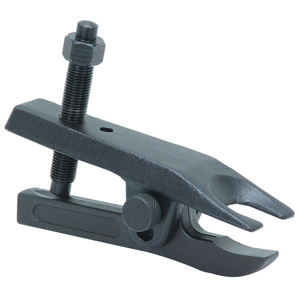

Thought I'd install perch collars today on my 24 BL Sas but I can't seem to get the control arm to release the ball joint. Been whacking it pretty hard, both hanging free and on the jack stand. The book shows a special tool, 204-592. Before I go there does anyone have any tips.? Much appreciated.

I couldn’t get mine out either. I ended up just going to the LCAs instead (was doing suspension so needed to get aligned anyway), but thought real hard about getting a joint puller

thx. I'll let it soak in WD-40 for a while first. Probably will need a puller
