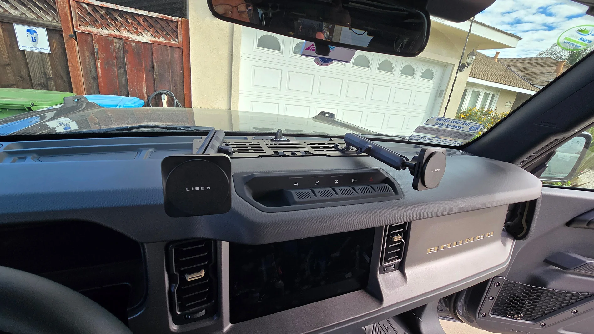

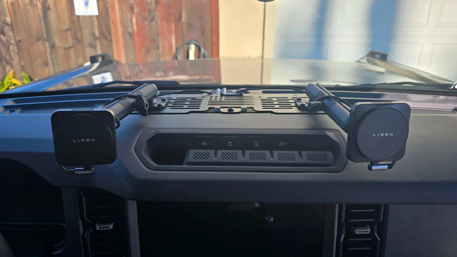

Sorry for late/old response. I successfully run two Magsafe chargers from my 2026 Badlands dash connect to charge two Samsung S24U phones. No issues. Here is my setup:
Oh, where'd you get the arms with the nice cord management?
Bought the parts on Amazon. I chose a Bulletpoint Mounting Solutions RubiGrid Metal Dash Mount Phone Holder with two Lisen MagSafe chargers for me and my wife. I ended up going with FANAUE Aluminum Mounting Arm - Dual 20mm arms, and Rigdance 20mm to 17mm ball extensions, and 1Zero ball mounts (all from Amazon).
