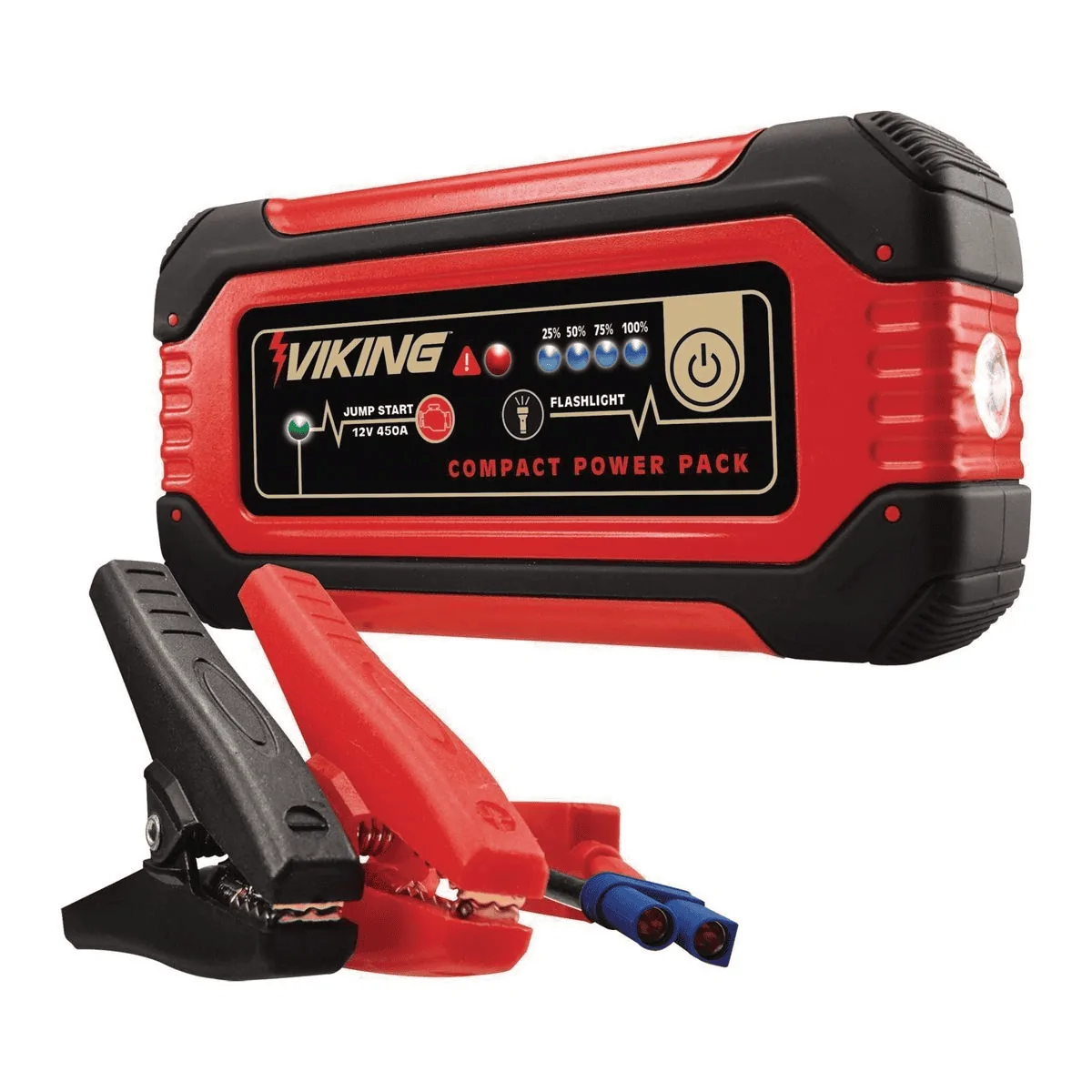

Get a small, cheap jump box to keep in Bronco then you may not even need the jumper cables. You can keep it charged using the cigarette lighter. even if it's not fully charged, it will still have enough juice to unlock the tailgate.

Ironically, folks who bought their Broncos from one of the local dealers here are receiving these portable jump starters in the mail lately. I'm not sure if it's a gift from that particular dealer, or if the rest of us are getting them from Ford. Maybe this issue is the reason!
