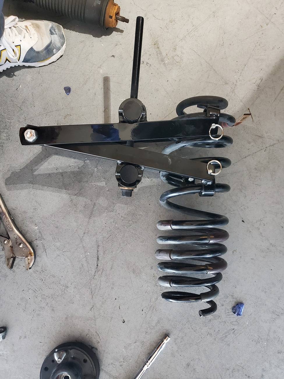

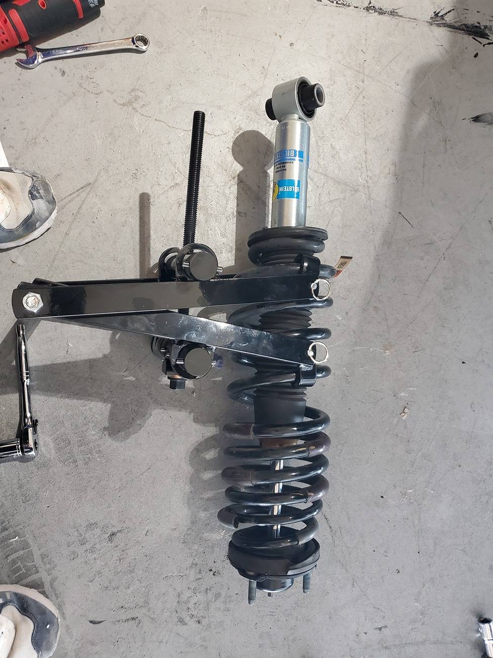

I'm alive. Actually, this is a good, easy to use and dare i say safe compressor. I mean, other than a wall mounted professional shop spring compressor, this Harbor Freight compressor has to be the best option over all other retail and rental compressors, unless there's another design out there. My local shop wanted to charge me $50 to compress and adjust each strut, not to mention driving there, driving back yada yada
Made in Taiwan, so there's that to consider.
In the end it got the job done without fuss or issue.
