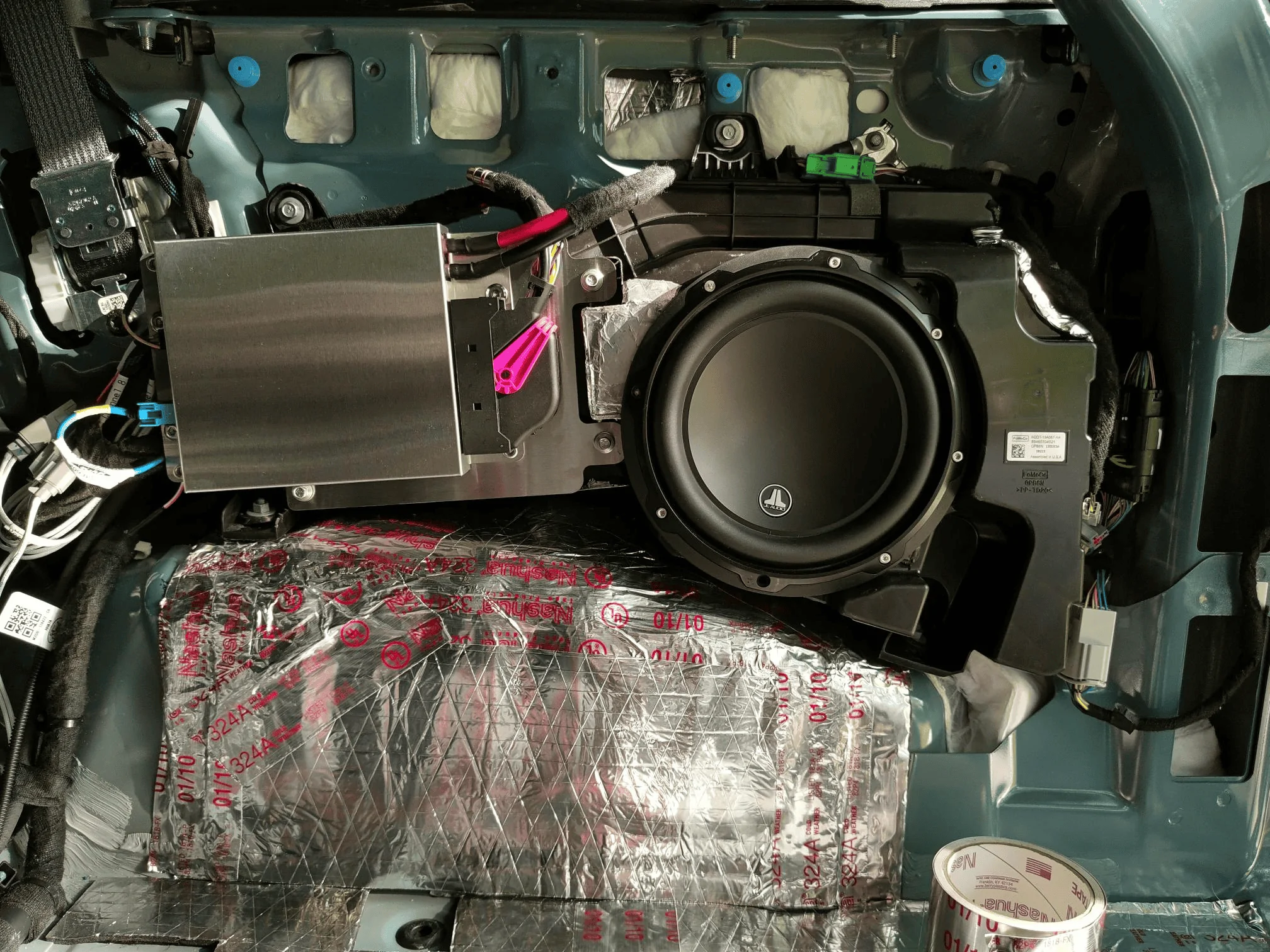

The amplifier:
https://mobridge.us/product/mobridge-bo-a2b-ford-amp/
The Bronco kit (with interposer and mounting plate) and power harness:
https://mobridge.us/product/ford-bronco-amplifier-plug-and-play-a2b-copy/
What it looks like as mounted with trim panel removed:

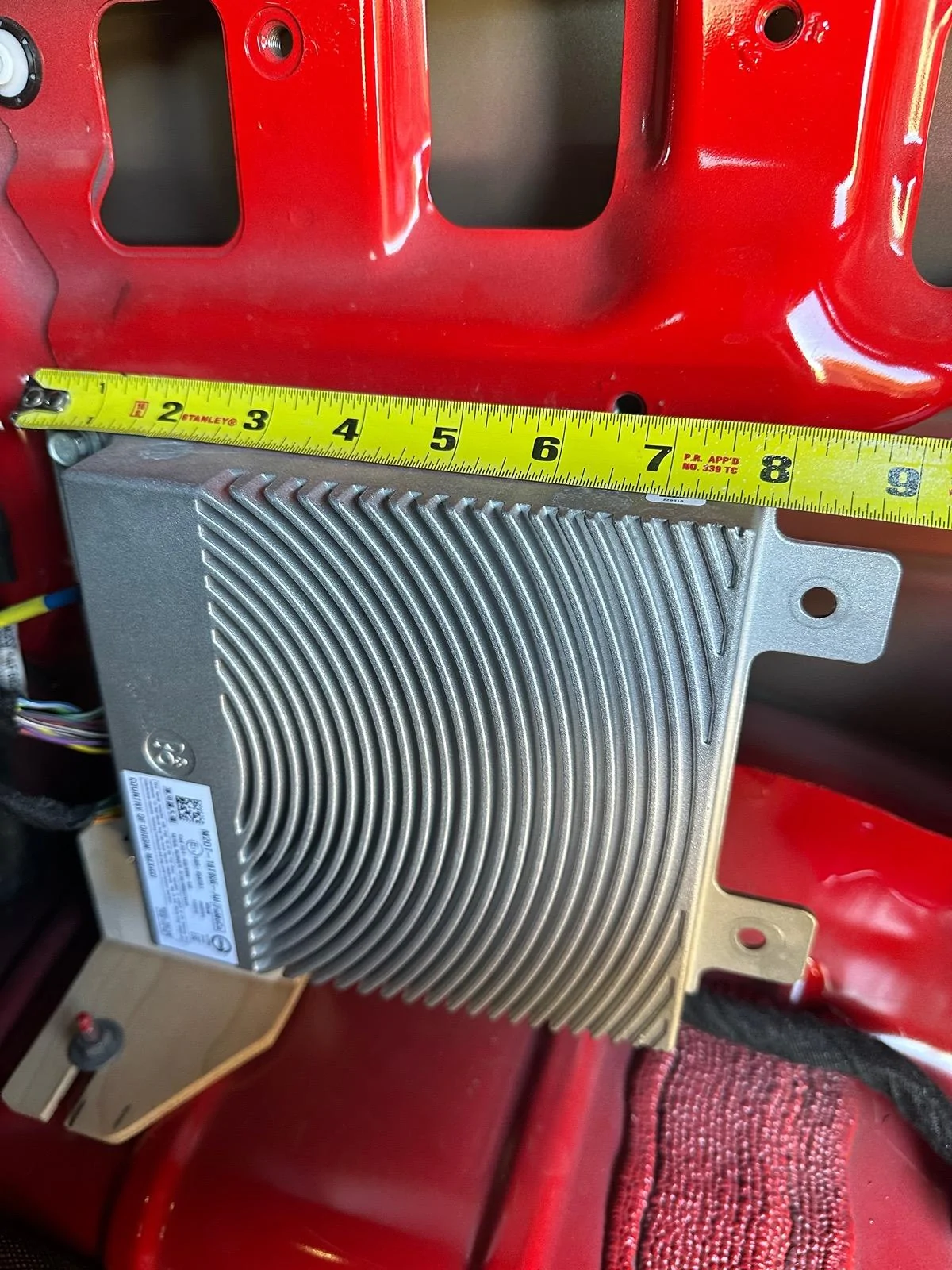

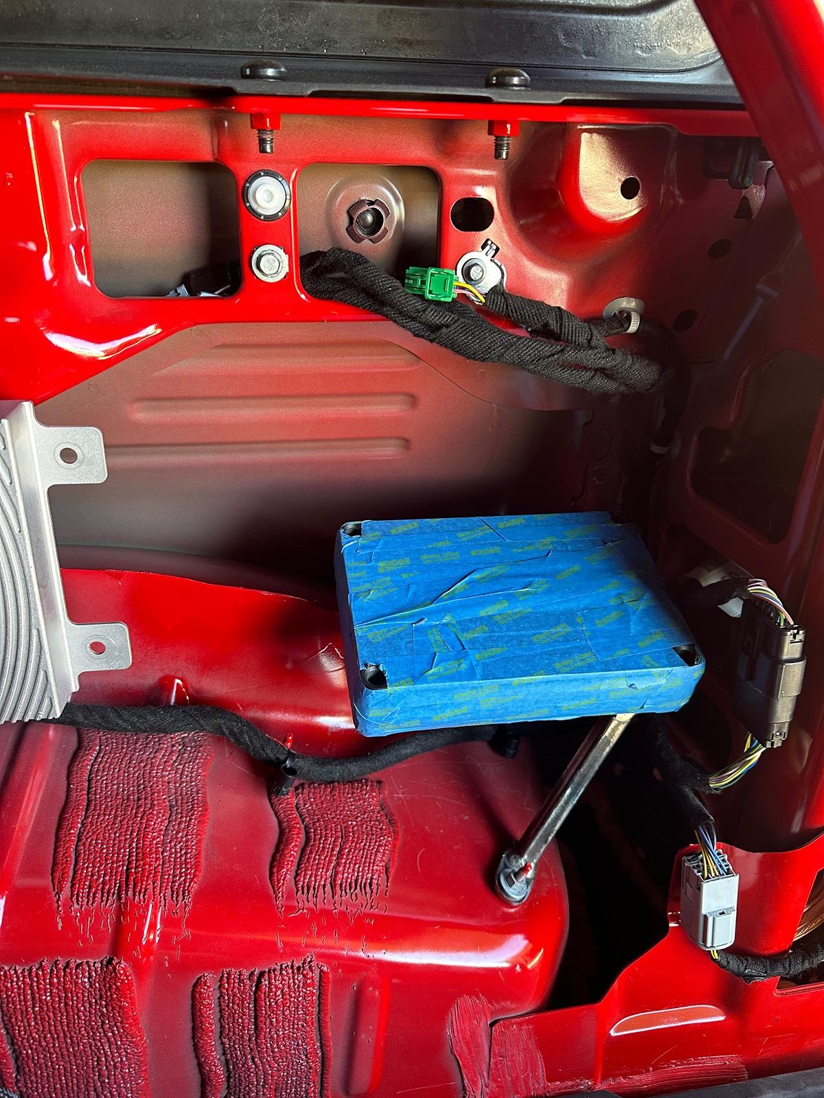

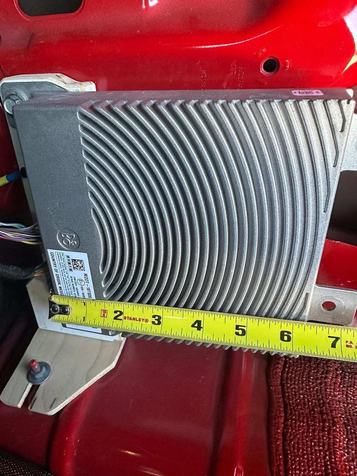

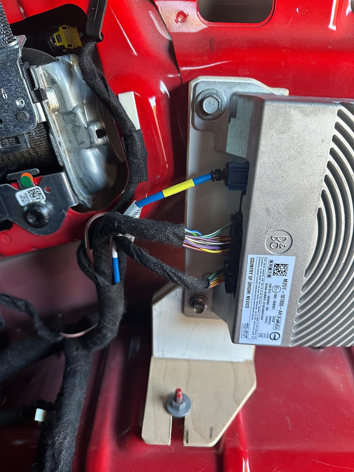

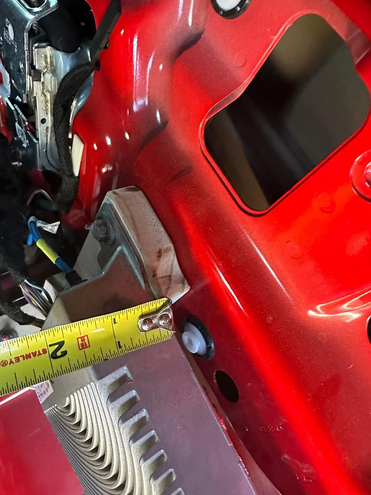

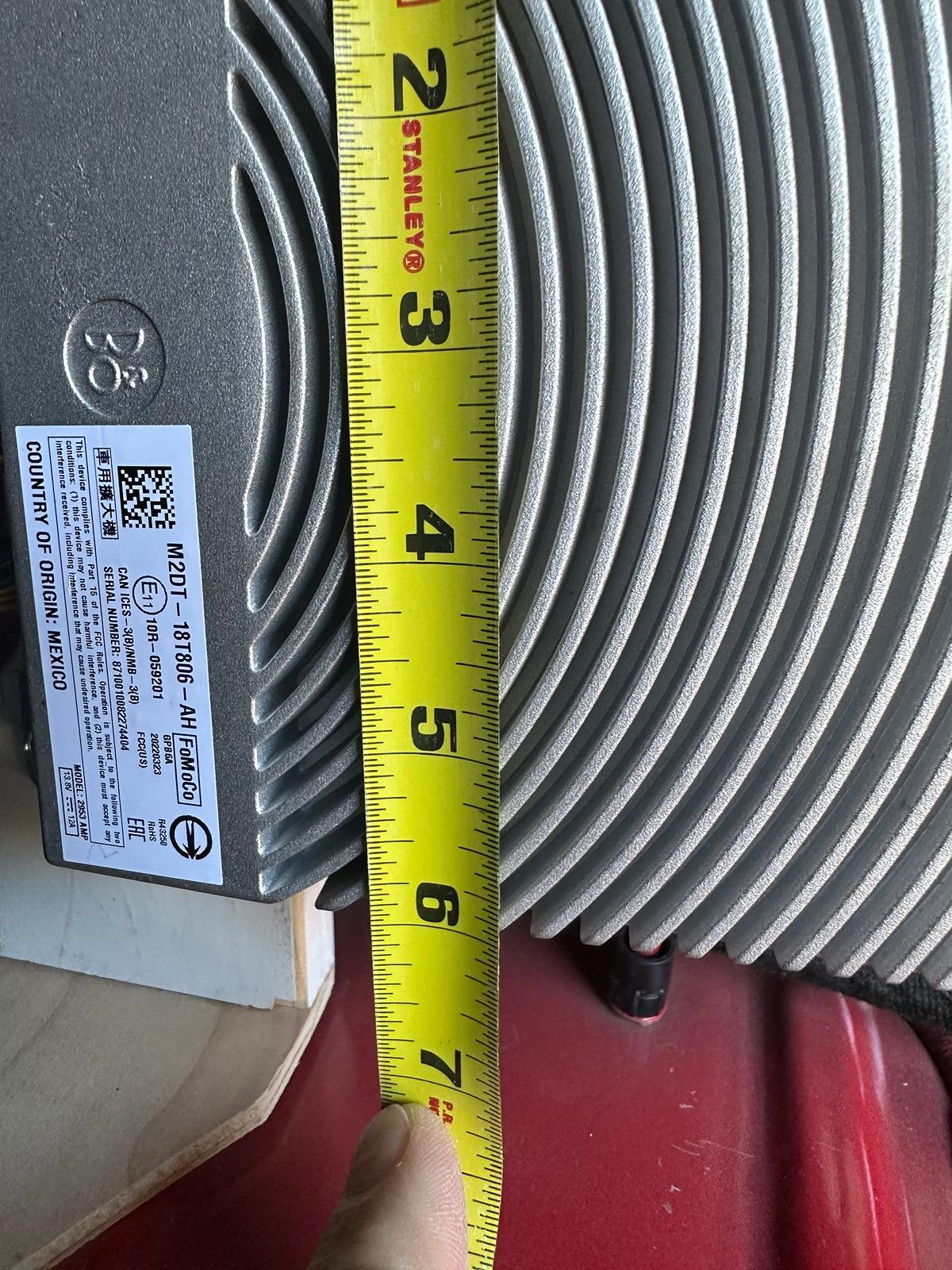

anyone have the B&O stock amp out of their Bronco to tell me the dimensions of it ?
My amp is semi-out. Relocated while building my amp rack. Hope these dimensions help.
