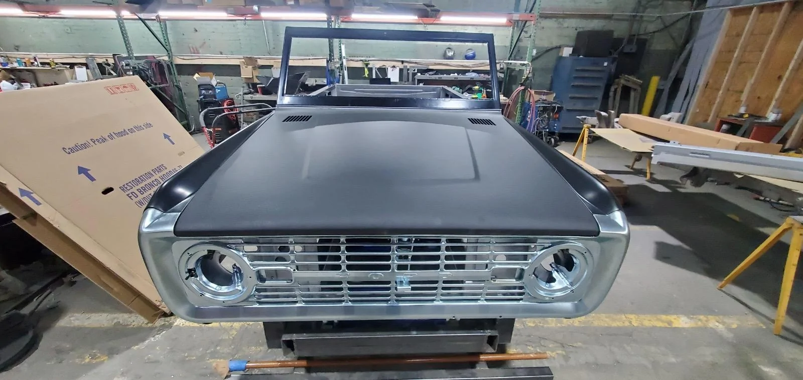

Here’s my new body waiting to be put on the old boy, pictured next to my Black Diamond
