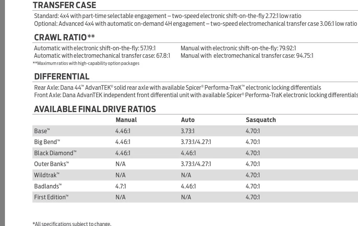

The only real hit will only be from the weight of the tires. 4.46 is not too low of gearing with the wide span of ratios we have with either the AT or MT. In fact I'm disappointed they didn't give us the 4.7 on the MT but so be it.
I assume you are talking AT since that's the only way you would have 3.73s. Comparing to the base 30" tires, 3.73 equivalent would be about a 4.0 ratio on the BD. So you'll effectively run 10% higher RPMs in your highest gear, but if my experience with other 8/9 speed transmissions such as the Jeep Cherokee (rental) is any indicator, you'll rarely actually make it into that top gear anyway. So bringing the ratio down 10% just means you'll be in 10th gear a little more often.
I would expect about a 5% difference between Base and BD, so ~1 MPG. But as they say, YMMV. I currently average a measured 36 MPG in a vehicle that's only rated for 30, as an example.
I thought all 7Ms had 4.7 diff ratio?
