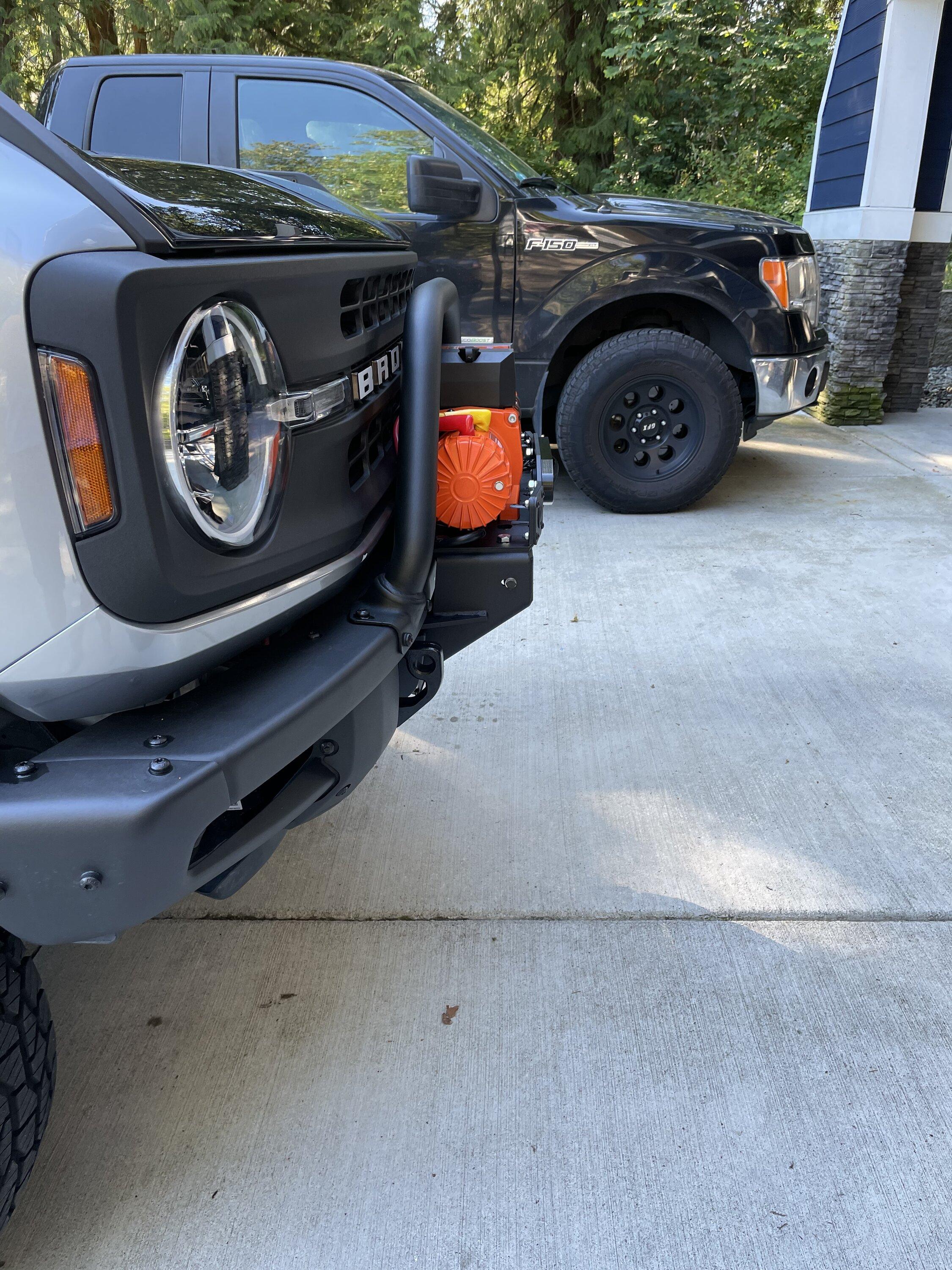

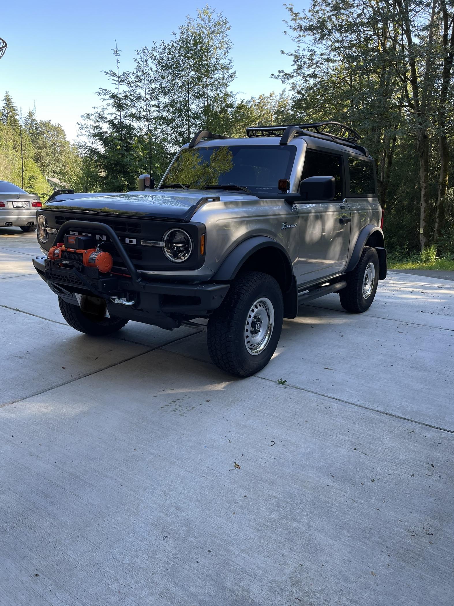

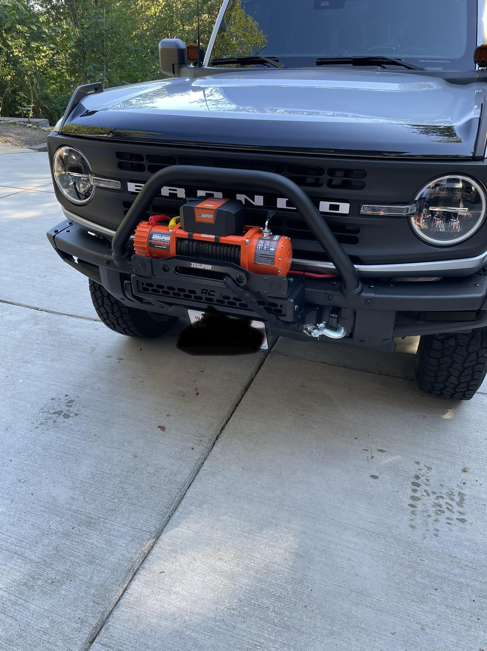

Yesterday I did a thing and installed a winch. Today I trimmed the plastic that surrounds the recovery points. What a PITA that was. Overall I’m really happy with the Rough Country mounting kit.

I saw that winch mount this week and love how high and tight it is. If I can find a mod bumper takeoff to buy, I plan on doing the same thing.

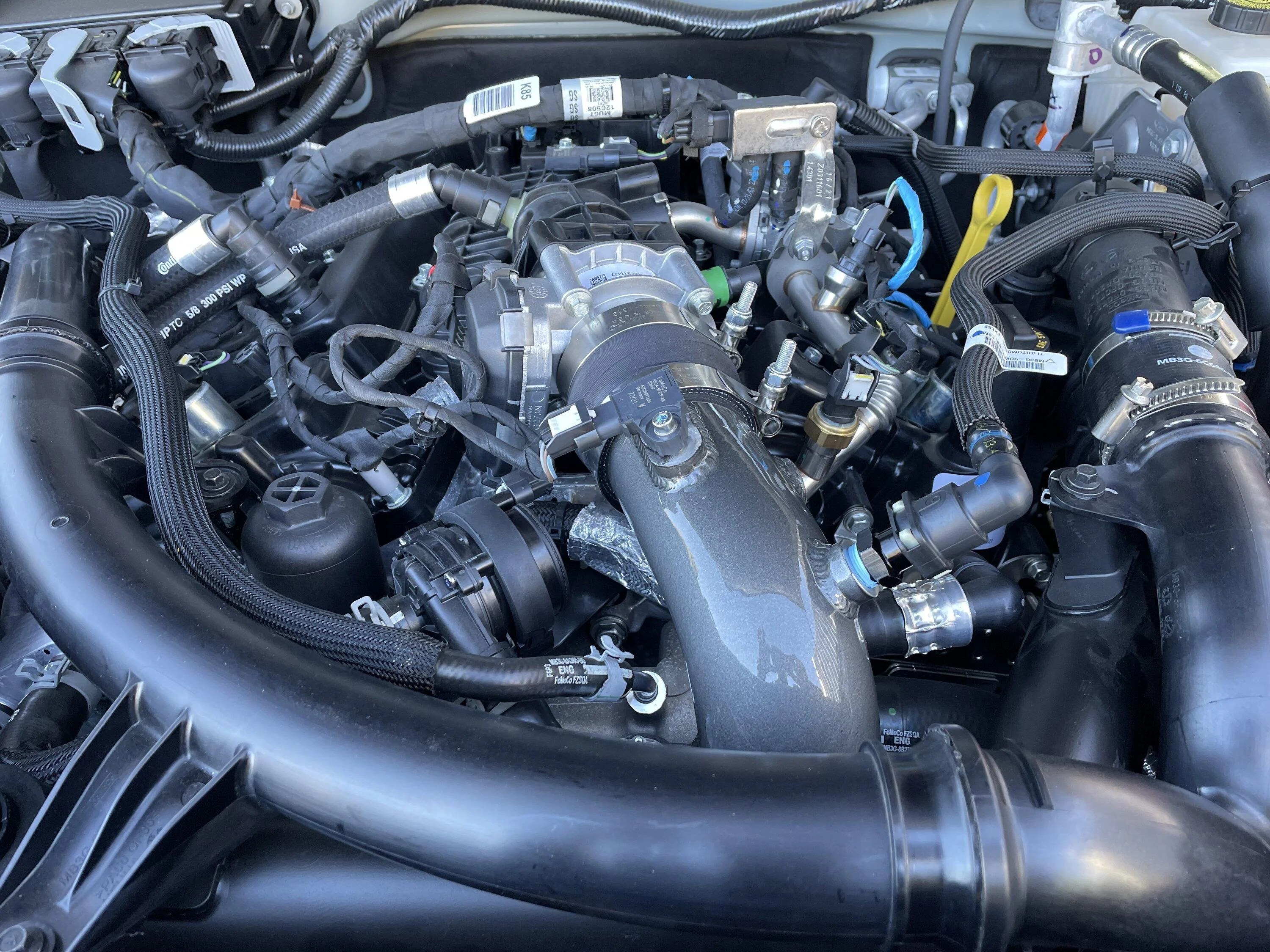

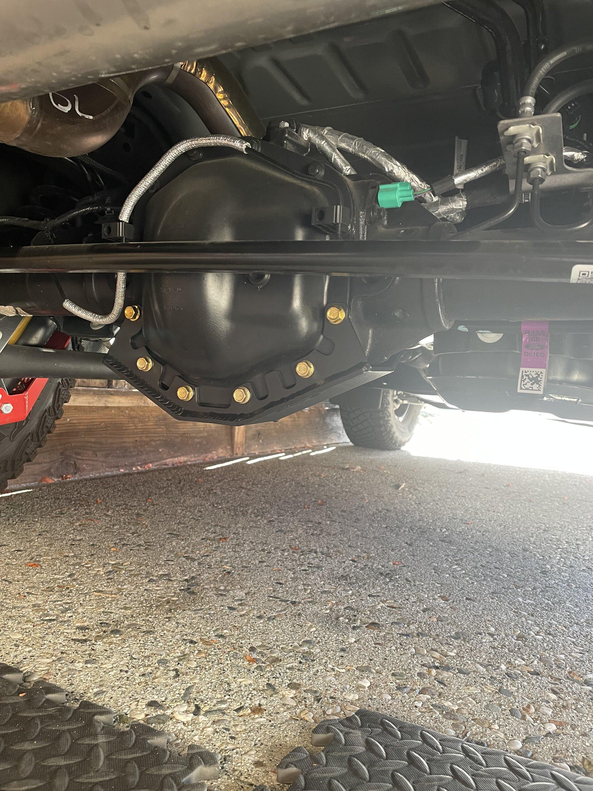

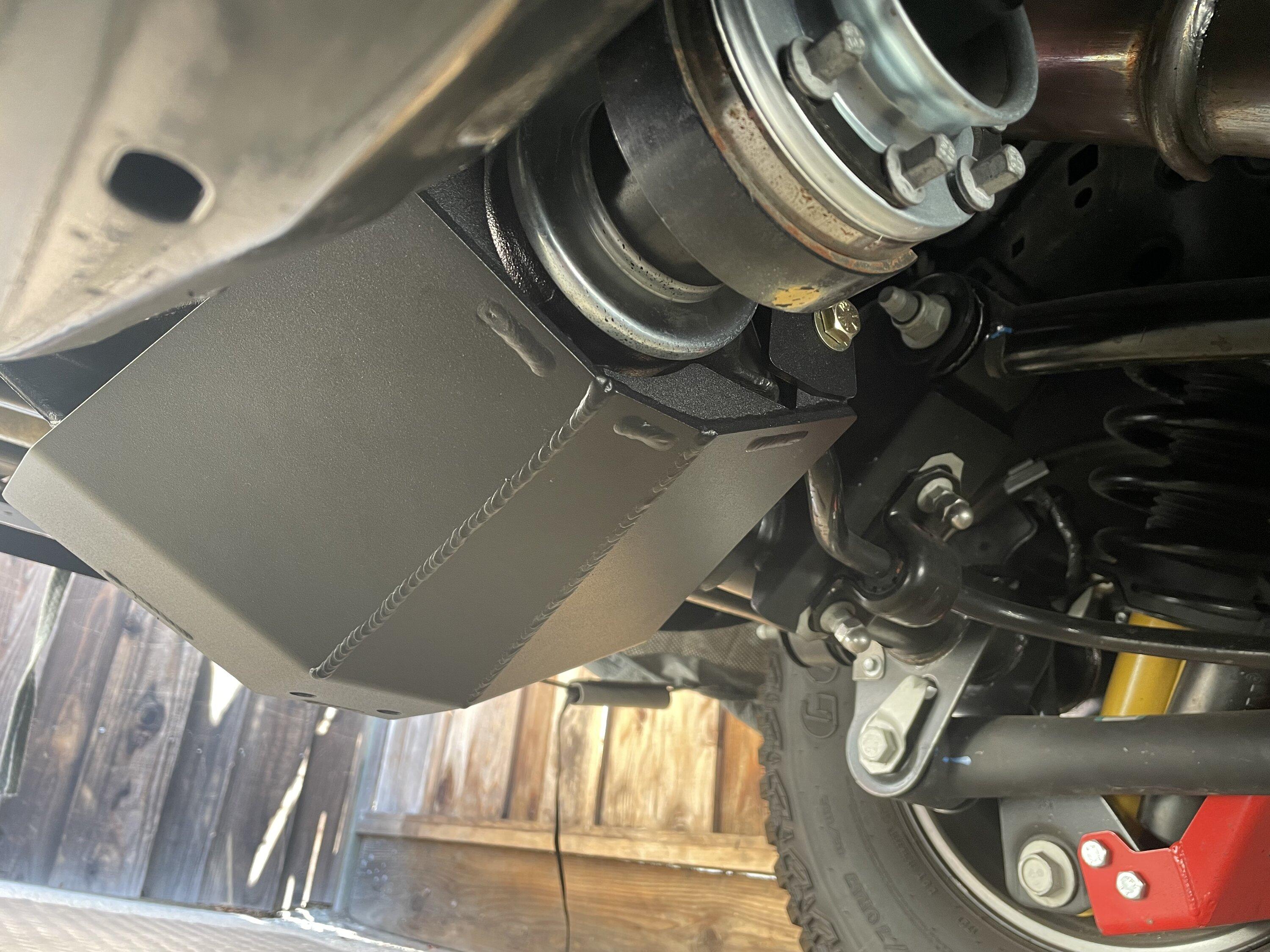

Installed the K&N charge pipe kit, Whipple intercooler, and the Foutz Motorsports rear differential skid/glide plate

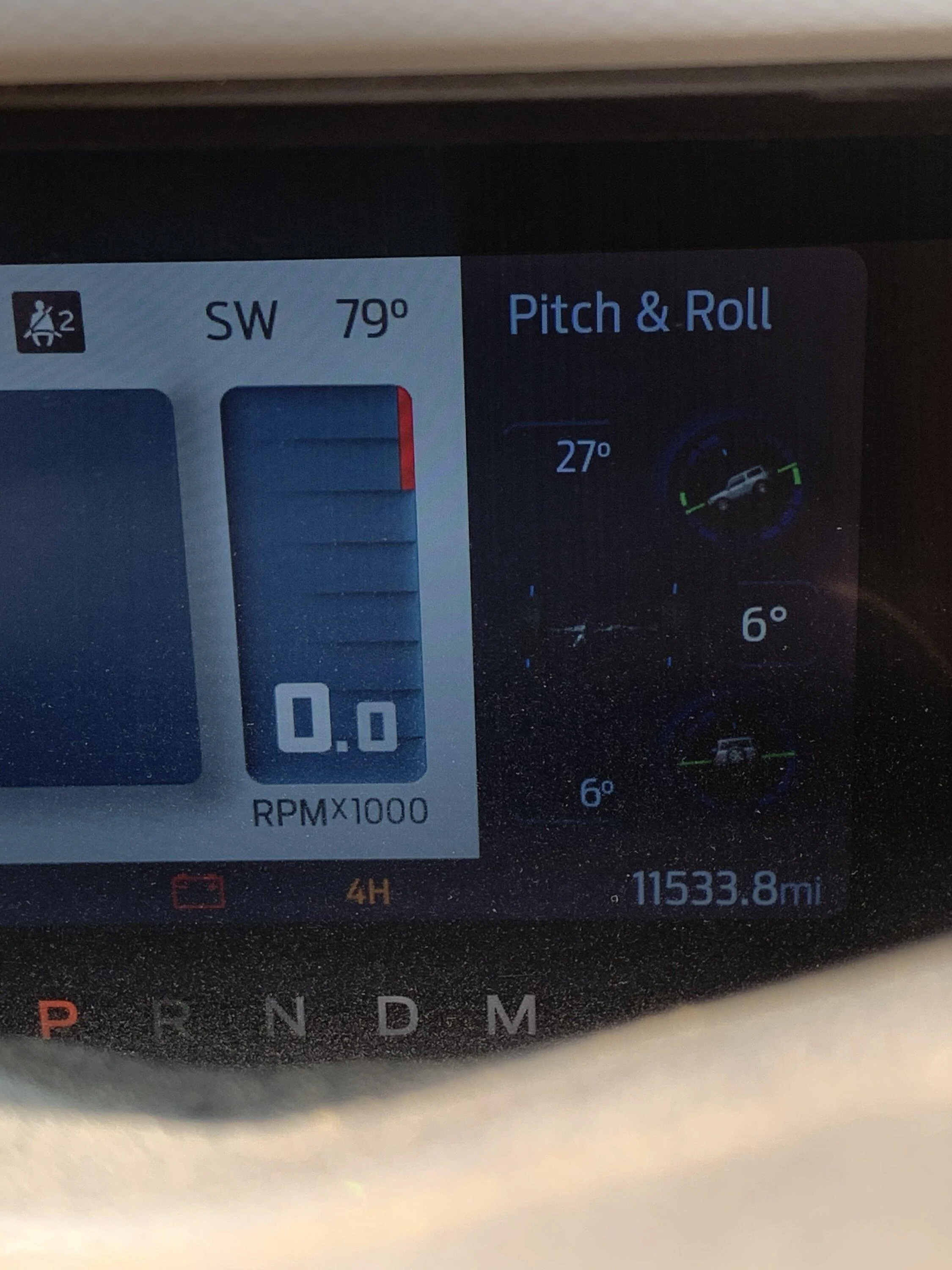

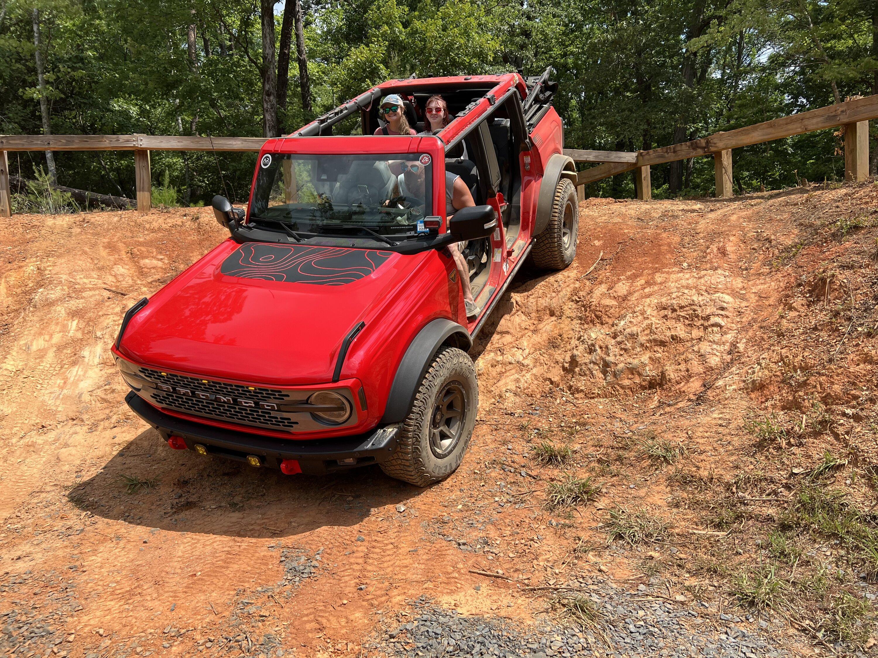

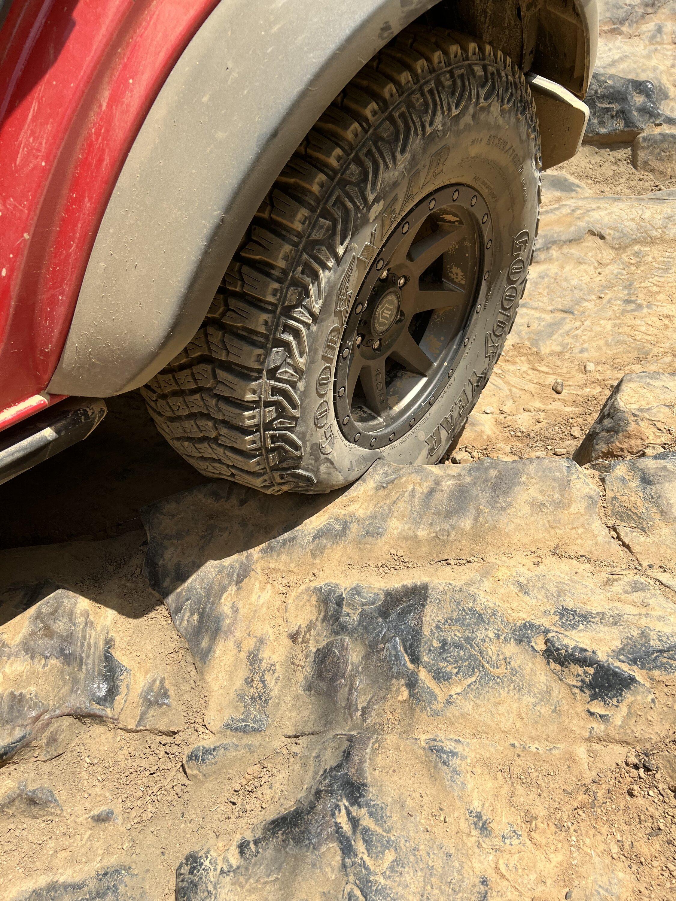

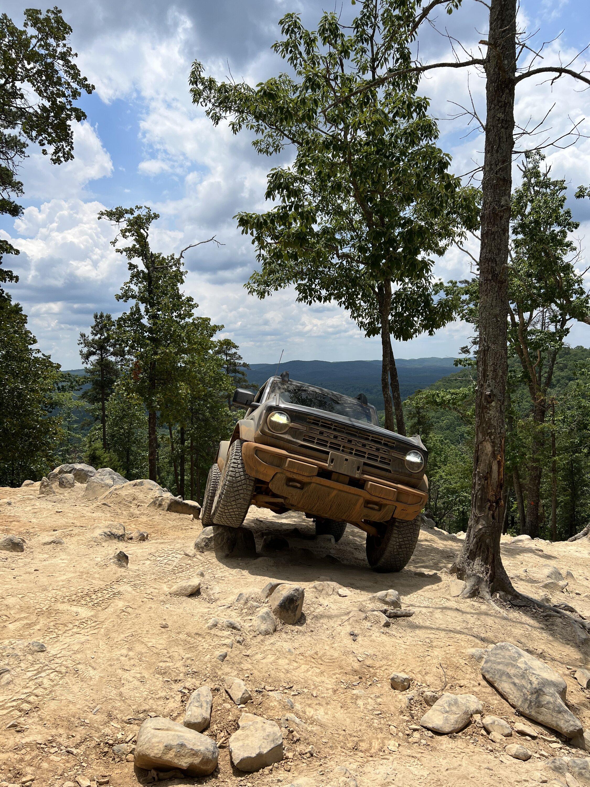

Not quite today, but Saturday got a little wheeling time in with a few other Broncos.
13psi air down, doing what it was meant to do.
Ford Bronco What did you do TO / WITH your Bronco today? πŸ‘¨πŸ»β€πŸ”§πŸ§°πŸšΏπŸ›  68AB2603-5A3F-4230-9EAD-D26535B23CEA
This was fun.

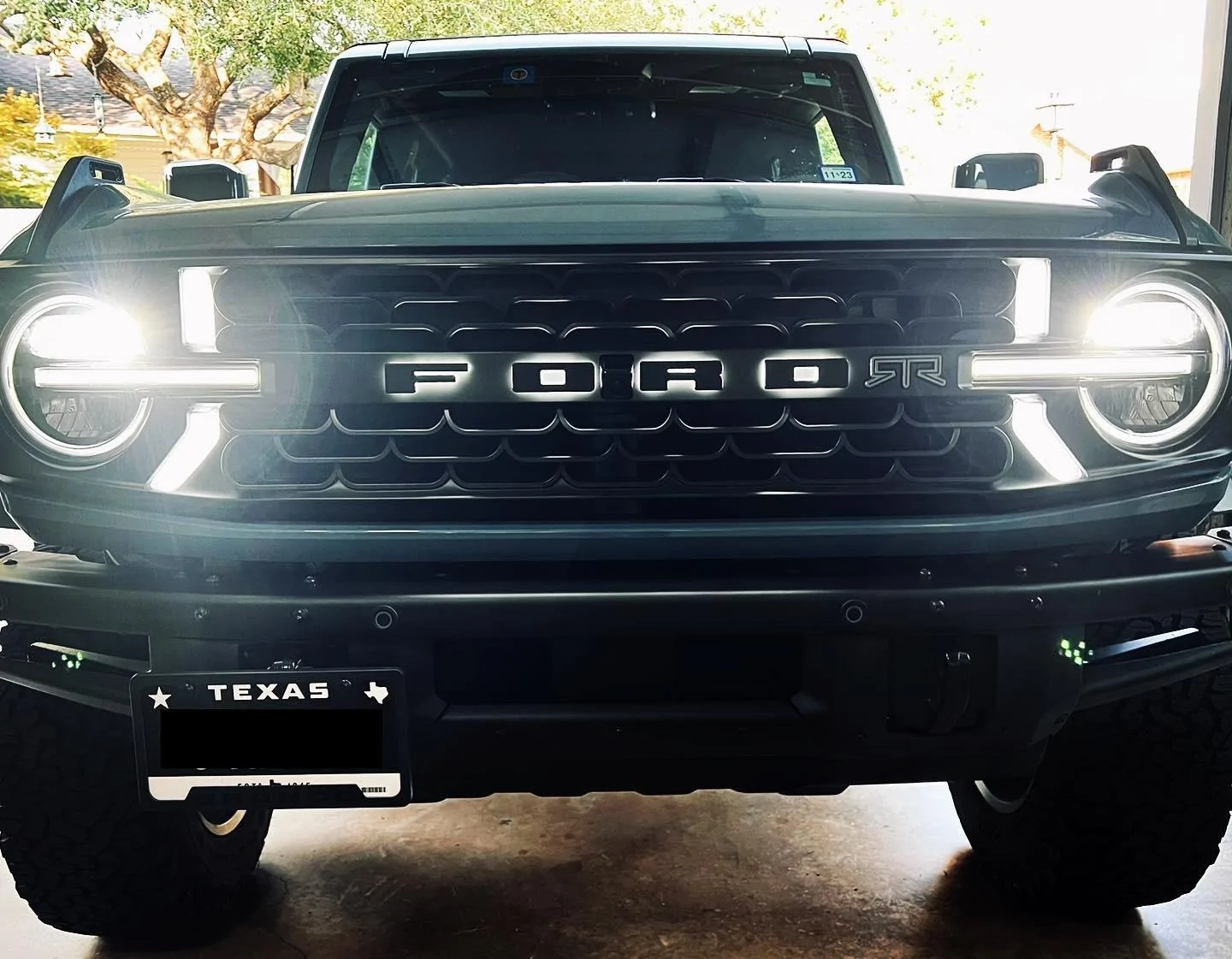

Installed the Oracle illuminated grille letters on my RTR grille. Due to the RTR emblem & front facing camera, I didn’t have the space for β€˜BRONCO’ so I opted for β€˜FORD’ instead.
The wiring was easy, it the alignment was tediously challenging. Aesthetically, it came out better than I thought; long term success is solely based on how strong the adhesive is

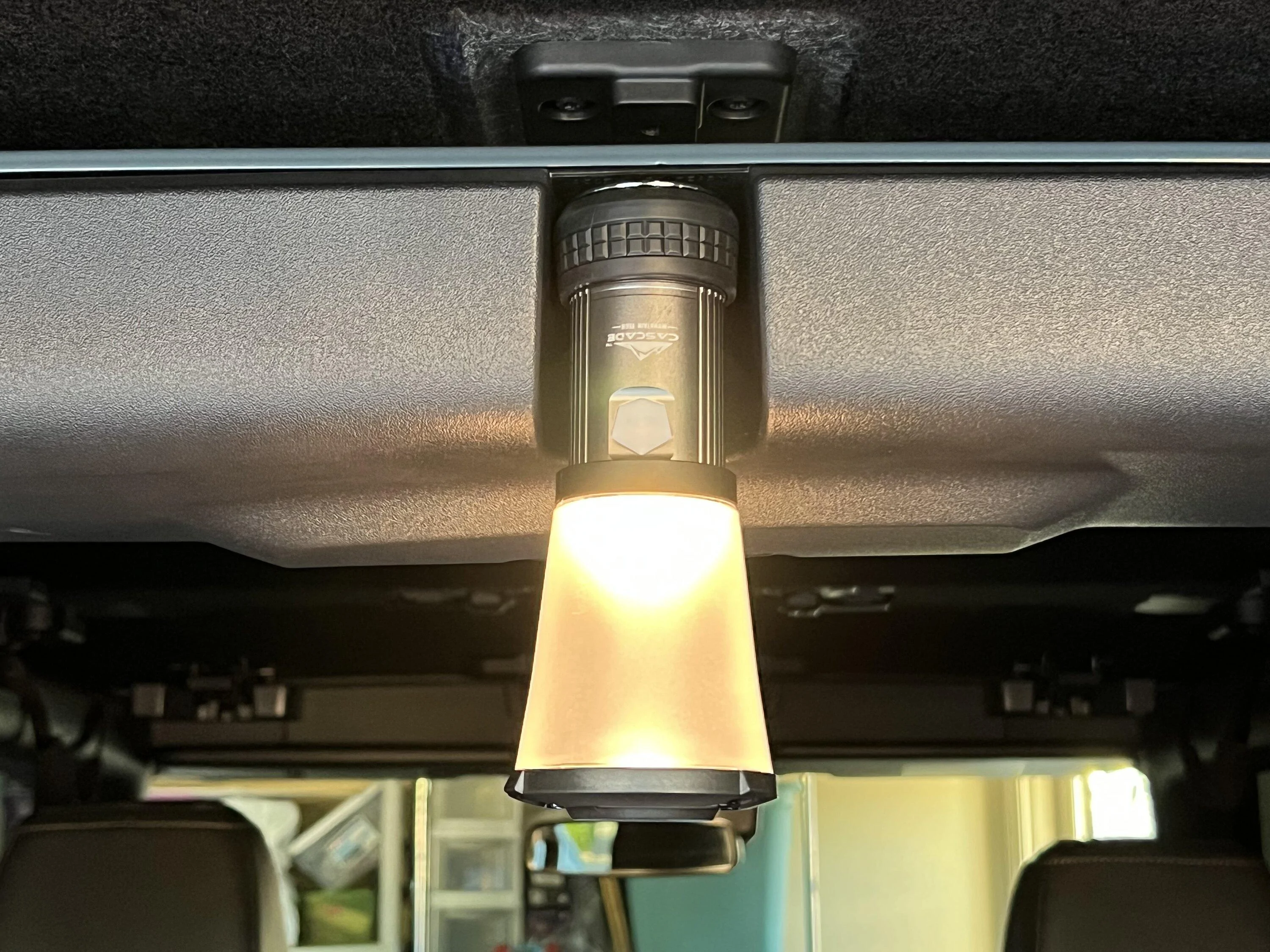

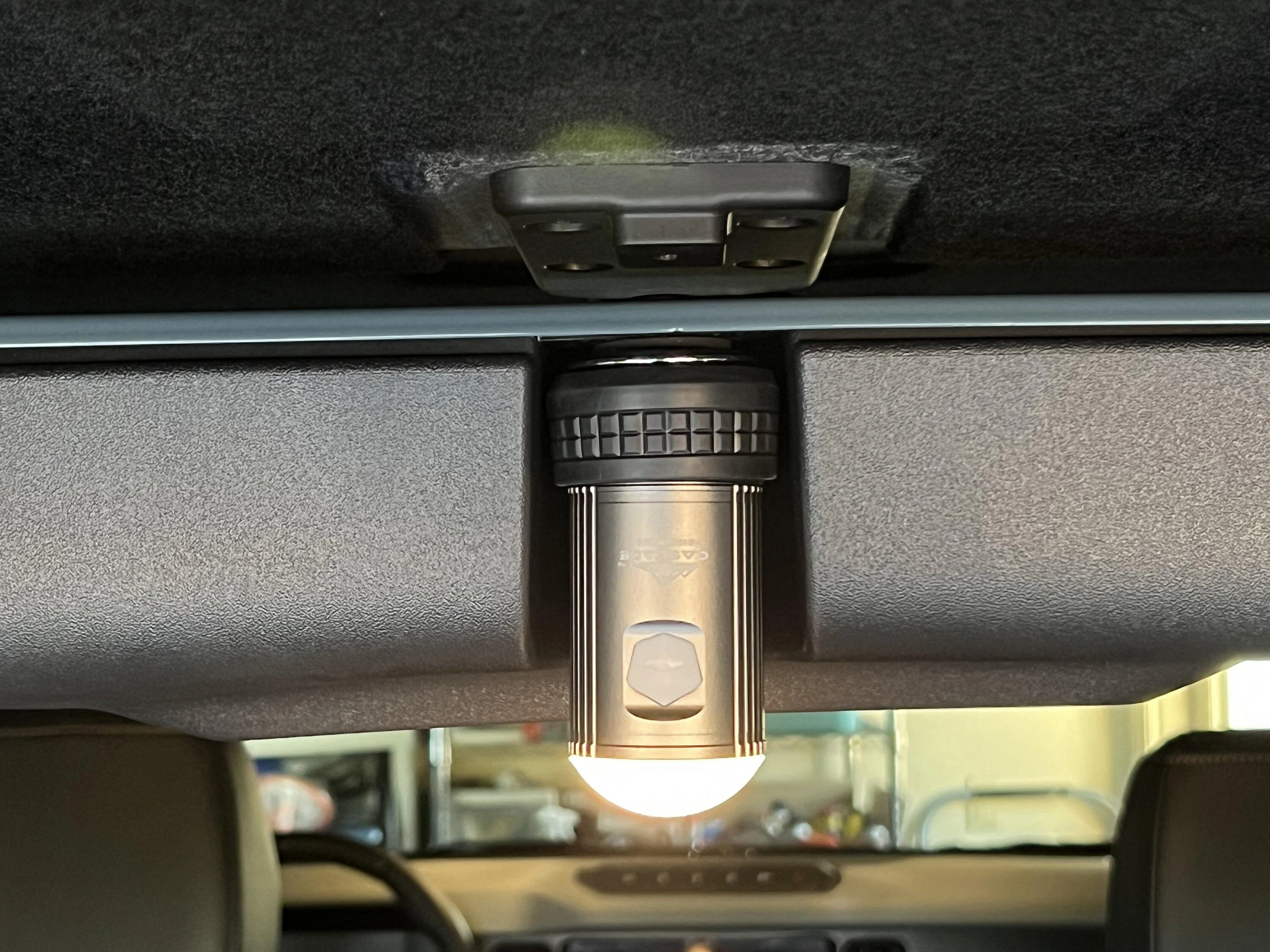

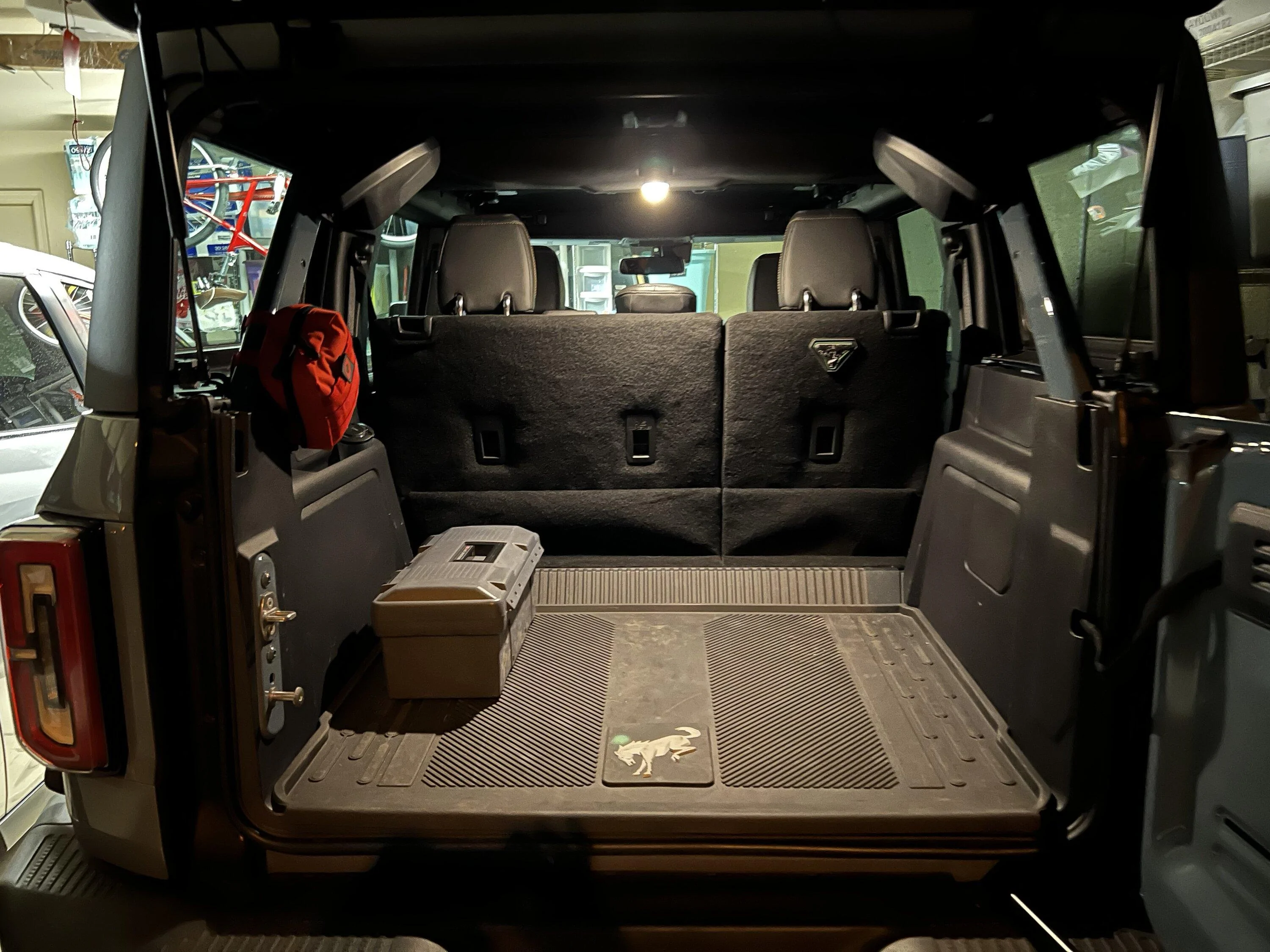

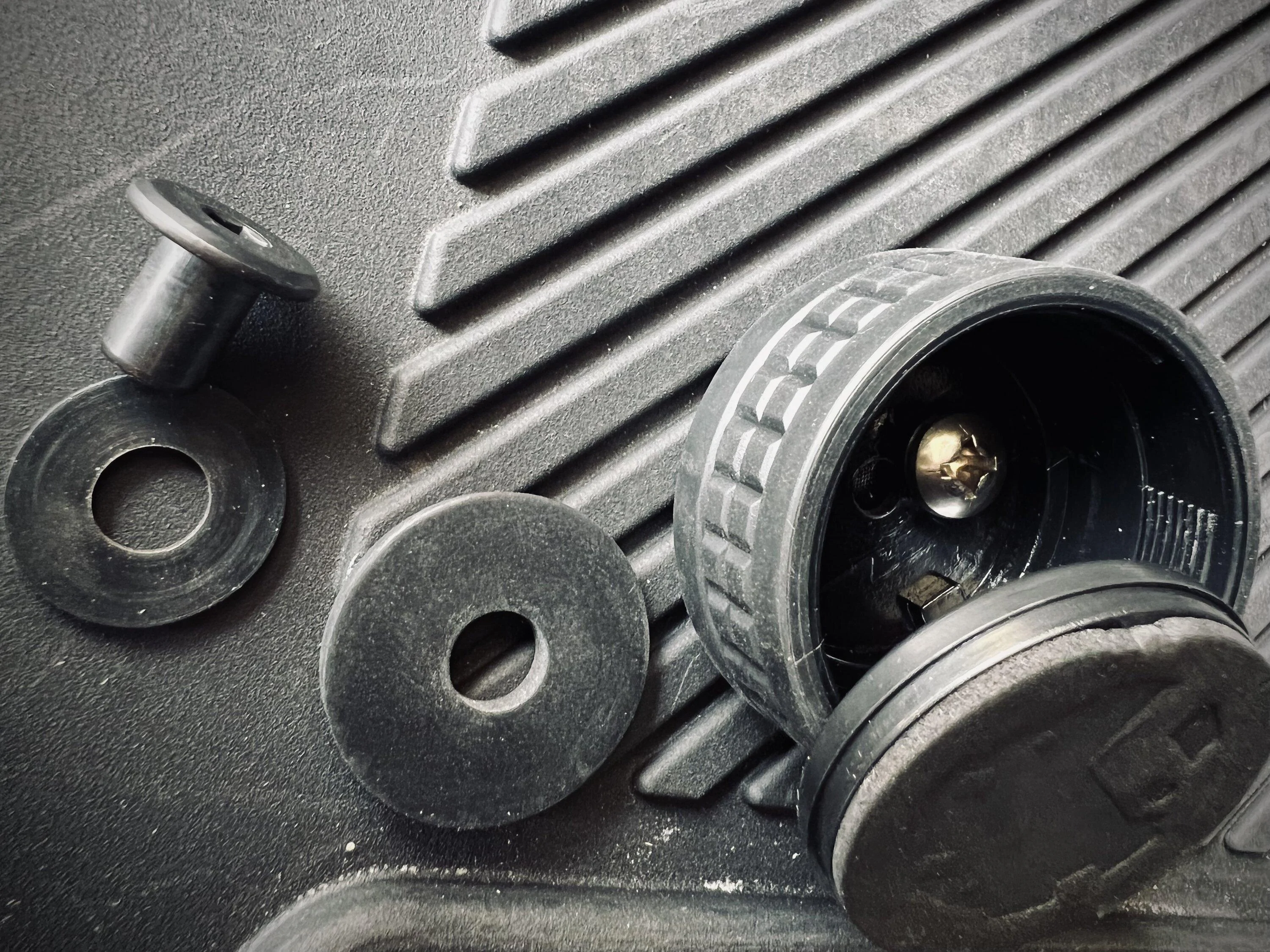

Mounted a battery powered led telescoping β€˜Cascade’ lantern in the β€˜Accessory Ready’ niche over the rear crossbar above the cargo area (4 door). Fits perfectly and throws a good amount of light. I’ll remove the Diffusion Dome for everyday use to avoid obstructing the rear view.
I don’t think Costco carries them anymore, but Amazon does:
Cascade Mountain Tech Compact Collapsible LED Lantern [3Pk], Black
https://a.co/d/ciapQV3
Cargo β€˜Accessory Ready’ Cascade LED Lantern Installation Instructions
  • Remove the screw-on cap from the lantern and then have a beer
  • Pop out the foam gap spacer plate insert from inside the screw-on cap with an x-small flat head screwdriver (the foam gap spacer is not glued, just wedged up in there real good)
  • Drill a ¼” hole into the screw-on cap, ¾” from the edge (hole will be slightly OFFCENTERED)
  • From the top of the crossbar drop in your Joint Connector Nut with the 7/8” neoprene washer attached (to protect the paint). You don’t have to remove the MIC hardtop to install (if applicable), simply push up slightly on the MIC hardtop above the β€˜Accessory Ready’ hole
  • Place the 1 ¼” rubber washer between the cap and the β€˜Accessory Ready’ plastic trim
  • Install your 3/8” machine screw up through the bottom of the cap and 1 ¼” rubber washer into the Joint Connector Nut
TIP: Hold the Joint Connector Nut with your finger (you can also use a 3/16” Hex wrench if no restrictions from the top) to tighten the screw
  • Reinstall the foam gap spacer plate insert into the screw-on cap
  • Reassemble the lantern and then have another beer while you play with the different settings!
Parts List – All 4 items sourced from Ace Hardware
  • Joint Connector Nut (found in furniture parts), ΒΌ - 20 thread $1.39
  • 7/8” O.D. 3/8” I.D. Neoprene washer (to protect the paint) $ 0.45
  • 1 ¼” O.D. with 3/8” I.D. (1/8” thick) rubber washer (if you don’t use this part, you’ll need a shorter screw) $ 0.69
  • ¼” x 3/8” – Pan Head stainless steel machine screw $ 0.35
