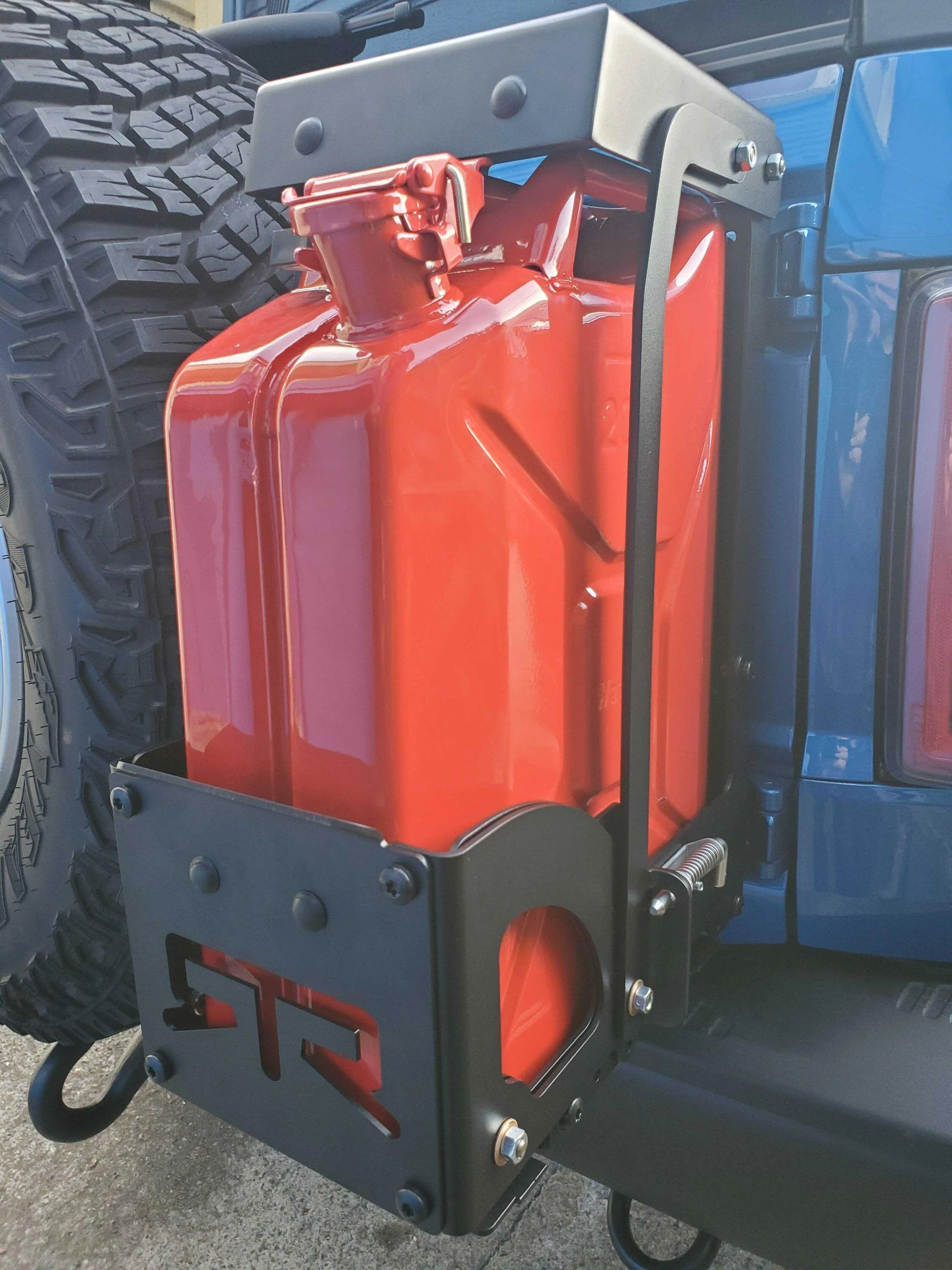

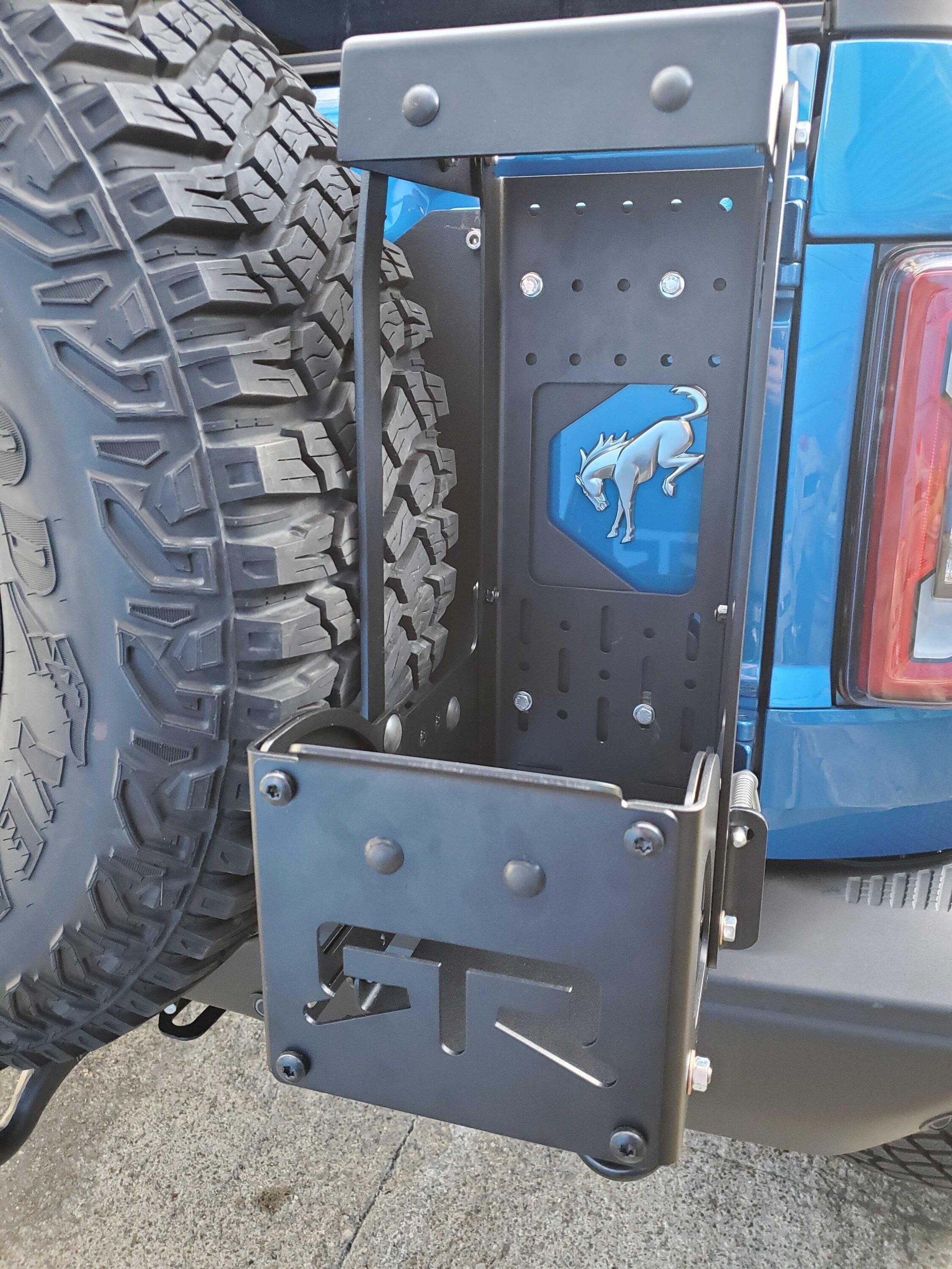

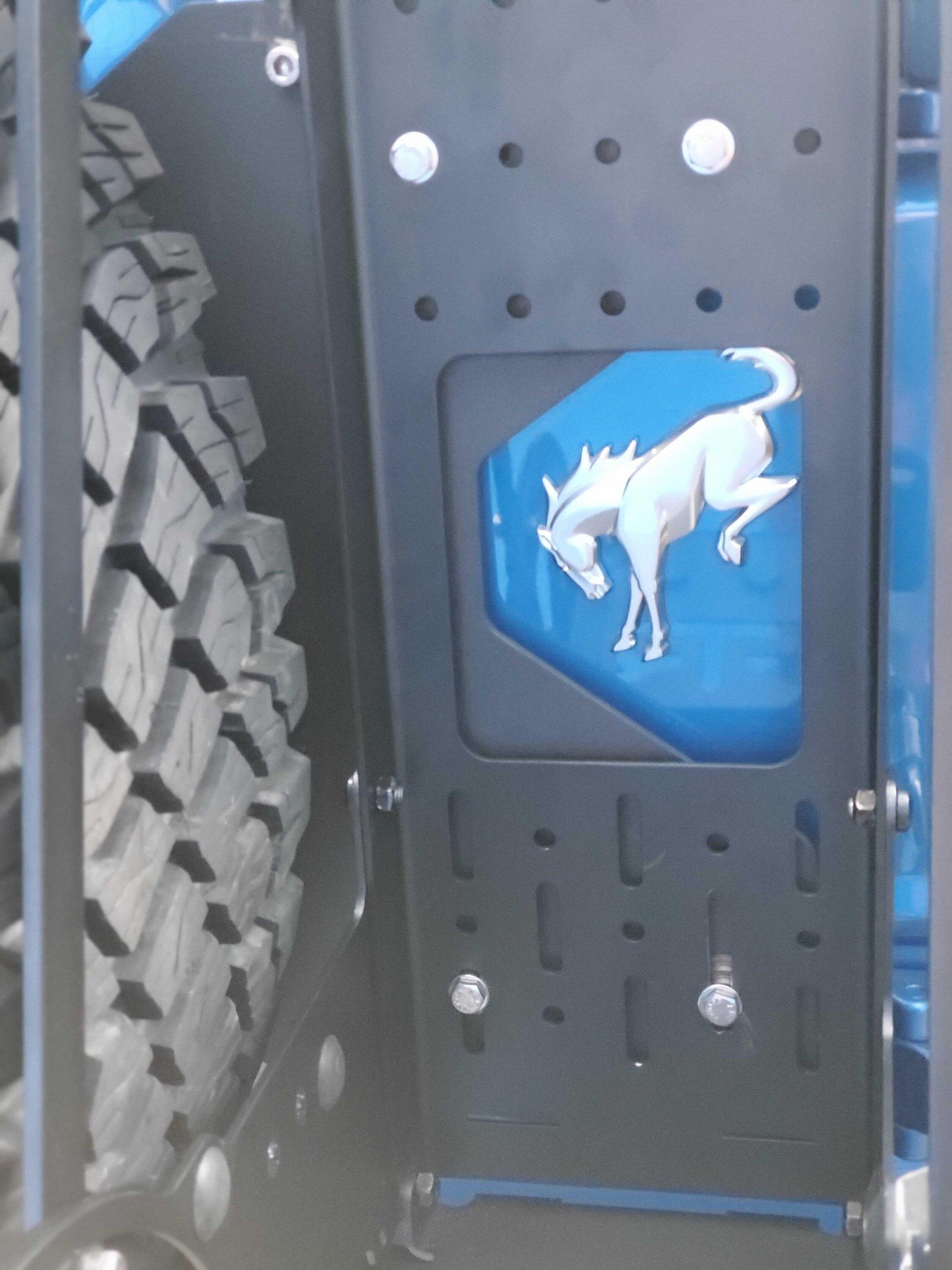

Today I installed the RTR 5 gallon jerry can mount onto my Hammer Built tailgate reenforcement panel.
This is not suggested or encourage by either RTR or Hammer Built. RTR states that you must use their tailgate mounting system. I did not since I already had the Hammer Built tailgate mount and RTR was out of stock. I also wanted to check how modular the HB mount can be.
I used some 1/4" spacers between the HB plate and the RTR mounting plate. I did not use the RTR optional mounting plate.
Three out of 4 mounting bolts matched the HB bolt pattern. The lower right bolt required me to extend the slot to line up the mounting hole. It was easy to extend the slot being that the plate is aluminum.
Being in California, the air resource board restricts fuel cans with colors other than red. I did want a black can to help it blend in and I will most likely get one outside of California later.

Red seems like the right color. Cool rack.

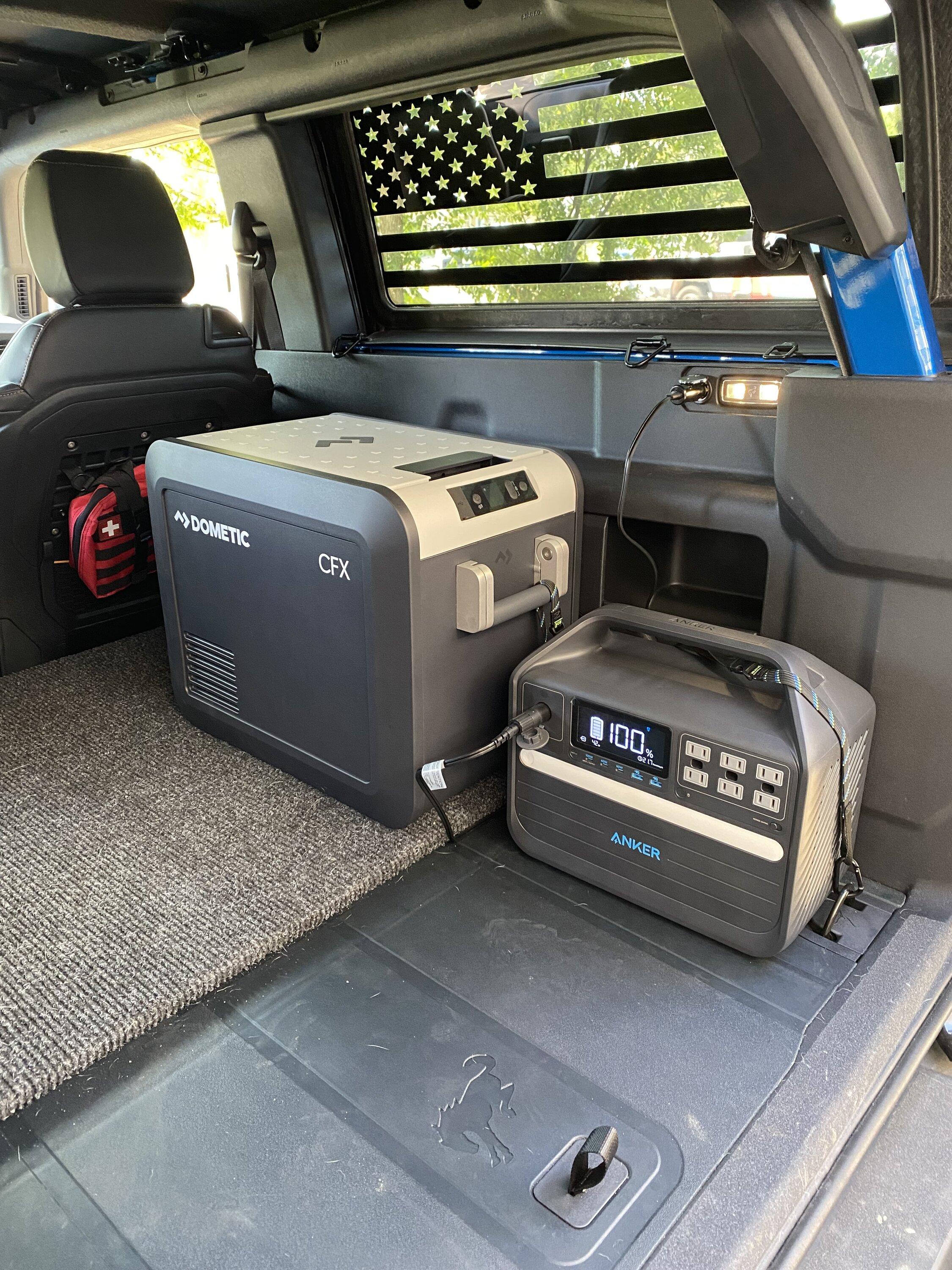

I'm debating between fridge or Yeti type cooler w ice. What made you decide on the fridge?
For me, I just didn't want to deal with ice and soggy food. Now that I went with an ARB Zero, it's been a lot more useful than I thought it would be in my day-to-day driving. Mine is plugged into the accessory port which stays on for an hour after the key is off and I store water and gatorade in it 24/7. It's not often that my drinks aren't cold and readily available.

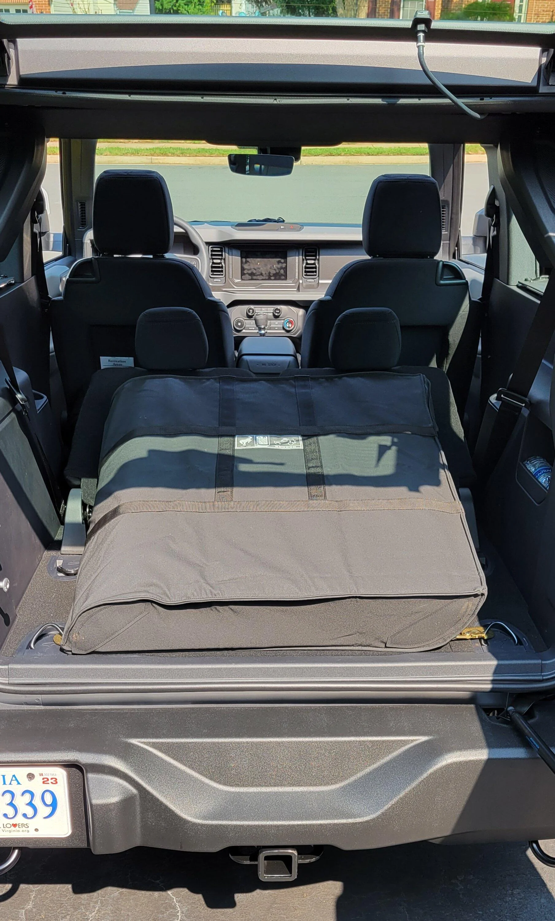

This soft top window storage bag has been designed specifically for the Bronco and I've been using it for a couple of months now. I wanted to check out it's durability before sharing my video!
So far its been great, both in the Bronco and hanging out in my dining room! There's a link to the product in the video description, but it's also here (and it's on sale right now): https://amzn.to/3S0DTYK

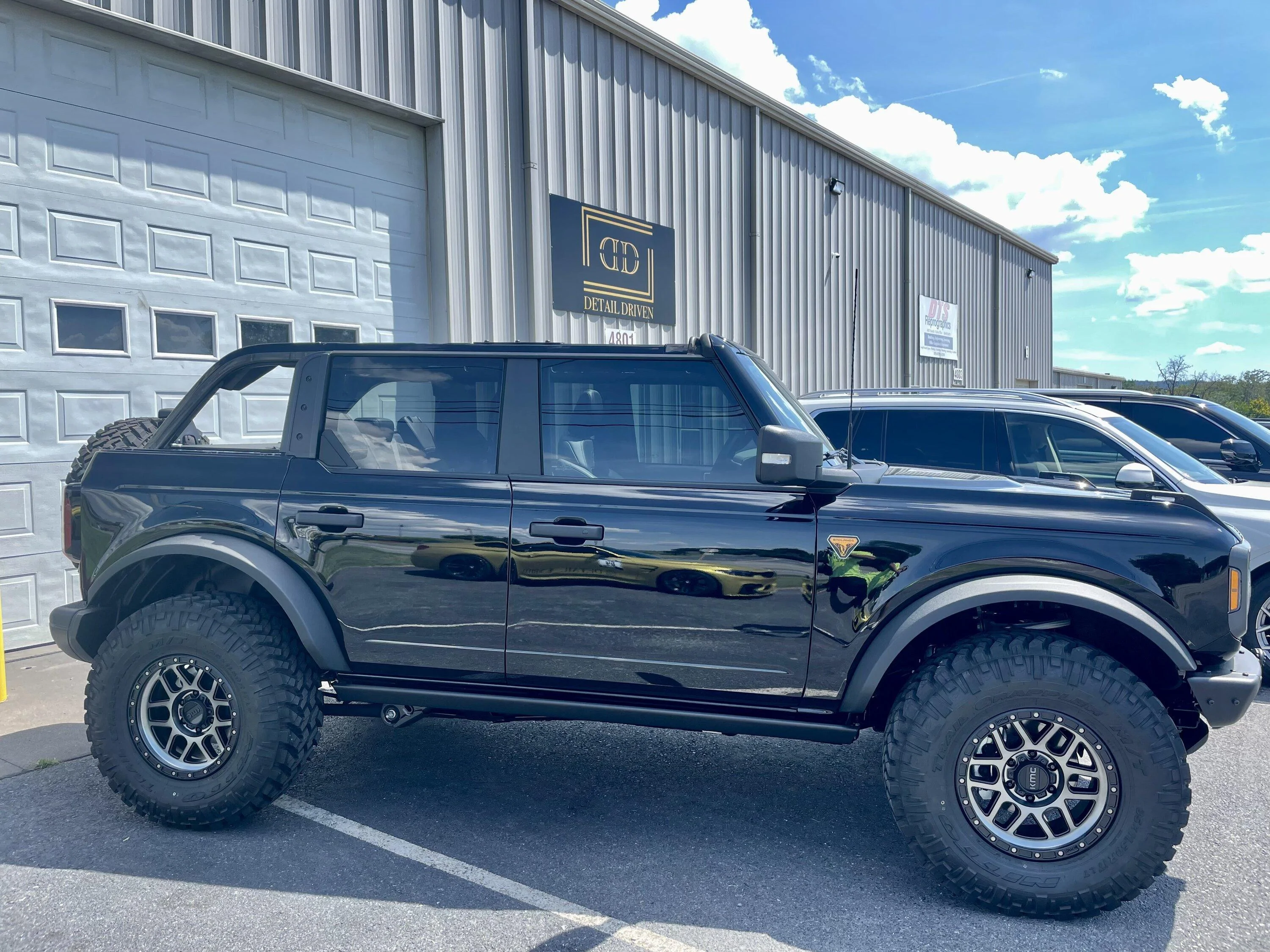

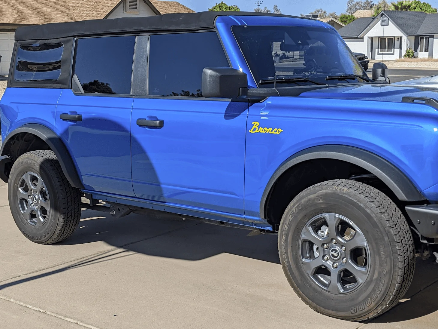

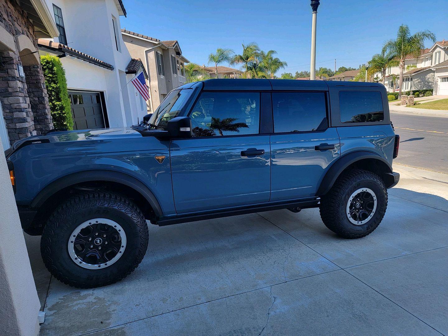

Full Xpel PPF (including door sills) and Xpel Fusion Ceramic Coating on paint, trim, glass, and interior.

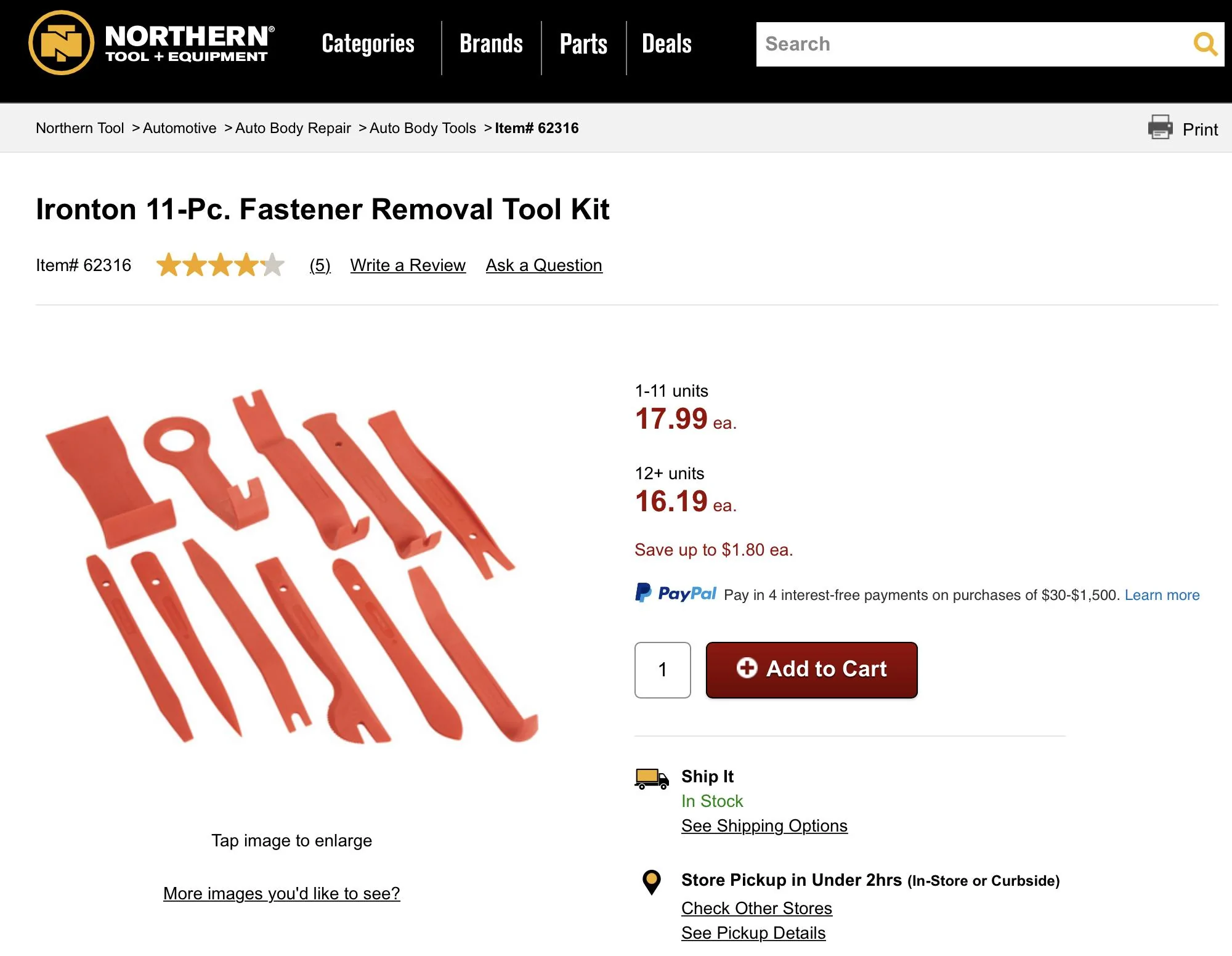

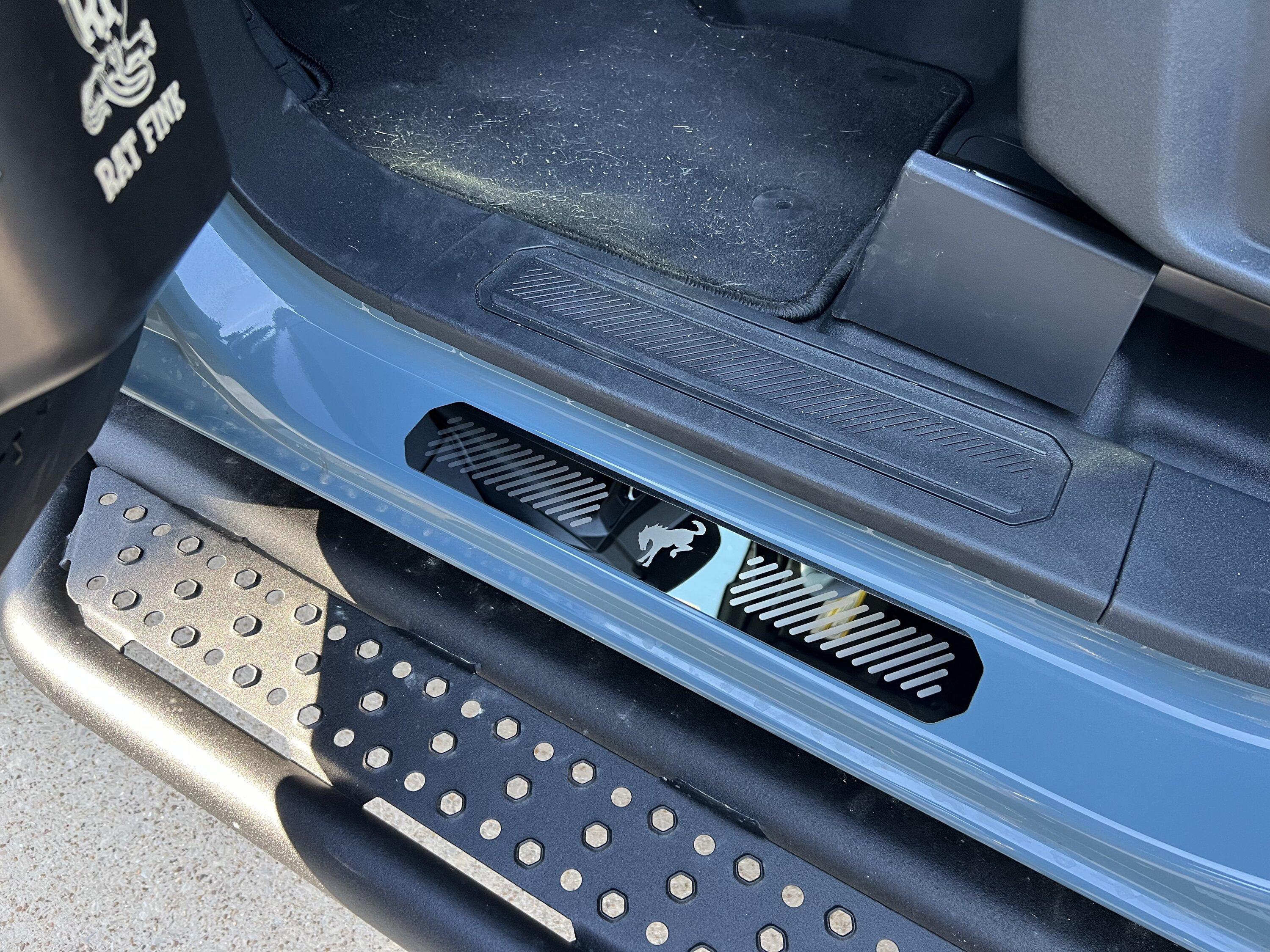

There are some folks out there swapping the tabs but I wanted to keep my original parts. So yes unfortunately had to order whole louvre assembly. They were $40 a piece x 4. I just called the local dealer and explained what I was looking for and he gave me part #s.​
Super easy to pop vents out and swap using a trim tool. I saw it on YouTube. Here’s the link.​
Please use trim tools and not a screwdriver. You can even see the scarring when they remove it.

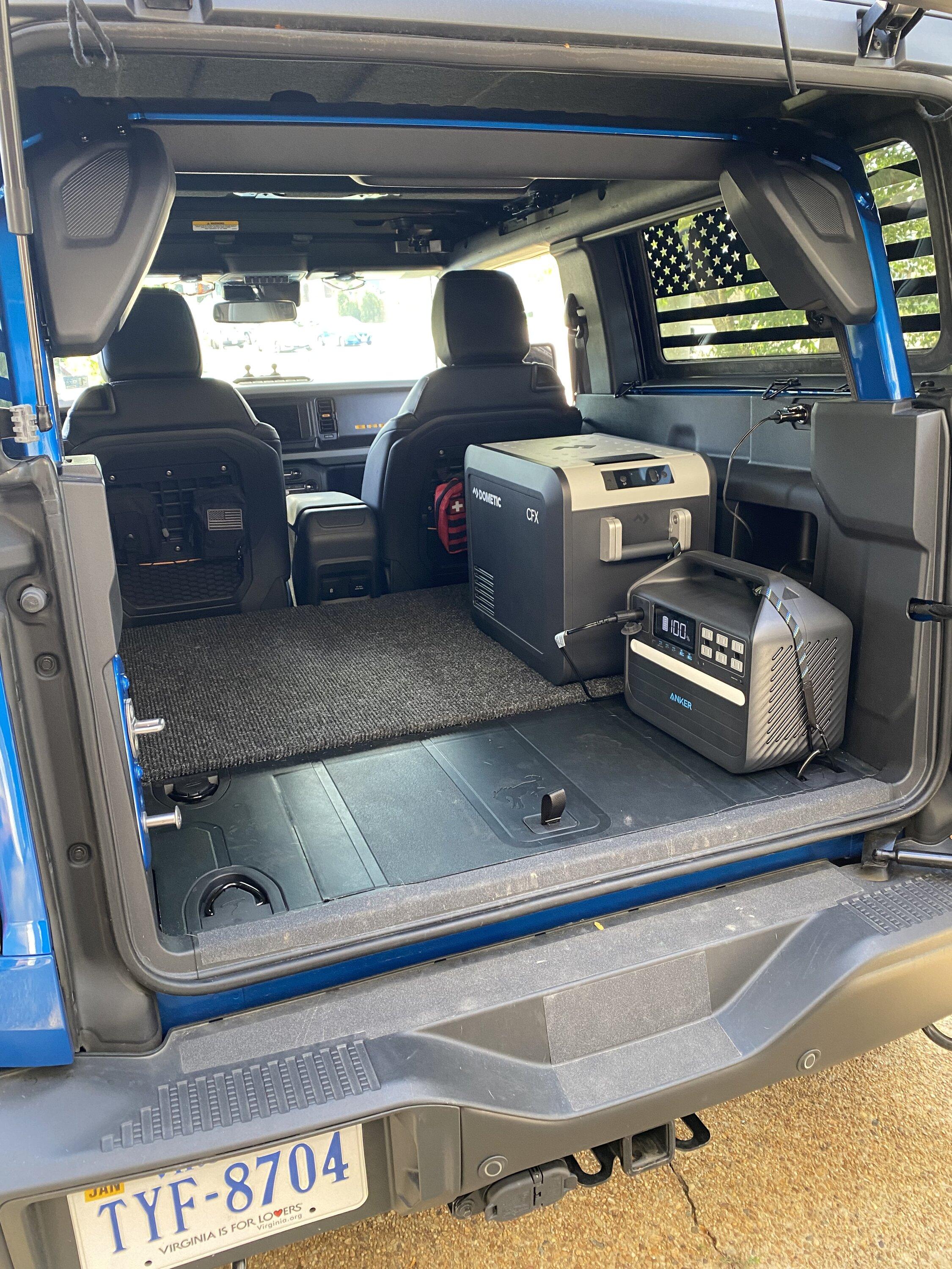

Mainly cause I had $1700 burning a hole in my pocket and wanted to try it out. My igloo ice cooler is smaller, lighter and less complicated but not nearly as β€œcool” as the Dometic. It will take about 10,000 years to break even on the cost of ice vs. this setup but once again the β€œcool” factor is off the chart.
It’s not convenient to bring into a hotel, is heavier, can’t really take it out and set next to the camp fire but it is super β€œcool”.
So really I don’t have a great reason other than I wanted one so I bought it as an experiment. This weekend is my first trip (hoteling) and so far it’s working well.
I think the use case though is definitely for more longer trips off grid. I do have a CO trip in the works for next year and this will be a great addition for that trip vice running though ice all the time.
