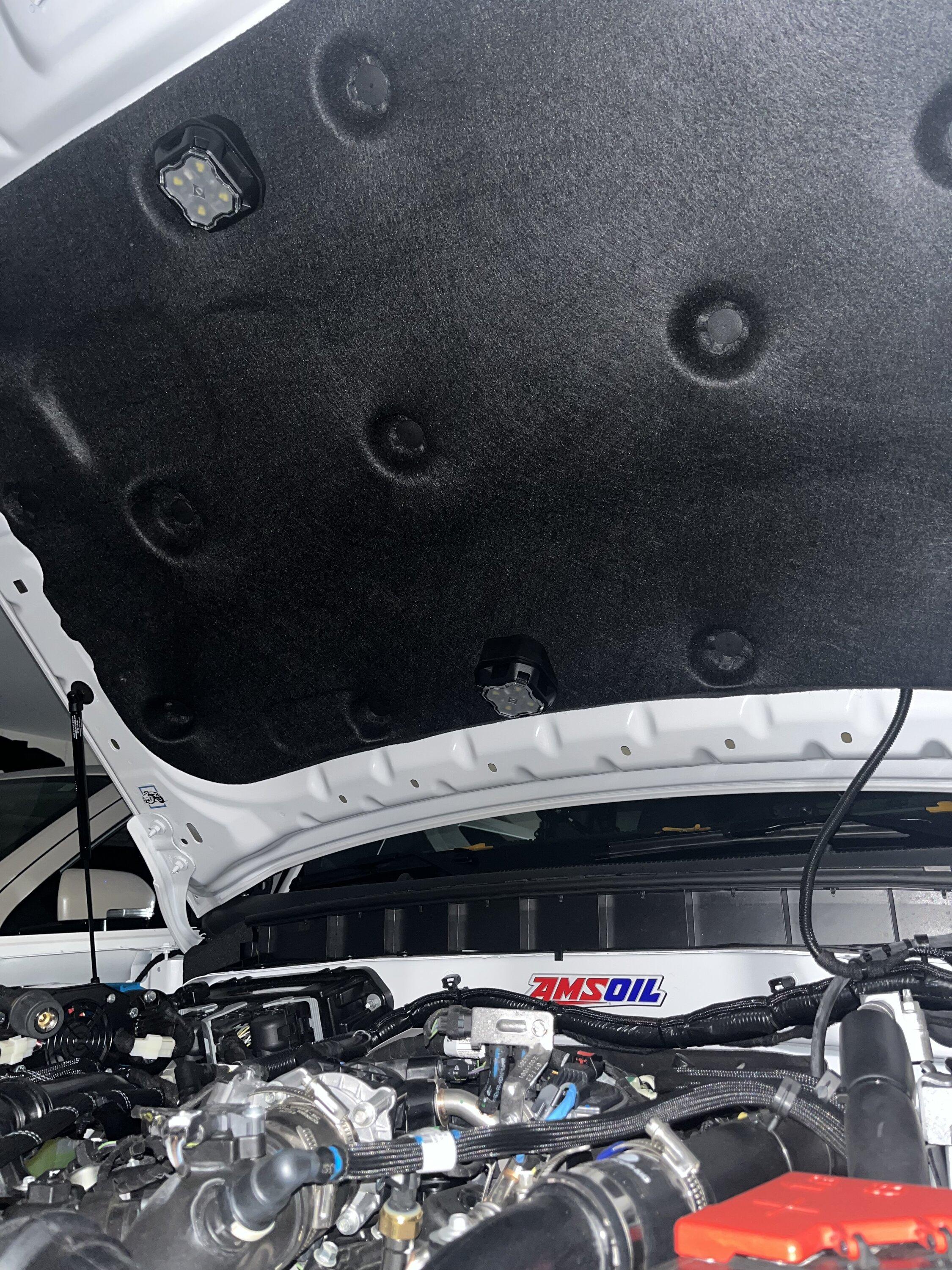

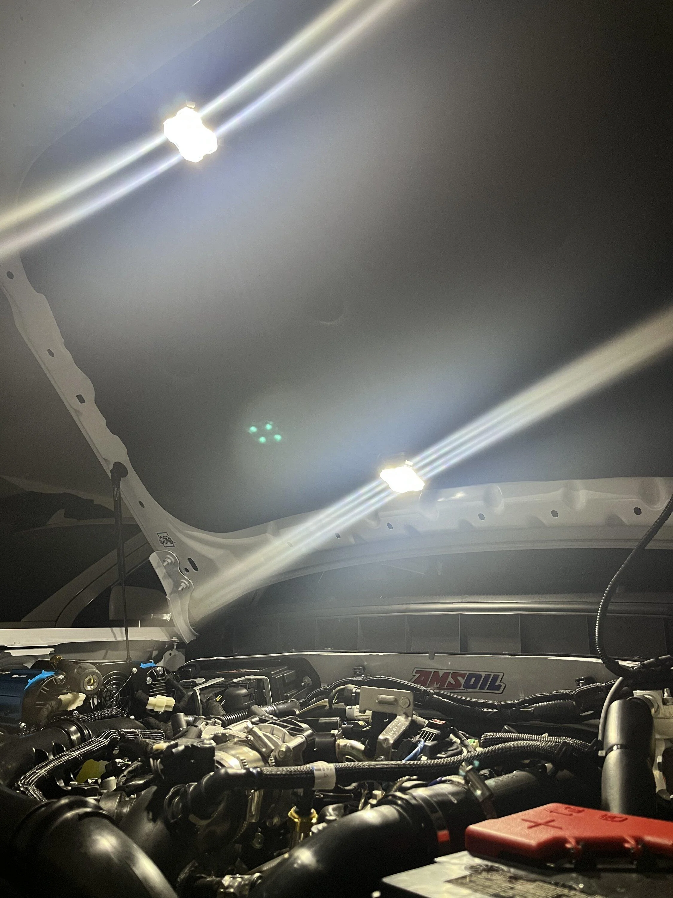

Installed some knock-off BD lights. Those Starbucks drive-thrus can get pretty dark.
Looks good. Who makes your light bar and where did you get it, if I may ask?

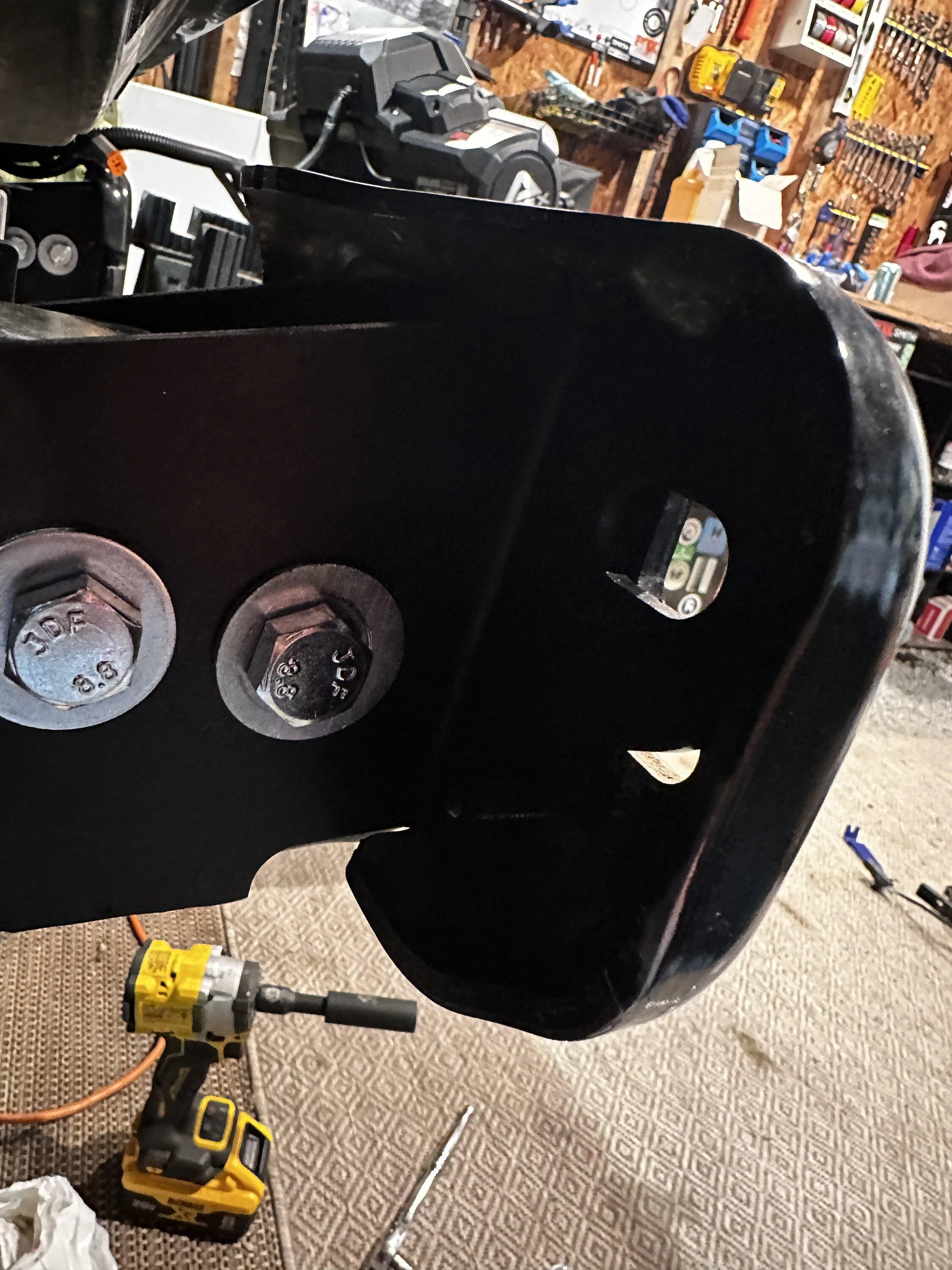

Finally got around to installing my LOD frame horn reinforcement brackets to keep my high winch mount in check. I’ll likely eventually swap these out for @Tricky Dick ’s version but I’d already bought these and modified them so figured I’d use them for now. Quite the PITA but hopefully worth while for now

Did you do any kind of spacers behind them? I wasn't loving how they sit on the dimples.

Actually I copied you and welded the pieces that I cut off of the outside ones onto the inside of the inner ones. It definitely made me feel better about them.. didn’t do anything to the outer ones though as I only had the two pieces I’d cut off and ran out of gusto to find anything else to weld on. Thanks for the inspiration! Had I not already cut the lower ears off I’d have returned them and bought yours already

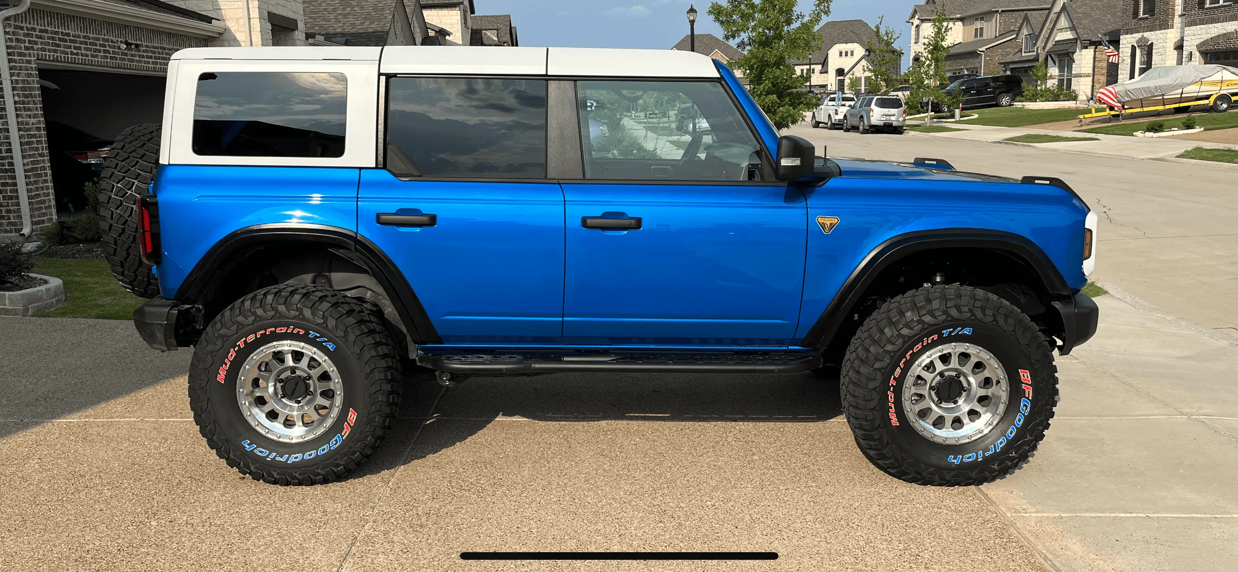

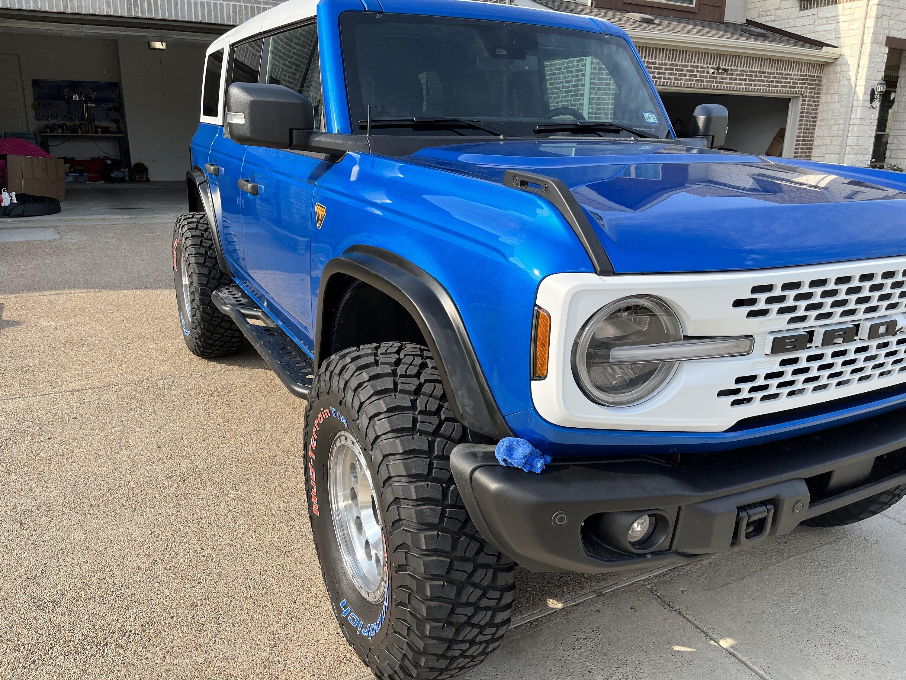

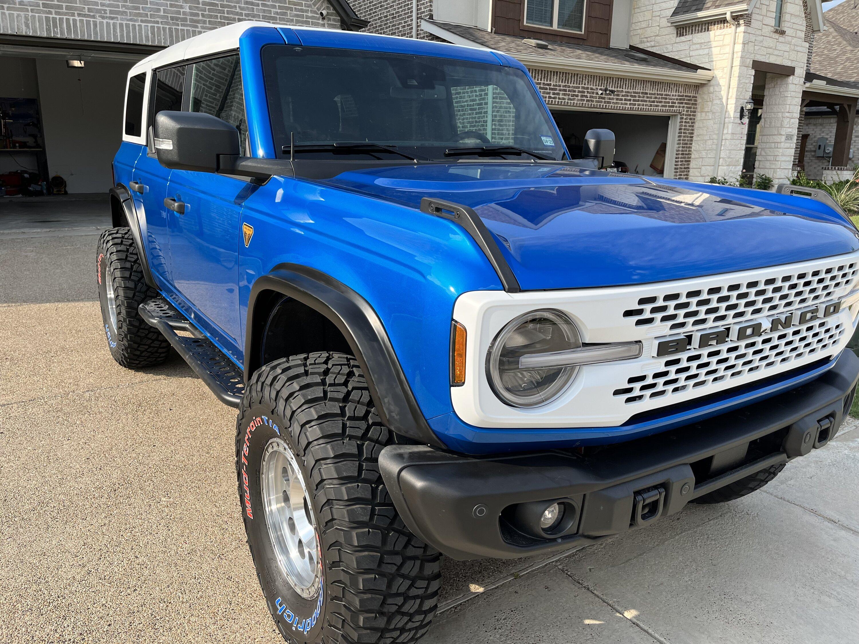

KBD flares added today gained some extra clearance

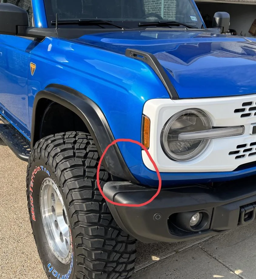

How are they sticking in the circled area? I’ve seen a few folks install these and it didnβ€˜t wanna stick to the contour on the front ones very well but maybe they’ve changed their tape

Shop towel to hold pressure while the adhesive set. I heated up the area with a heat gun to get it nice and sticky about 4 hrs and it seems to be holding tight.

Good tip, thanks!
