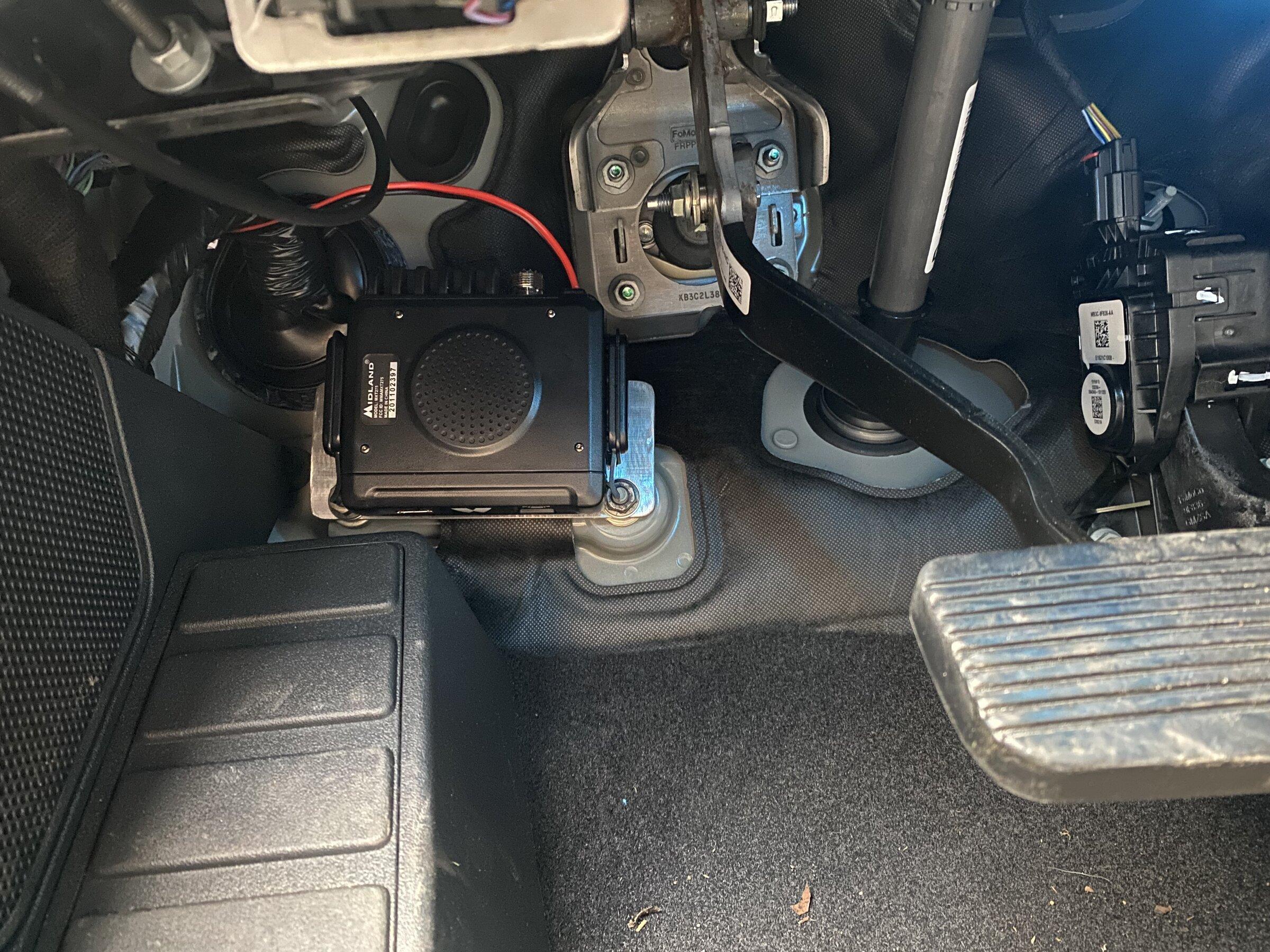

Thanks! Unfortunately, I didn’t think to document along the way.
Here’s what I used:
==> Midland MXT-275
==> RJ-45 Cable extender
==> 3db gain stubby Midland antenna
==> Hood mount
The install was pretty easy: dedicated power cord / antenna brought through the firewall gasket. (Took me a minute to realize there are β€œtwo sides” to the gasket. Think rubber tuna can). Cut off the 12-volt car adpater; tied red to the AUX yellow-orange (Aux6), and the negative to the frame grounding nut nearby.
After mounting the head unit under the overly-sharp metal bracket under the steering column, I removed the front environmental controls panel. The Pickens Party of Five videos on installing the auto-stop-start eliminator really helped.
I measured out the square shape using blue painter’s tape. A narrow-blade oscillating saw worked great. UNTIL I tried to re-install the panel, with the extender installed. Turns out there NO space behind that location… Opps..
So I cut an approximate 1” x 1” x 1” cube of space from the black plastic compartment behind it, and prayed. Luckily the space was void and seemed like maybe it’s an air-vent.
Panel snapped into place. Also shout-out to the excellent Trail-Recon youtube video on this this install. Between his and PPo5 install videos, wasn’t too bad.
LOL..
I’m going this route. Pics from another member.

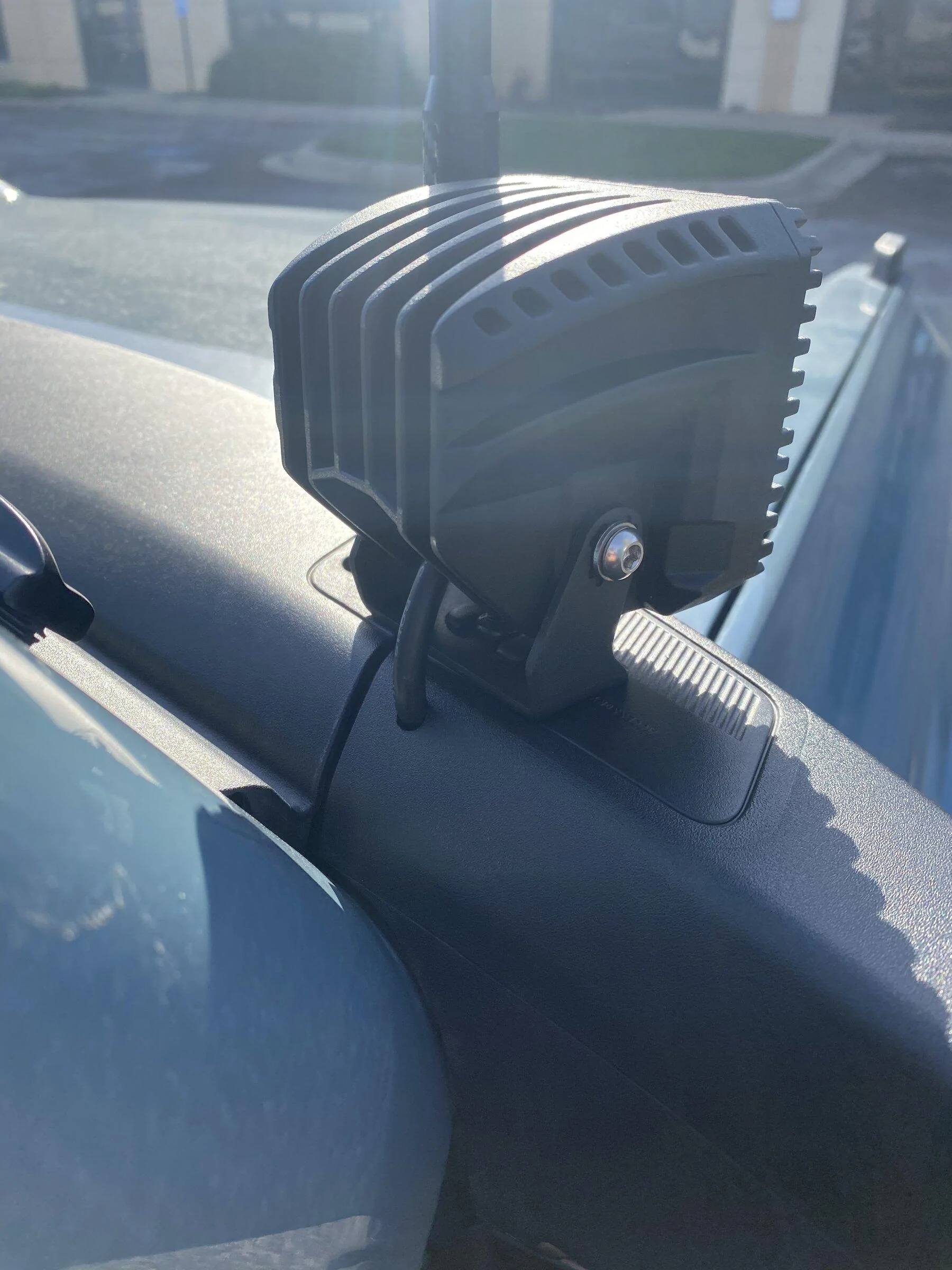

Did this yesterday as I had some free time

As a total noob - is there a main benefit for drilling a hole versus just running under the panel around the antenna? (That is the only way I've seen it done in the youtube videos I've been watching)
