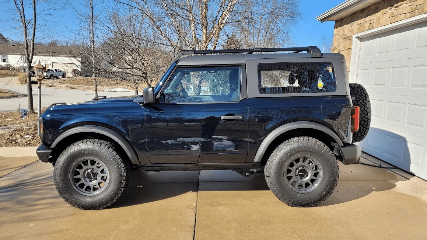

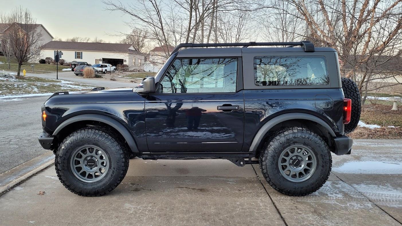

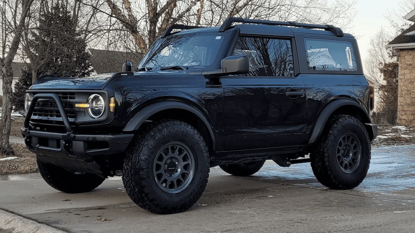

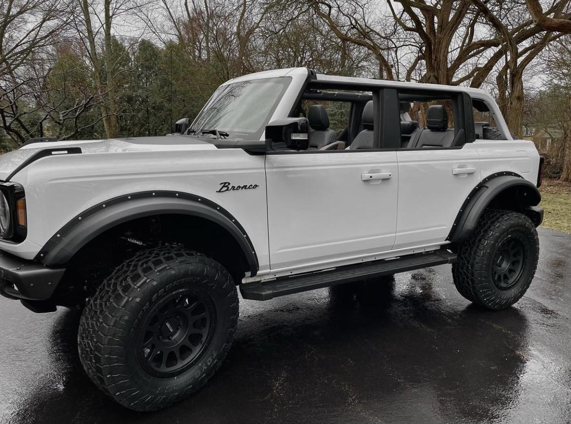

Going with the 706s. Just wish i could get any two ford dealers to agree on the offset..
+35mm fits up to a 35x11.5R17 on a stock Bronco with the crash bars removed, several people here are running +35mm with Toyo 35x11.5R17, Kenda 35x10.5R17, 285/75R17, and of course the 285/70R17.
I have a set of 705’s in 17x8.5 +35mm waiting to mount.
Here are a bunch of pics I’ve saved from the other guys running +35mm. If anyone isn’t cool with my posting your pics please message me and I’ll remove it.

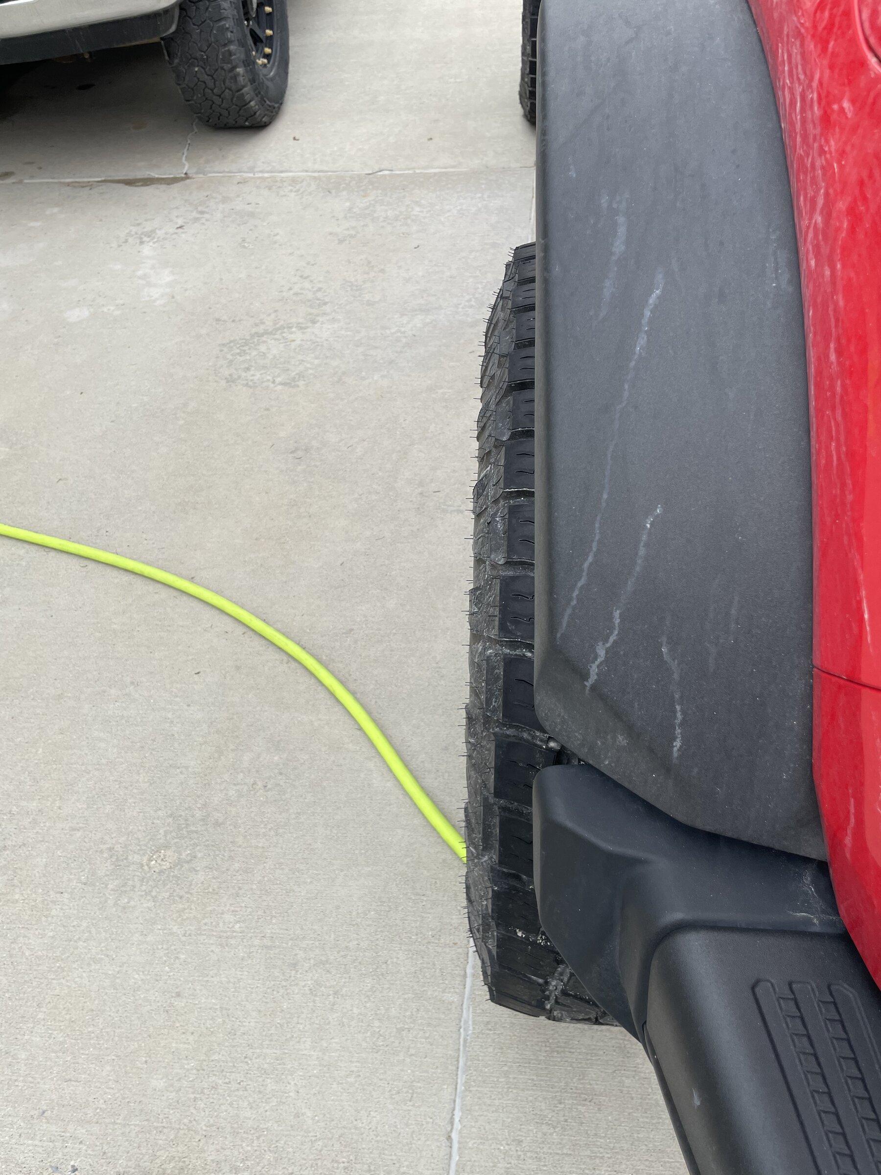

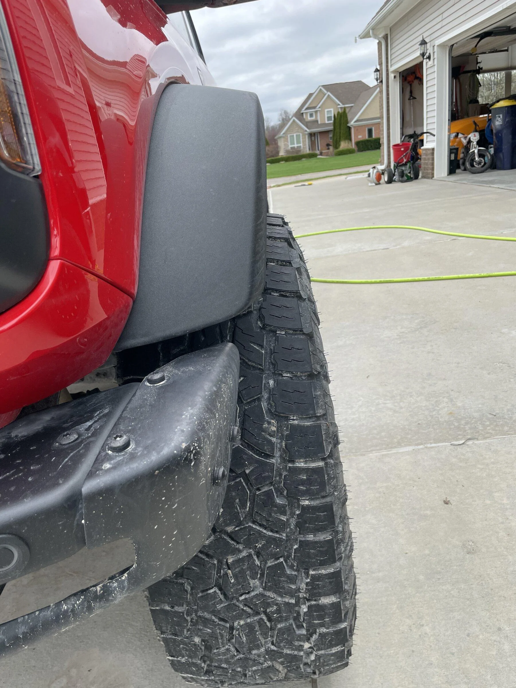

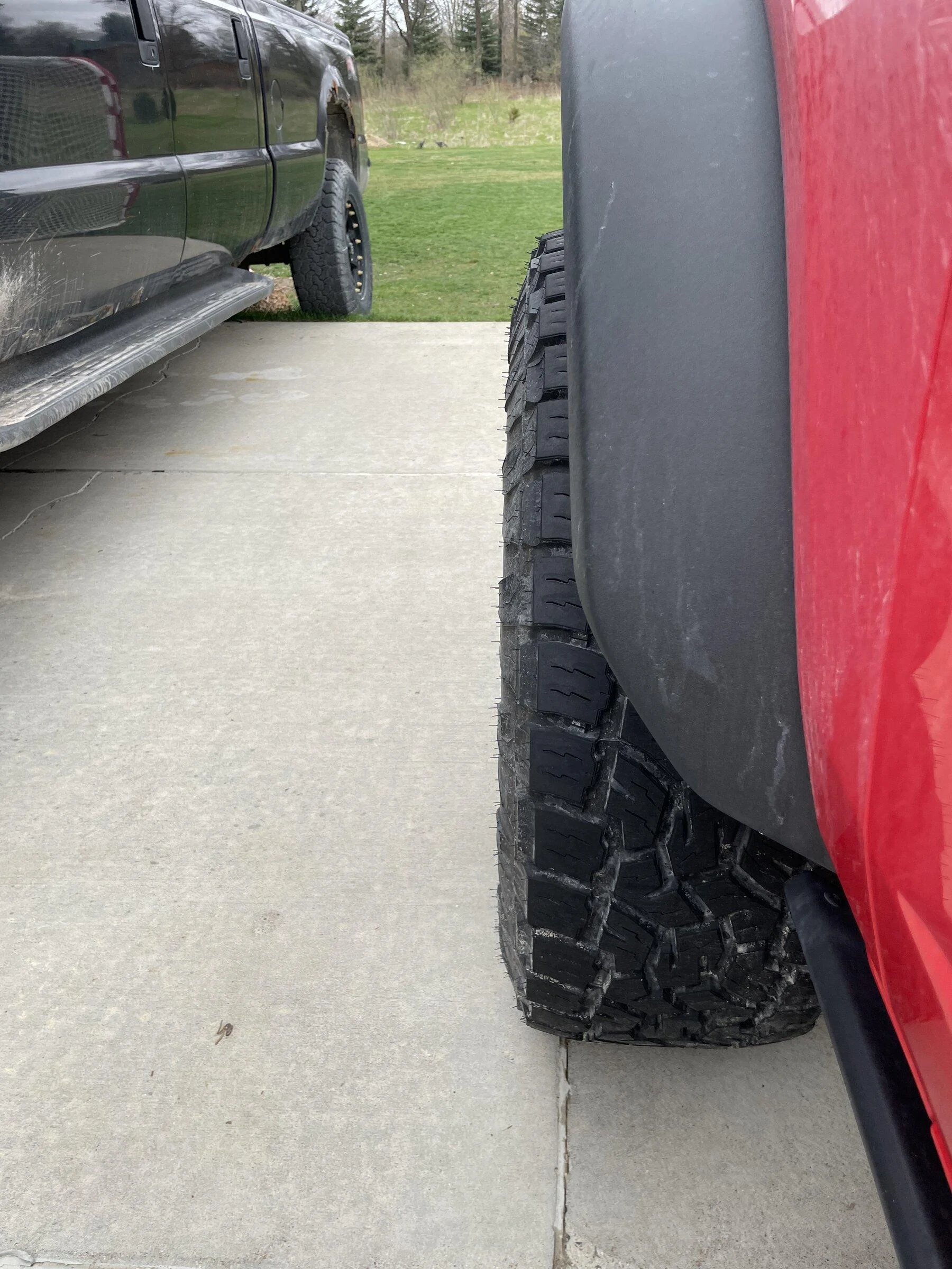

Nice combo! You rolling 285 70 17s? Curious about rub, travel and poke? Dealers in my area are pushing me to a zero offset on both the MR 703 and MR 706. Thanks
295/70 r17 Yokohama MT…Very little poke..No rubs…+35mm offset

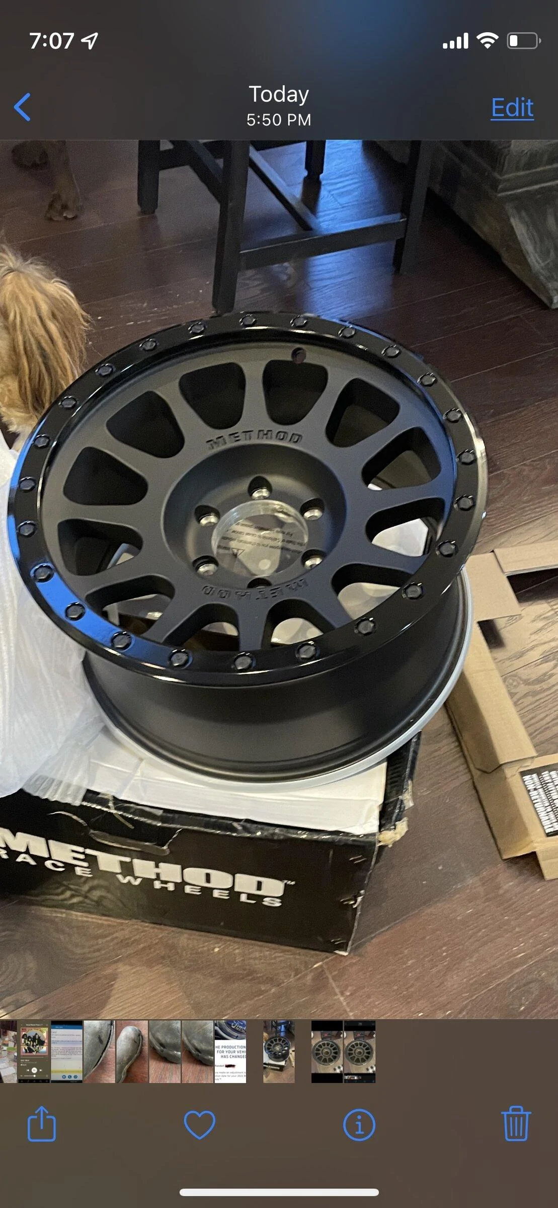

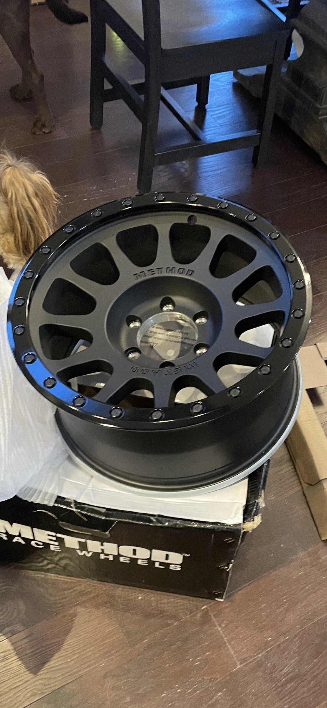

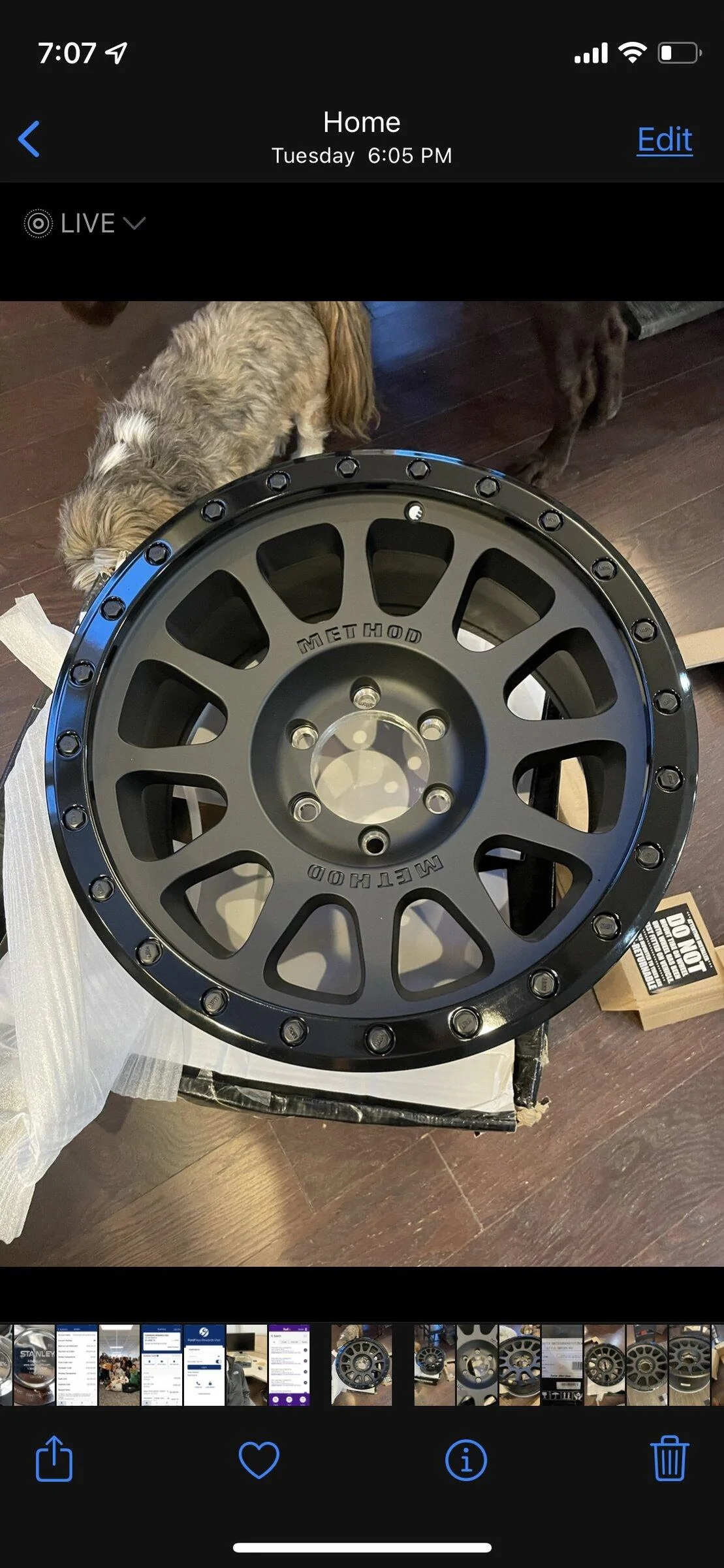

Double black I have 5 sitting in my office my Bronco build is today. 18x9 -12 offset
Ford Bronco {thread} {filename}
If it’s not too much to ask, Could you post a picture of the poke from these wheels? And your tire size? Thanks!
I have 305s (-12mm) on order and am trying to understand How much poke you expect.

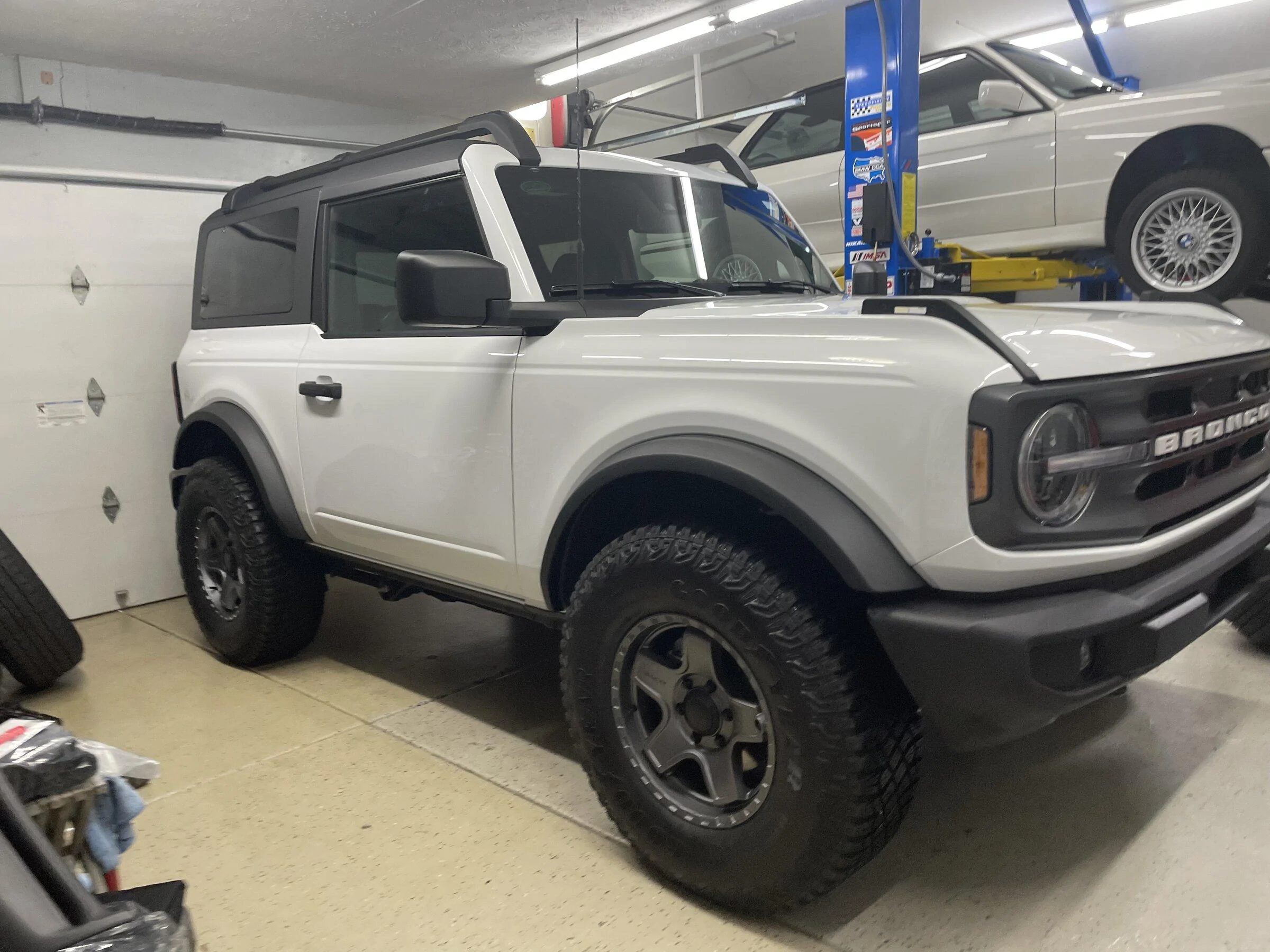

Titanium 17x8.5 0 offset 305's
35x12.5 Trail Grapplers
ReadyLift 2" SST Lift Kit - 69-21200
Sasquatch flares
Hot Damn, I love this. I have the same wheels on order in a -12mm offset.
Can you post a picture of the poke?
