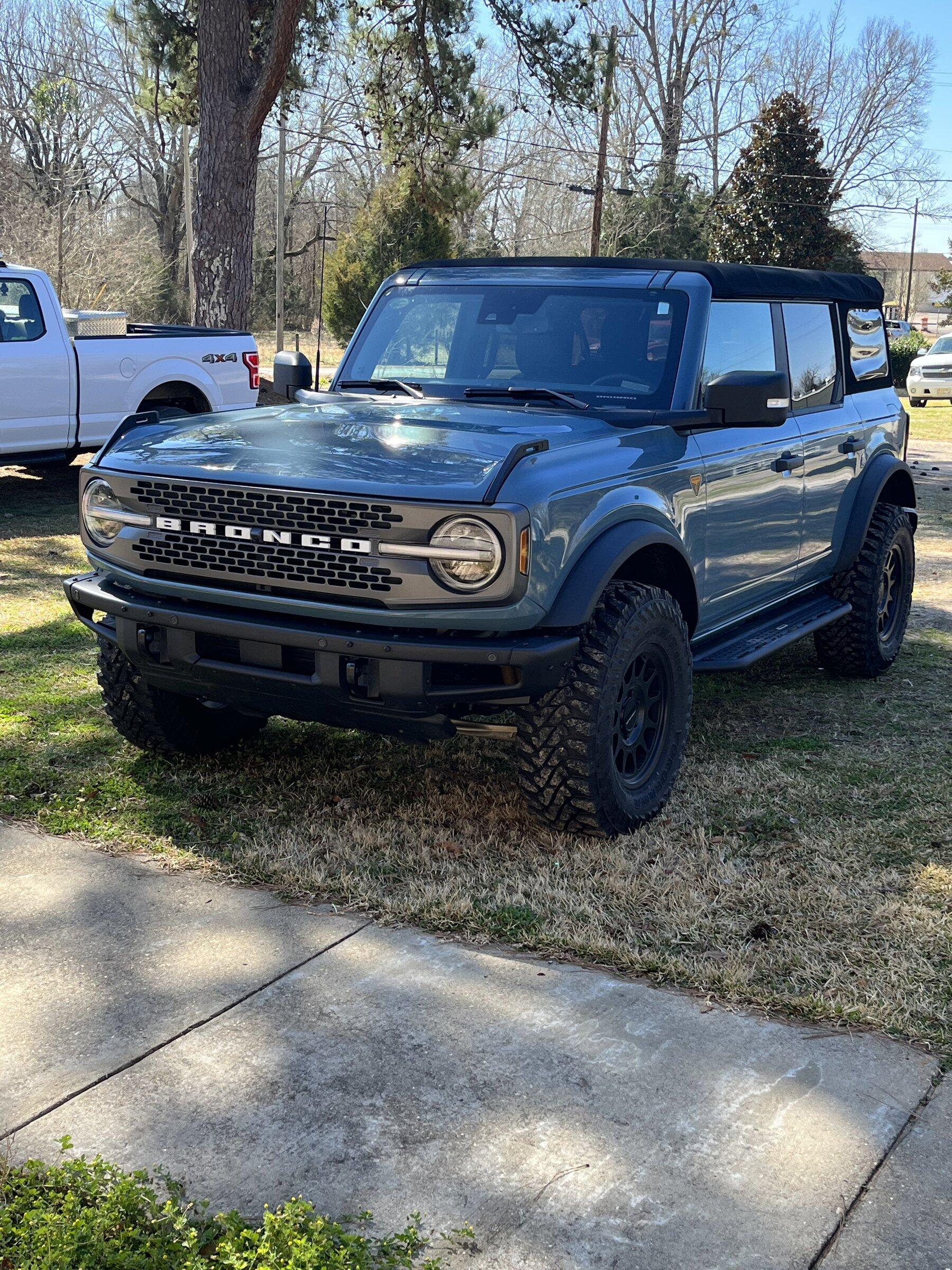

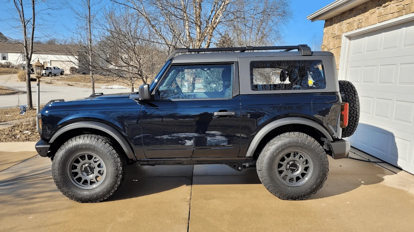

That’s what I was looking for..I’ve ordered the 703 with +35mm black for my badlands non sas..I’m going with Yokohama 003 MT in a 295/70r17..I was scared the factory +55 was not enough offset for the wider tire but didn’t want a lot of poke
[/QUOTE
Ford Bronco Method Wheels 5C729E20-C5CB-49D7-9644-663AAC50CC61

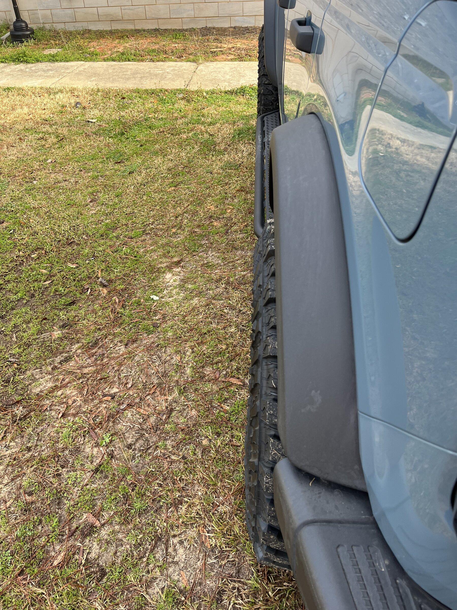

Got my wheels and tires installed today..Went with the 703 17 x 8.5 +35 mm offset. I’ve got very little poke but a more chunky look with the 295/70…Thanks for all the pics y’all posted it really helped on making my decision.

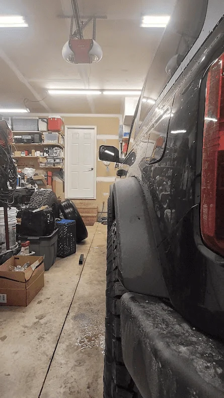

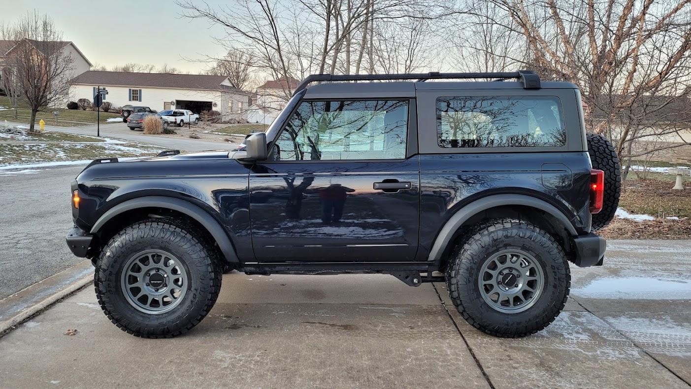

Wish I had found this thread earlier, I could have hooked you up with a bunch more of my pics.
Mine is the AMB two door posted 2 or 3 posts in.
I have 35 x 11.5 Toyo AT3 on a base Base.
NO LIFT.
props to :
Thanks for sharing the LOVE!! LOL
that’s with +35. Again not my picture or Bronco
Ford Bronco Method Wheels 1646105550404

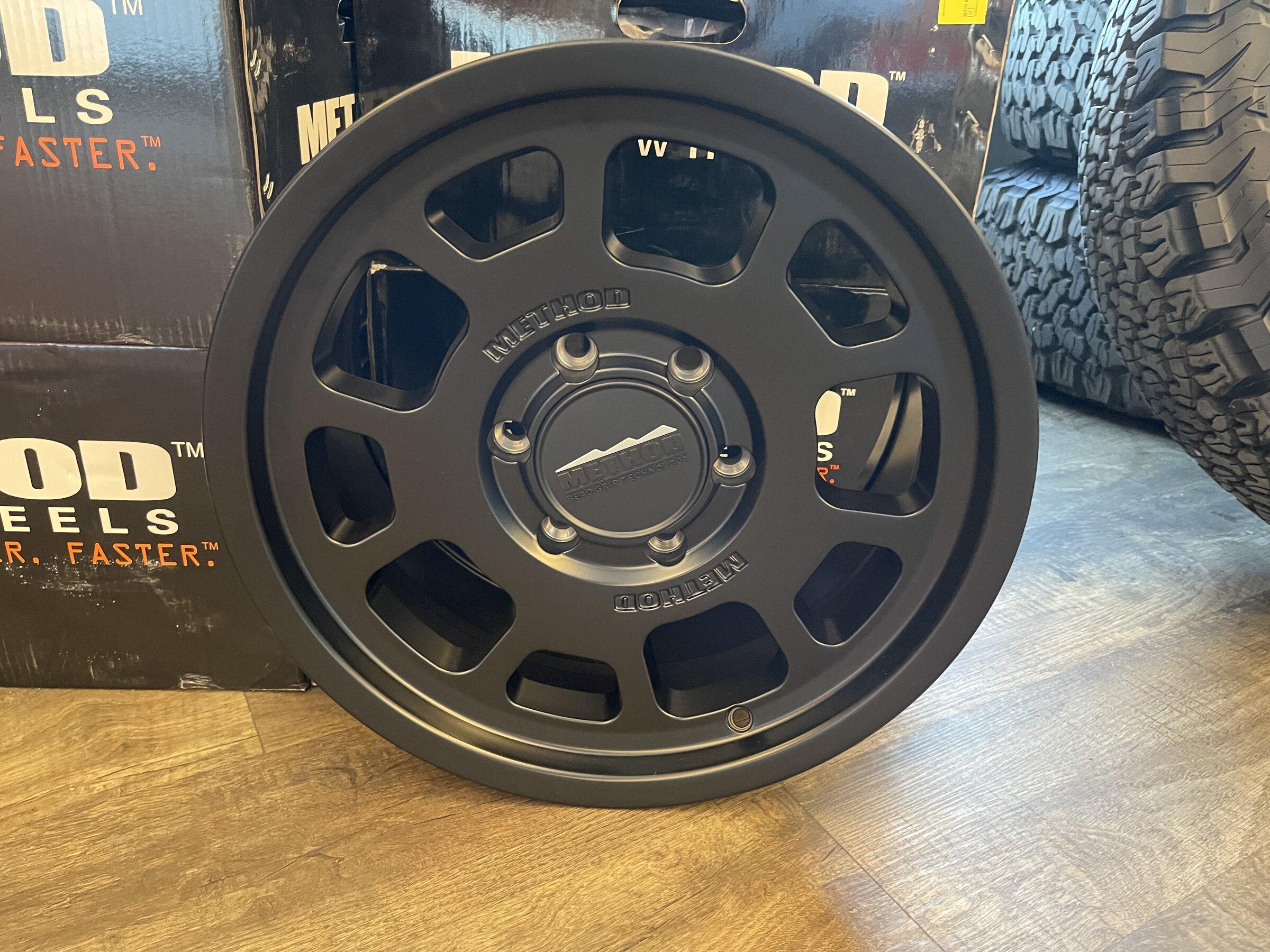

I have a set of the black MR705 +35mm wheels in the mail from a member here, due tomorrow. I’m planning on sticking with my stock 285/70R17 BFG’s that came on the Badlands. I keep looking at 285/75R17, 275/80R17, 34x10.5R17, 35x10.5R17, etc to go bigger. I don’t want to go E rated, C is limited to the Toyo AT3, D has some more options. I don’t need the bigger tires for anything but looks, and I know the weight penalty of 8+ pounds per tire won’t help. I‘ve been down this road with other trucks where I upsized the tires and killed the MPG and overall daily driving performance.
One concern I do have is clearance with the increased wheel travel on the Badlands. I’d be annoyed if I went bigger on tires only to have to limit the up travel.
Ford Bronco Method Wheels FDEED0E1-4D2D-4F8F-9967-C59B01A33529

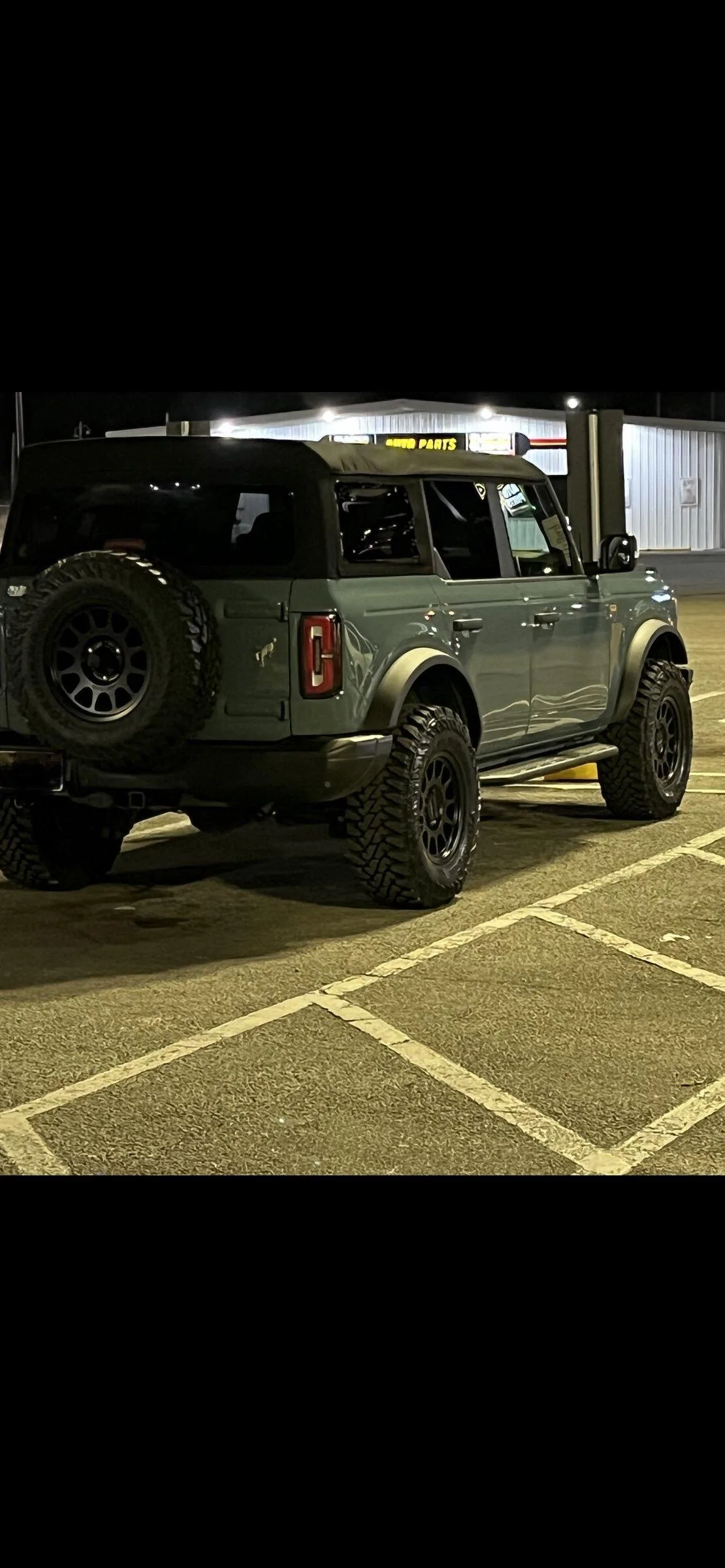

I had many of your same concerns..I wound up going with a 295/70r17..Its a little over .5 inch taller and wider then the factory tires. My main concern was clearance with factor rims and poke with aftermarket rims. The Methods with +35mm offset seem to be perfect. Also went from averaging 18.2 down to 17.8 MPG not that bad of a drop and it doesn’t seem to affect the power..The 4.47 gears still are great with the new tires.
Ford Bronco Method Wheels 5937F9CC-8BF3-4C57-829C-4FFD6799E31D
Ford Bronco Method Wheels 6F21CBF9-DC48-4ED9-94C6-D8E694CC80FB
