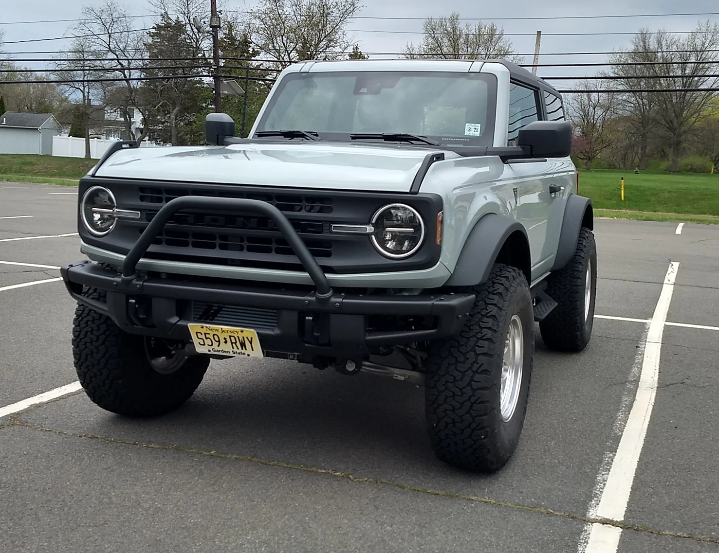

I have 17x9 with -6 and I don't think you want to go farther out, probably in a little so I suggest the 17x9 with 0 offset.

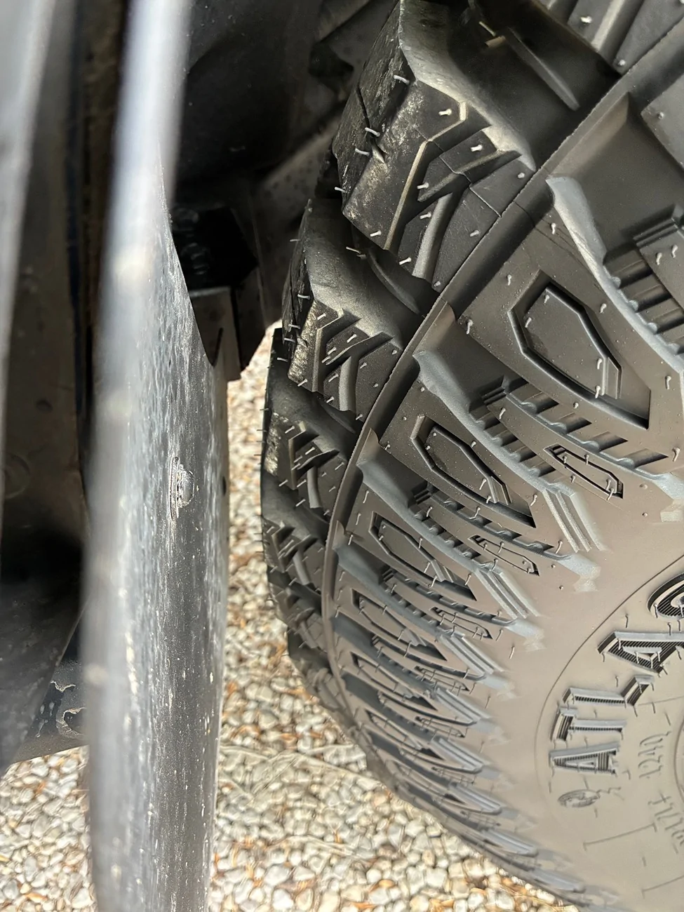

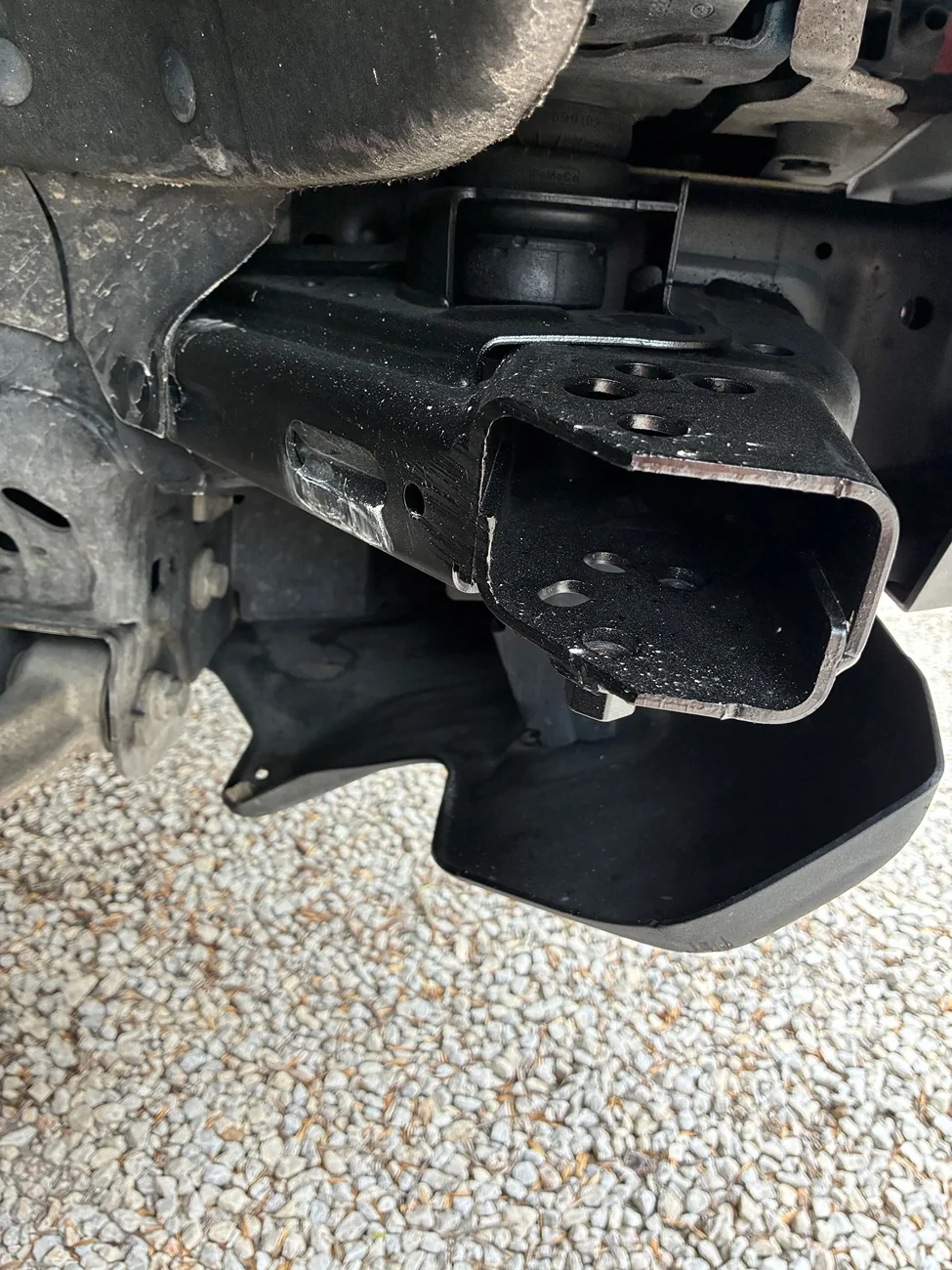

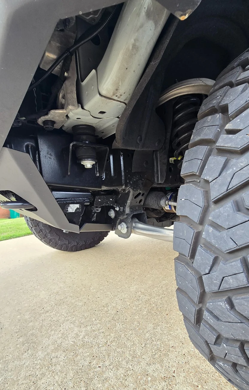

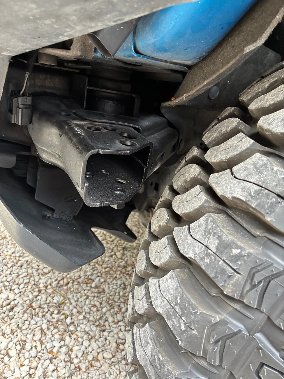

+12 really worked well for me. I did cut the corner off the front crashbar mounts and plan to completely remove them, but went trail riding and tire is barely rubbing at the front at full lock. (See dirt mark at plug weld in first pic).
I had already cut an inch or so off the rock rails and have bro flaps that hug tight away from the tires.

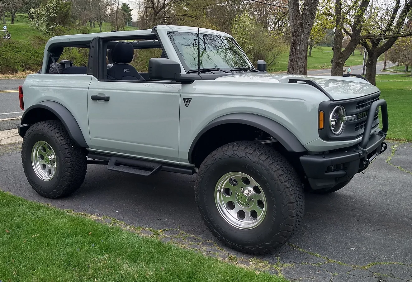

Are those 37s? Any rubbing issues?
Love that style of wheel.
Yes, 37x12.5x17. The BFG KO2's tend to run a little smaller so I haven't had any rubbing.

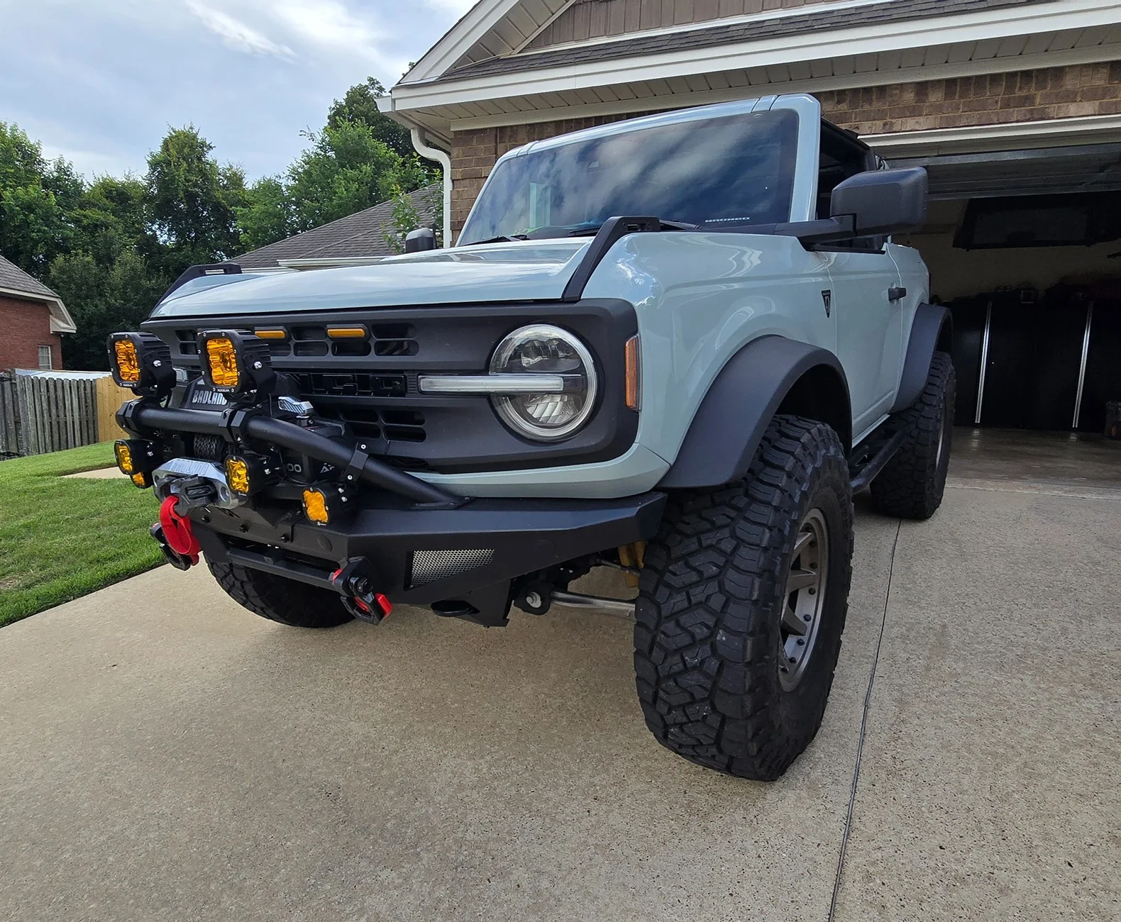

I went with 17x9 with 0mm offset.
I went with Ion 171 that look similar to your wheels but a little less expensive.

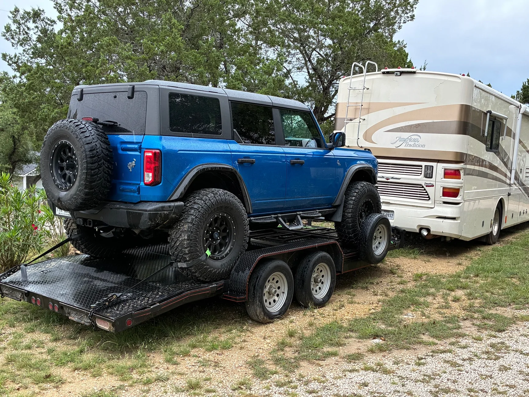

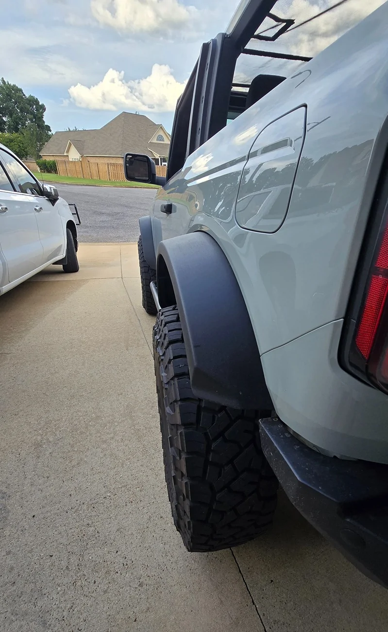

17x8.5 0mm for me. Sasquatch with about a 2.25" lift. Oh....standard fender flares.
Looks great! I remember when you started that build. I finally upgraded from 35’s to 37’s recently. (non-sas BD) Wish I had skipped straight to the 37’s honestly.

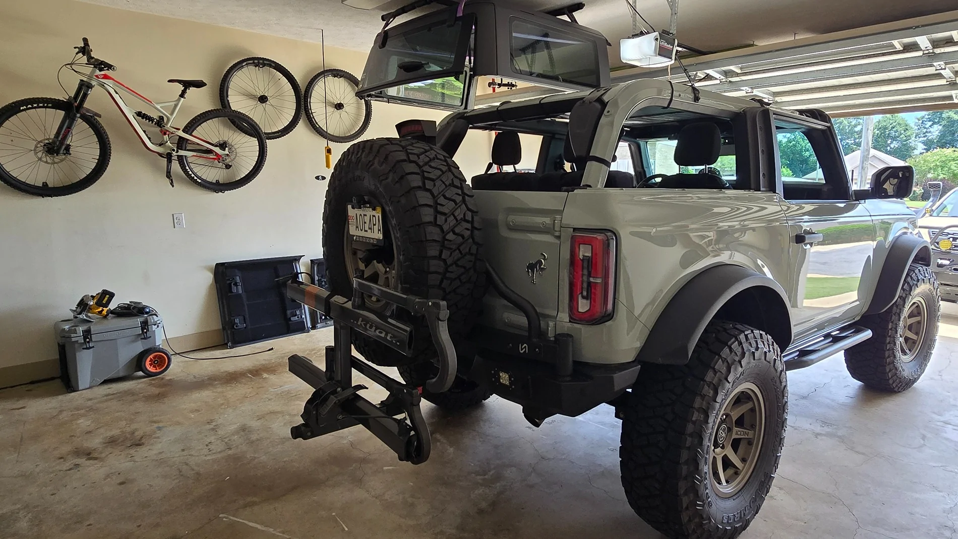

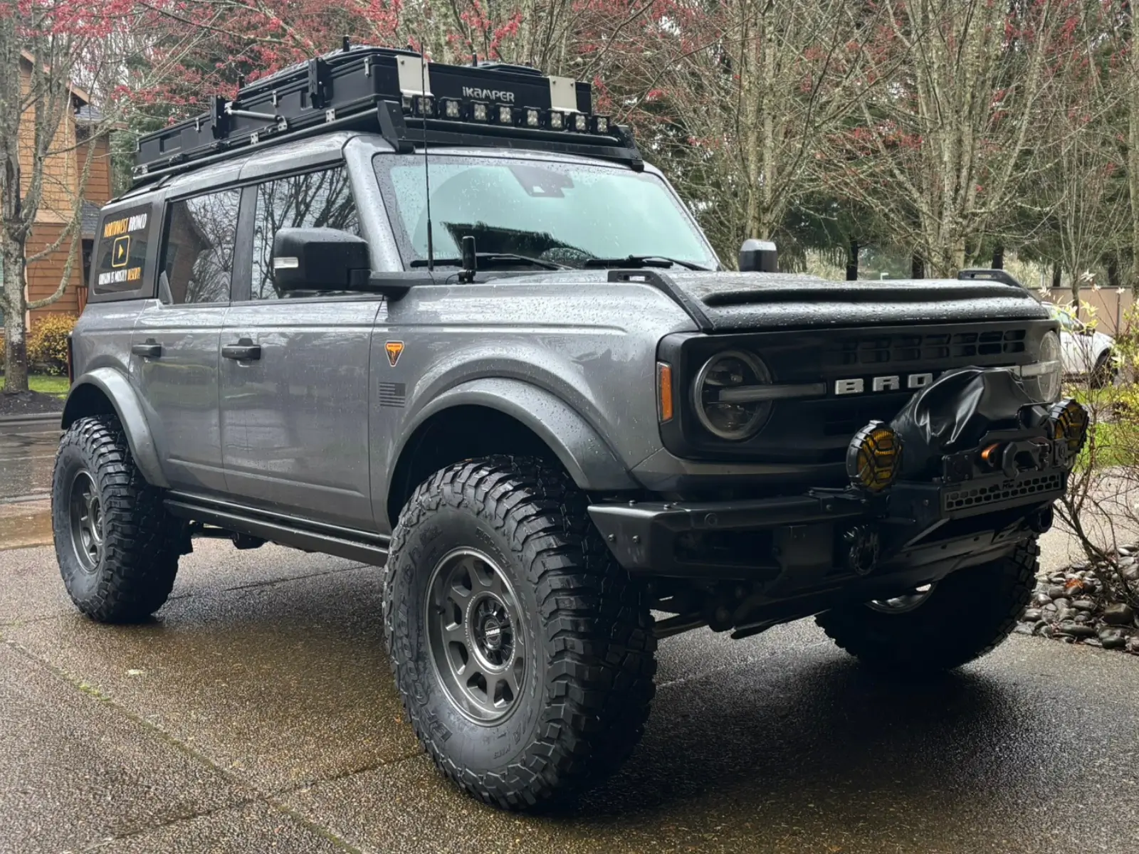

23 sasquash with 37's
SVC spacers on OEM Bilstein
37x12.5 x17 Toyo Open country R/T
17x8.5x17 0 offset Icon Rebound
JKS max tire kit
