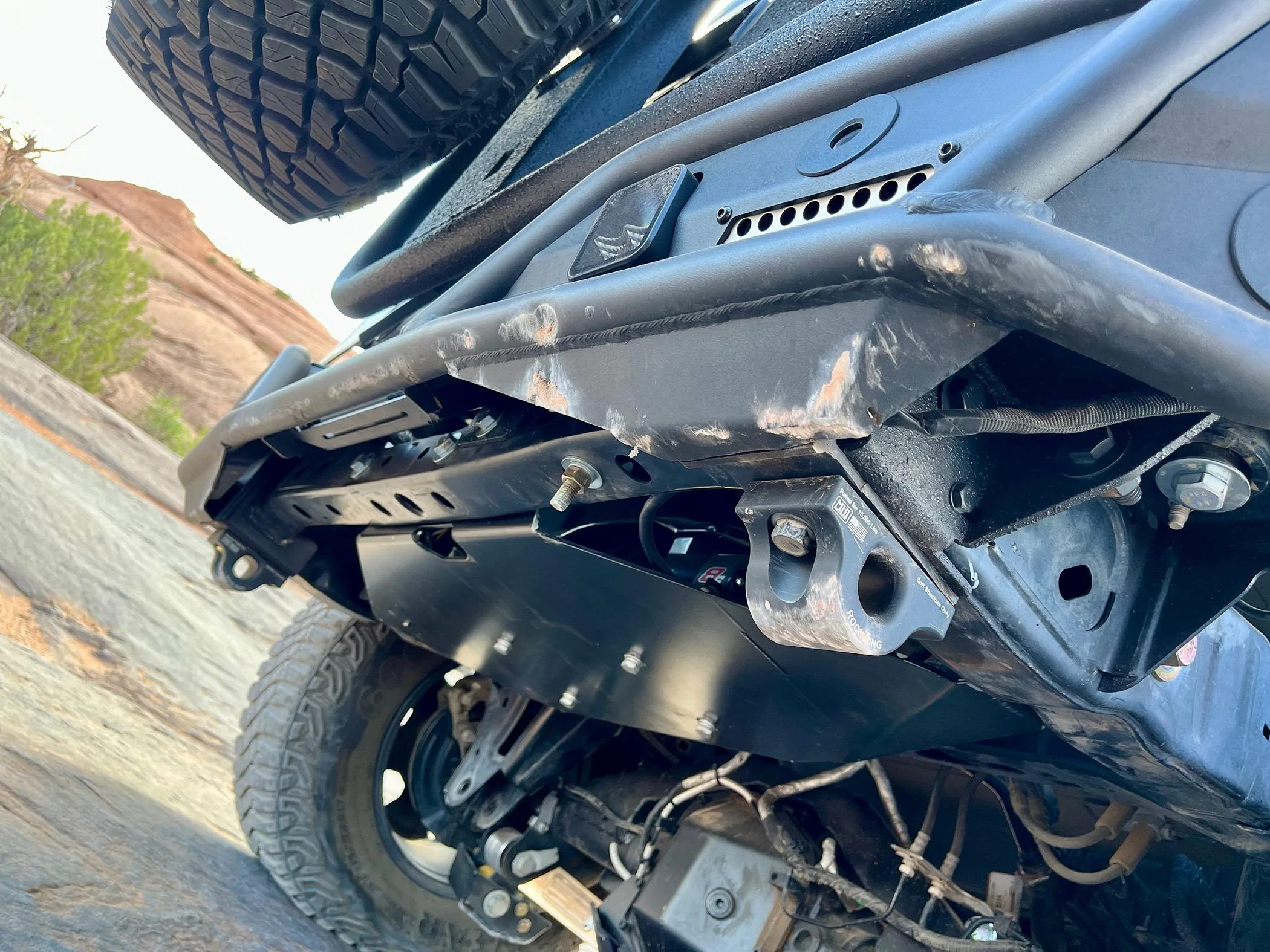

Having been inside the crossmember that the factory hitch is hooked up to, I’m not trusting the recovery tools installed into the receiver to do any tough pulls. That crossmember is pretty flimsy. Check out the attached picture-it couldn’t even handle the full torque on the bolts for the tire carrier without collapsing. Pulled the receiver entirely. (Which is funny as originally I wouldn’t budge when Ford was trying to entice me to remove it to get the Bronco sooner)
I’ll use a bridal attached to both frame mounted points for anything on the rear if not using the rear winch. (Rear winch is bolted up to the rear crossmember, both frame rails, and the next crossmember in line)
Ford Bronco Winching vs Pulling Deadfall IMG_1795
Hauling logs aren't generally too tough of a pull though. Just big and awkward.
They do like to get wedged between trees, but that's usually a sign to stop and make another cut, not back up and hit it harder with more gas. Even the really heavy green ones, you aren't carrying the full weight, just dragging it.
So long as you don't go and try to jerk on them (which could possibly snap your line anyway), or get caught on the downhill slope of a big one when it starts rolling down (I bent a rim on my tractor and snapped the winch off that way once) - I can't see an issue with it, even with the trailer hitch.

Oh right. My bad. Forgot this thread was about fallen timber and got hung up on the hitch 😂👊🏼
I’d agree with that for sure
