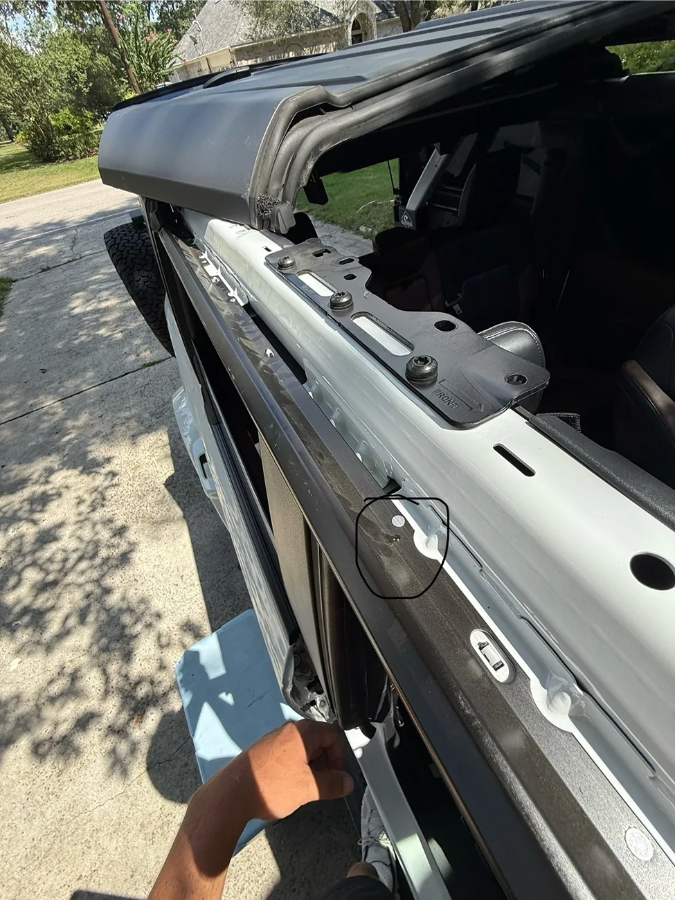

Had my bronco for a little over a year and always had a creak when the passenger rear window hits max uptravel, finally got annoyed enough to look at it and all of these nuts on this bar are backed out, assuming never torqued but my question is how do I access them? And has anyone else experienced this?

I believe you have to pull the plastic trim on the under side, like where the side curtain airbag is. I've seen a lot of other posts from people where those bolts have been loose.
It's not hard to get off - a couple of small bolts where people usually add grab bars or paracord.

thanks man that’s exactly what I did, I looked and couldn’t find anything about it. Window still pushes it up a little causing the trim to poke out some so I’m thinking about maybe lowering the window a bit, project for another day though. Thanks again!
