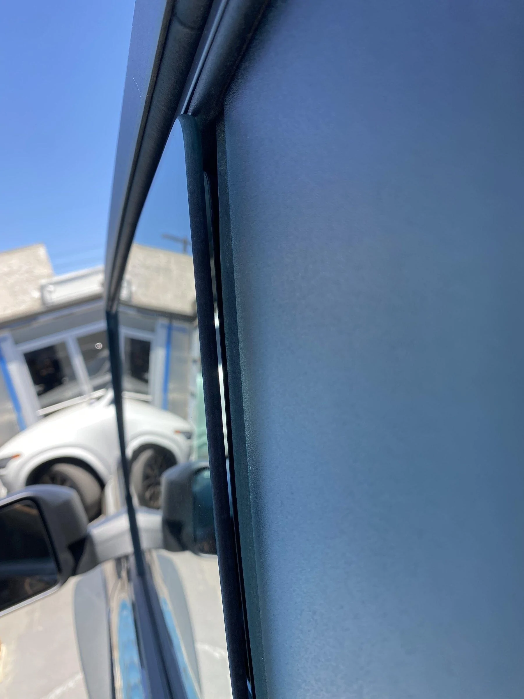

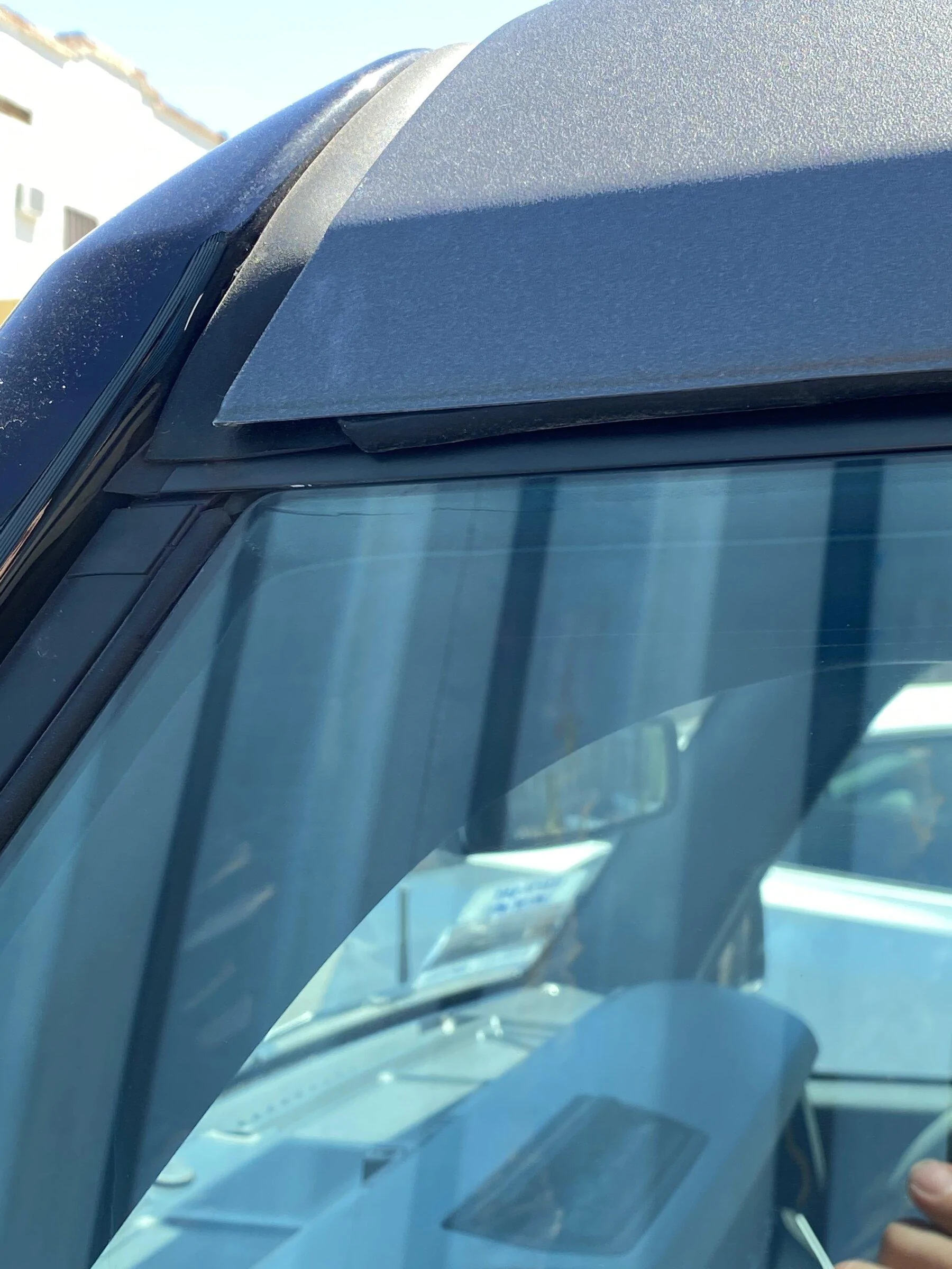

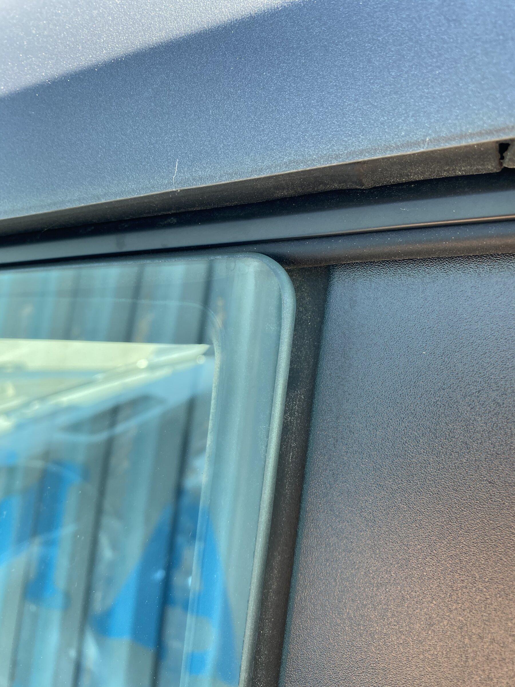

Finally pick up my bronco and on the way home I noticed a lot of wind noise and thought the window wasn’t fully pulled up. Checked and it was all the way up. So, just thought it was the side mirrors making the noise.
Few days later, I noticed the same side (driver) auto-window function didn’t work. Then noticed the window did not pull down and up slightly when the door opens and closes. Then noticed a gap between the window and the seals.
Anyone else has this problem?
UPDATE FIXED:
Solution is to reset the window limits.
1. Push and hold down the window switch. Once at the bottom keep holding for an additional 5 secs.
2. Pull and hold up the window switch. Once at the top keep holding for an additional 5 Secs.
3. repeat 2 more times.
4. Open the door.
