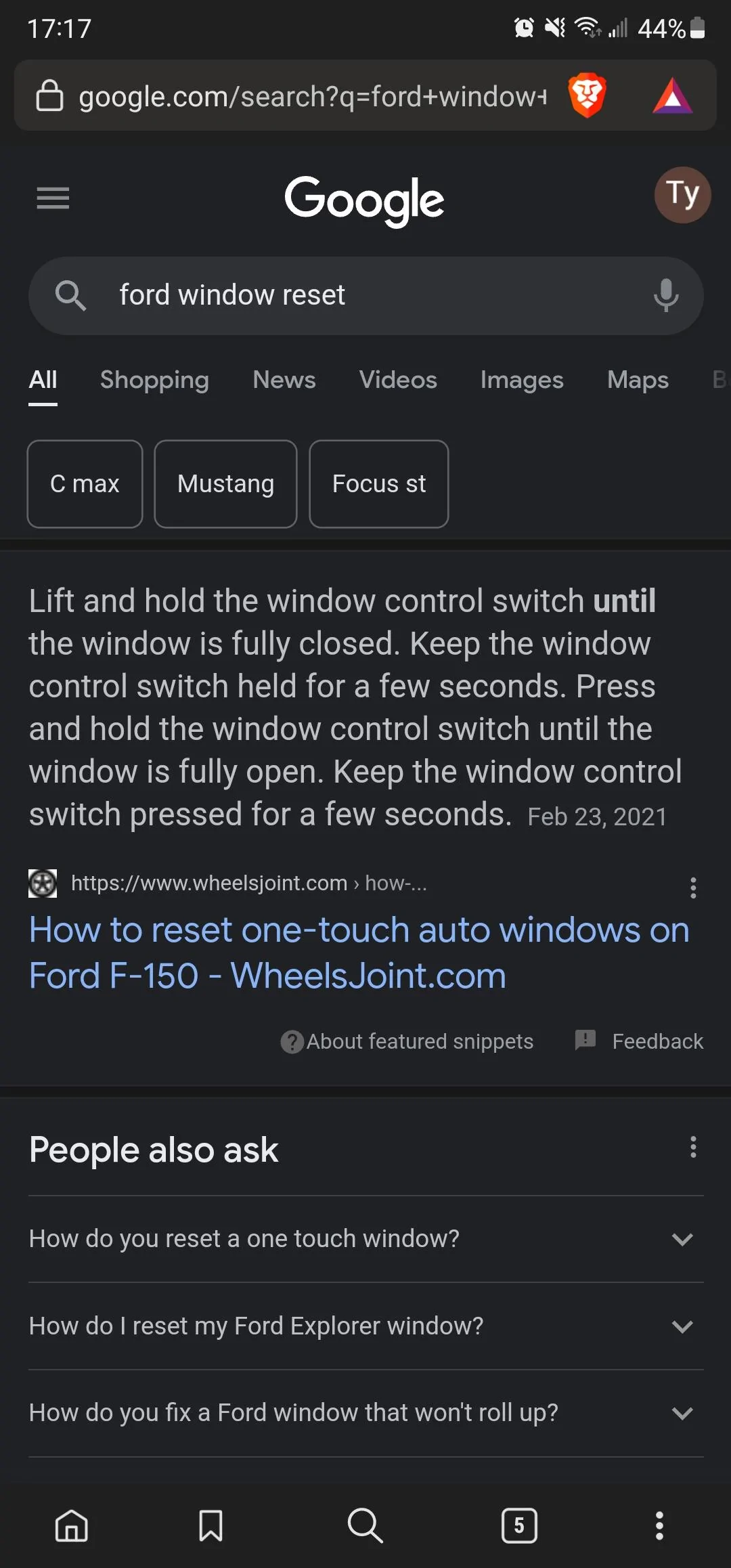

I've tried searching and can't find the thread. After I got my bronco back from the engine replacement my passenger side window will not reset. I've rolled it up and down fully multiple times. Any ideas?

Turn the vehicle on.....Roll down the window and hold the button depressed for a 6 second count.....then roll it up and hold the button up for 6 seconds......then roll down the window again and hold it down for 6 seconds....then roll it up again and hold the button up for 6 seconds...release the button then open your door to see if it auto rolls down the 1/4" or so...I tried it several times with no success until I did it twice in a row...that fixed the issue for me...let me know if this helps you

Didn't work on mine. Might have to go fight to get a passenger door module, every fix on this car has been a fight to get done.
