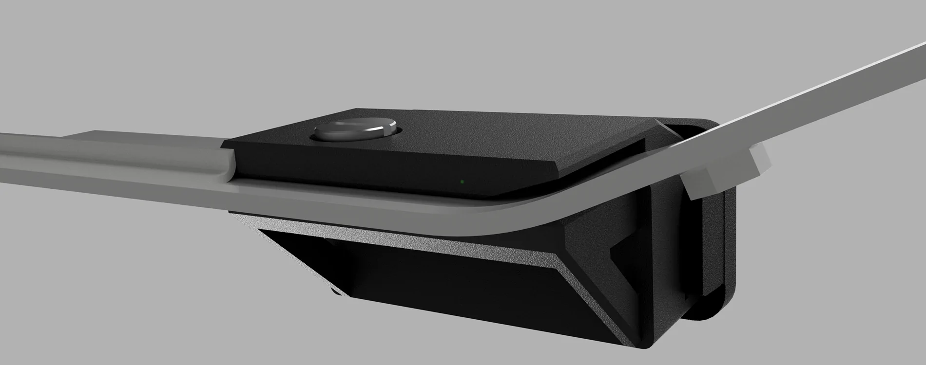

I make a Junction Box for the Upfitter Switch Connections. It uses WAGO 20A lever connectors for switches 2-6 and a 30A for Switch 1. I mounted to an unused ground wire Rivnut (apparently used on Lux package unfortunately) so I'm working on a version that mounts using the 'racetrack' hole to the right. Still a bit in development but I've been using it for several months.

I just updated my design to mount over the small 'oval' racetrack slot between the ground wire rivnuts. Have to print one to verify it will fit but I'm optimistic:)

I lost part of my reply earlier. It is designed to 'organize' your upfitter switch wires. My 'standard' package Black Diamond has two unused ground rivnuts in the flange and I used one for my mount. I've found out that some of the 'higher end' trim packages use that unused rivnut so I've redesigned it to use the 5/8"x7/8" slot between two of the ground rivnuts. I'm printing the first one of that now. I'm thinking about selling them (I'm retired and not set up for that) but have an agreement with a guy who is that I could transition over to. I'm thinking I could produce them for ~$40 plus shipping. Thoughts?

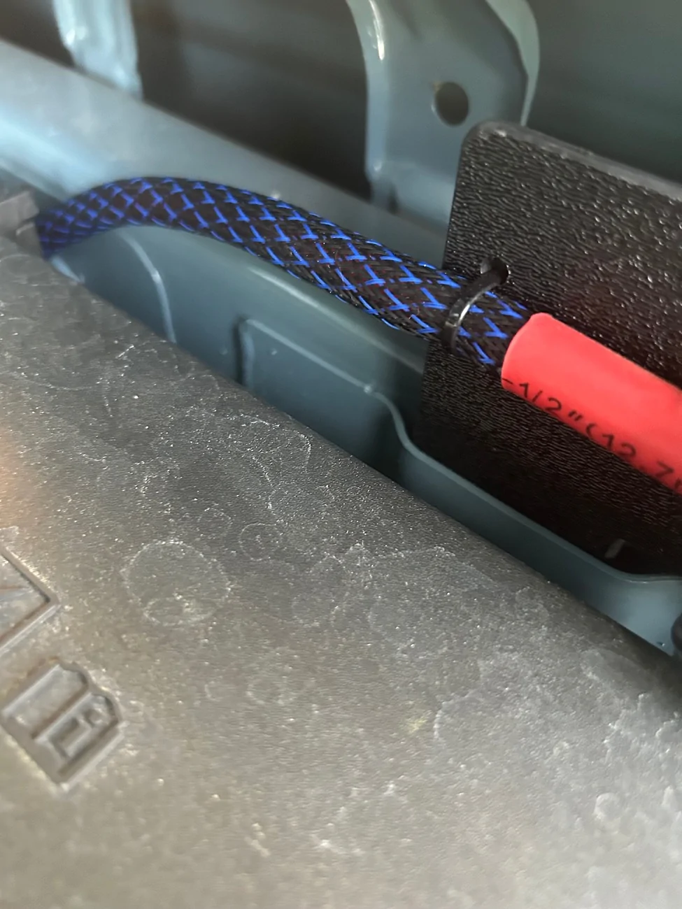

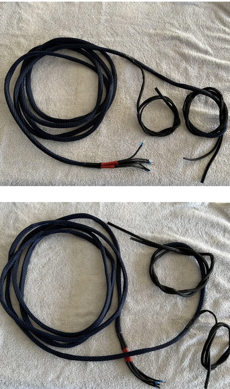

I like to pre run and tape wires together. Or use string to get length. Then a combination of Tesa tape, braided loom and heat shrink as shown in my power and speaker wire runs.

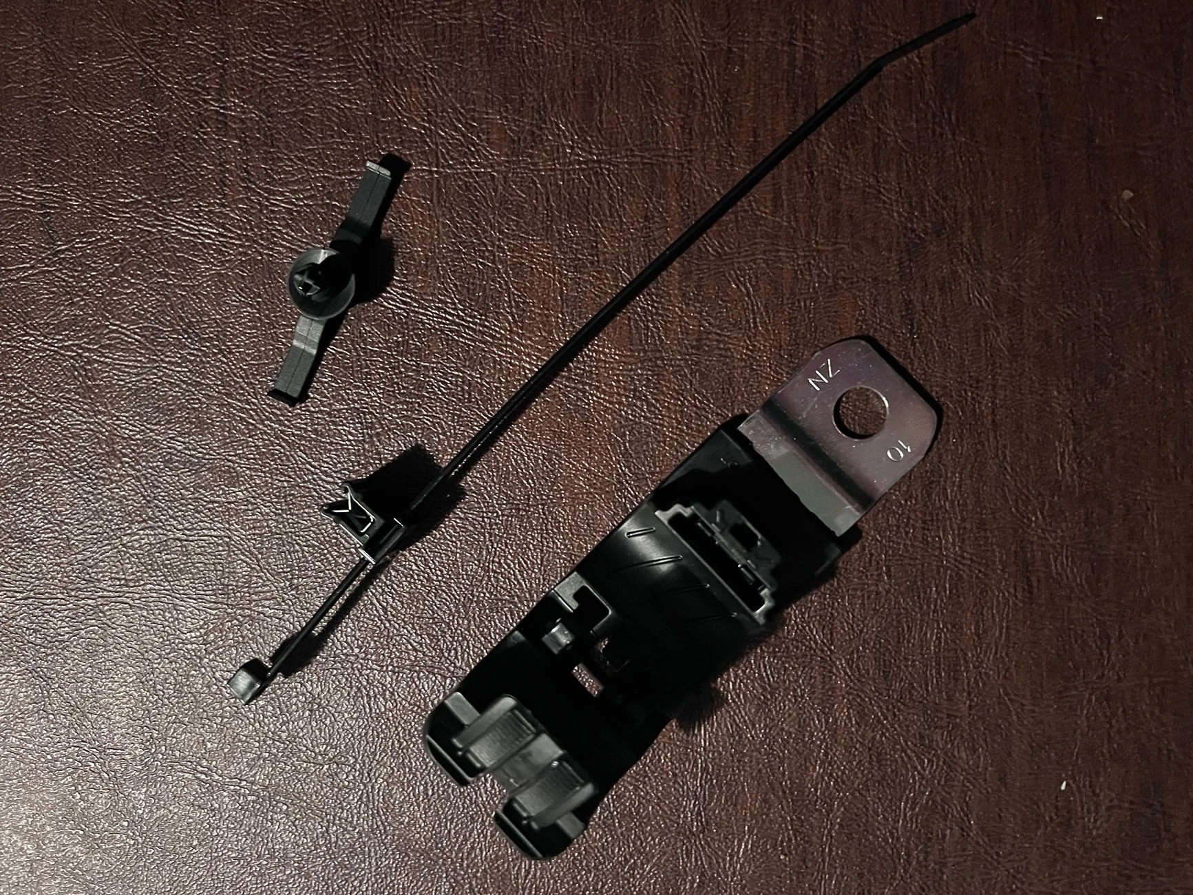

If you add the friction tape as mentioned before, the wires look factory..

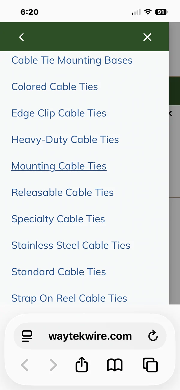

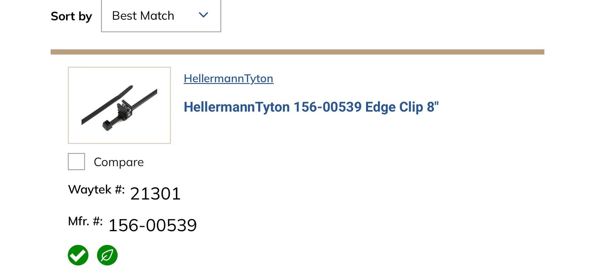

Companies like WayTek sell a large variety of cable ties.
Ford Bronco Wire management tips/suggestions? IMG_8275
Ford Bronco Wire management tips/suggestions? IMG_8276
For wiring that run over the ‘firewall’ or other places that have thin edges…

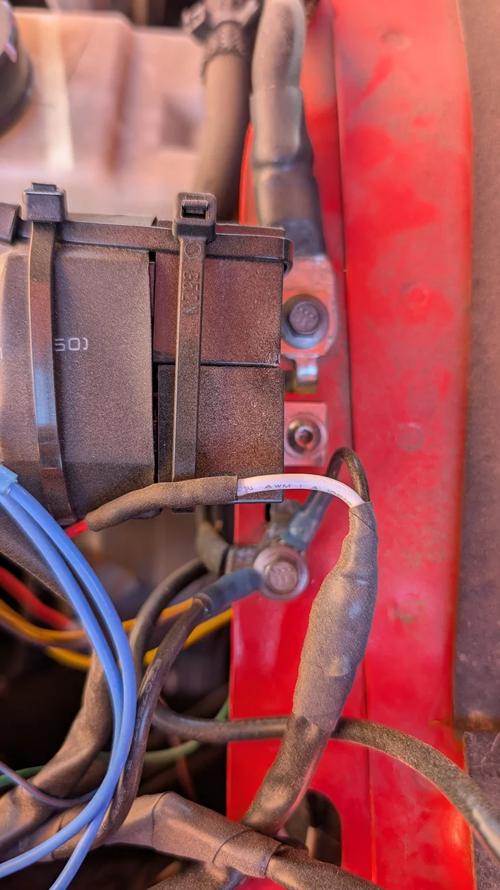

Give me a chance to make sure the new design fits as intended and I'll make you one. I don't know if the Raptor has the same configuration in that area. If you are interested, send me a picture of the body flange where the ground wires are and I can maybe tell whether it will fit.

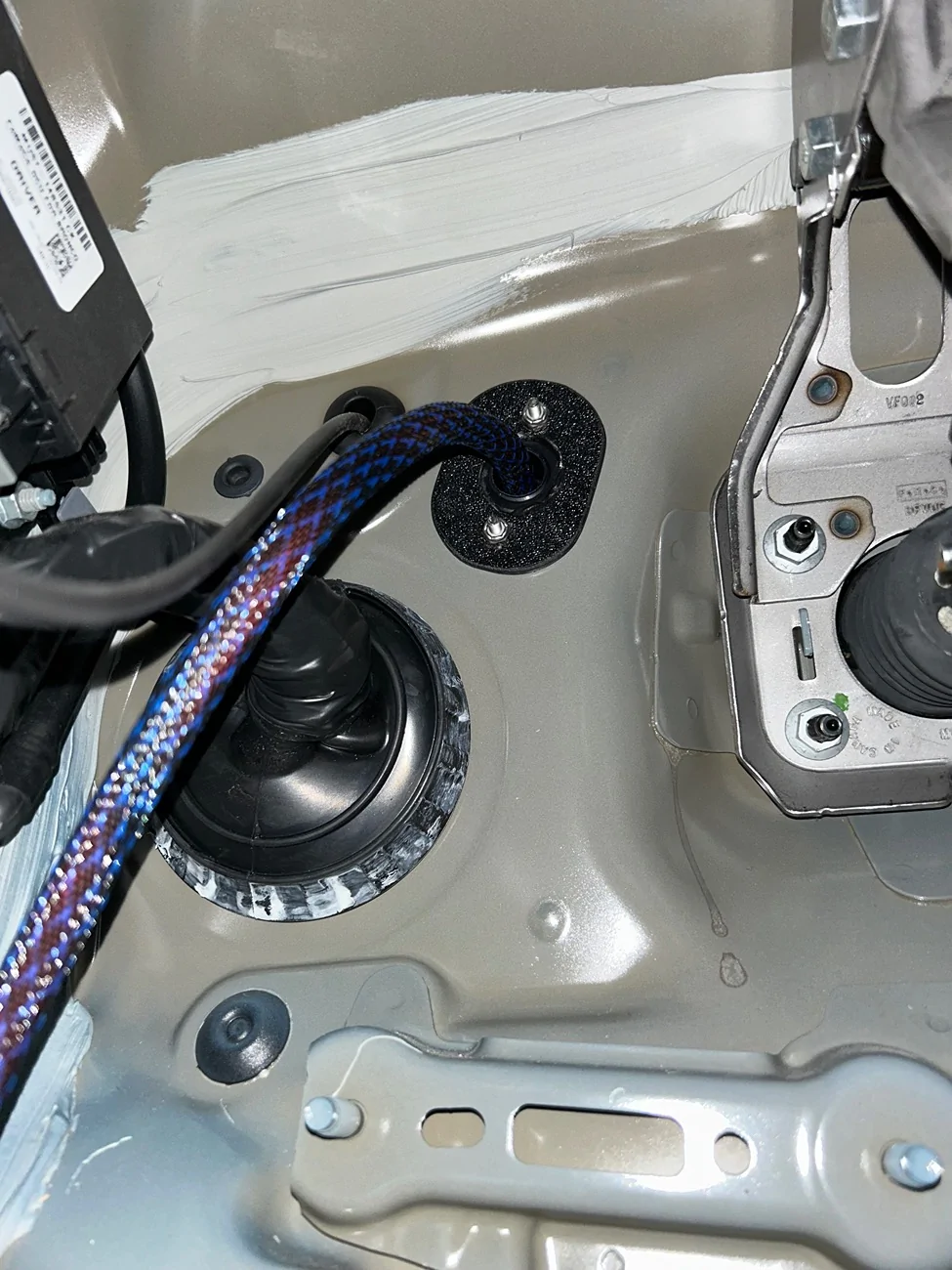

Might as well throw in my custom ABS firewall grommet. It’s two sided. Engine bay side has the wire bushing attached and the seal to firewall. Through bolted to inside piece.

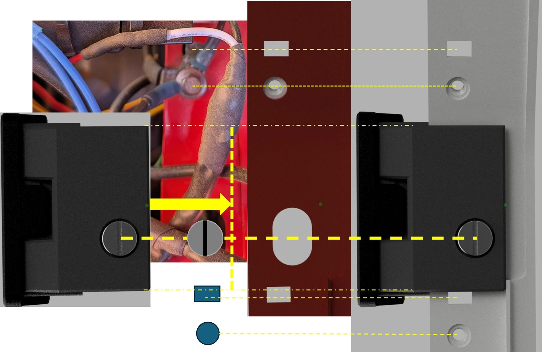

I think it will fit if there is nothing between the 7/8"x5/8" slot at the bottom of the picture and the rectangular hole below it just out of the picture. See the attached picture for placement. The only question is that the thin sheet metal on top of the main flange might be a little closer to the edge than mine is. Might take a slight amount of filing but there is some ability to move it around inside of the 7/8"x5/8" slot. The shoulder bolt is a little less than 3/8" diameter so there is some movement within the slot available. I've (hopefully) accounted for the bend up in the flange (second picture).

😮😮😮. Fantastic reverse engineering there.
If beggars can be choosers, the Raptor amp order is 10, 15, 30, 10, 10, 10.

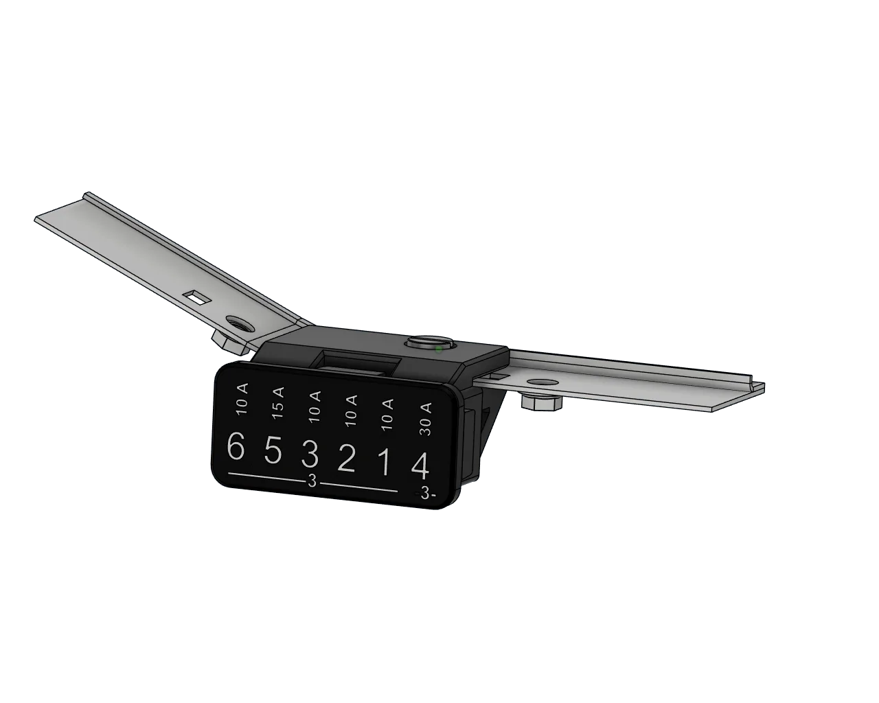

I'm happy to pay for this!
As I'm facing the plate, how are those ordered 6, 5, 4, 3, 3, 1?

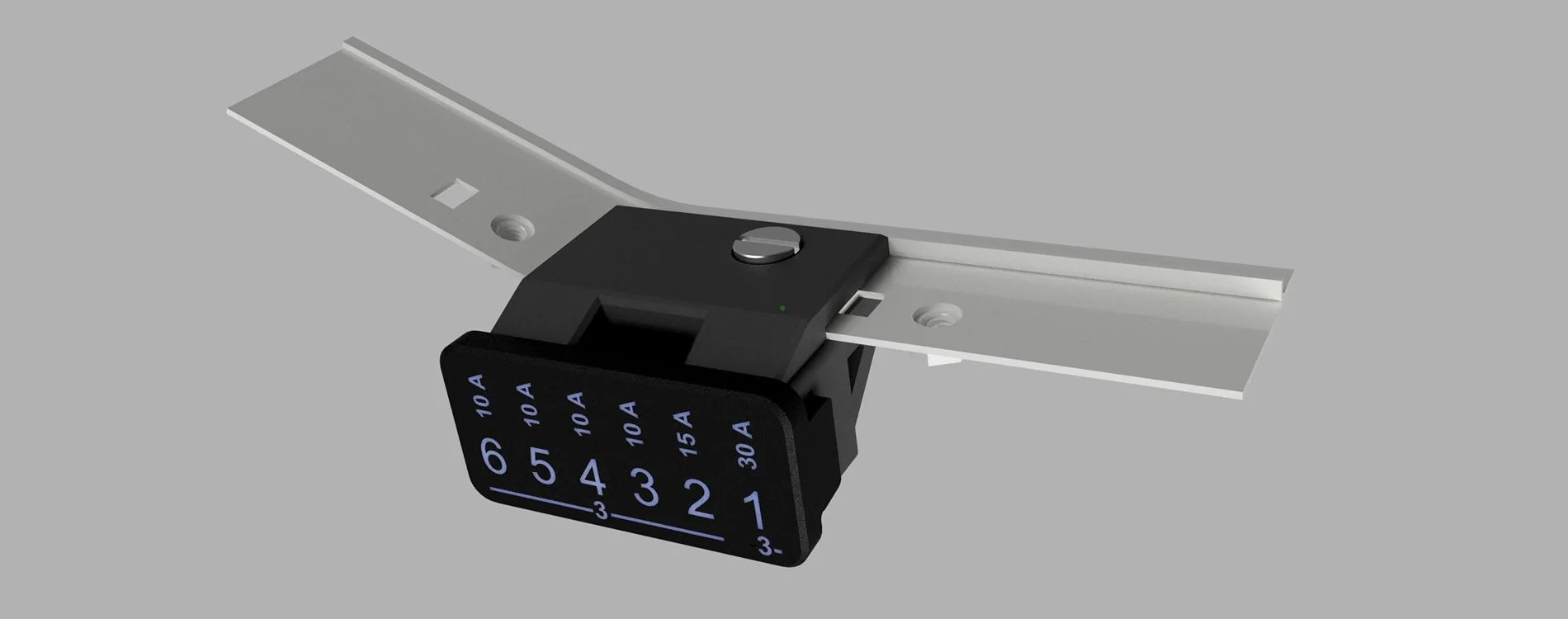

Unfortunately, the 30 A WAGO only fits in the rightmost slot (currently labeled '1')I can change the amps on the rest of them but I'd have to re-lable the current '1' to 4. I'll generate a picture.

Picture of the order. Only the 1st slot is a 30A WAGO, the rest are 20A
