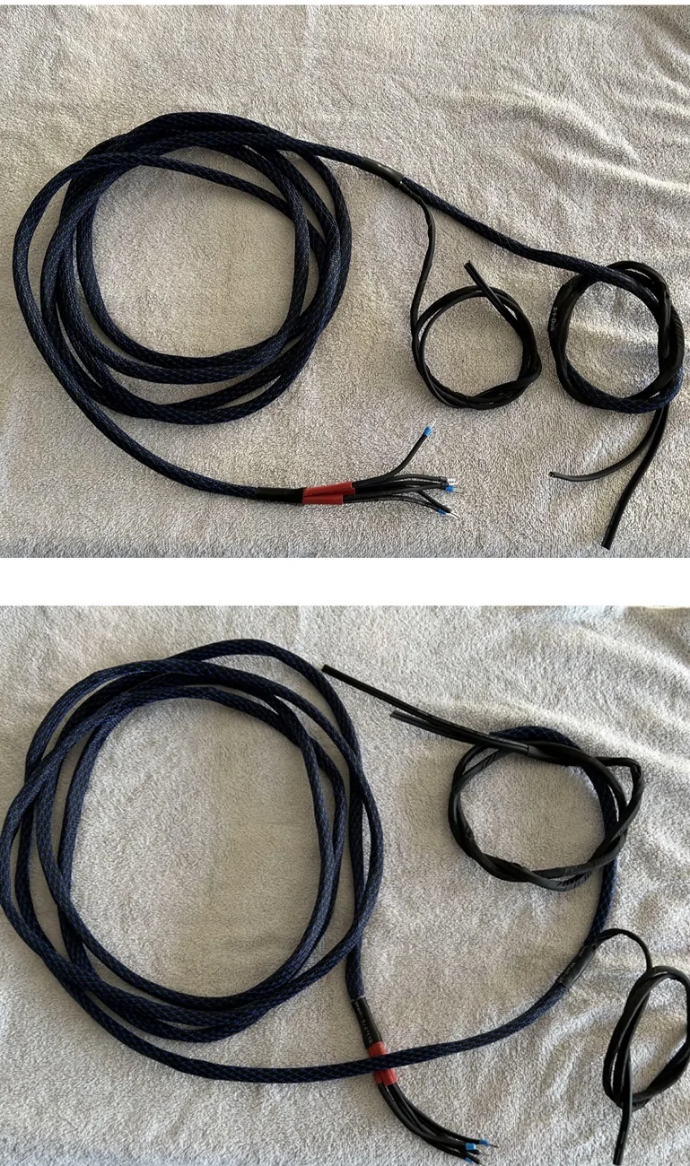

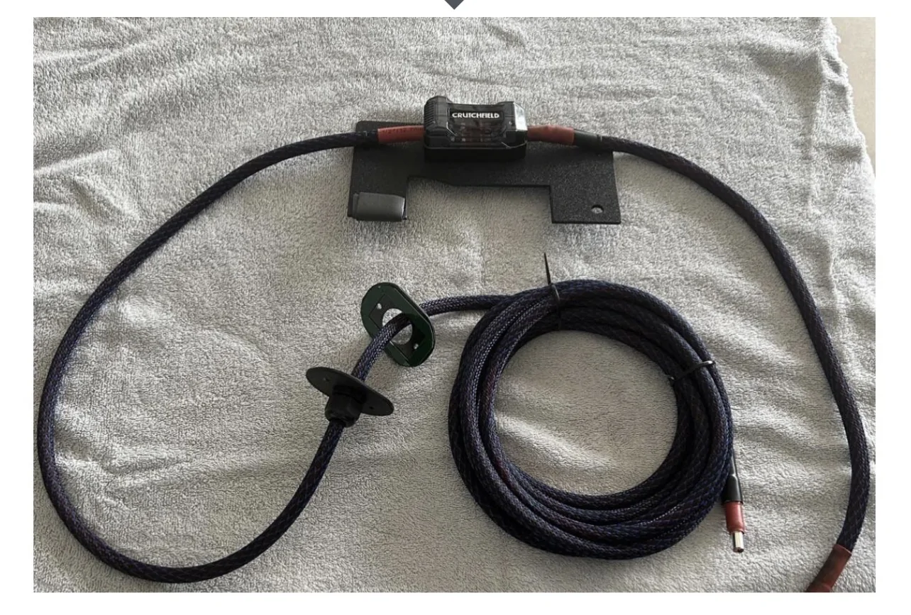

I believe there is only one way to do the wiring properly if you want clean wiring. Tying up extra somewhere is not the answer. Not wrong, just not the best. Cut the light harnesses and add new wire of proper lengths. You can temporarily run them and bundle them with small ties or tape. Then remove and wrap in Tesa tape followed by braided sleeve. Heat shrink ends of braid or cut with a hot knife or heated razor blade. I find it fun and rewarding to do a really nice wiring job. It will also be trouble free if terminated properly.
Ford Bronco Wire management tips/suggestions? IMG_1754
Ford Bronco Wire management tips/suggestions? IMG_7668

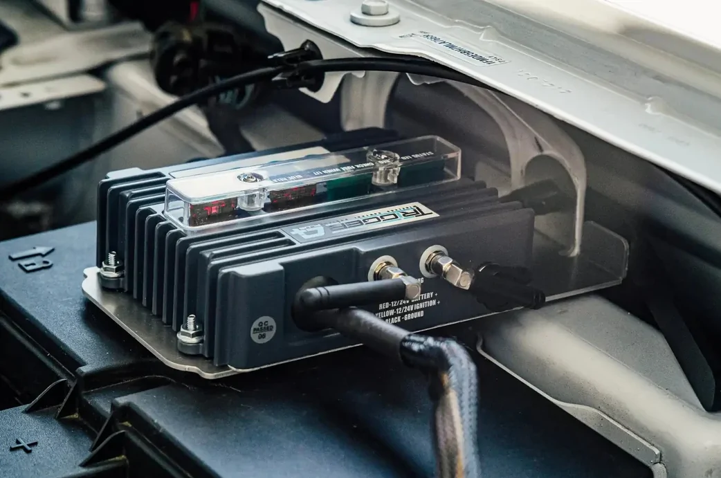

One thing we've had great feedback on recently is using something like our TRIGGER system. We offer a Bronco-specific setup that includes a laser-cut underhood mounting bracket for the controller and a visor/flat mount for the RF remote. It cuts down on running wires into the cabin or drilling through the firewall, while still giving you 4 or 6 fused accessory circuits. You can also control everything from the RF remote or the TRIGGER app.
It's definitely not the only way to do it, but if you're planning multiple accessories, it's a nice clean solution!
Ford Bronco Wire management tips/suggestions? Trigger
