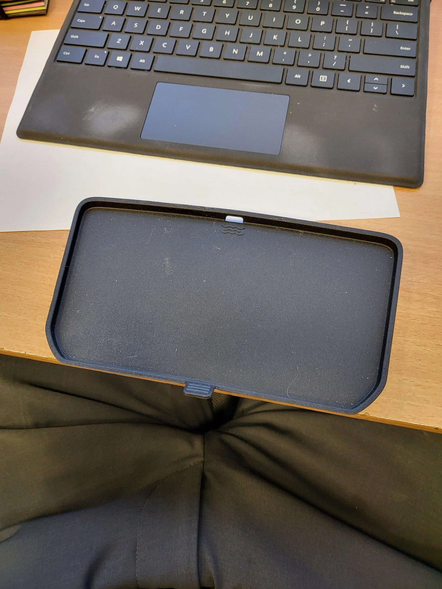

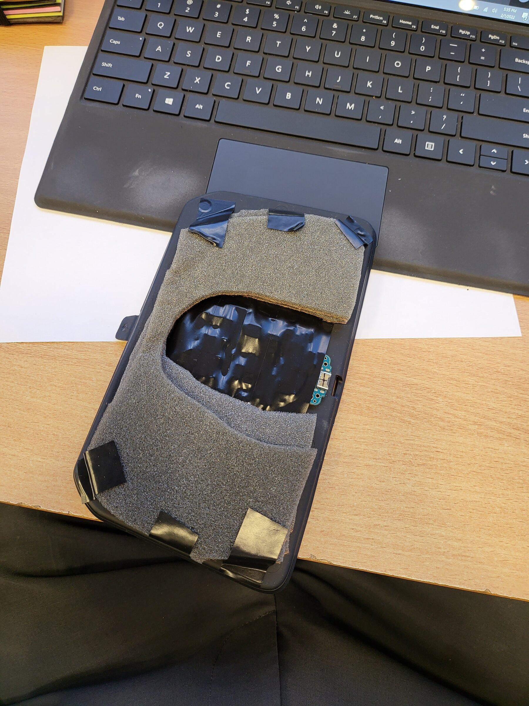

Not to thread hijack, but I took this install a step further today.
Was considering picking up a charging board off Amazon, and wiring in via add-a-fuse. Foam cut out under the pad for the board to sit flush.
Was sitting at work and came across a wireless Samsung charger I don't use any more (have one built in to my mouse pad now), so I disassembled it. Took the cooling fan off (won't be any ventilation under the rubber mat anyways), and cut some foam out. Electric tape holds the board and charger in place, and I ordered a 6" USB Type C cable off Amazon today.
Works great! Like all wireless chargers it'll take a bit to figure out exactly where to place my phone to charge, but for $6 (the shorter cable) I'm very pleased. The rubber mat even has a little hole in the front for the cord to run through. 🤷

Nice! Can you show it installed with the cable inserted? With less crotch shots. 🤣

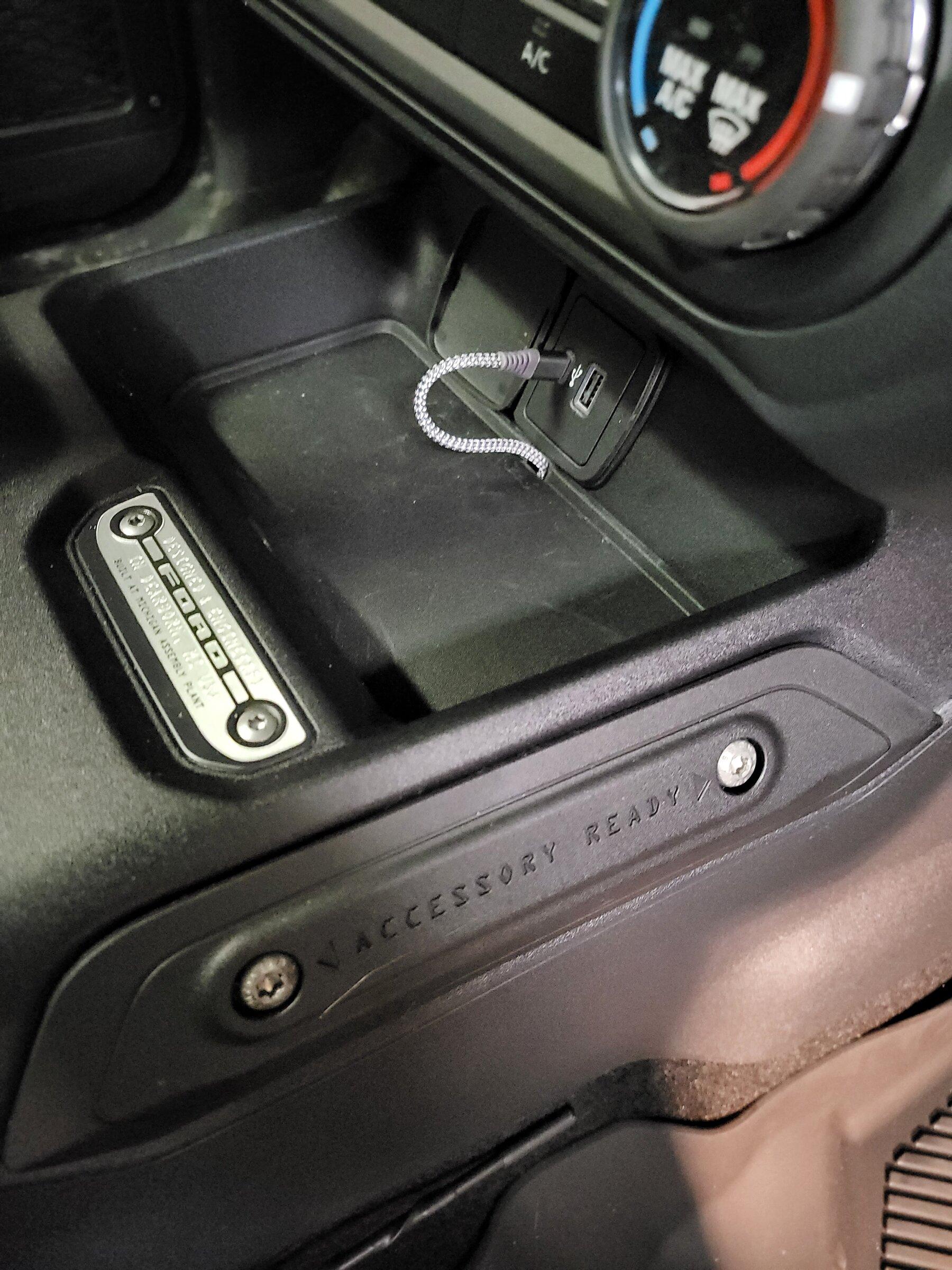

Yeah I'll snap a photo tomorrow when I have the shorter cable. Can't guarantee my crotch won't make the shot though
