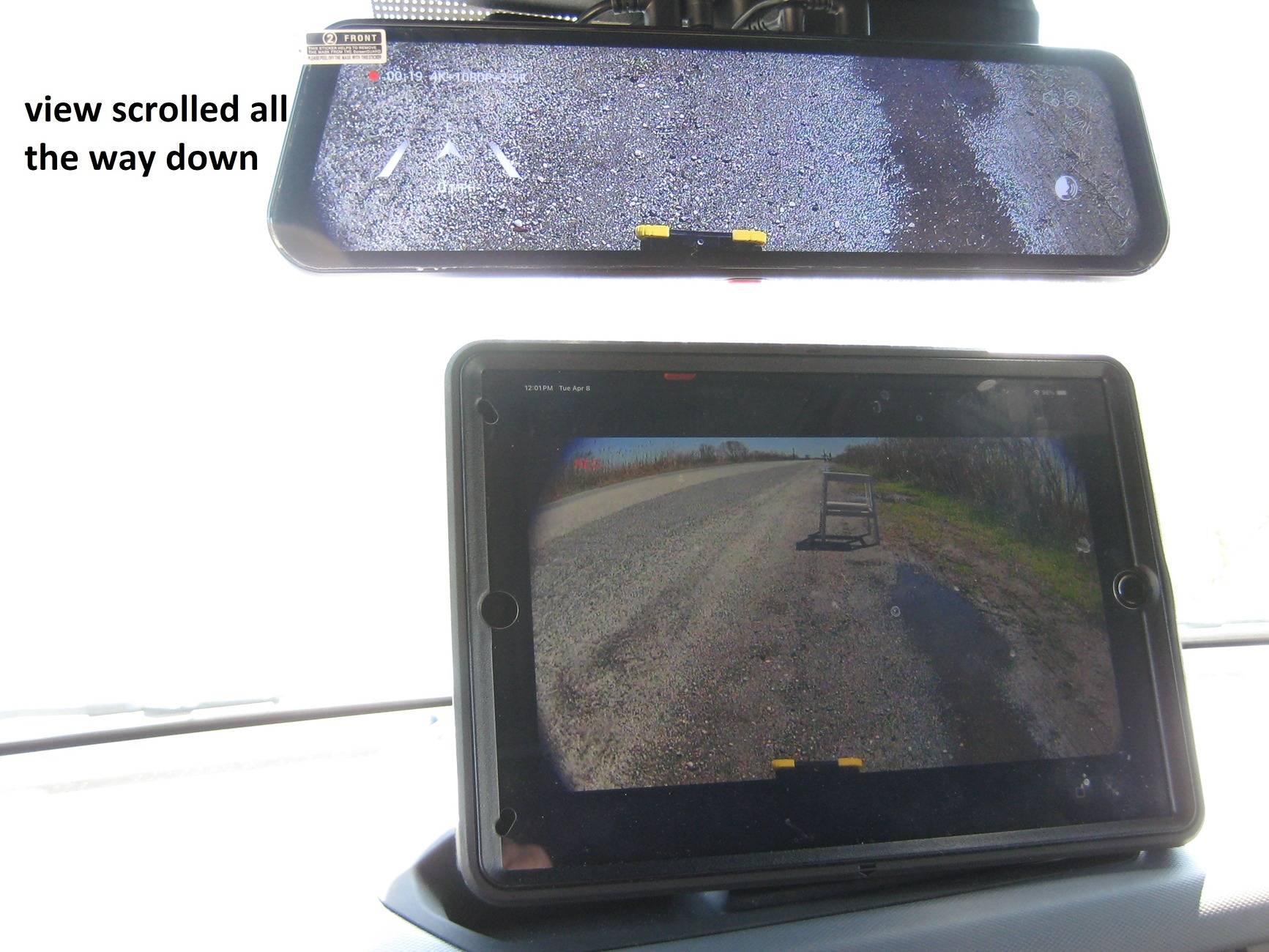

From what I can tell you cannot watch 2 cameras on different devices simultaneously.
In my photo, I was live streaming the camera to my Ipad via the mirror's wifi connection using the Wolfbox app. In that mode you can see the entire camera image on the Ipad and change views using the the app, not the mirror settings.

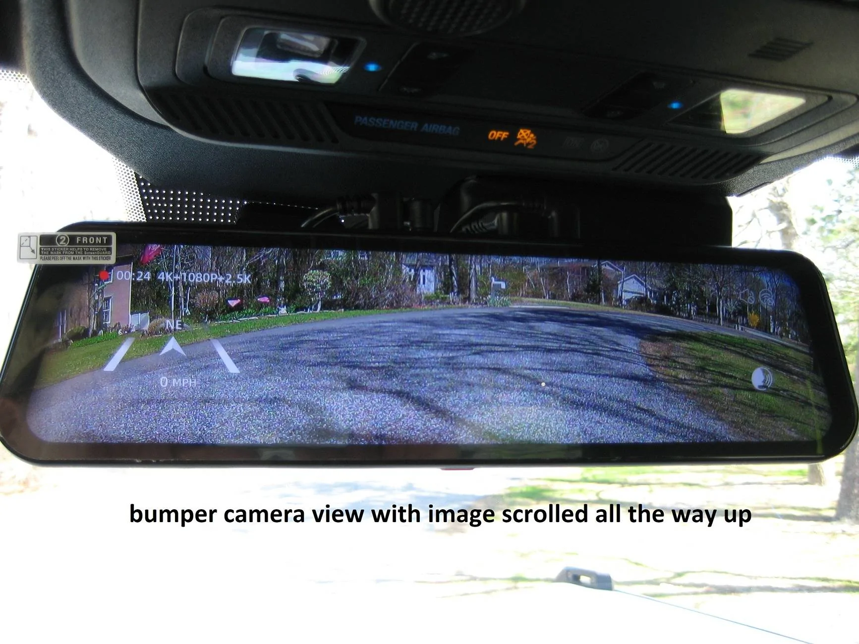

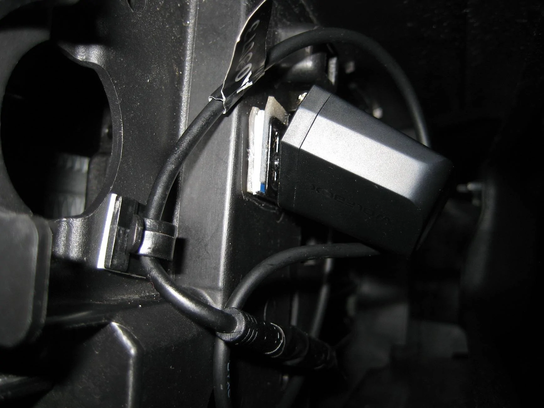

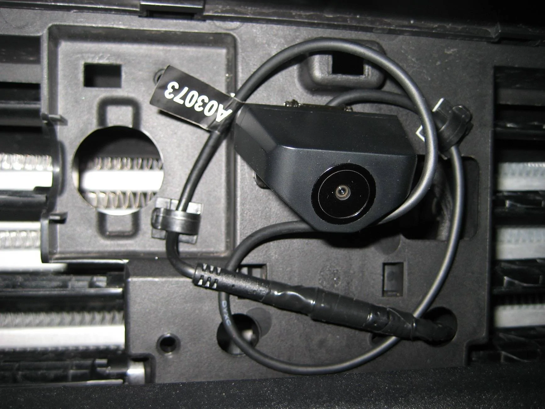

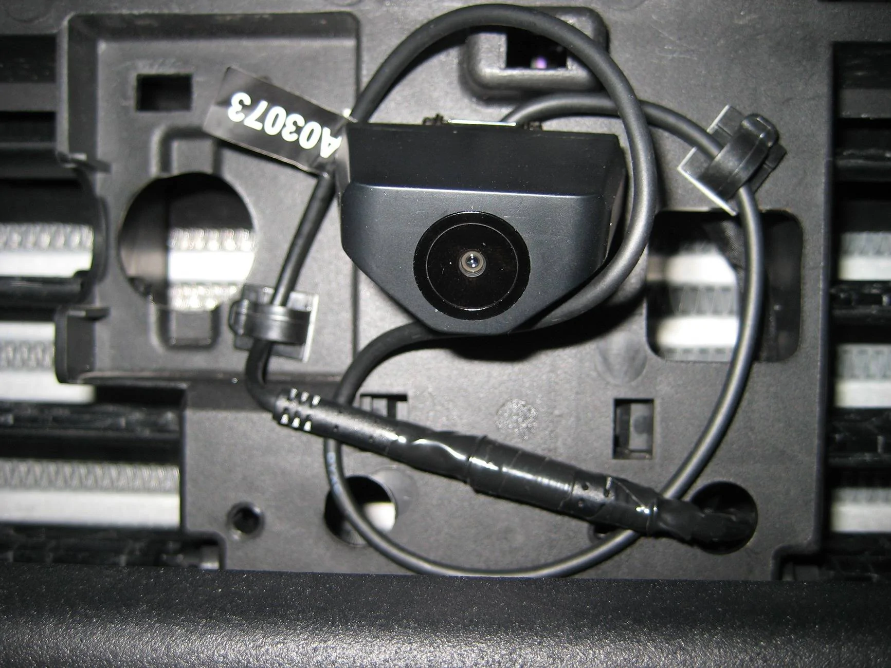

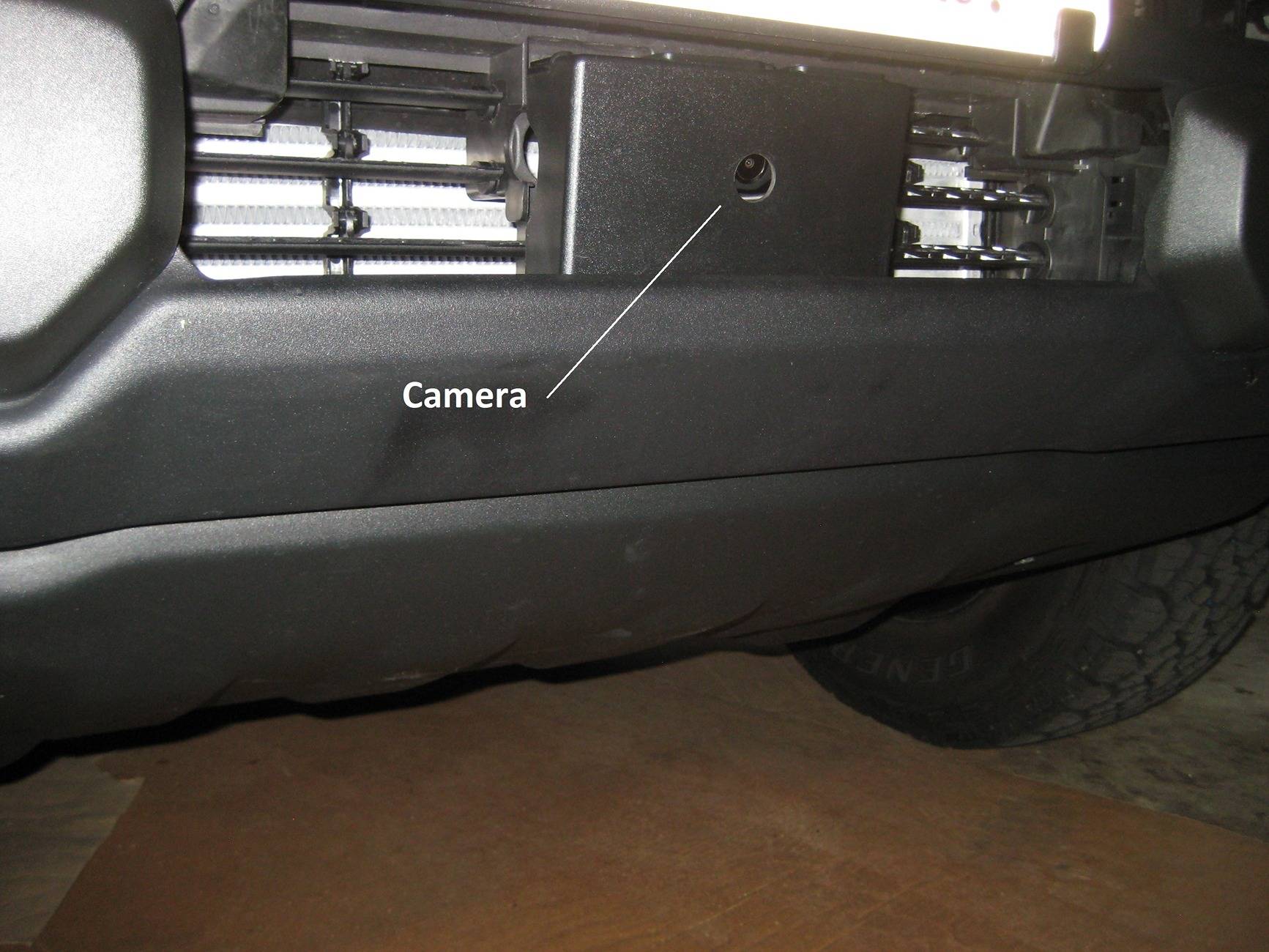

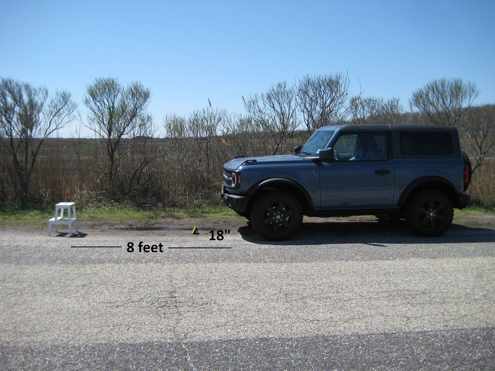

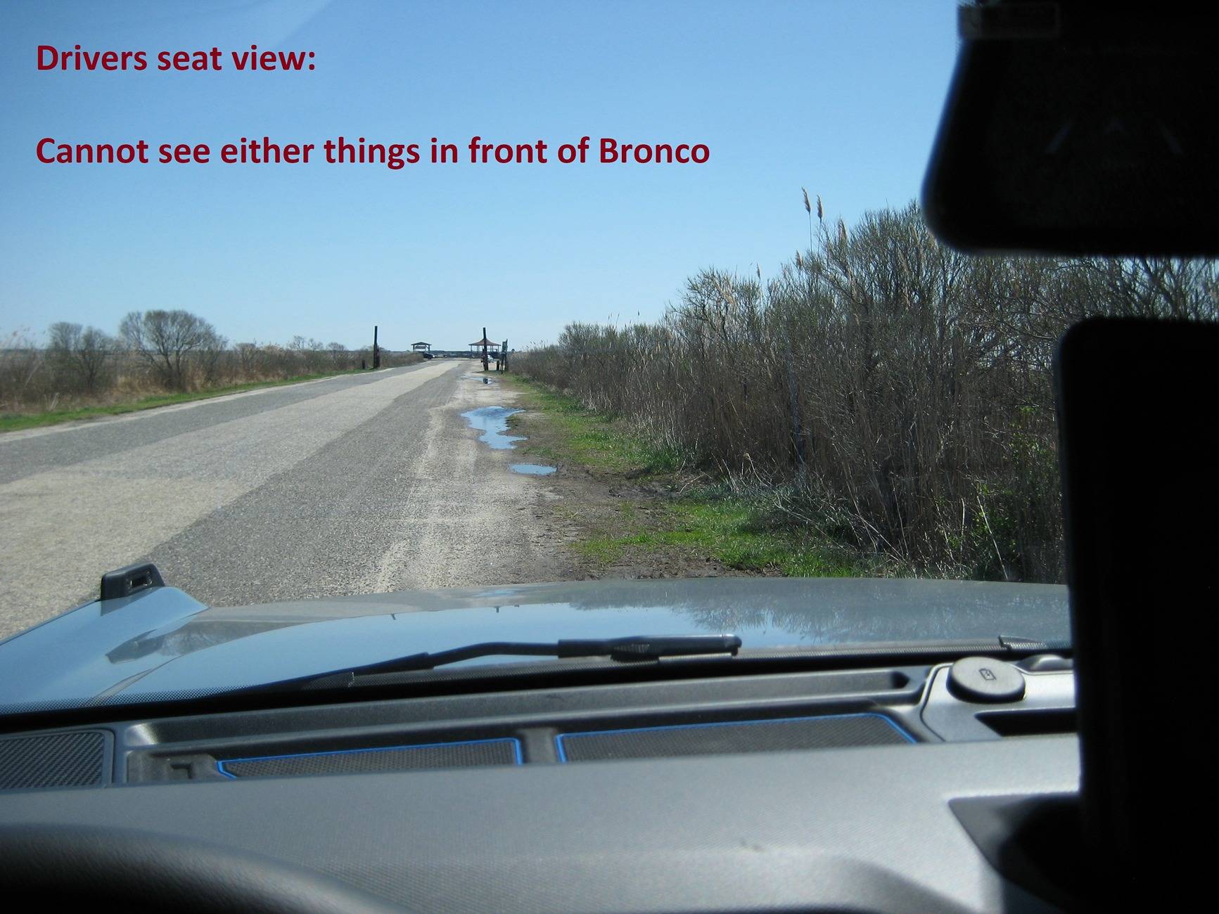

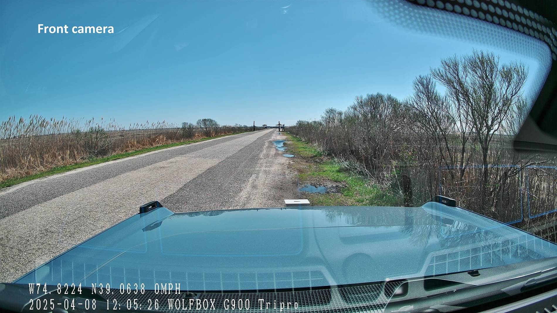

Just installed my tri-pro camera where the adaptive cruise control LiDAR would be if I had one.
https://wolfbox.com/products/wolfbox-g900tripro-bumper-version-3-channel-rearview-mirror
Below are some pictures of the installation and some views to compare how it helps with the blind spot in front of my Bronco. I can now see objects 18" in front of me!
Nice! I mounted mine on the trim under the grill, but this may be a better solution. I worry about getting mud and other stuff caught in behind the faux sensor plate though?

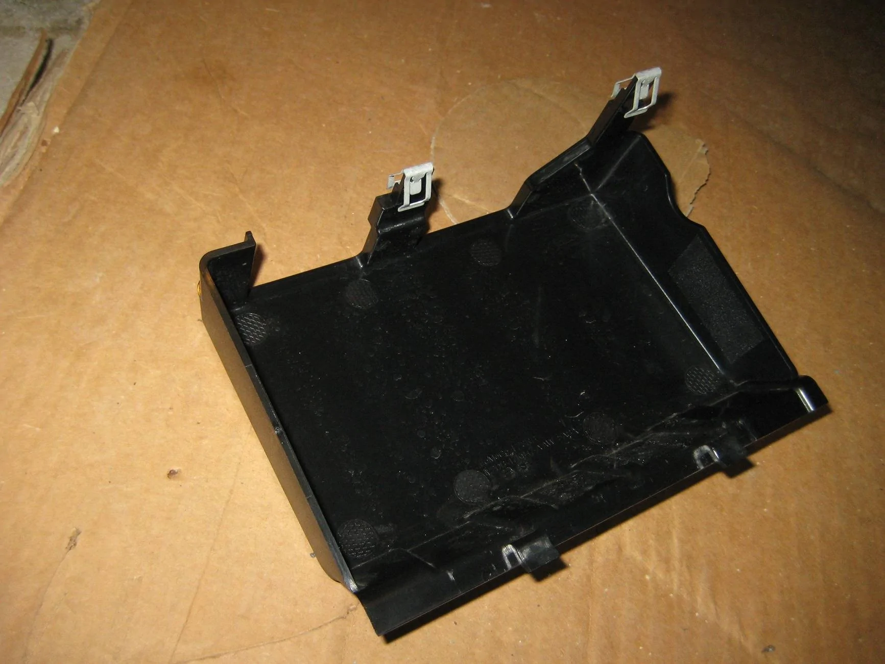

As it is, the top of the cover is wide open so I expect mud gets in there already.
If one goes mudding, I guess they can pop off the cover beforehand. It's just 2 snaps holding it on.

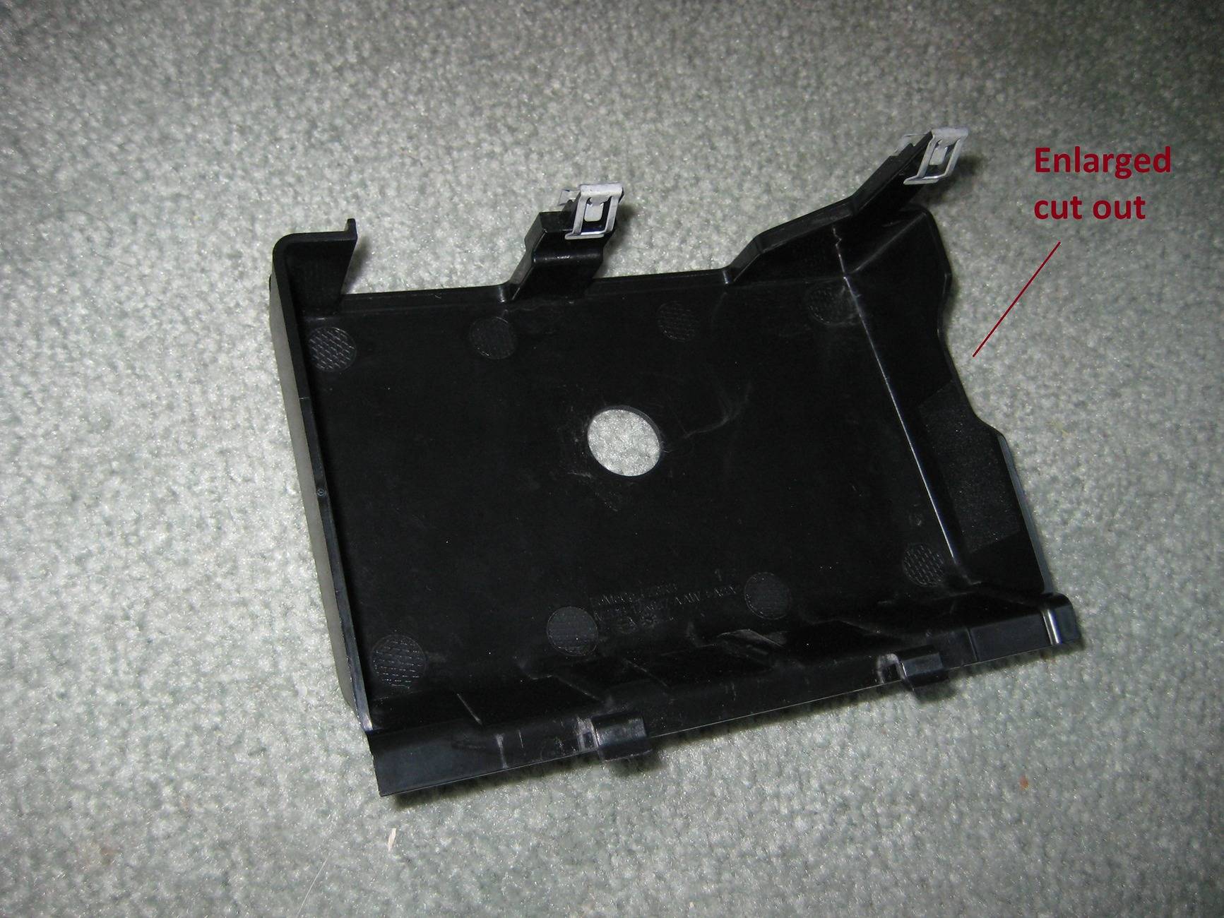

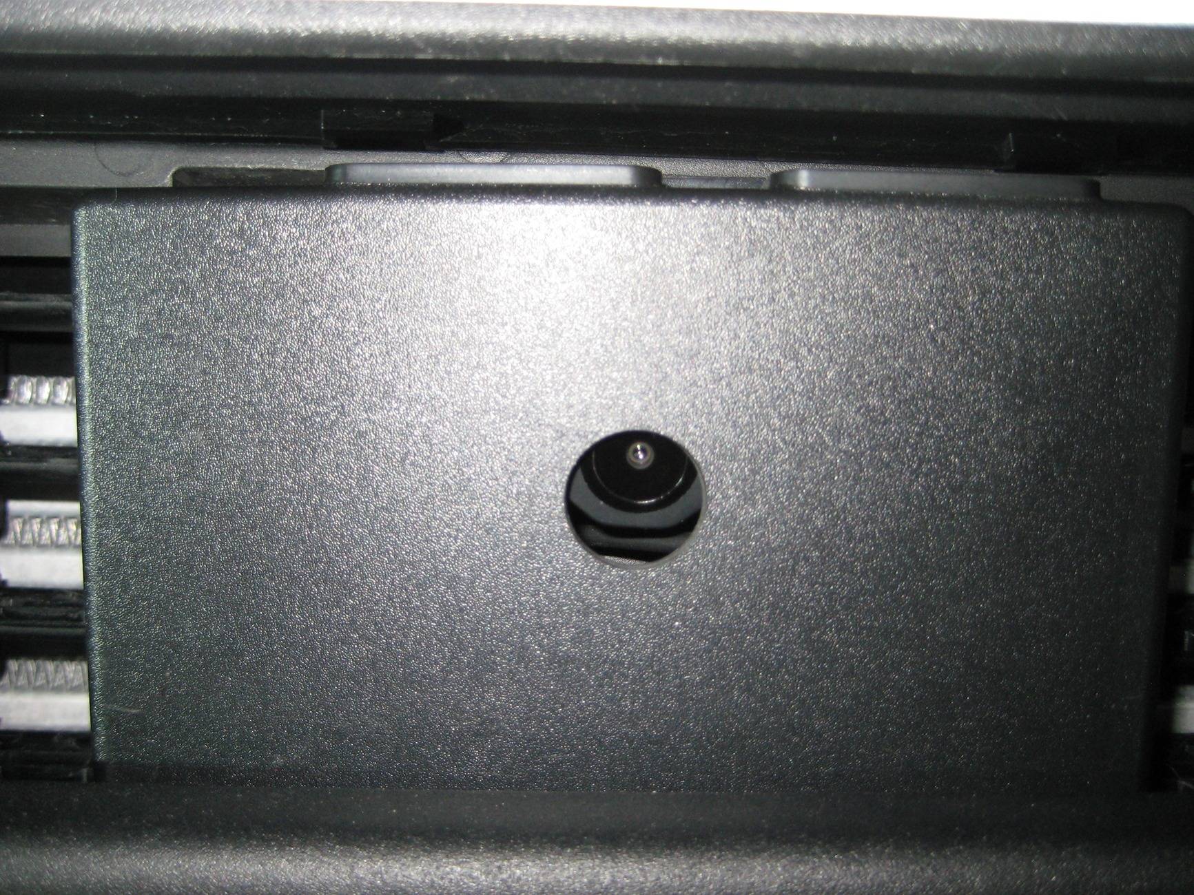

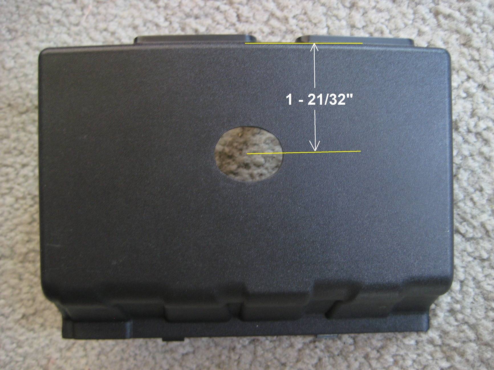

For anyone attempting this, I did have to carve out the side of the cover a bit larger to be able to slide the cover past the camera.
The biggest challenge is getting the camera to line up with the hole for the view you want. My hole is 3/4" diameter but I probably should have gone 7/8" or 1" to avoid the peephole look on the camera.
Ford Bronco Wolfbox TriPro Bumper Camera install (in adaptive cruise control sensor location) enlarged cut out
Hole egged out to remove peep hole look

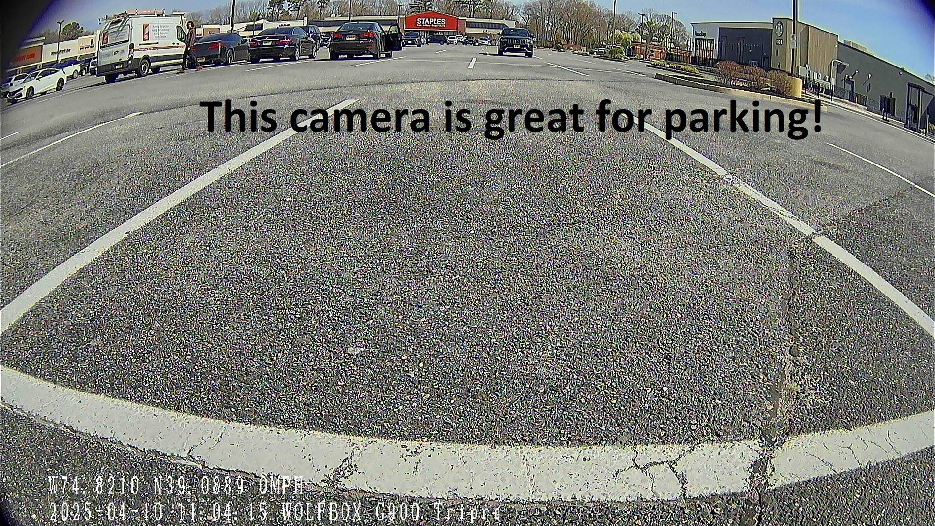

Bumper camera view
Ford Bronco Wolfbox TriPro Bumper Camera install (in adaptive cruise control sensor location) 2025_04_10_110415_00_I.JPG
Ford Bronco Wolfbox TriPro Bumper Camera install (in adaptive cruise control sensor location) front vi

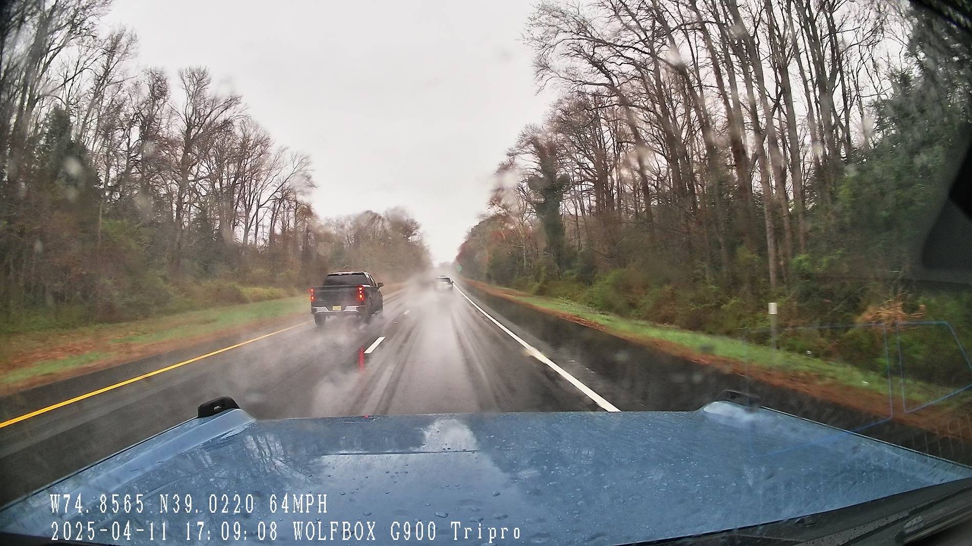

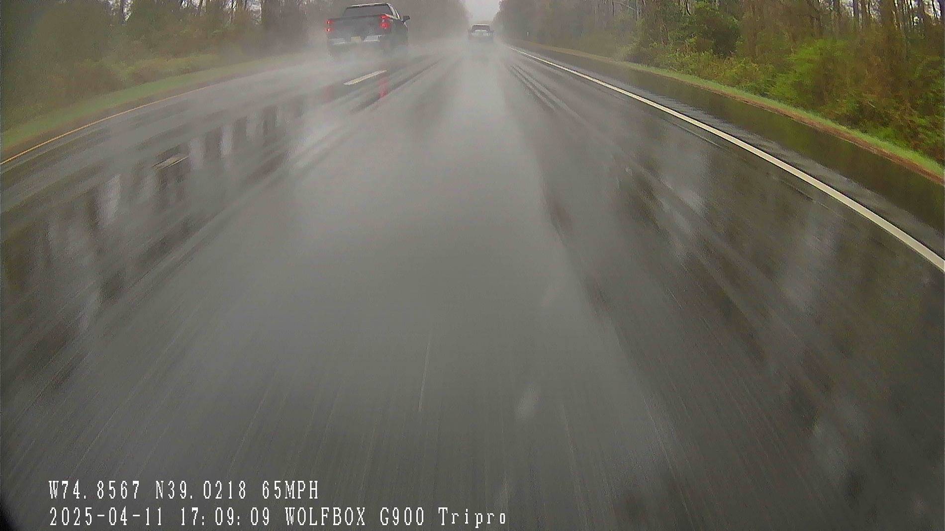

Tried my camera setup out in the rain
Front camera with polarizing filter
Ford Bronco Wolfbox TriPro Bumper Camera install (in adaptive cruise control sensor location) 2025_04_11_170909_00_F.JPG
Bumper camera
Ford Bronco Wolfbox TriPro Bumper Camera install (in adaptive cruise control sensor location) 2025_04_11_170909_00_I.JPG
