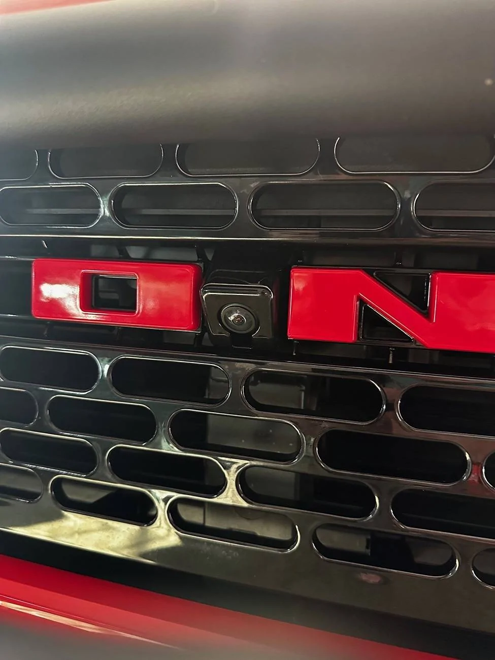

Front Camera installed

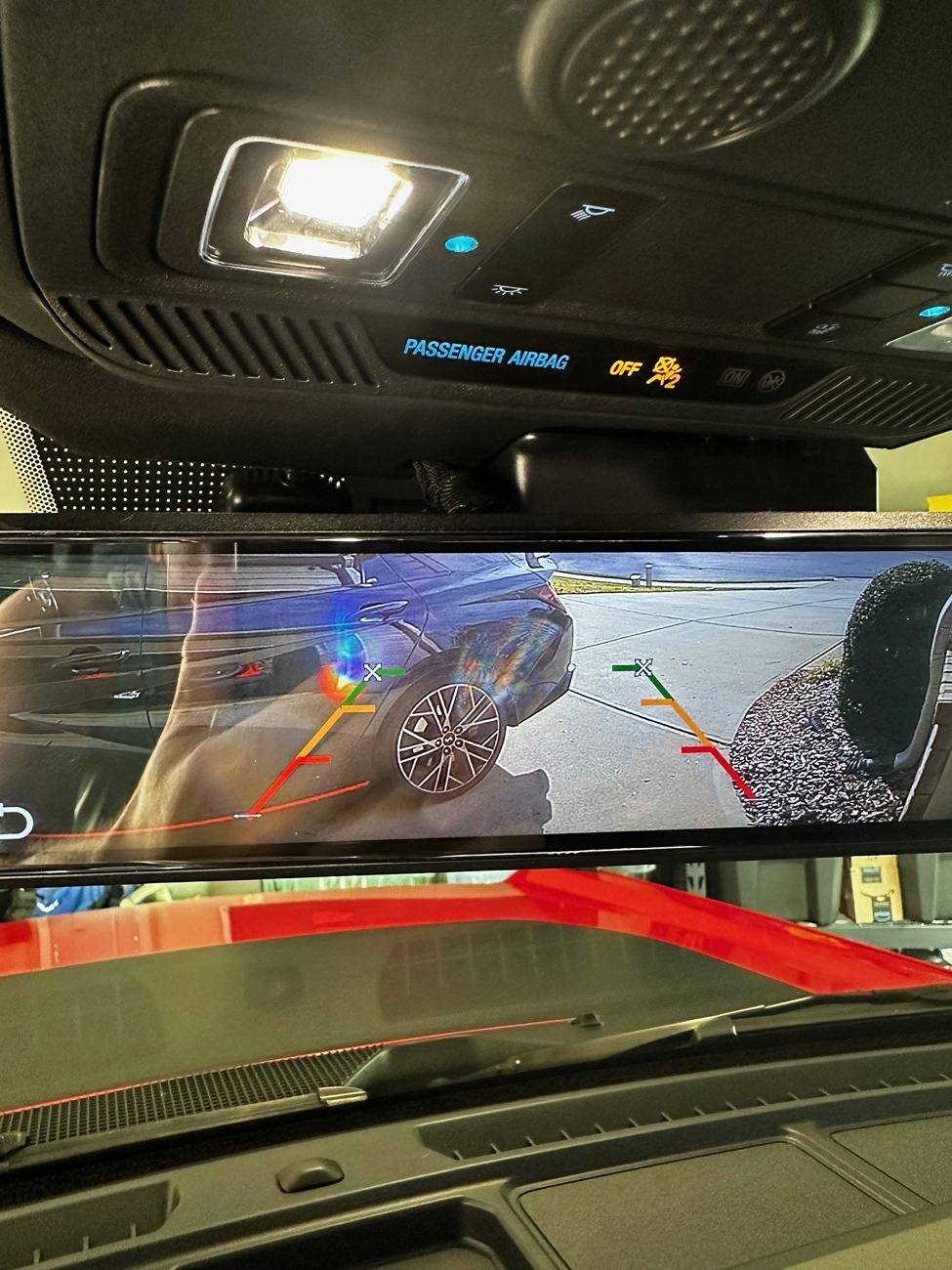

Here you can see just a little bit of my wheel at the bottom left of the mirror view. If you don't push the camera forward and bend the Amazon mount some, then you will see more of the wheel on the sides of your mirror view. If I angle my camera view up just a bit from this view, then you see even less of the wheel.

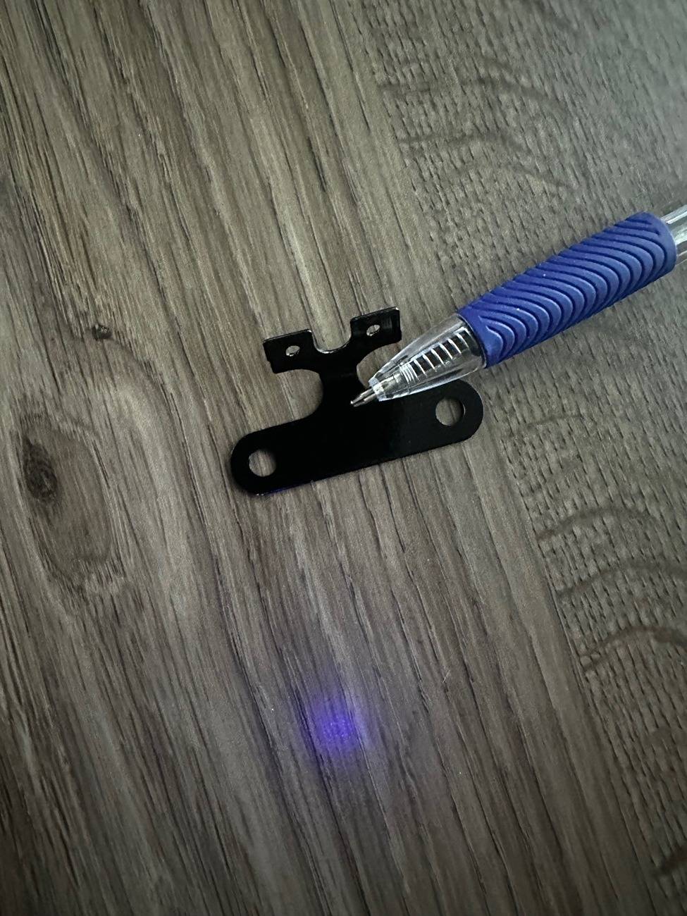

The pen tip below is where you will drill the hole for the screw you buy from Ace Hardware to mount this bracket with the camera attached to the Brandmotion mount. You will then have to shave off the bottom sides of the below mount so it isn't wider than the Brandmotion mount. I drilled my hole below the pen tip indicated, so you may not have to bend your mount as much to get the camera forward to a good spot if you drill based on the pen tip location below. You will have to bend this mount some to get it to where you want.

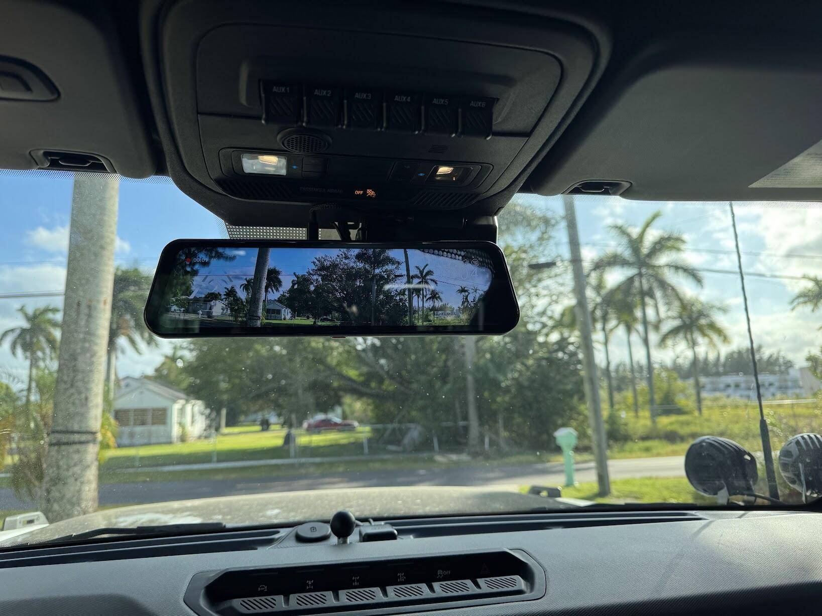

I have the WolfBox 900 pro. I just installed it a few days ago. I have not setup the back cam as of yet, because I am replacing my soft top with an Armadillo hard top and I am waiting for it to arrive. (Ships this week). I will be installing the rear camera from within inside.

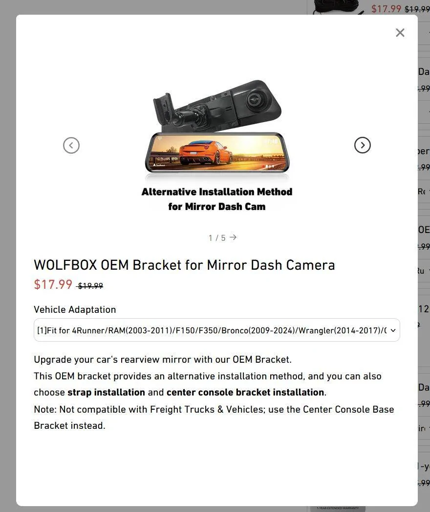

As for the WB, I chose it because of ease of installation. It has an OEM bracket (separate purchase for 14$) that allows you to remove the OEM mirror and install the WB. As for the wires coming out of the top, this was not a big deal because I used an adapter that allowed me to use the power from the OEM mirror, and I bought a 1.5 USB C cable to power. The GPS plug in is ran under my front trim and comes out next to my USB on the dash. The same will be for the rear cam when I run it.
The picture on the WB is crystal clear. It has many options as well, with built in WiFi to connect your phone to its network for video downloads, 2.5/5g, voice activation for camera operations, stop recording, turn on WiFi, show Front/Back etc. Also when the mirror is off it operates as well as the OEM mirror. At night it does have the antiglare, (mirror off) The built in GPS is very accurate. With power coming from the OEM, did not have to do anything special for the parking option. Best of all I received 35% off, and I was able to get a lot off the accessories, (which I found I did not need some because of the adaptor I found) but things such as the anti-glare, and rear camera brackets, were a bonus.
As you can see in my pic below, the install is clean, and you would really need to pay attention to see its not OEM.

David, Does this setup interfere with the visor's? Jim.
Ninjak
Feb 19, 2022
2,743
4,719
Miami
Afternoon Jim,
No. When you use the OEM bracket/mount, it replaces your mirror, and both visors operate as if the OEM mirror was in place.
