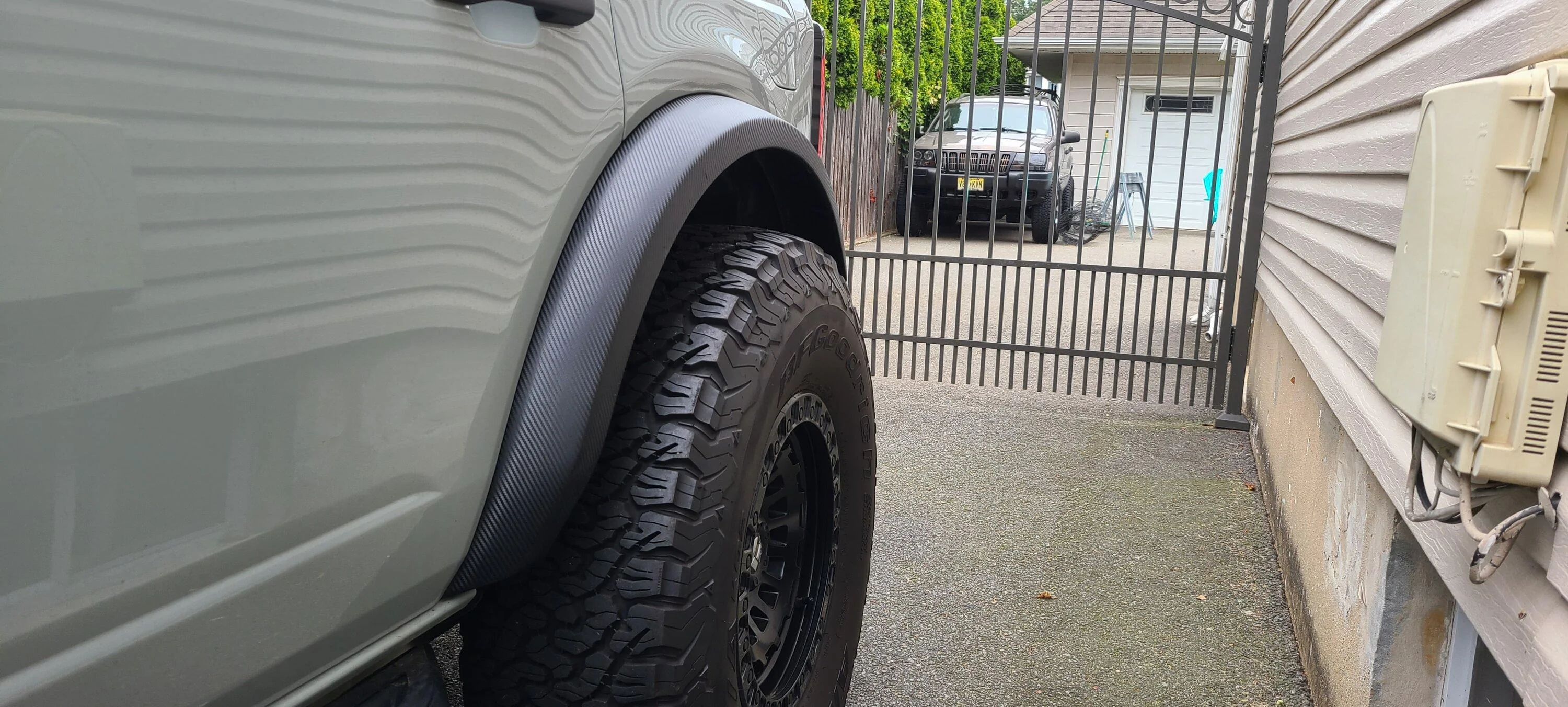

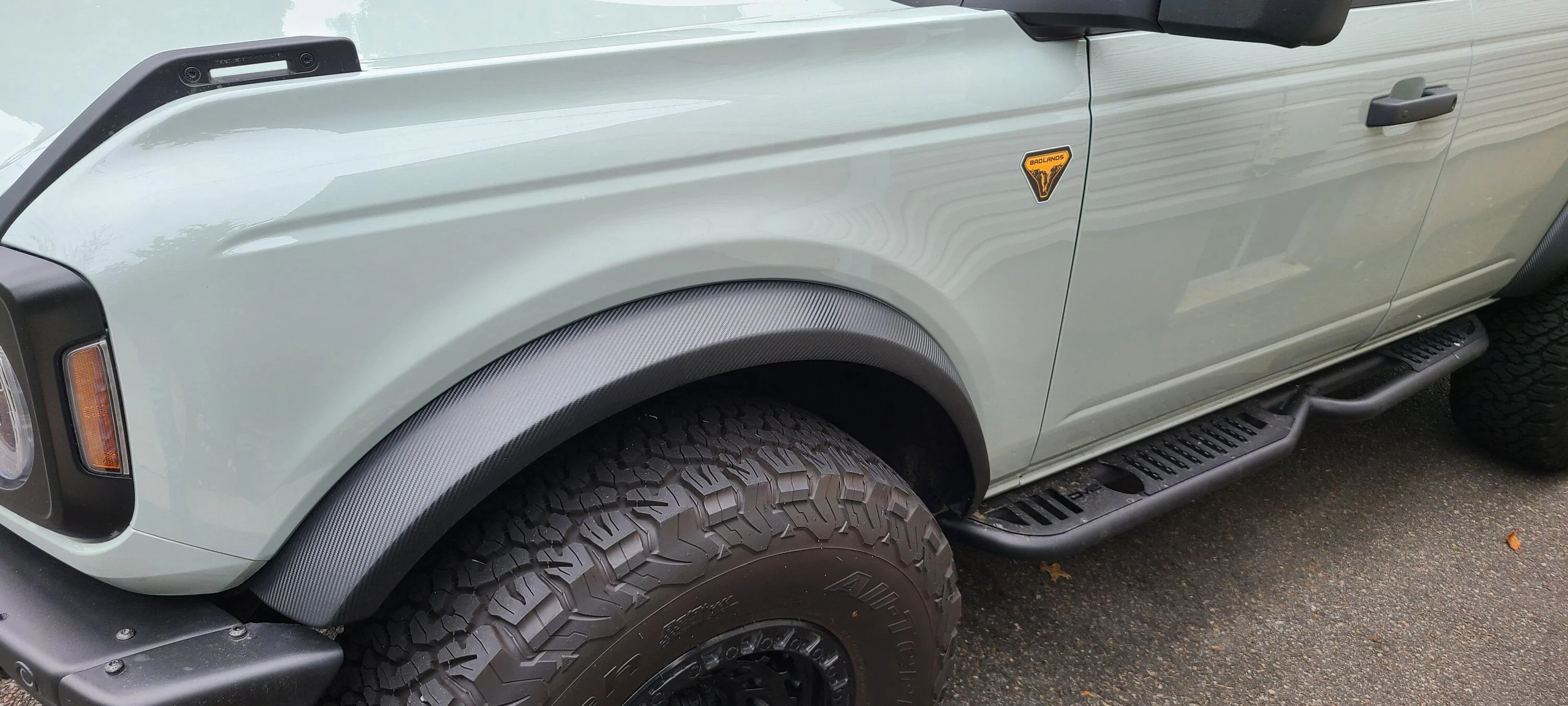

This looks great. Subtle and clean.

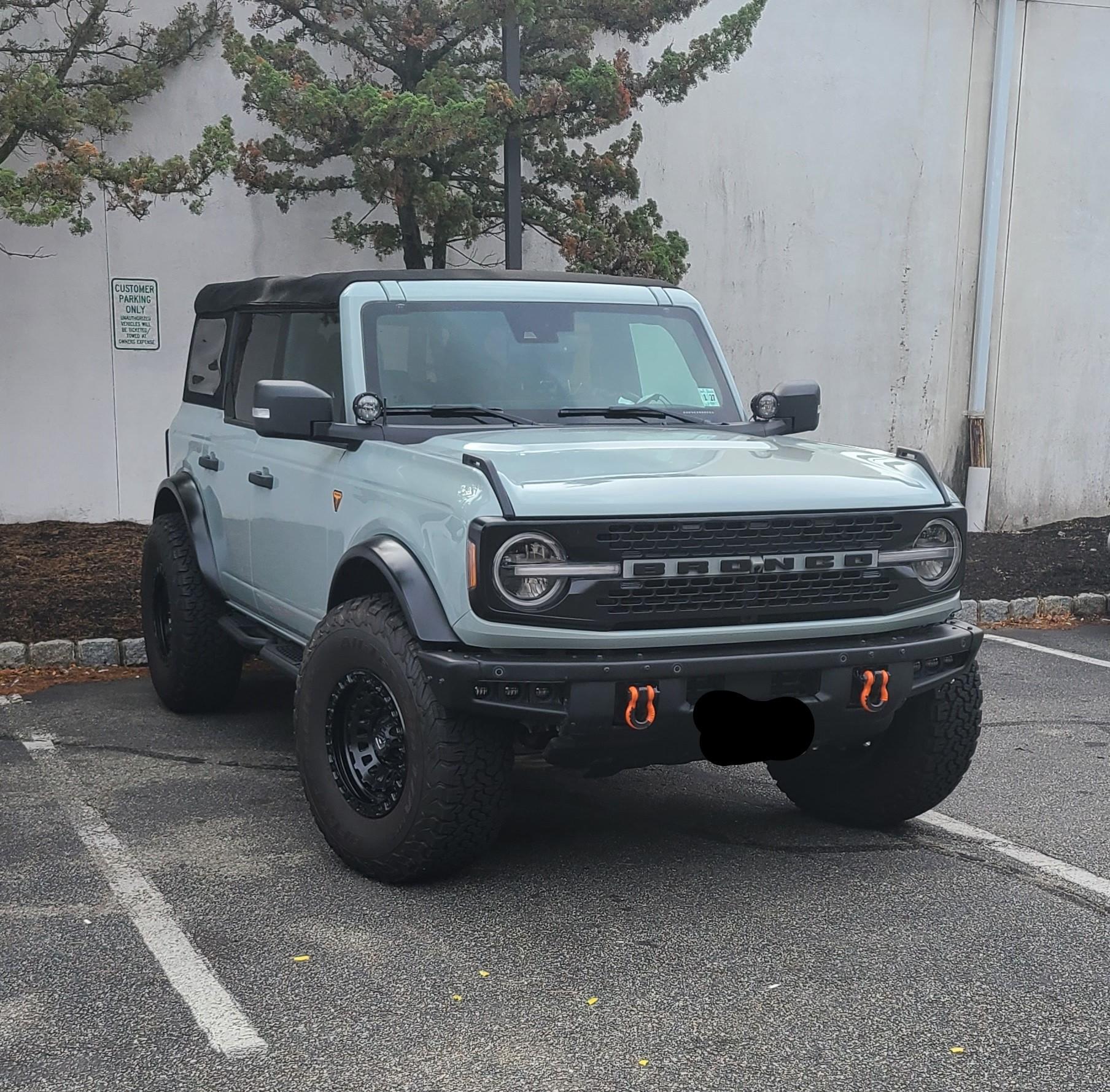

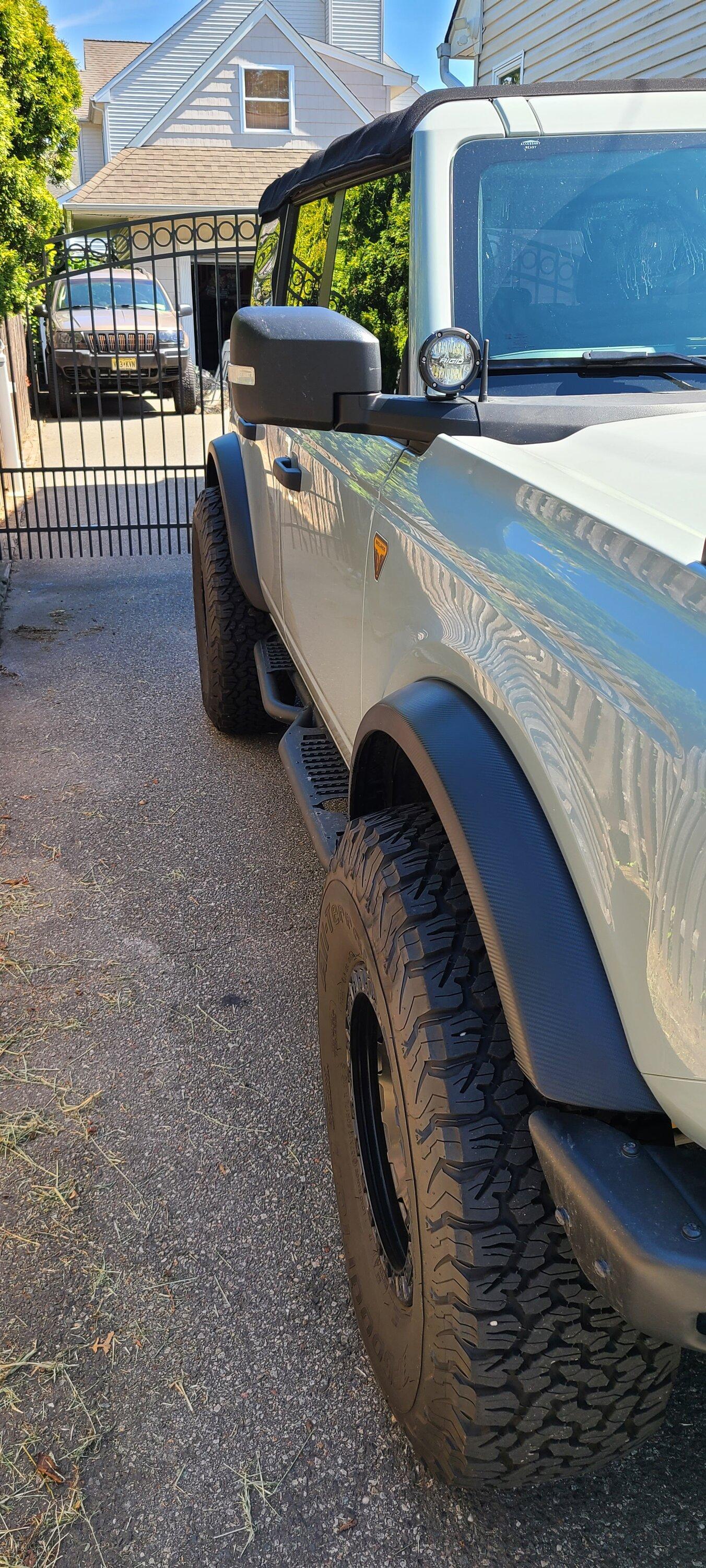

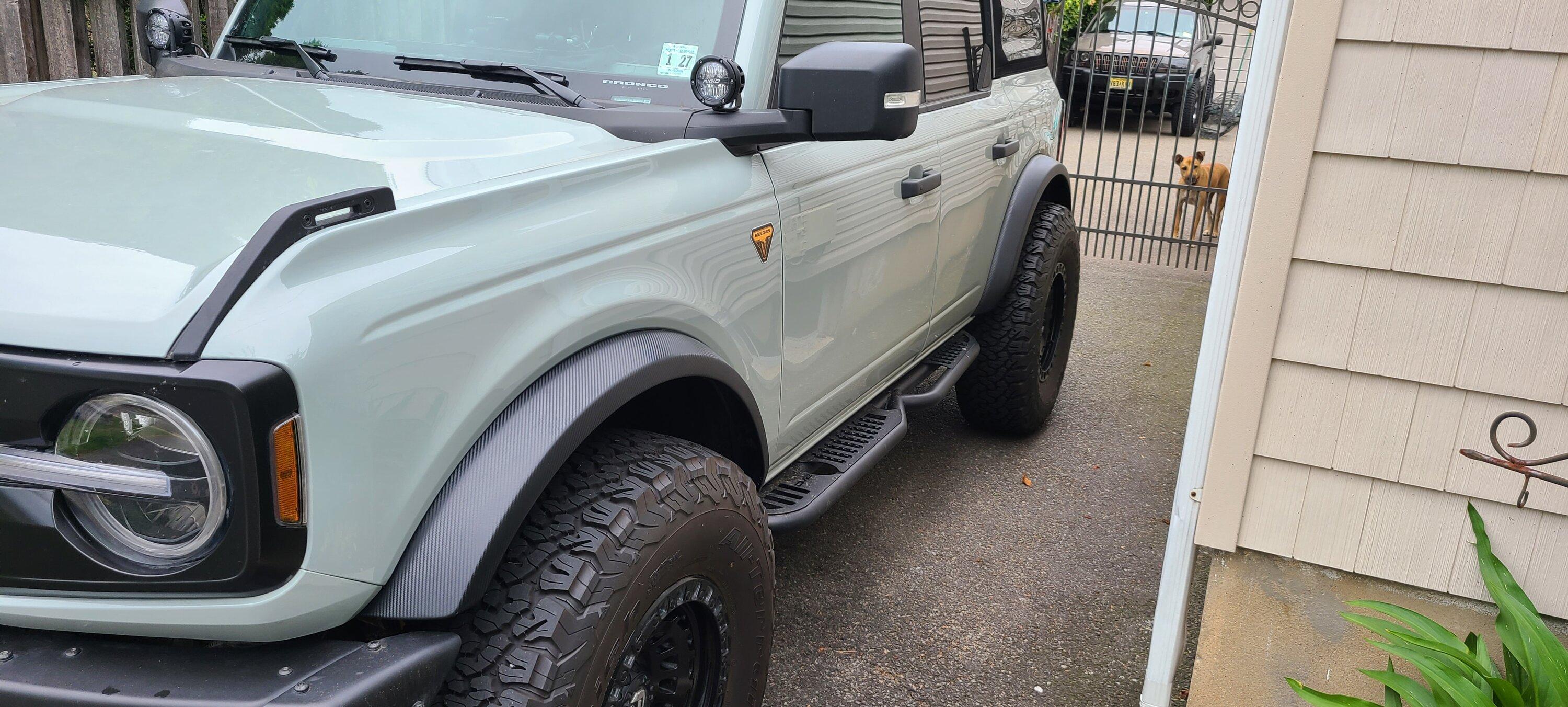

Did you paint the grill yourself? I was thinking about doing it and trying to decide between gloss an matte.First I painted my flares to match my grill that I painted satin black. I really liked the way the grill looked as opposed to the stock grey
so I thought the flares would look good to but after putting on the truck didn't like the way satin looked so I wrapped them.

-1 offset and 37" BFG KO2'sWhat offset are those zephyr wheels ?and I assume 35 tires what kind?
Yes I painted it. It is satin blackDid you paint the grill yourself? I was thinking about doing it and trying to decide between gloss an matte.

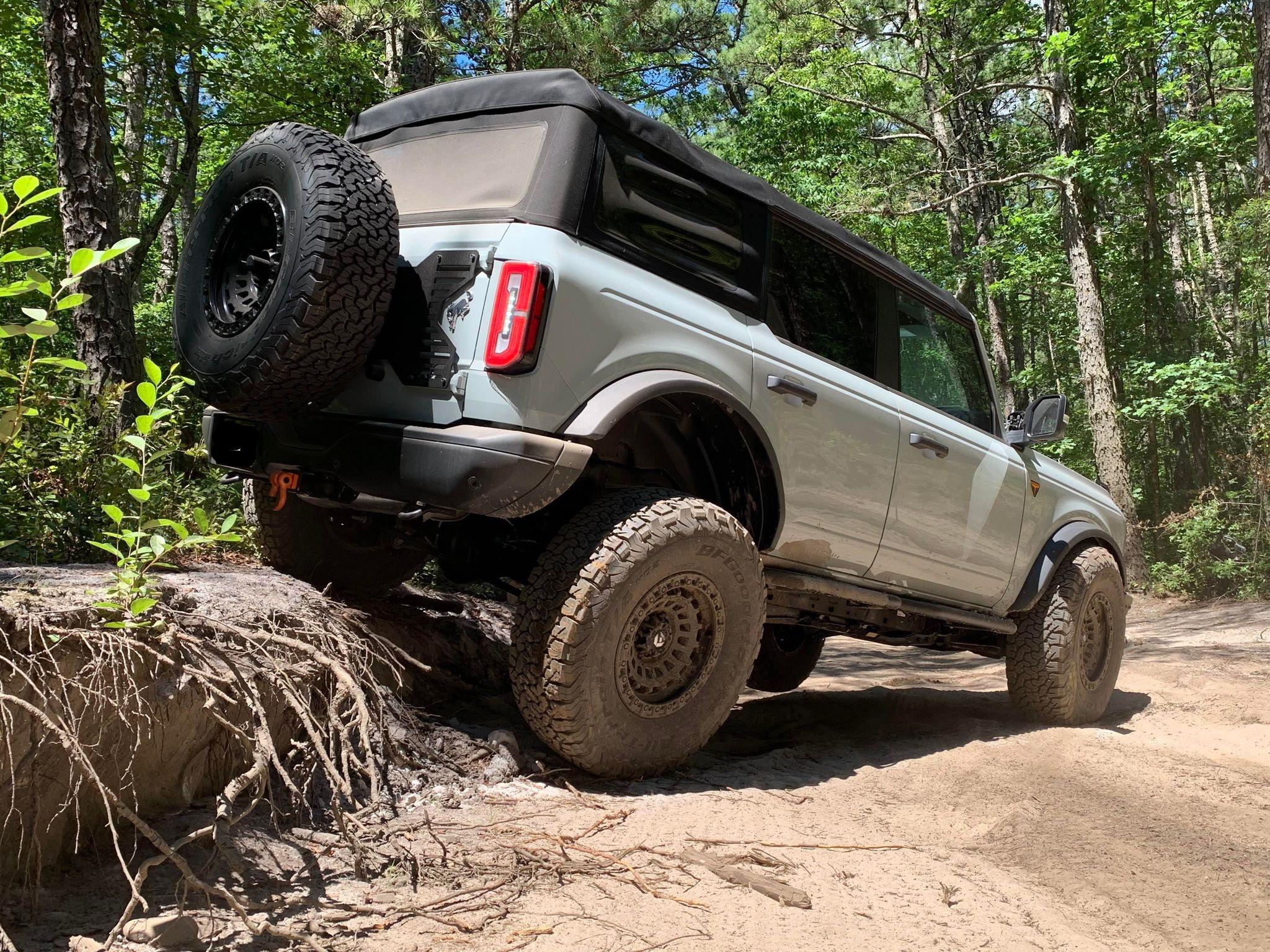

We went to three places that day started out at pine barrens then went further south ,maybe Brendan T Byrne state forest, I was following my nephew.where is this?
I do like the carbon fiber look... add one more thing to my "to-do" list now!First I painted my flares to match my grill that I painted satin black. I really liked the way the grill looked as opposed to the stock grey

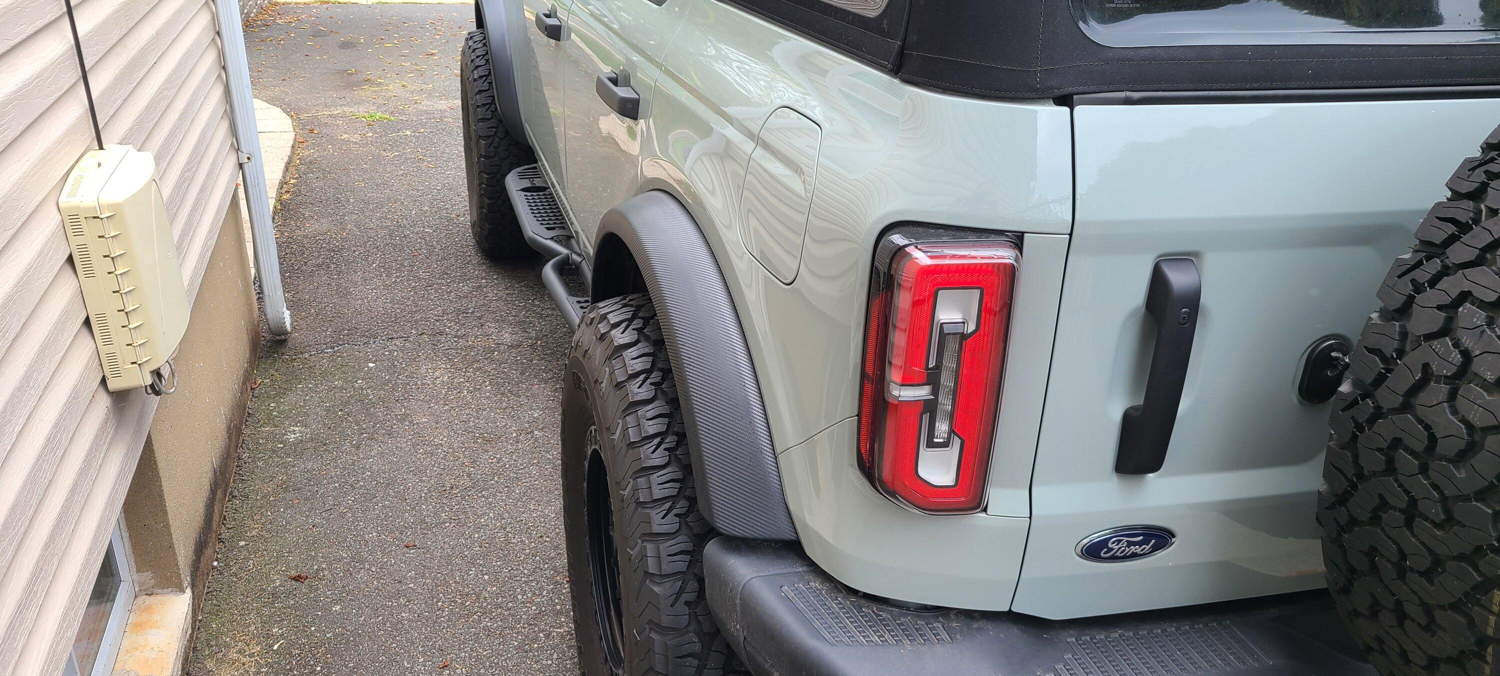

I have never wrapped anything before and to me this was pretty hard to do i cut into 9" x 60" strips and placed on top of the flare working down on side then the other. the strips kept wanting to move to the back of the flare not leaving me enough to cover the front side but I eventually got it to work.
Doing it this way it was very hard to wrap the front face but Got it with a little heat and a lot of patience. Probably should have bought enough to cover the face
of each flare and then pulled it over the top.

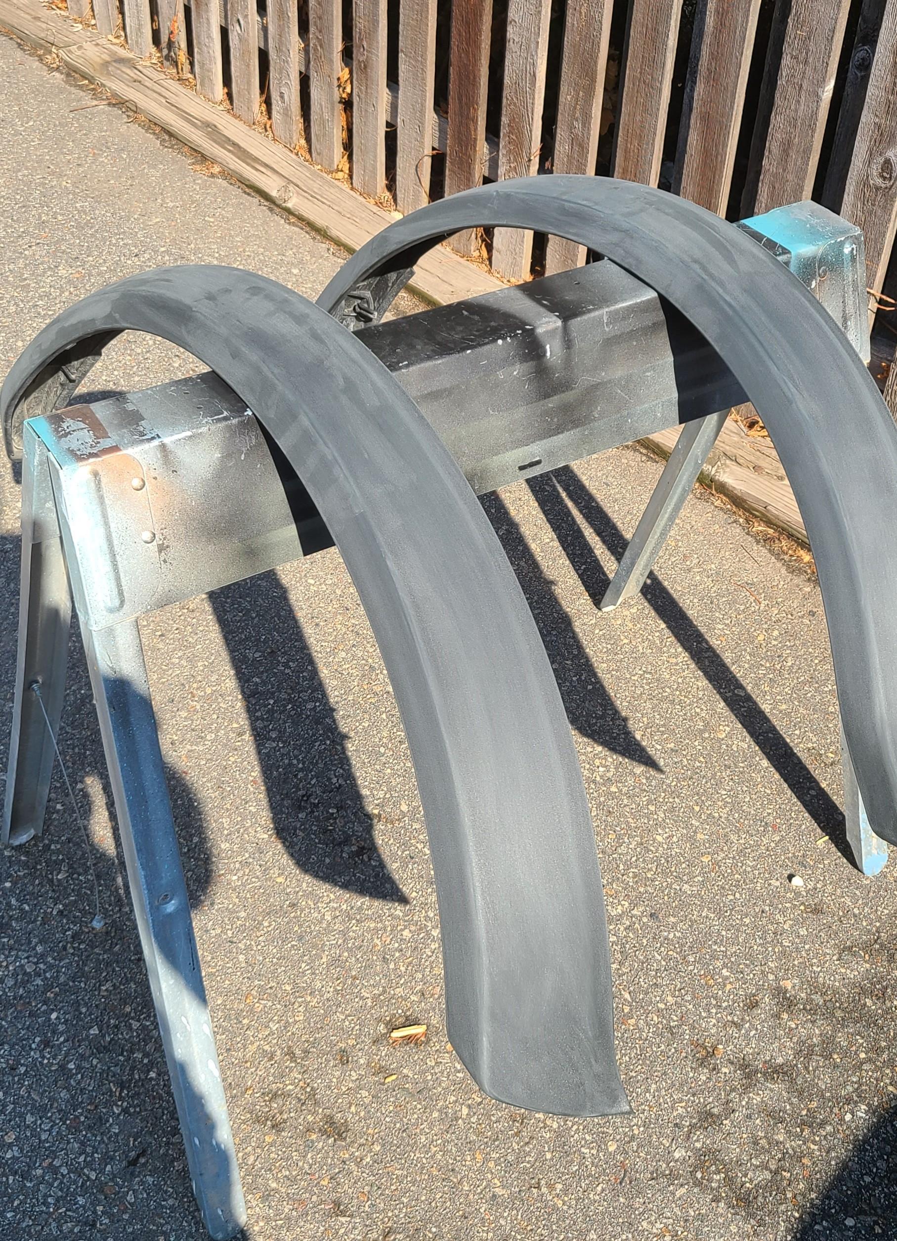

Here is what they looked like before I painted them very stained.

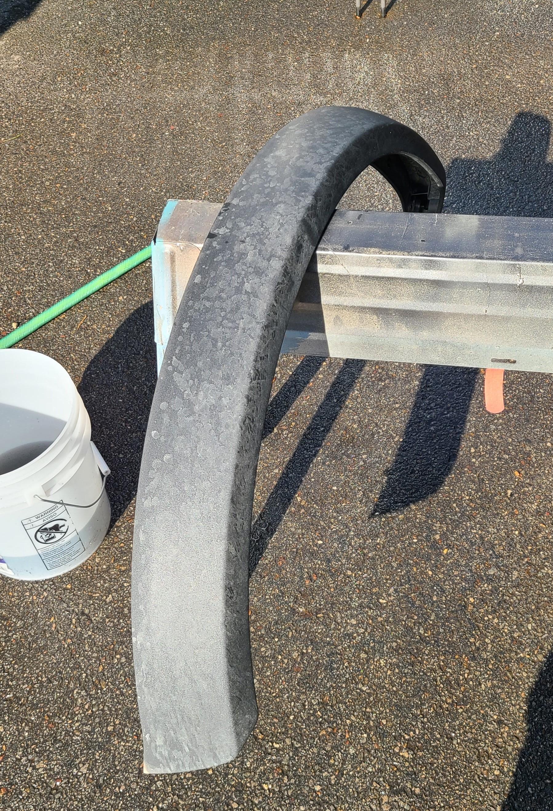

Here's what they looked like after lots of sanding.
If anybody is going to try this I would not try to wrap the the flares if they weren't painted I don't think it would stick.
Here is a link to the vinyl I picked it is a matt carbon fiber.
https://www.amazon.com/dp/B00L9J4SQ8?psc=1&ref=ppx_yo2ov_dt_b_product_details
If I did it this way again I would by a 48" x 60" giving me a 1 foot strip for each flare.
Here are some more pics of the finished project
