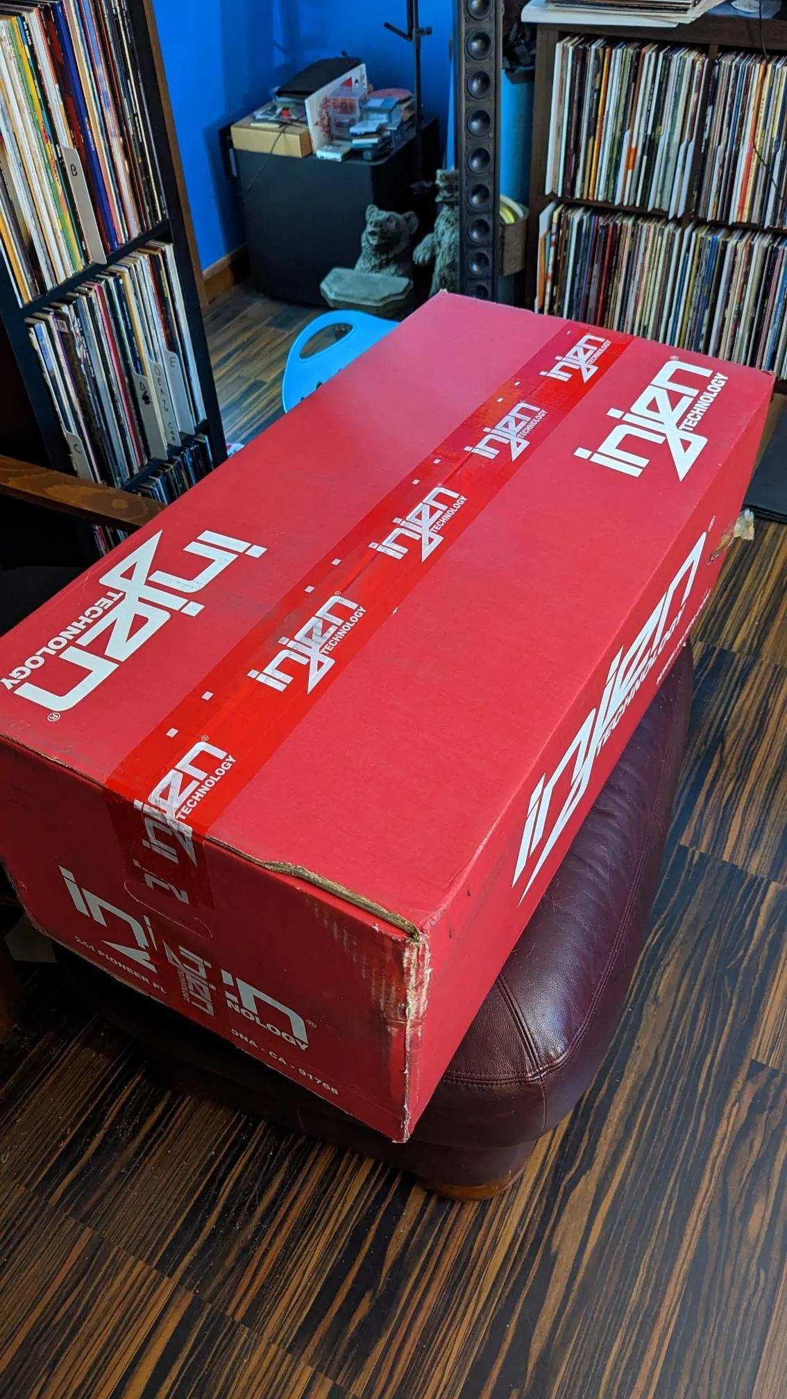

Ford Bronco Injen intake for 2.7 installed 1686951310945
Hey! One of those arrived today for me as well! It will indeed be a fun weekend :)

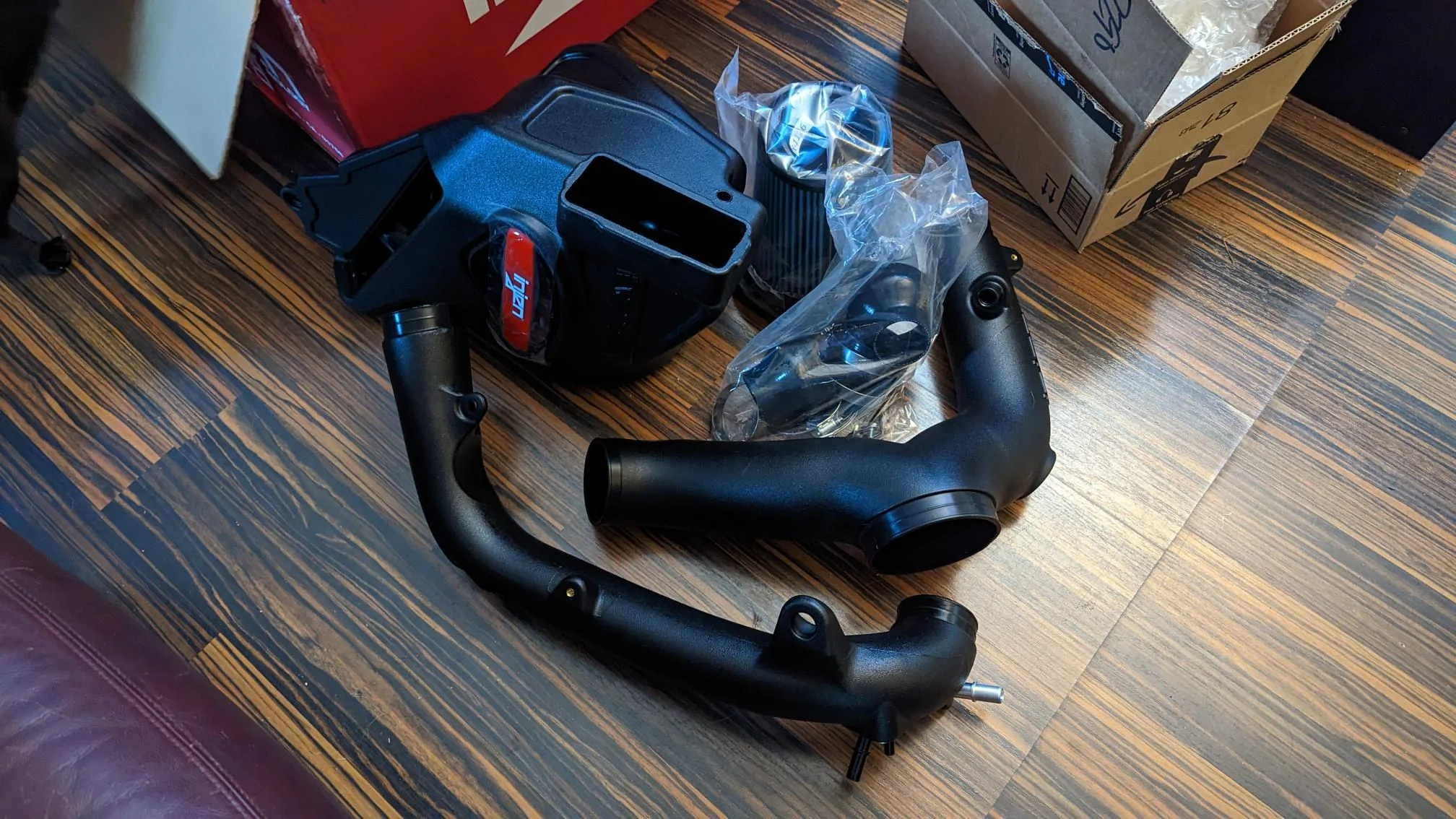

Ford Bronco Injen intake for 2.7 installed IMG_8002
Been looking at the K&N myself. Just curious, was there anything specific about the Injen that made you choose it over others? Just brand loyalty over the years? Or is it due to their claims of a 26Hp gain vs. 14.35HP gain from K&N? I haven't really compared other brands yet. Maybe it is the sound one makes over the other? I kinda like the blowoff sound the K&N adds but maybe they all do that?
The Injen is a completely closed system. The piece you see on the right side at the top is for a future snorkel attachment. That piece is closed off.
The K&N is not closed. The top of the lid is open and uses a thin foam piece to cover it. You can leave it off and you can touch and see the filter.
Also the Injen replaces the charge pipes and takes the bends out of the stock system. That is the reason I purchased this one. Close box has an attachment for a snorkel coming and proven to work.

The difference between the Corsa unit and the Injen unit is massive actually. The Corsa unit is basically just a box (with a smaller inlet actually) and a simple "Y" section to attached the restrictive factory intake tubes. It's basically just a replacement filter inside a box and not a true intake system.
The Injen unit not only uses a much larger filter/box, but it also has an attachment point for our snorkel that is currently in development. On top of that, Injen is the only manufacturer that designed their intake tubes that go all the way to the turbos. Our competition did not go all the way to the turbos because they couldn't figure out the vacuum port for the crank case pressure sensor which caused their kits to throw check engine lights. This is the main reason why our competition stops before the turbos and thus leaving that restriction point at the turbo and hurting power output.
Our engineering team designed our own version of the OE vacuum port to match our improved airflow and had it injected molded for a precision fit on our intake tubes. This allowed us to remove that major choking point right at the turbos and provided us with the additional power on the 2.7L that our competition just can't match (until they copy us that is).

thanks for explaining this. So if we don’t have a snorkel is that part still open or is it closed off unless you have a snorkel?

GAHHH! This install is a B@**&T^^@@@CH!!!! Oh they make it sound soooo easy lol. Well, its not. especially if these parts have never been apart before. Don't even get me started on the Ford clips......between that and the pop-up T-Storms today......I'm hoping I can get it done!
That said, its a nice piece, the box is bigger, also where there is the open side, that goes up against the side fender, so it will seal. (That is the snorkel assembly inlet btw) I wanted to do a how-to for youtube, but HA! Comcast had a cyber attack and went down. Hard. So yeah, it's not been a good day to do this, but it's going to get done.

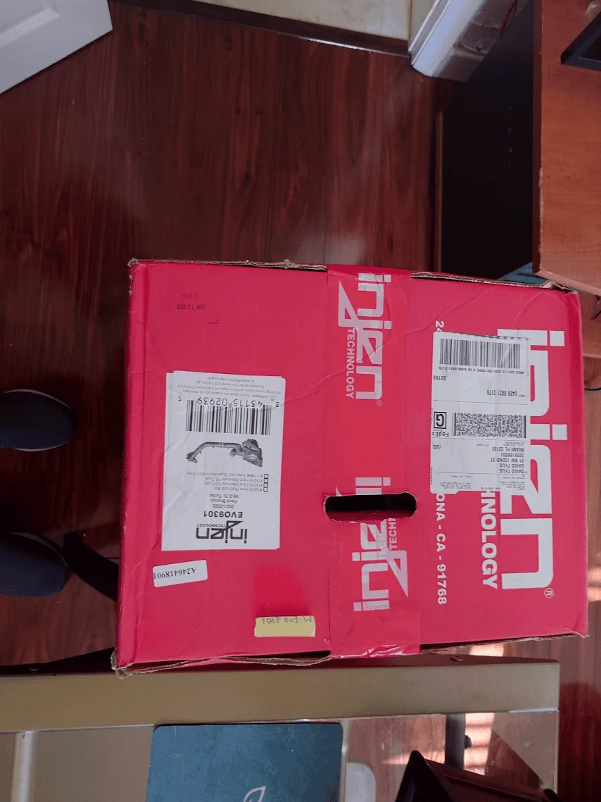

That was a bit of a nightmare.
Ford Bronco Injen intake for 2.7 installed 04F5E554-61E5-4851-834C-BFF4D8B3CC31
