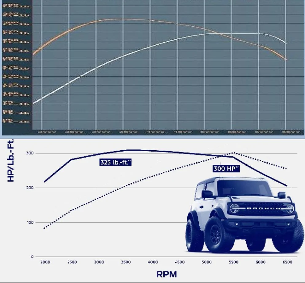

Having cut my teeth on 60's muscle cars, I always assumed the Bronco's horsepower and torque were advertising fluff the engine produced at ridiculously high rpms. The 2.3L is rated at 300hp/325 foot pound torque- pretty close to the 271 HiPer 289 of Mustang fame (Shelby boosted that to 306). Curiosity got the best of me, so I downloaded the curves and scaled them for comparison. The 289 is on the top. I'm still in shock; you can just about lay them on top of each other:
Ford Bronco Comparison: 2.3L Ecoboost vs the Legendary 271HP 289 2.3Ecoboostvs271h

Isn't that 289 rated under the old system? So head to head in the real world the 2.3 probably crushes it.

Back in the 1960 engines were usually rated for gross horsepower. The engine was tested on a test stand with no accessories, no exhaust system, optomized intake, timing, etc. The engines were tested under ideal conditions. Horsepower as installed in a vehicle was about 20-25% less.
Today engines are rated for net horsepower meaning all accessories attached with factory intake and exhaust systems.
There were some exceptions such as the 1968 Ford 428 Cobra Jet Mustang which was advertised at 335 HP to give it a better class for drag racing. It was closer to 410 by the rating methods of the time. The factory team made a shambles of the Super Stock class NHRA Winternationals that year. Stock, one could do 13.4 seconds in the quarter at 108 mph. The factory cars could do 11.5 at 120 mph.

Factory hp/tq numbers are still rated at the engine today, not the wheels.

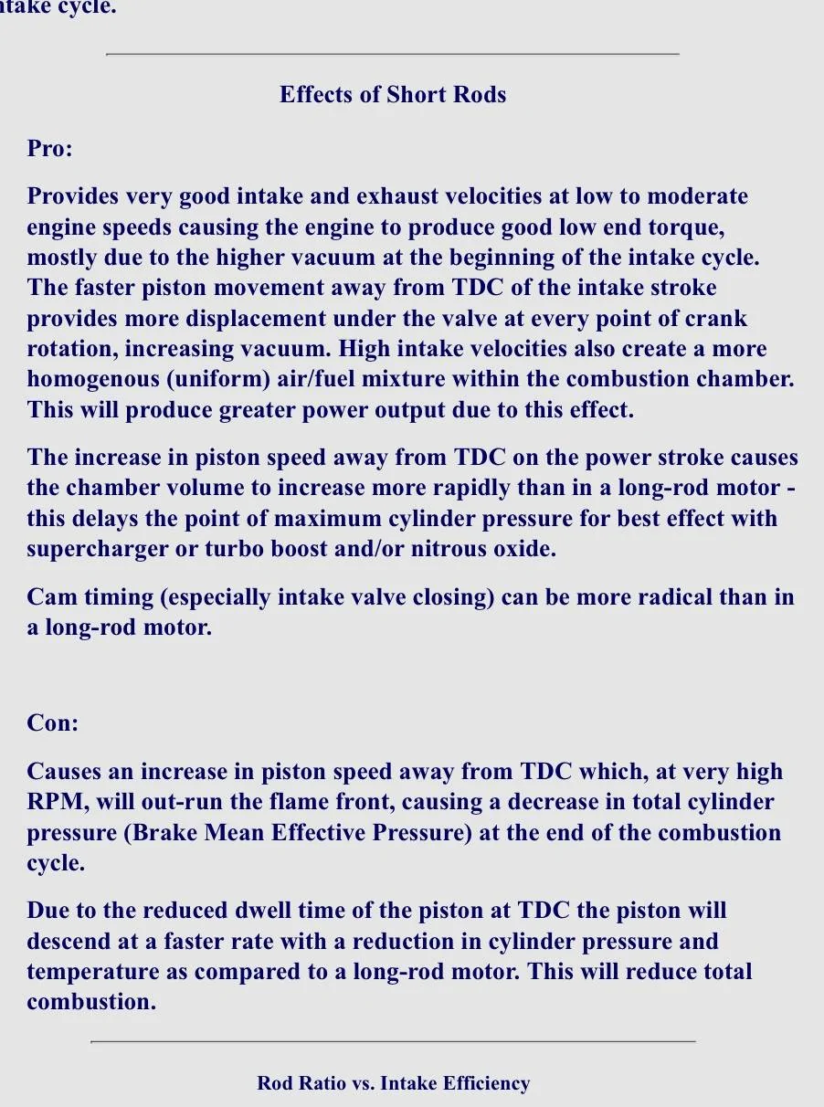

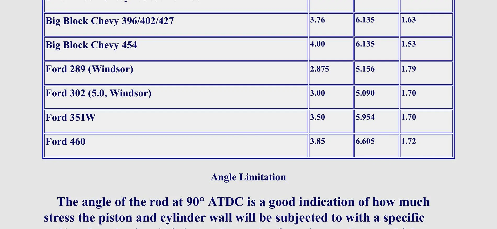

Ducati1098, do you know or could figure out the new 2.3l Rod Ratio? 289 was 1.79 and why she was fun at higher RPMs
Ford Bronco {thread} {filename}
Center to center rod length is 6.0709 in.
Stroke is 4.0157 in
So roughly 1.51

Not too surprising that the 289 is outpowered by a modern 4 banger though. The 60's muscle & Pony cars were great performers for their times. They continued to compare favorably with other eras for decades too, but contemporary cars/engines started to catch up as early as the 1980s. The trend continued and today a well optioned Honda Accord could keep up with most of stock muscle cars from the 60's.
As others have mentioned, the way hp is measured DID change too. The same HiPo, 271hp 289, from 1965 would be rated quite a bit lower today.
Ever looked up the 0-60 times on your favorite muscle cars from the 60's? Most were in the 6-7 sec range with only a few of the very fastest getting into the 5's.
