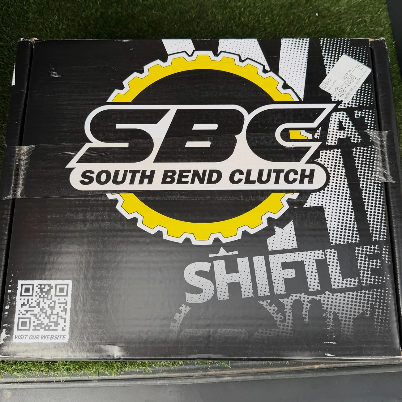

The setup I currently run is the OEM clutch with the B&M short throw shifter & the Steeda 40% softer clutch pedal spring.
The factory 2.3L Bronco manual is comfort-biased. Ford prioritized smooth engagement, Noise/Vibration/Harshness suppression, and wide driver tolerance. It’s easy to drive, but torque headroom, heat tolerance, and feedback are limited.
OEM uses a dual-mass flywheel, organic clutch, and an isolated long-throw shifter. Engagement is forgiving and quiet, but the system masks input and doesn’t like repeated load or heat.
Switching to a South Bend Stage 2 Endurance single-mass clutch removes that damping. Throttle response sharpens, engine braking increases, rev-matching improves, and heat capacity goes way up. The trade-off is expected NVH—idle gear rattle and a narrower engagement window are normal.
The B&M short-throw shifter pairs correctly with the SMF (single mass flywheel). Shorter throws and firmer gates improve shift consistency under load. Slightly more vibration, but better control.
The Steeda softer clutch spring is the balance point. It improves modulation and reduces fatigue, making the setup livable for daily driving without reintroducing isolation.
Net result: more torque capacity, better heat resistance, and cleaner shifts. Less forgiveness and more drivetrain noise. Highway behavior is mostly unchanged.
Bottom line: fewer buffers, more control. If you want comfort, stay OEM. If you want durability and direct feedback, this setup does exactly that.

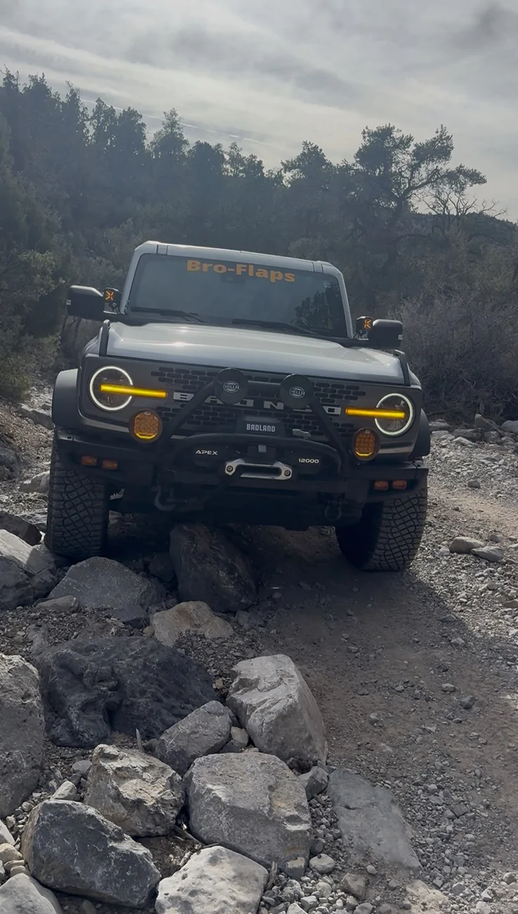

Very interesting and well written. I have the 2.3 with B&M and did the Rocky Gap Trail this weekend and had some left leg fatigue. The clutch seems relatively easy to modulate but if this is an improvement, count me in.

I run a South Bend clutch in my Dodge/Cummins 2500 with the NV4500HD. Good people there.
However, as Ford pegged it with the 7-speed, clutch and shifter, there's no need to spend additional money for any modification. Ford engineers got it right.

Once upon a time I had a manual cummins and the stock clutch couldn’t keep up with the engine mods. Put a South Bend in there and while I no longer had clutch issues, wifey absolutely hated driving the thing 😂 The “if you want comfort stick with OEM” is more true than many realize.

Is the included SMF lighter than stock? I have been seeking a kit with a heavier flywheel as some Jeep kits offer - looking for more tractor-type performance offroad and willing to accept a less performant experience on.
